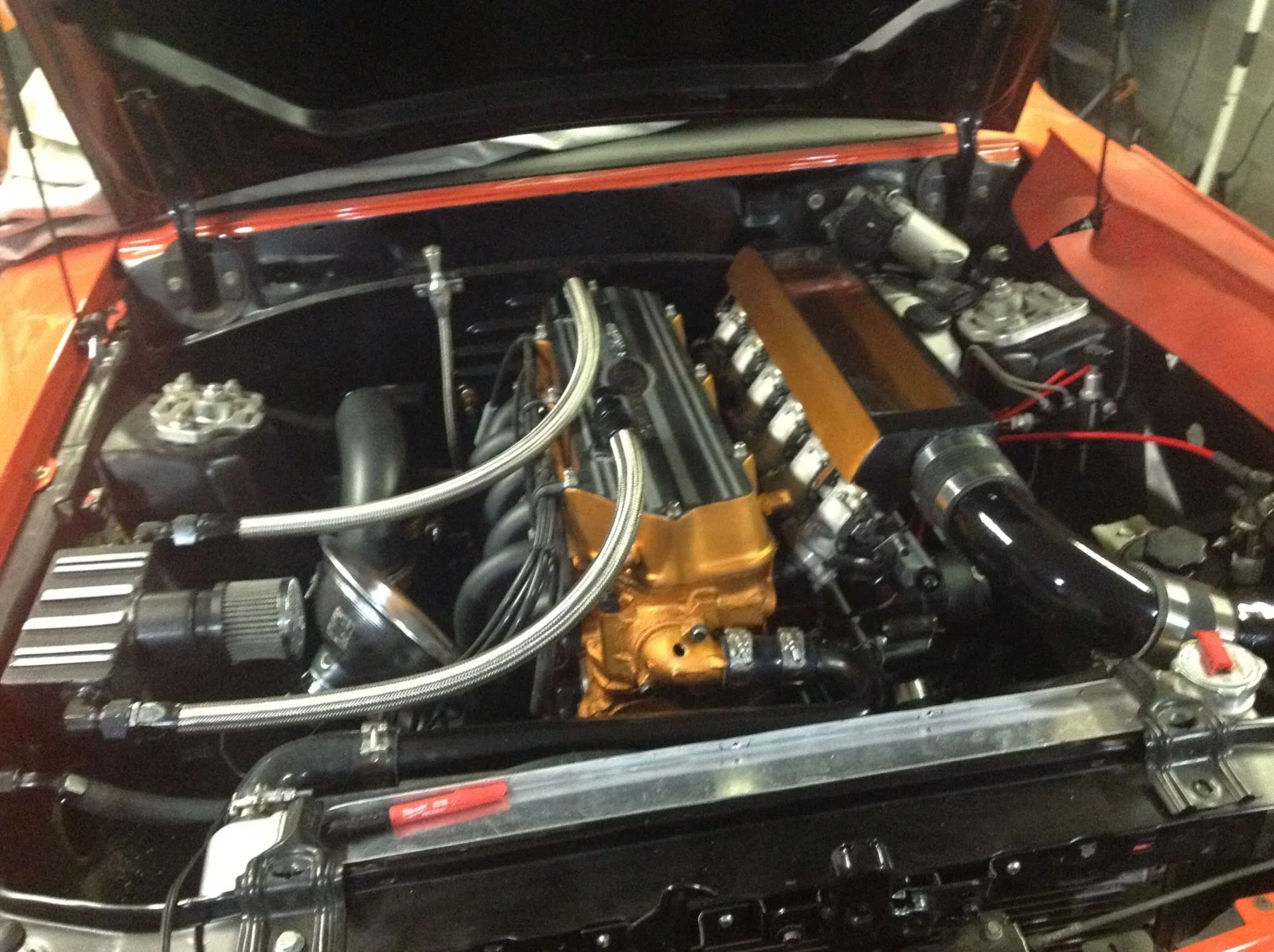

one problem gives way to another.....I planned to put 90* hose end fittings on these male fittings.....
The hood won't close.
So,...as with everything with me,.....I have to adapt.
These things barely get by. One of them is a 120*, and the other is a 150*. I need the 120's, I only have one. I have two 150's, but they're too tight.
I could buy two of these special swivel fittings and they would fit, but.....
They're 30.00 each. And they don't completely solve my problem,....I still gotta get something screwed to the 90 to accommodate the breather filters....

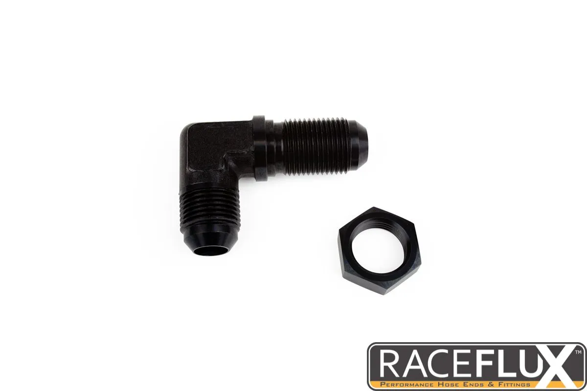

How about on of these? 90° AN bulkhead fitting and use a straight hose fitting??
You may have to trim the long threaded end off some, but it will work. Use an O ring to make it seal properly.

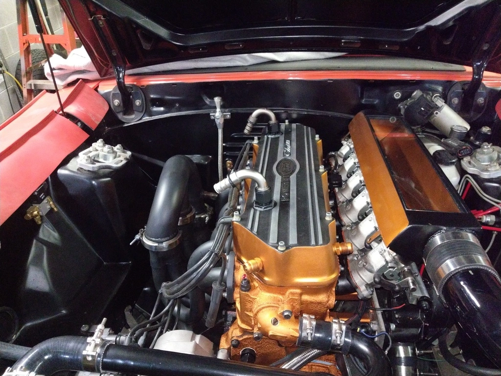

I'm thinkin that I somewhat solved my lopsided issue.
The catch can/breather that had no place but up front when this was a turbo engine, now has several places to go now. In the original location, it hit the hood, requiring that I drop the thing lower. ( which made it a moot point to even consider keeping it there). Originally, I built that contraption so that any blow by oil that made it into the catch can would drain back into the engine after I shut it off. ( that's what the two -10 fittings are for hanging off the front of the valve cover). When it became apparent that I was gonna have to drop the thing because of the contact with the hood, it put the catch can drains lower than the fittings on the valve cover...
Just another case of the multitude of instances where after building something, and trying it out I say........" Well that ain't gonna work now is it?"
(The light that's sitting on the header was so I could see if there was still contact with the fittings.)
Sunday I'm back at it. Left to do is throttle cable V3.0, this time with the new Lokar cable. Still got no idea how I'm gonna secure the pedal end of the cable that uses a tiny little e-clip when you can barely see that, much less get two hands up there to try.
I also have to figure out the BMW tps sensor pig tail wiring, so I can transfer that config over to connect with the weather pack fitting that I used to have on the old setup.
Some bolt tightening, water in the engine, the brakes have to be bled now that the Cobra PBB has been installed.
I gotta see if the laptop will connect to the ecu via Bluetooth (another unlikely scenario, I refreshed my OS, lost my tune file, had to completely reload TS)
