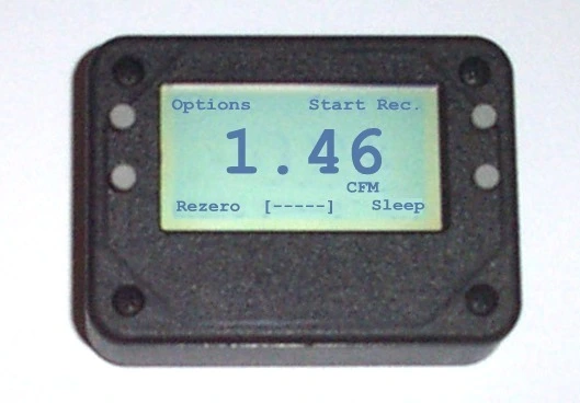

Blowby Recorder
This hand held device lets you display the blowby as either CFM (cubic feet per minute), LPS (liters/second) or LPM (liters/min) without need of a data logger. You can also record blowby for as little as a few seconds or for up to 20 minutes. Then you can playback your data on the Recorder, or download to the free Blowby Analyzer software for graphing, printing, saving, etc.

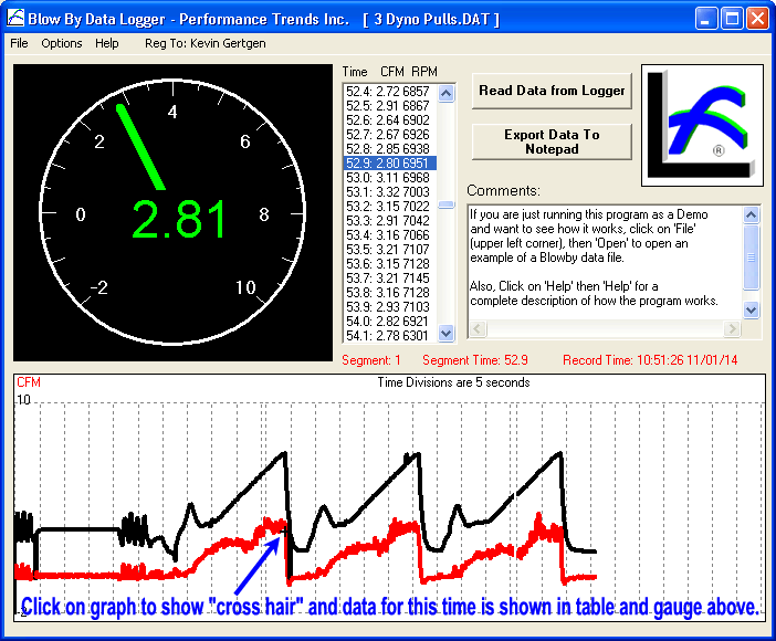

On intial bed in, if thrashed, (an' isa aint sayin' you is thrashin it, but just hyper methematically thinkin aloud if its allowed) .....it will operate like a Water Injection system, or AdBlue scrubber unit for diesel truck thrashed, or like a nitrous system used on the street.
Everytime you use the mid range at 80% TPS, you'll get in excess of 3 cfm blow by, and it'll carry water as part of the cracking process. B y my calc's, 9/16ths of a cfm per piston.
3cfm for a repeatedly caned afternoon of driving (an' isa aint sayin' you is thrashin it, but just hyper methematically...) will make a quart or liter of decant per 1000 miles, easy. Decant settles out, so its total volume will yield much less than that in water an oil, but you get the idea. If the engine is okay mechnaically after its bedding in, it won't make more blowby.
People need to understand....its only when you use an engine under its mid range load that it makes blow by.
I'd by the blow by detection kit. Unlike a Supercharged engine, a trubo always works the rings out because at cruise and under boost, the variance load is externally 1.6 times what it is at cruise. Supercharged engines are always more constantly boosted at the manifold. The "comming on the boost" is a turbo thing. It loads the rings, and the amount of remaining engine life is a function of the peak blow by, it can be very accuratley defined. In Tuning British Leylands A Series Engine, the 2ND Edition book, DV said that peak blow by from valves and pistons collectively defines remaining engine life.

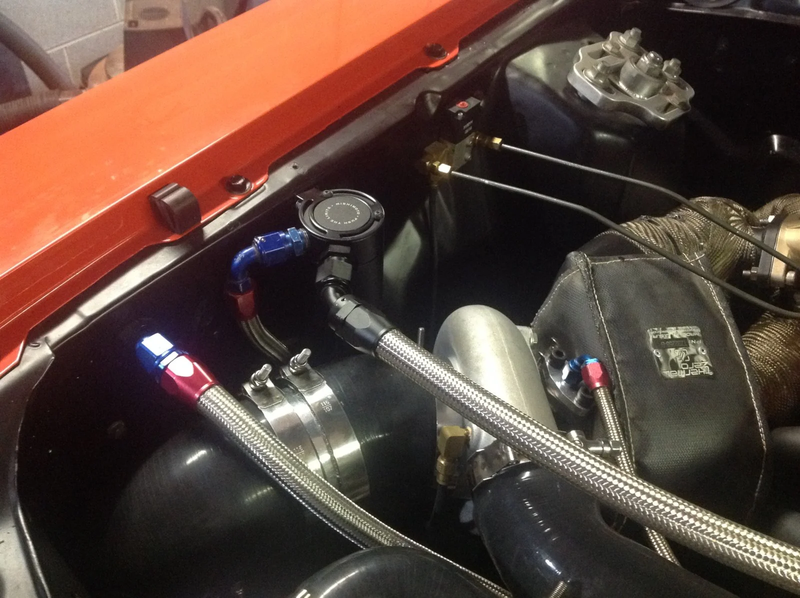

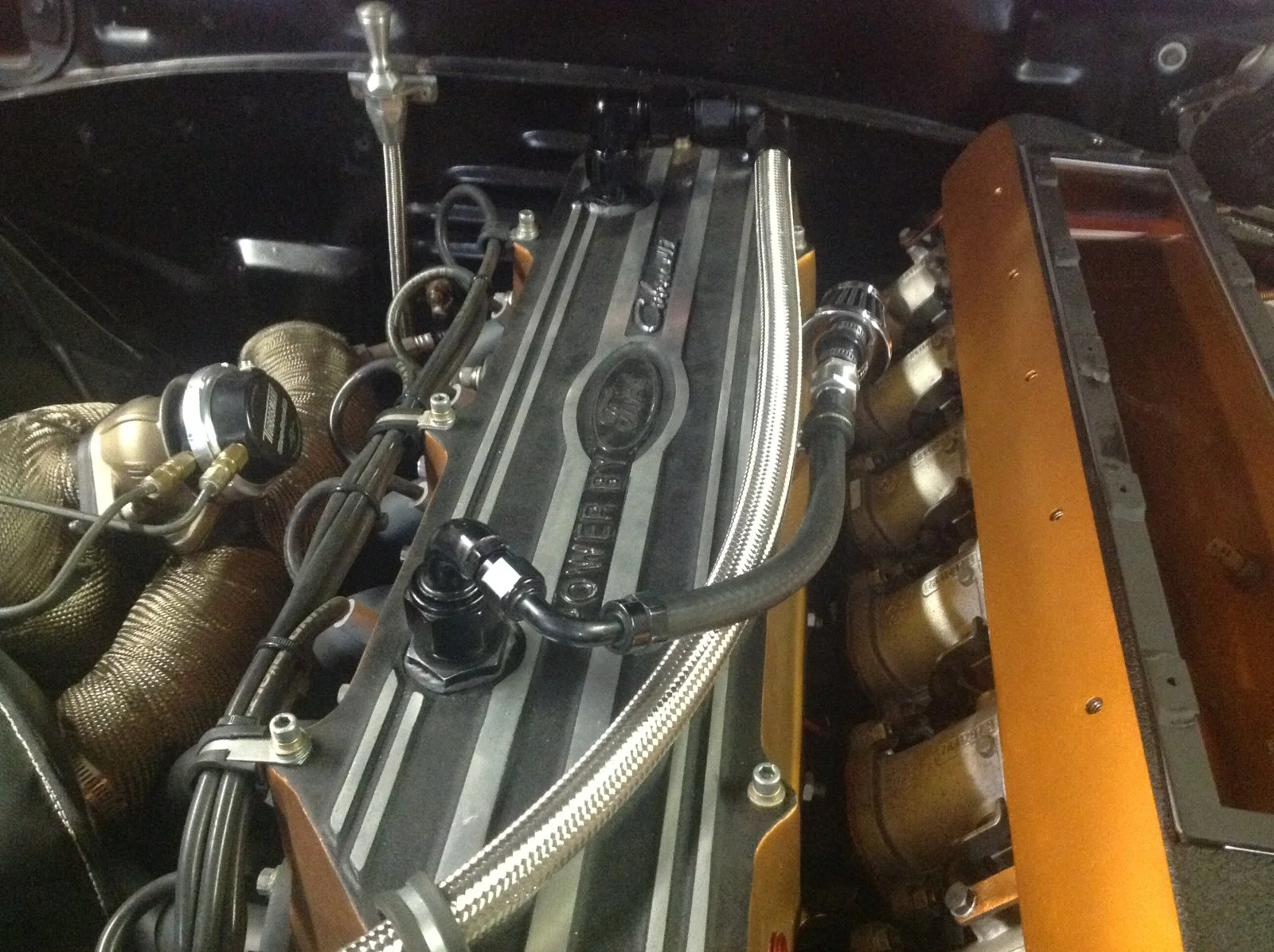

That ricer part claiming itself to be an oil/water separator is installed....kinda.
It's freakin tiny. I plumbed a -10 hose from the valve cover into the "in", and a -8 from the "out" that is now plumbed into the intake air tube in front of the turbo. The other fitting on the valve cover has a -6 running to a check valve that will not allow blow by to push out, but will allow negative suction to have a "relief valve" of sorts to ensure that I won't suck a gasket while cruising, or any other high vacuum situation.
I put a fitting into the bottom of the thing where it was plugged with a pipe plug. I'll run another -6 line to a small jar of some kind so I can see how much oil is passing into it.
we'll see if that thing doesn't end up in the trash.

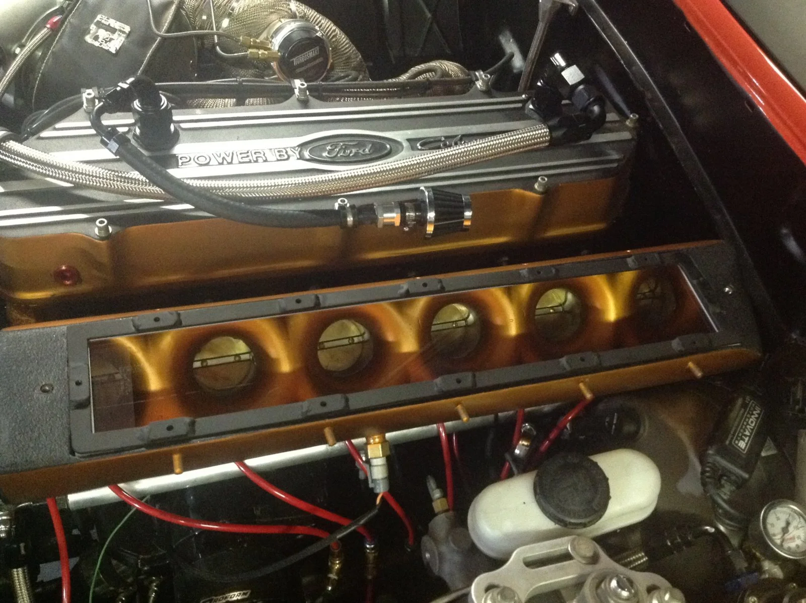

The air box is painted....and like I said earlier, is waiting on paint to dry. I'm gonna have to reserve my opinion on how this thing is gonna work, because I haven't used the actual glass during the mock ups..

For your consumption. ( even though the freakin paint isn't dry on the retention straps)
There now, satisfied?
Even the frame itself is still wet a little, so the finish will have to wait. ( besides, I got no little mason jar yet that will serve as the remote reservoir)
eventually, I'll get a black hose end for the other end of the catch can, as that's ratty red/blue junk will have no place under my hood. Whether or not I need it, I added a check valve to the other end of the valve cover that will not allow crankcase pressure out, ( it'll all have to flow out the other end) but will let the crankcase breathe when I'm cruising. I don't know if that logic makes sense or not, but I'm goin with it.
The box is so tight now I gotta almost jam the damn thing down on top of the tb's....ill not be worrying about boost leak there. The glass is protected from damage by thin aluminum strips that the preload screws would potentially cause,... And the whole damn thing is a semi-permanent solution...only in case of catastrophic failure does it need to come apart.
