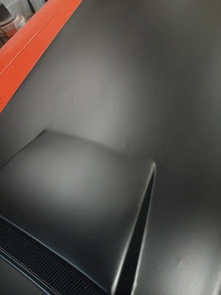

The hood bubbles are my fault....It probably happened as a result of running an unwrapped hotside within inches of the hood paint..
This is what the bubbles look like..
It's no wonder....

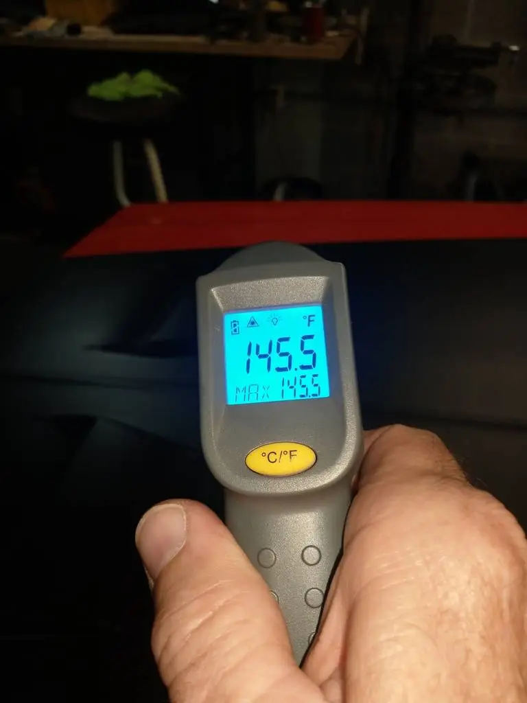

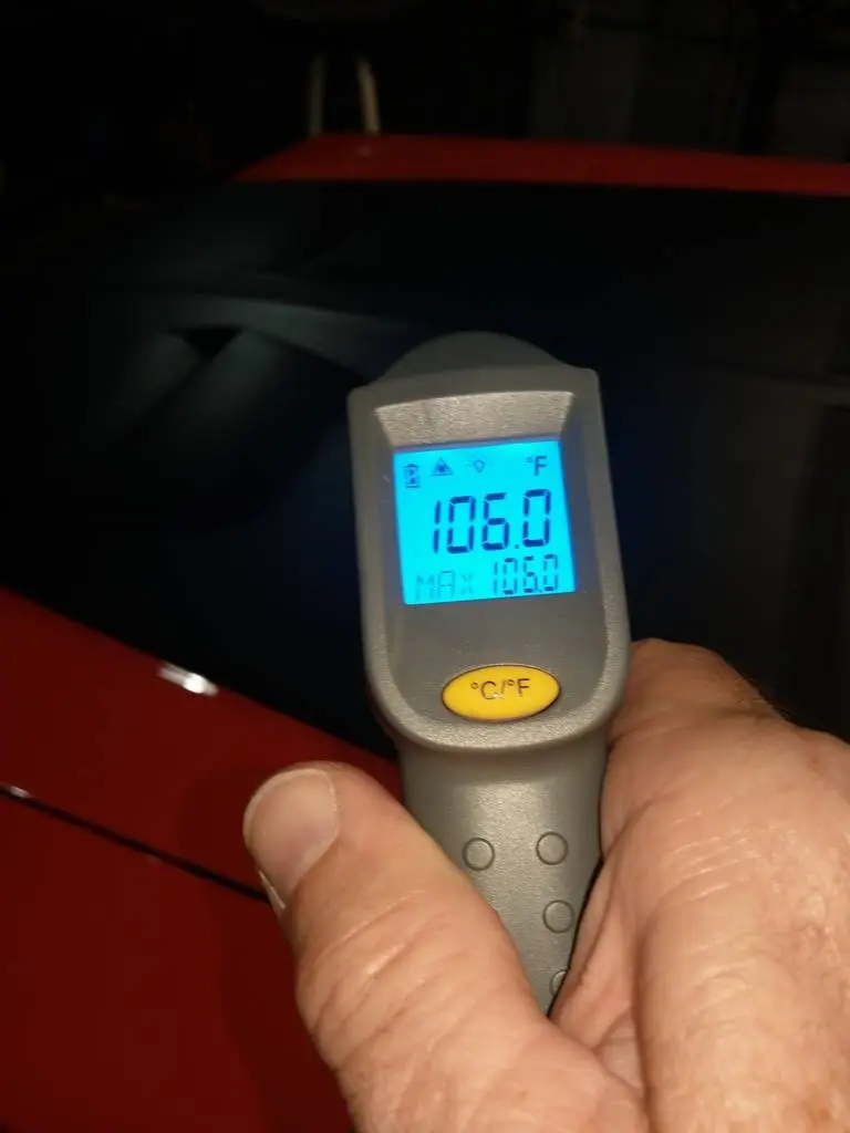

Now that there is a wrapped hotside, and only after running the thing at idle last night,...look at the temp difference.
Hotside,.....
cold side...
