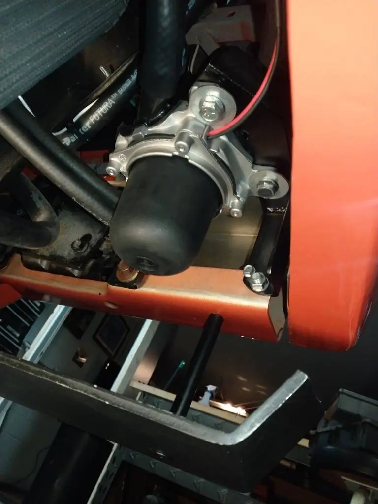

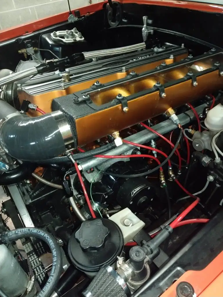

I installed the new filter and restarted the car...oil pressure reading 60 psi at idle. I shut it off, and installed the Camaro vacuum pump..( took all freakin day) I followed the example that was linked earlier in the thread. The way I've wired it, the vacuum pump only comes an when the engine is under boost. I ran a fused circuit directly off the back of the alternator to a 30 amp 4 pin relay. According to the guy who tested this pump, it'll pull a whole whopping 4" of vacuum at 12v, and 7" at 16v. So, at 13.8v I'll probably see 5 or so.
Better than nothing.
The line going to the pump has a tee in it now, and I've ran a 3/8 line with a one way valve installed in the middle. As soon as there is positive pressure in the air box, the valve gets blown closed, and suction reverts to the pump,..when the engine goes back to negative pressure, the pcv valve will allow engine vacuum to pull crankcase vapors through the oil water seperator.

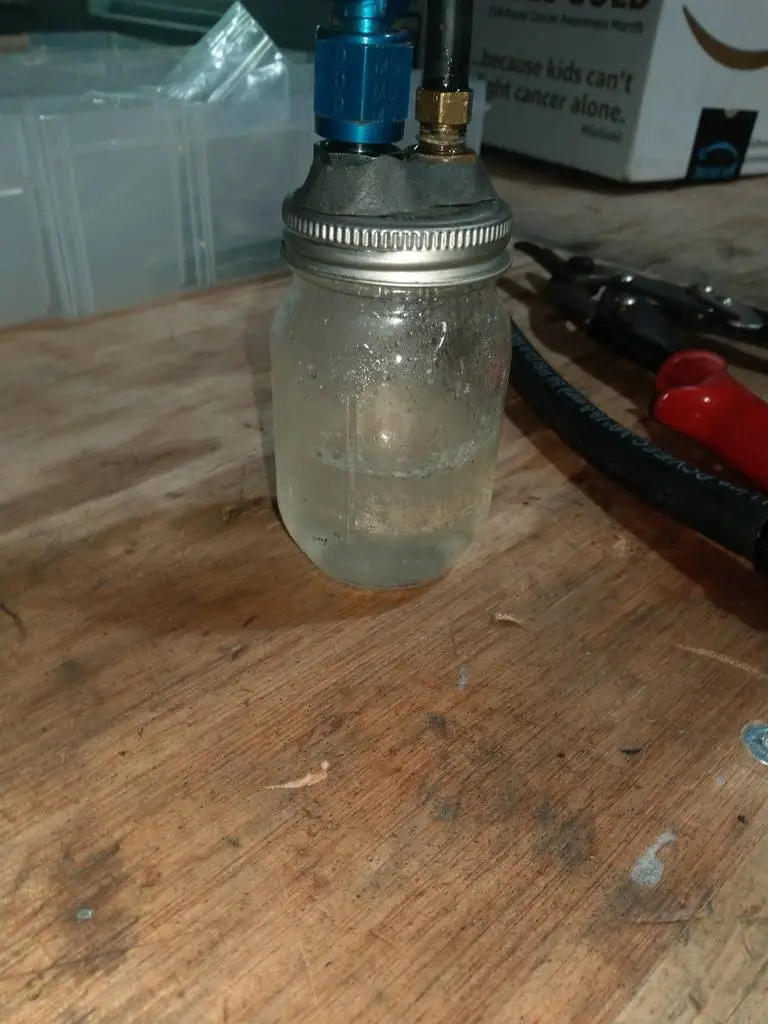

The goofy seperator is working perfectly...wicking this much water out of the crankcase just in the hour or so run time since in

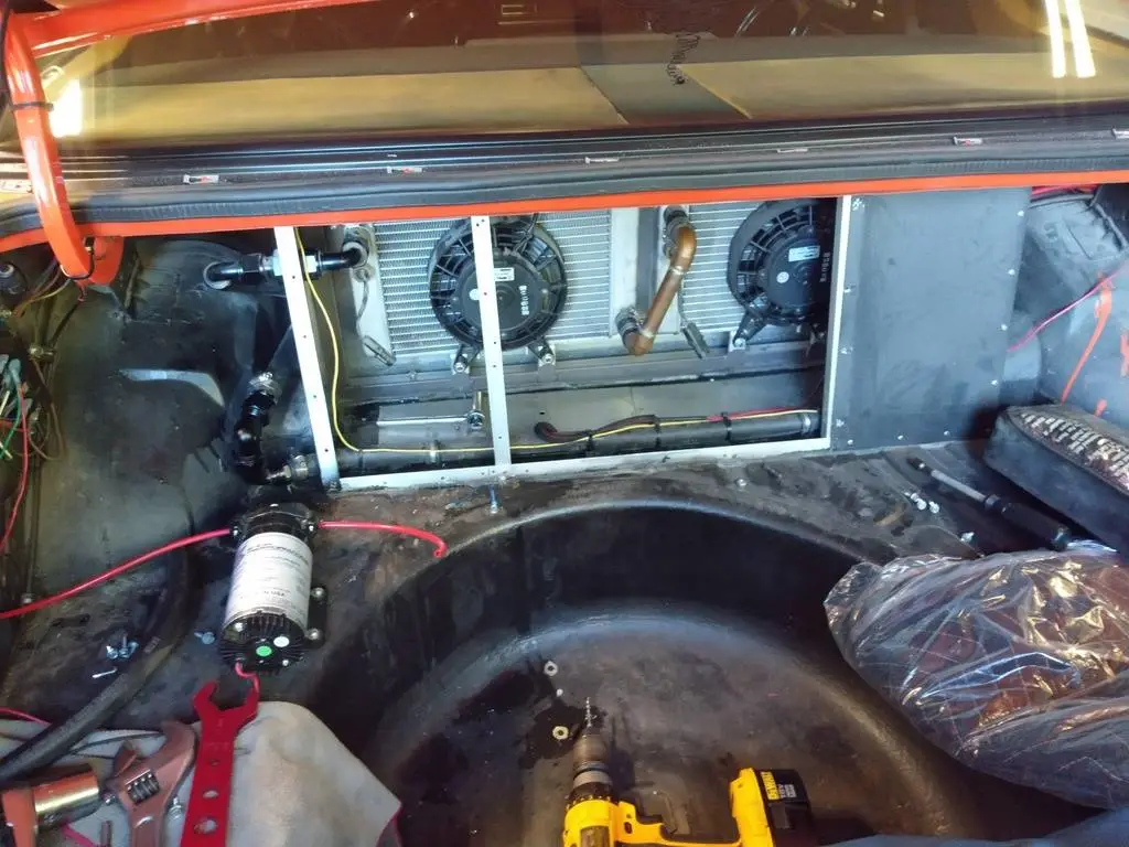

I decided that I would make my life even more complicated by running coolant under the floor via two -12 hoses, and into the two linked radiators that are installed behind the little Japanese Kid. I was able to find a fitting that I could unscrew a hose off of, and dedicate that fitting as a supply source for the rear radiators, the hose that used to go to that fitting only needs a union so that I could couple the return hose back to it.
That was the easy part.
I cussed for about an hour while I resecured the hoses to the 10-24 screws that were still hanging out of the bottom of the floor.
How I did that the first time w/o blowing a blood vessel in my brain is beyond me, but this time I got real close to doing that. The stupid screws spun while I tried to tighten the nut down. 4 of them eventually tightened, the 5th one required that I remove the carpet, cut a small hole in the dyna mat that was on top of the screw so I could get a screw driver on it, and finally tighten that btch down.
Once I finally get every thing buttoned up...I fill the car back up with anti-freeze, and run the pump in TS to suck the water through the lines..
I check for leaks......none.
I start the car and let it come up to temp,..it's now apparent to me that I need an additional fidle valve to let more air into the engine to sufficiently allow it to run fast enough to support the additional drag the AC compressor adds.
( I know this because I pulled the line off of my BOV,..and the increase in RPM is just right)
But not yet....I got a plan for that.
The engine slowly creeps up to temp,...I'm waiting for it to get to 190 so the t stat will open, and water will move through the whole system...No sooner does it do that however, and the now 190+ degree water moves to the rear radiators.
And..
The 8 pound radiator caps opened like check valves, and just started pissing green pee straight out of their respective overflow tubes.
And both radiators are sealed inside an aluminum shroud...
How much more perfect could this get?

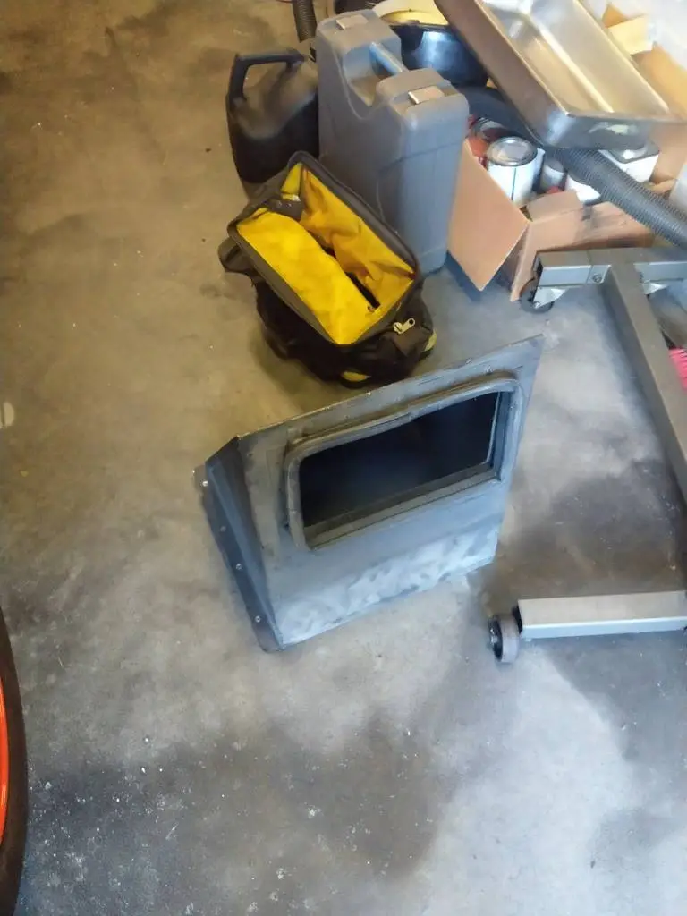

But by the time I get back, its 5 pm,...and I'm done. I got no desire to play in the wet anti-freeze that's now everywhere,..so I throw a bunch of rags on the floor, take a couple of pics,...put my dinner in the oven to cook,...and sit down here and write this.
I had to drill out about a dozen rivets, and remove the center section to be able to get to both radiator caps.
I got what I need now,...I have both caps, and access to them...what I don't have anymore is a dedicated circuit to turn the fans on...I used to have two wires back there to run the old intercooler pump, and the fans, but now I got a water meth system back there that needed both wires, and had to have a third wire ran for the warning light.
So,.i gotta pull another through there and hook it back up to one of the switches currently in the dash.

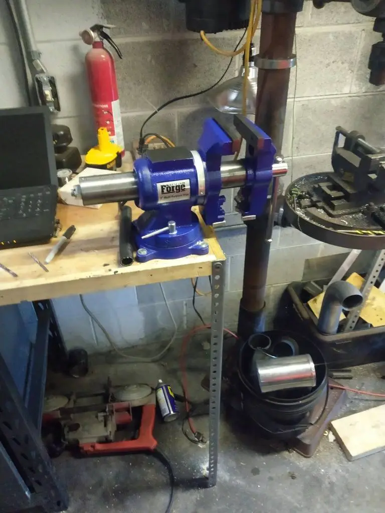

This all started early this morning, with me driving to Harbor Freight to finally purchase a new vise. I have been using the drill press vise for everything since I got here to this house,..and today I decided to change that.
I believe this'll do pig,...this'll do.
