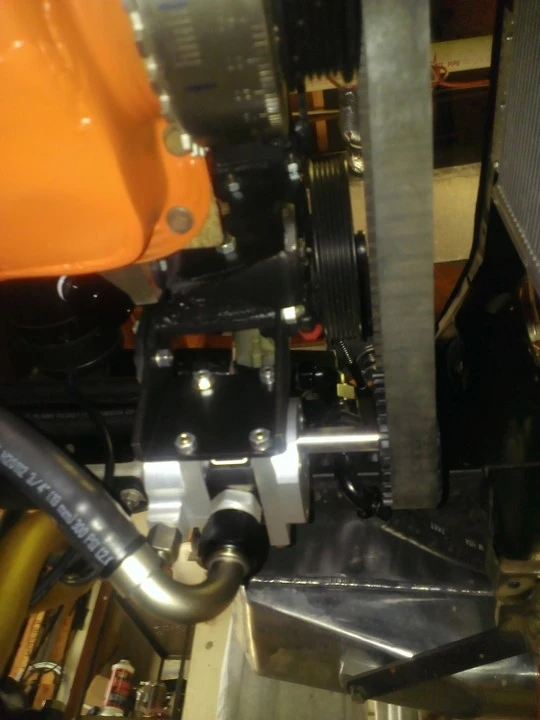

Yesterdays update said that the belt alignment was wrong, and the pic clearly shows that it is. What looks like the belt is too far forward is actually the nose of the gear being too low.
I removed the bracket, and ground off one of the two tack welds so that I could twist the thing up to align it. I need to do a better job of with that tack weld, because I did in fact twist it, and you can see that the tack is starting to fail because of that. Let me tell you, if that tack fails, and I lose all that I have, the roar that'll come out of my mouth will be heard in Canada.
So that that won't have to happen, I'll just add to the tack tomorrow before I bolt the bracket back in place for final alignment.

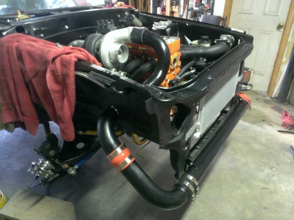

All of my couplers came in this afternoon, so I changed gears again, and returned to the cold side completion. The dilemma was what to do w/ each cut end of the tubing to keep it from slipping out under boost. I was gonna weld tabs, and strap the splices together ala-dragcar, but that was more work than I wanted to commit to. I attempted to weld a ring around the end of one of the tubes, but that took forever, and I hated it when I was done. So, in the end, and in the simplest form possible, I took a crescent wrench, closed it tight against the wall of the open end of each tube, and slid it onto the end of the tube 1/4". Then, working around the tube, bent a simple flare at the end by "nibbling" one little bend at a time until I got completely around the end of the tube.
Took about 1 minute per end. Ten minutes for all.
Then I painted the things in a high heat black, and coupled the things in place permanently.

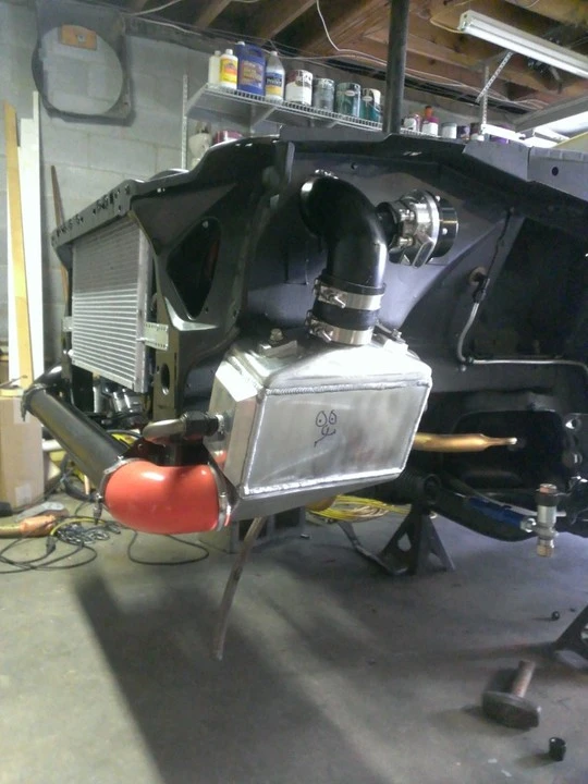

I got to the IC side, and completed my BOV installation. Another Chinee piece from Godspeed, we'll have to see how this thing works and sounds.

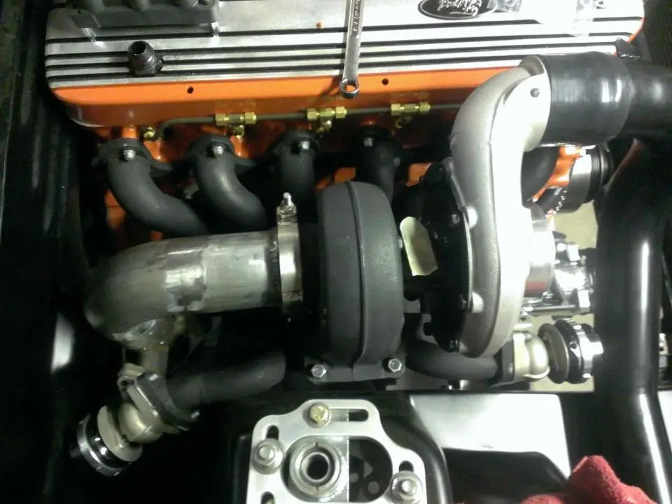

Once all of that junk was done, I moved to the wastegates, and the hotside. At some point during the welding/ baking the holes that hold the waste gates on got way smaller. I had to run a tap through them to get them back open big enough to get them to bolt up.
Loosely bolted on till I get the downpipe finished. That'll be tomorrows work.

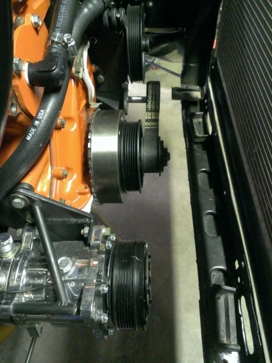

Interesting - no side flanges on the oil pump pulley. I would have thought that would be standard equipment.
I just did a Google search and found out that to prevent problems, the two shafts in a Gilmer belt setup have to be absolutely parallel. It seems that if the alignment is off slightly, the flanges cause the edges of the belt to fray.

The crank pulley is the guide pulley. It has the side bolsters to keep the belt on. To tell the truth, I expected the OP pulley to have one as well, but I guess it makes sense that the belt runs true, and since it can't potentially walk left or right (w/o shredding) then you only need the one pulley guiding the belt.
