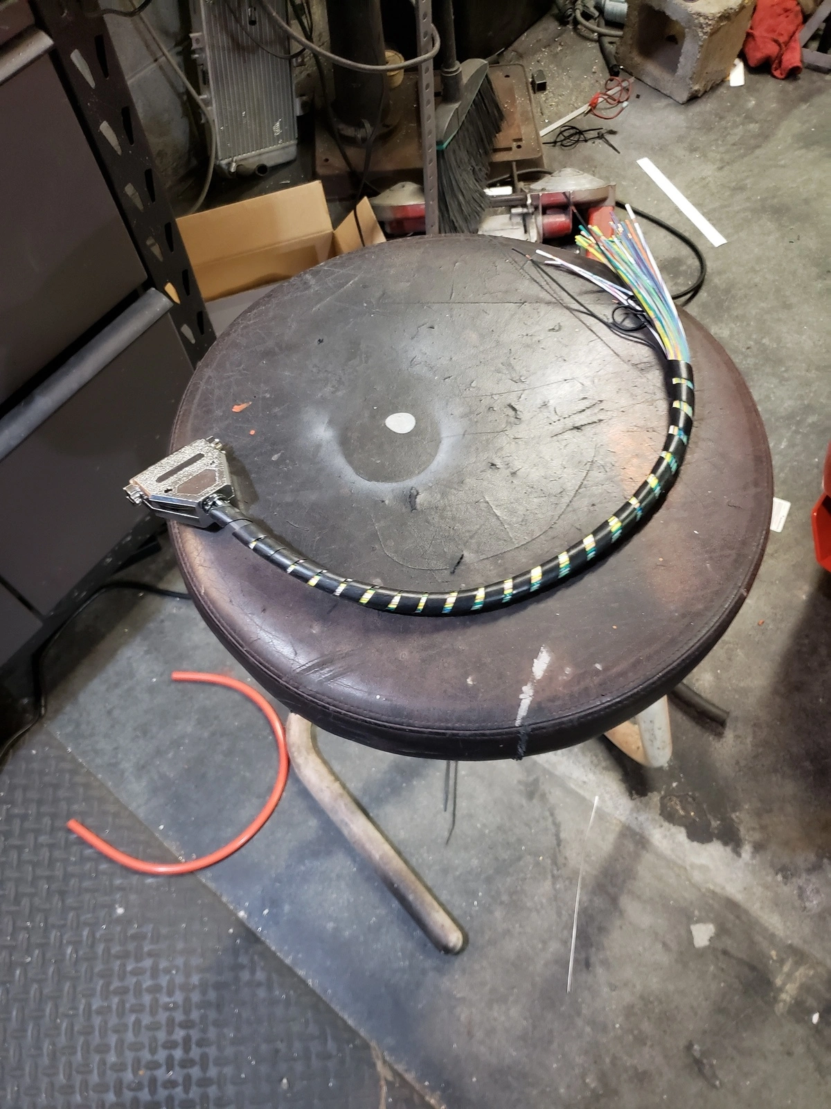

Got my response from diy auto tune. The guy must’ve been a new guy, as he was excited to respond to me. I got my link to the ms3x pin out for the db37 cable that I’m going to build, now I’m excited. I got this ant killing mega-magnifying head set that electronic techs use that make my eye balls the size of base balls,...and I’ll wear a set of 2.0 readers under that.
The soldering iron tip will look so big, it’ll look like a WWII Zeplin is flying above my circuit board.
I can’t wait!!

Oh please share, I'm just about to do this myself

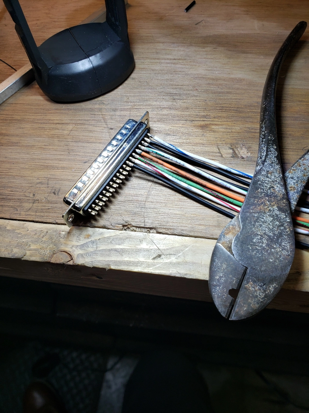

I'll tell ya...building that db37 connector ain't for the tenderfoot when it comes to soldering. The pins are damn close together,. It's not so bad up until you get the first 19 soldered, but when you flip that bitch over....things get a little more complicated.
This seemed easy...for the first 19 pins..
But, as expected with me, I flip the thing over, and start in earnest. I solder 20, 21,22,23, all the way up to 35..... Then, as I'm almost to the end,....iI go
" What tha?....there's sposed to be all yellow wires on the end, but now I got two yellows and a green n orange one....where the hell was this sposed to go?"
Pin 26...I gotta unsolder 9 wires, put then out of order wire in pin 26, then put back the rest of them into the goob-u-lated pins that remained..

Again,..I managed.
I have to check the pin integrity to make sure I haven't shorted anything together,..( I didn't) before I pull the old ecu, and do what needs to be done to upgrade the thing to ms3x.
This took almost two hours..( partly because I'm doing stuff over) Kate got home just as I finished, and my continuity tester is dead, so,...this'll be another day.

Somebody looking at it may wonder why the pigtail as a prequisite..
So to answer that, I'm anticipating being able to swap my main board over into the new box, add the 3x expansion card, put the box together, plug the existing relay cable into the main db37, and plug in that harness to the 3x db 37. I I'm hoping that I'll be able to do nothing else, and be able to start the car. I'm hoping to be able to do nothing else, and have my laptop hook up to the ecu via the Bluetooth adapter currently on the MSII.
The pigtail harness is for the future...it'll be there so that I won't have to do a damn thing except hook wires to it from whatever thingy I need to get input from, or control.
But then, ...I could be wrong.
And as a footnote to the footnote ..the notch cut out of the non-insulated diagonal cutters that I've had since 1990?
That don't work for sht, and I should throw away?
That's what happens when you cut through a live 110v 40 amp circuit in an old ased house with fuses.
