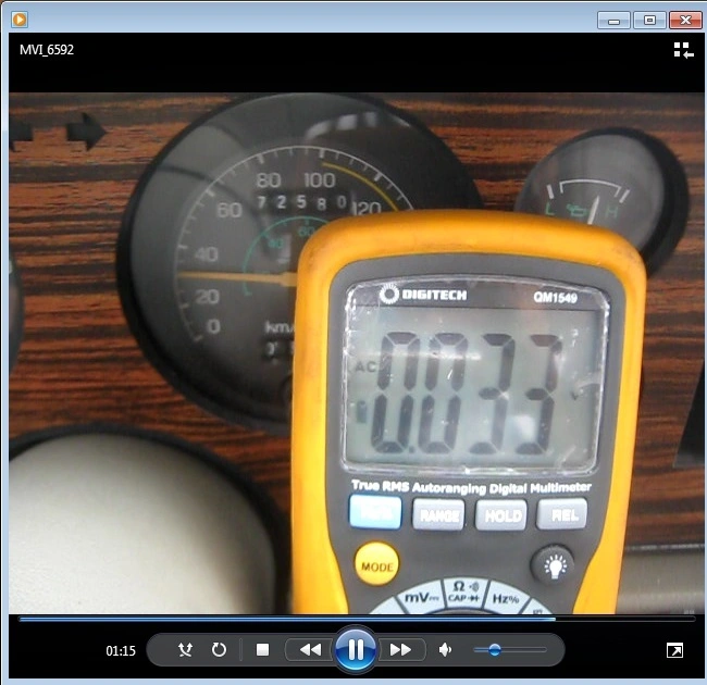

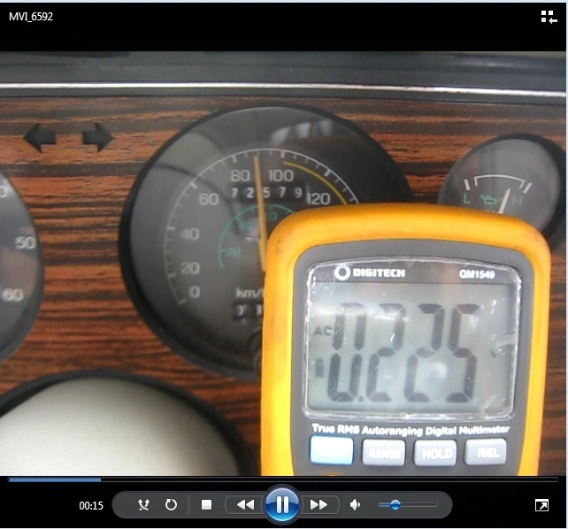

I jacked up my car, and ran the standard Hetz, A/C Voltage and Ohms resistance checks from zero to 62 mph, with my metric speedo registering in KM/H. Note that there is no voltage going up to 32 km/h or 20 mph, but once invoked, the voltage can be recorded right donw to zero, so there is an interesting voltage speed, Hertz resolution
0 km/h, 0 mph 0 Hz, zero volts AC

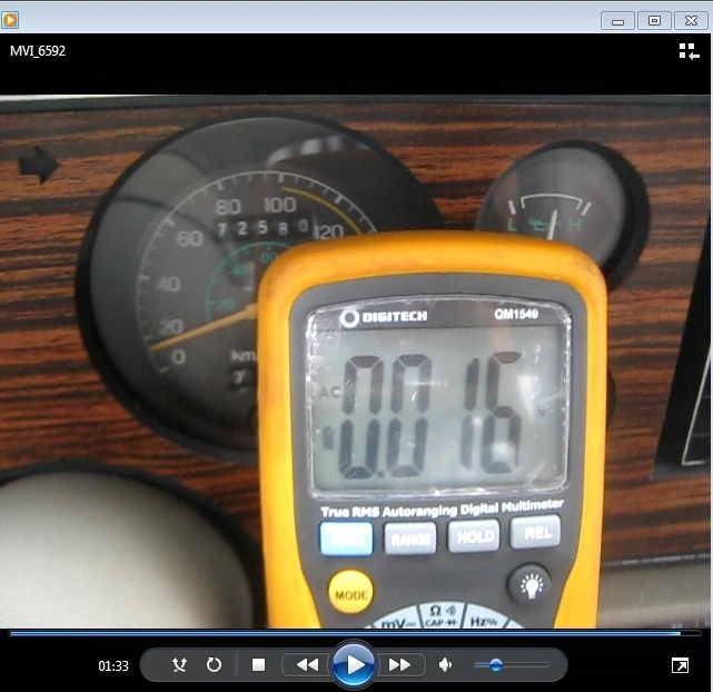

12 km/h, 7.4 mph, but 0.016 volts AC on over run
See picture
20 km/h, 12.4 mph 0 Hz, zero volts AC
30 km/h, 18.6 mph 0 Hz, zero volts AC, but 0.033 volts AC on overun
See picture
32 km/h, 19.9 mph 0 Hz, 0.00 volts AC
32.2 km/h, 20.0 mph, 0 Hz, 0.019 volts AC
40 km/h, 24.9 mph 0.056 volts AC
50 km/h, 31.1 mph, 0.083 volts AC
60 km/h, 37.3 mph 102 Hz, 0.109 volts AC
70 km/h, 43.5 mph, 0.149 volts AC
80 km/h, 49.7 mph 0.186 volts AC
88 km/h, 54.7 mph 125 Hz, 0.223 volts AC
See picture

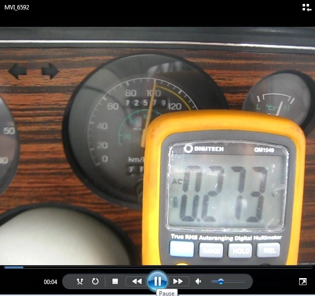

100 km/h 62.1 mph, 0.273 volts AC
See picture
The square wave form kicks in after 19.9 mph on the upward rise, with zero Hertz cycles per second on my Cat IV multimetervoltage and the voltage increasing steadily from 20 mph on upwards.
The on the decilne after 20 mph, it records right down to 7 mph, assumably for the one Speed Desnity AOD car that needed idle speed control...

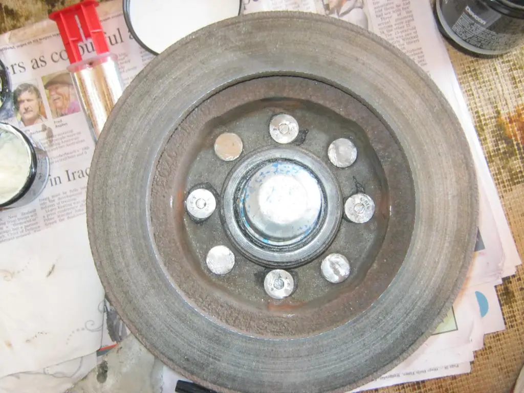

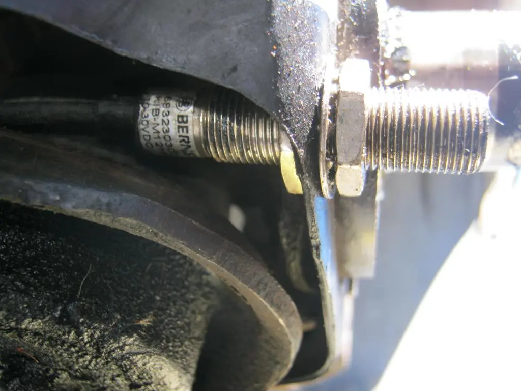

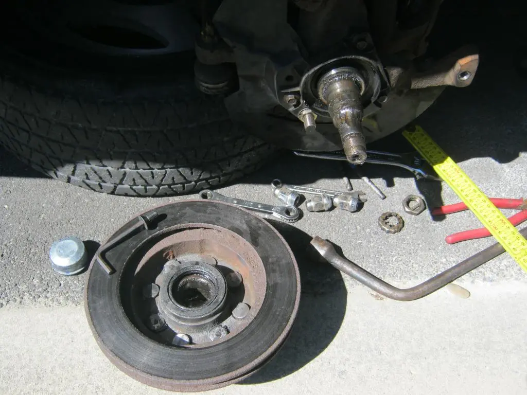

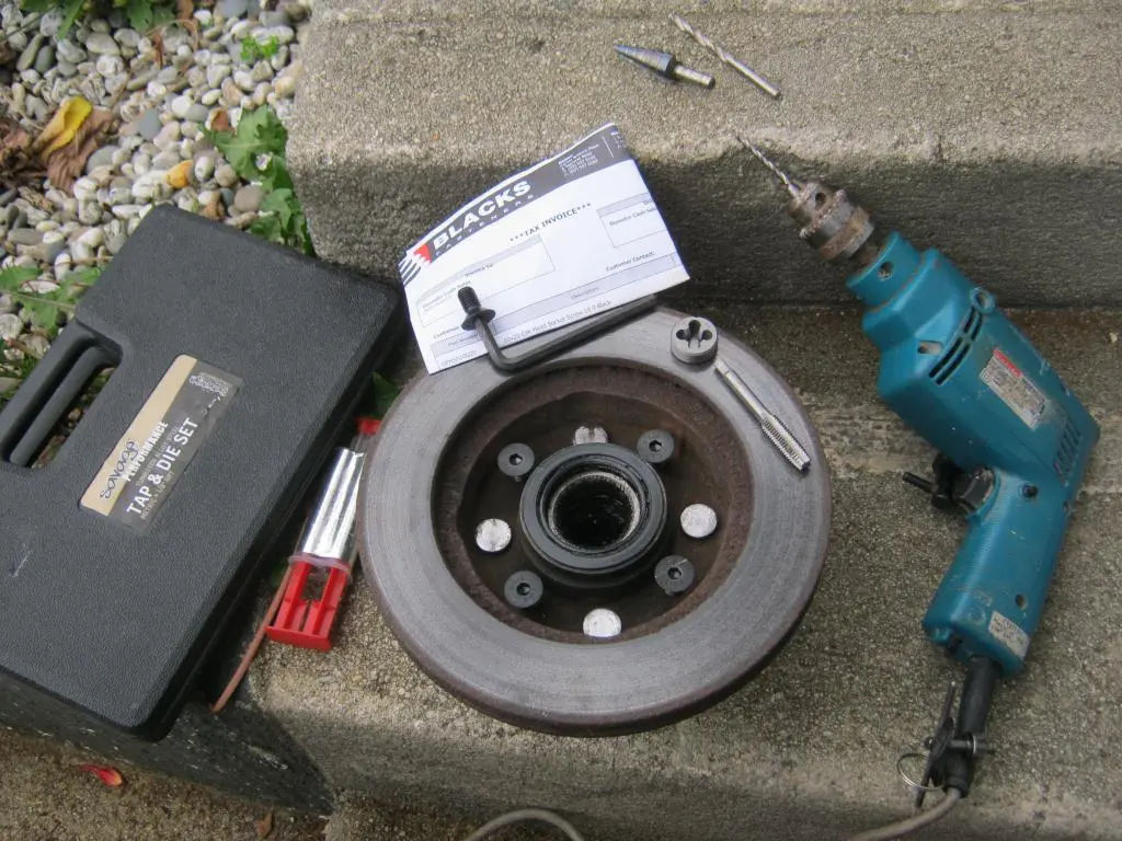

Well, I've tried to make the Fox VR sensor work, but its designed for other purposes Ford engineers had in mind in the late 70's, not for a roading technician's list of must haves. I was hoping that the 8 plips per revolution reluctor would allow a square wave form logging down to "stop start" walking speed, as required by Autocross Halda, Brantz and other Route position meter. But it doesn't. There are other speedo pickups that do, the Fox system isn't really difficult, but I wanted a truly digital solution. Ford system is half digital, half anologue, and it hasn't helped me.
I had no choice but to set up another Bernstein proximity sensor, and JB Weld/Devcon expoxy in four extra M10 30 mm long set screws with the hex head filled in with a cut down Allen keyhead Arildited to the set screw.
Mr Bernstein, JB Weld, Mr Allen and Mr Tu Pack Araldite® from Selley's Australia saved my life
It was a lot harder, I thought I could just drill four holes, and run an M10 1.5 MM tap and die through it, but there wasn't enough metal to do it.
The requiremnt I have is to be able to log distances of 9-1/2 inches along the road, and with a four stud wheel and 77 inch rollout (loaded) 190/65 390 tire, I can get down to only 19.3 inches with four studs, or 15.5 inches five stud.
I can't fit 10 studs on the inner wheel pitch center diameter, so I'm stuck with 8 3/4" bolt heads on a 108 mm 4-1/4" PCD, and that's going to have to be used when I go Five stud as well.
I'm scratching my head on how to make a 10 bolt even spaced sesnor ring on the back of a five stud brake disk...that's my next project.

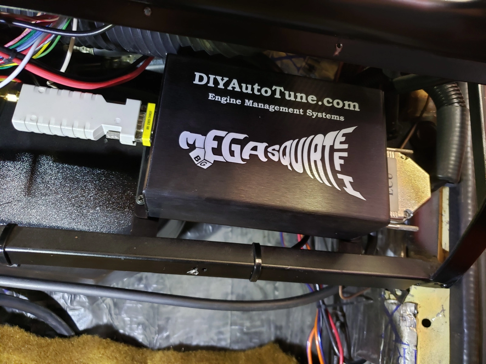

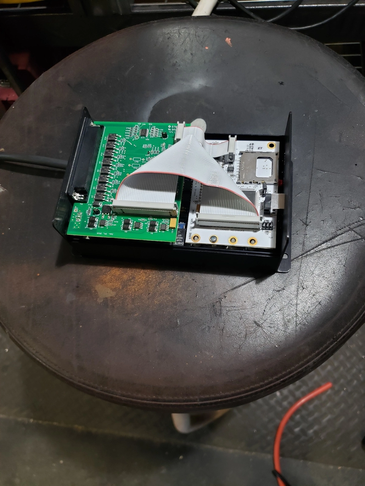

The behind the scenes goings on has Steve figuring stuff out now. Converting over to 3x from a DIY built ms2 wasn't even the least bit hard. All you have to do is unplug one board with the main processor on it, and plug in the new ms3 board in place of that. Secure it with a couple of supplied screws, and add the 3x expansion card, which plugs into the newly added ms3 daughter board. Then slide all that junk into the bigger case.
The "hard part", the "scary part".....is bringing it to life.
You have to create a new project file, and you have to install new firmware to the latest ms 3 release ( because your tune/config was ms2 based, and now we're talking a little different, and much faster) .......And, in order to do that, the thing has to be plugged in, and powered up.
So,..fuel,...spark,..injection, fans, pumps,....,...they're all powered up with no programming telling them what to do......
Or what not to do.
Steve wants to know if I have a way to turn off all of that stuff, and just have the ecu powered up so that fans won't run, pumps won't pump, coil packs won't fire, injectors won't click, and my precious EDIS won't somehow overheat.
Uhh,....Nooooo,.....I didn't plan to ever have to turn off any of this sht.....it all needs to run.
"Ok then,..We'll just have to go with that then he says, but after the firmware upload is complete, a bunch of stuffs gonna probably start happening"...
Perfect..
The good thing ( According Obi-Wan VanOrder) is that the firmware upload process has been upgraded along with the hardware, and was now do-able from the PC. The other good thing was that my Bluetooth connection worked instantly, and made all of that techno-stuff possible whilst I was sitting at the workbench where I built that thing.
The bad thing was that after it all uploaded, and the required power cycle took place,..the fans started running, and I get a conflict warning saying something to the effect that one of my outputs was conflicted, and I had to correct that in settings before going on....but it didn't mention the fact that the damn fans are running. ( and who knows what else,...you can't hear anything while the fans are running)...
So rather than hold my hand, he takes the current tune home with him...saying that he'll have it back to me in a few mouse clicks sometime today....and not to worry...
But you gotta understand one thing...this is me we're talking about here.
Me? Not Worry?!! Pfffttt!
Let's just say that I'm not gonna put the top on the ecu, or even attempt to secure the thing just yet.

well,....It runs.
Perfectly.
The take away is that this kinda sht makes Steve like a little kid in a toy store. The whole time he's looking at the tune file, he's looking at the capabilities,.... He's sayin stuff like "Oh my God,...Wow,...That's is fckin awesome,...Man, I'm jealous.
I'm all the time thinkin..."I just hope it runs right."
It does...Just as it always did. Only now I can do super human sht..............evidently.
Lets recap shall we?
One week ago I cut my finger off, and put it back in place w/ steri-strips and a CVS splint.
Today,...I'm on the path to a full recovery...Albeit w/another gash that'll tell all the ladies, that I'm good at working with my hands
The MS2 to 3 X is behind me, ...what ever I was worried about was completely unfounded..
** Dont believe that for a second.....This car would not have ran after this upgrade...The fact that I had to use unorthodox outputs to run the common stuff caused several conflicts with how the MS3x wanted to do it...It had to be told that there were these "band-aids" in place to make this thing work.
But it works great, with endless potential in front of me....So nothing left to do, but tuck him into his little cubby, and cover him back up until that time comes when I get it rolling, and thoughts turn to,...........15 psi.
The final footnote before I go get something to eat, and start working on the trunk, is to recognize Steve for his selfless help.
If I wasn't such a prick I'd say that this place is full of the best of the best, and Guys like Steve, Dave, Nick, and quite a few others that prove that this is the best collection of guys that you can get.
Except the fact that I'm here too,........and there is that "prick" part still........So I got that going for me...............................................Which is nice.

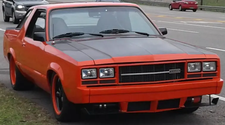

Somewhere back a million pages, there are some photo-shopped images of the hood on the car in different colors, so I can decide if I want to try all black, all orange, or some combination of the two again. It's the same way for the trunk for me.
Thinkin' maybe all black this time, with only the front edge above the grille orange, and the rear edge of the trunk the same way.
Maybe.
Like this, only maybe just the hood gets the black with just the front edge staying orange.
