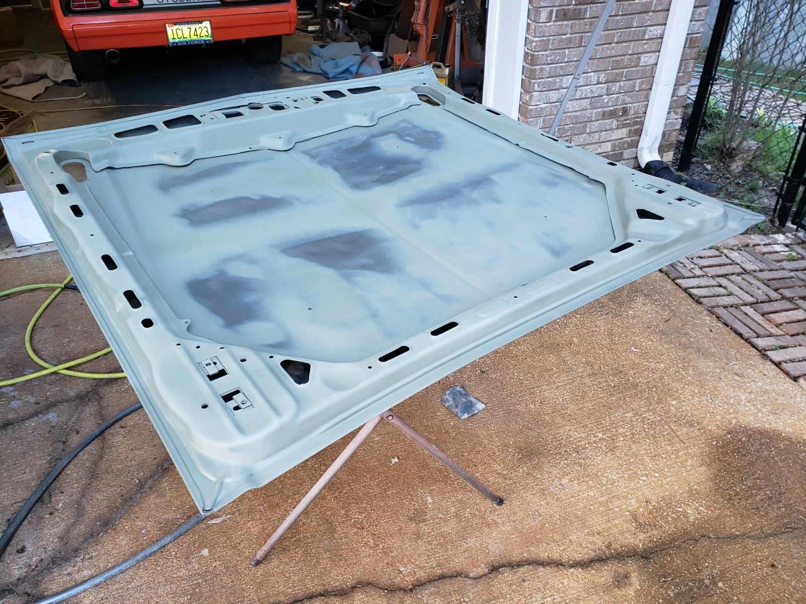

The bottom of both the hood and trunk are now in rattle can etching primer.

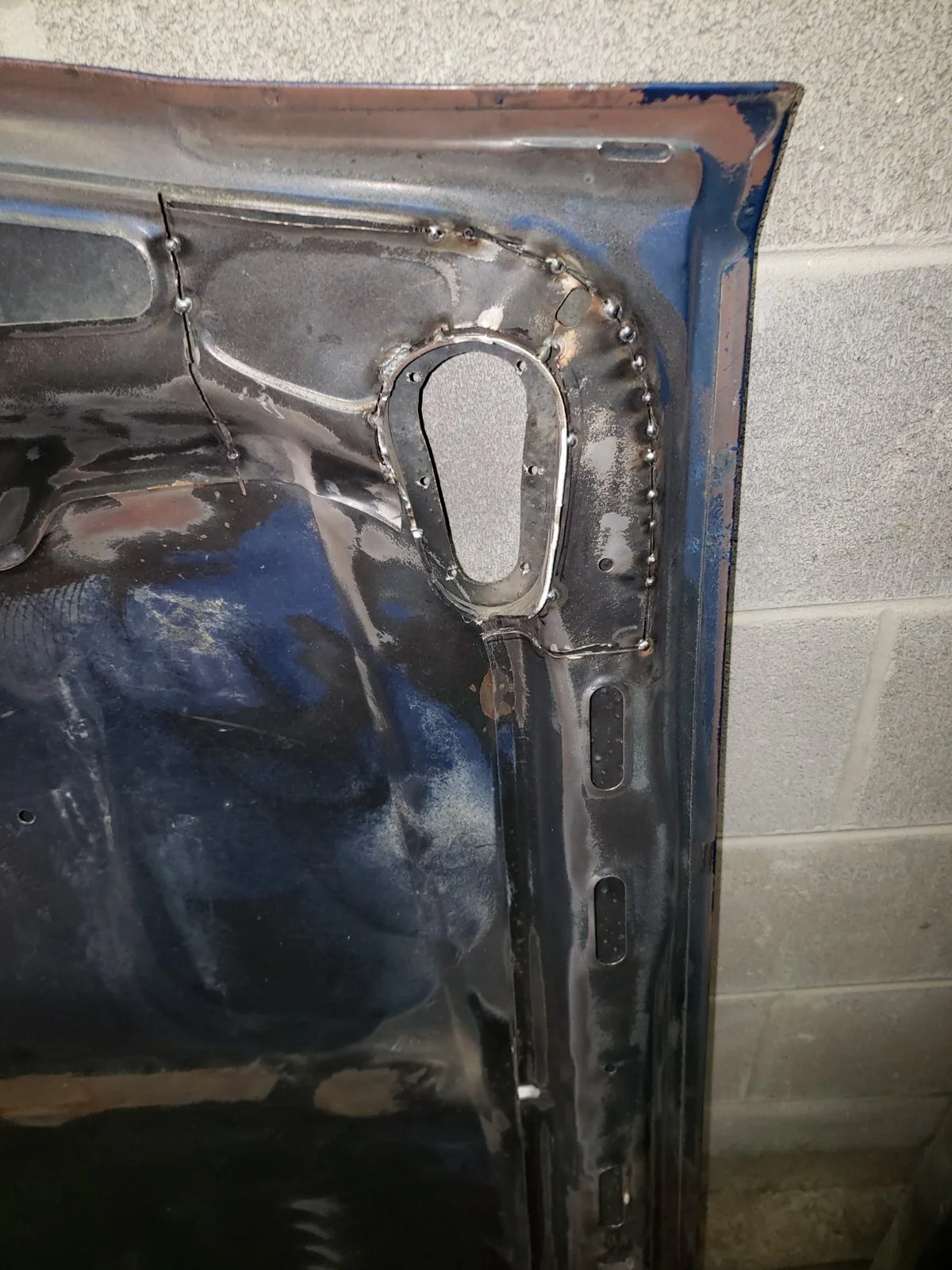

Remember, I decided to ditch the hood latch in favor of using aerocatch fasteners instead...
After cutting the area out so that I could cut the hole properly, I had to tack the old metal back in place.

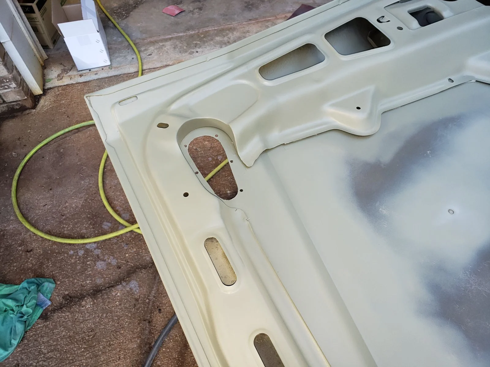

After a bazillion hours of grinding, and fixing what I fcked up, that looks like this today.
It's the wrong side compared to the pic, ( I forgot which one I originally took a pic of)
But it's at my level of acceptance, and I'm now able to go forward w/o worrying about screwing up the top finish. The rear wing holes are drilled in the trunk, as are all of the lift strut mount points. The only thing left to do now is prime everything again. And hope that the final block comes out flat.

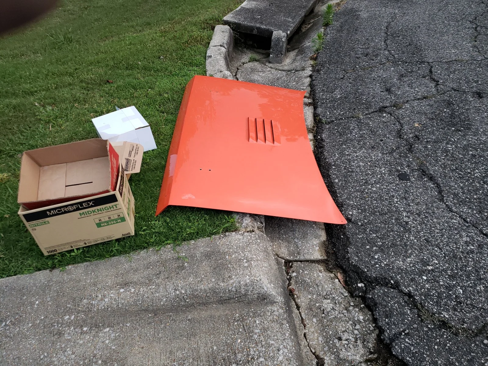

Say farewell to the Gila hole...its slotted for the rubbage pick up.
The deck lid, it’s sad.Why are you angry Dave? Because the G hole trunk is gone,nor because I used rattle can etching primer?
Yeah...there was quite a bit of work in that thing too..just didnt make sense to keep it though. The vents were an open hole into the trunk, the buttload of body work under your paint was failing, and..now there were 4 additional holes on top where the wing was mocked up.The deck lid, it’s sad.
Heck, I understand, it's just a little sad.Yeah...there was quite a bit of work in that thing too..just didnt make sense to keep it though. The vents were an open hole into the trunk, the buttload of body work under your paint was failing, and..now there were 4 additional holes on top where the wing was mocked up.
