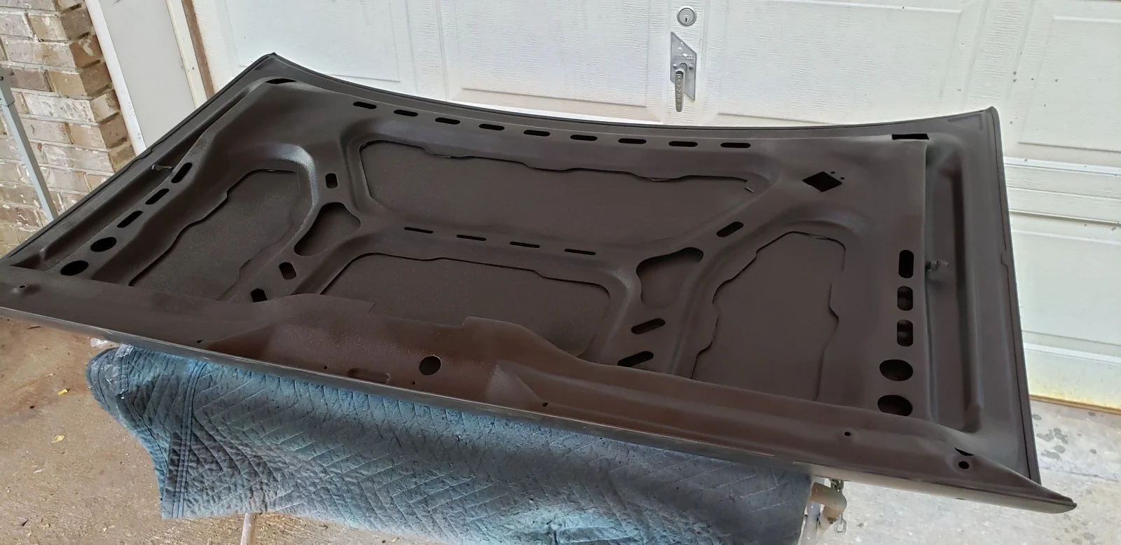

I start out...though, all positive that I'm gonna make big progress..I get the trunk flipped on its back, and start trying to paint the underside..but I cannot get a spray pattern much bigger than a few inches. I have to overlap 2/3rds of each pass, and it's just dry spraying the hell out of the metal in front of the path.
I relegate myself to finishing it, while at the same time completely fcking it up. I'm gonna have to mark that as a do over.
I give it a couple of hours to dry, and flip it. Except I'm not gonna try that again,..something is clearly wrong with the gun. So I take it all apart,...it's filthy as all three pigs.
I spend an hour cleaning it, put it back together, put some thinner in it and check to see if I can make the fan pattern bigger...I can.
Great........... now let's try it with some paint.
It's working. I now have about a 5" pattern,...I manage to spray the trunk fairly consistently, but still put it on way too thick, and now it's orange peel city. I decide to wait and see how it will flatten. As its drying it's shrinking up pretty nicely...I'm thinking I can almost live with the texture,...kinda an eggshell finish..but, as luck would have it, a breeze blows a piece of MDF I was using to check the spray pattern over, and it blows all kinds of dirt onto the not quite dry eggshell finish.
