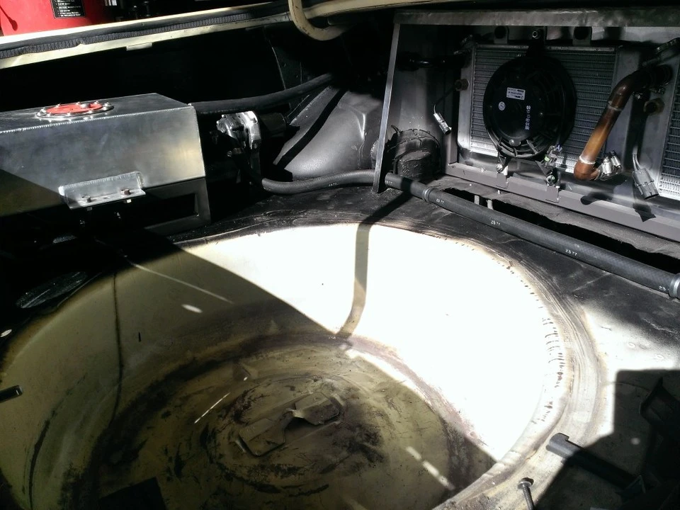

And you have fans to help the air through, correct? If I had your fab skills, I would put some small square scoops on the outside , versus screens or whatever covers you are thinking. That would look pretty bad ass, and even more out of the normal for a Fairmont. Seems like they would fit just right down there.
That's the direction I'l leaning Nick, I gotta figure the area of a 6" hole, and convert that to a H x W measurement to see how far that thing will hang off the quarter. The fans are drawing through the holes, and dumping the exhaust out on top of the rear end.

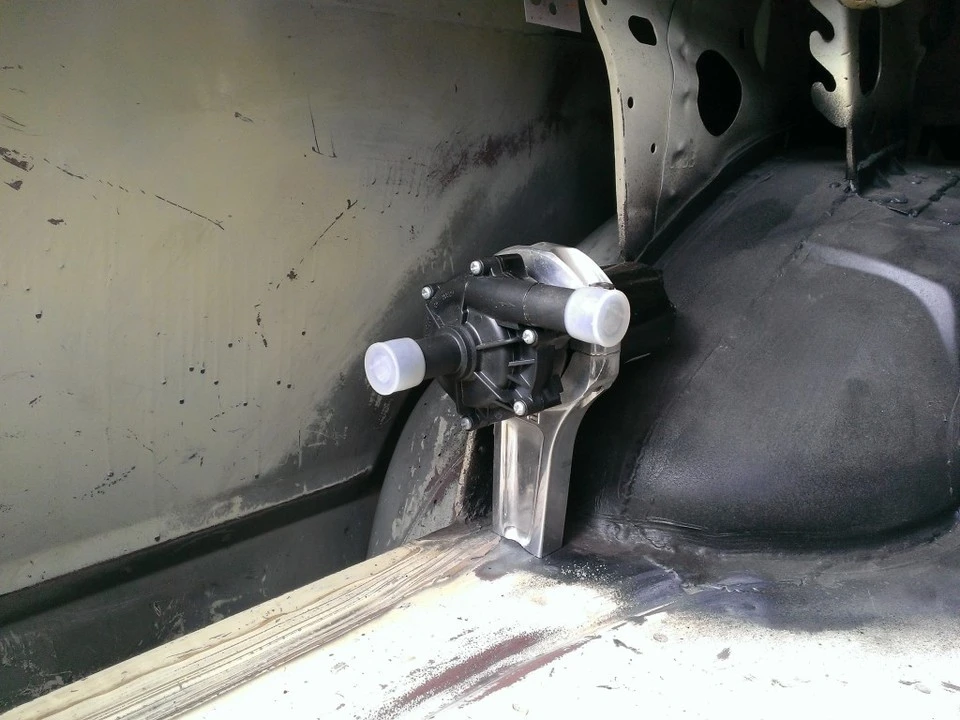

Did the IC water reservoir/pump mount today.
That entailed finding a sufficient round mount to hold the body of the Bosch 03 Cobra pump I'm using to move water between the IC, and the radiators.
Awhile back I snagged one of these BBC aluminum con rods that my friend had used up in his drag car. Once aluminum rods reach a certain number of passes in a drag car, they become "work hardened" and are subject to breakage. For my purpose the one I snagged worked perfectly.
What looks like some sort of bizzaro catyclismic engine failure, is actually the end result of me cutting the small end off of a BBC alum rod, then drilling, and tapping it to act as a mount stalk for the Bosch pump. Two 1/4" studs sticking through the floor, nutted on the bottom do nicely to hold the Cobra IC pump 3.750" in the air.

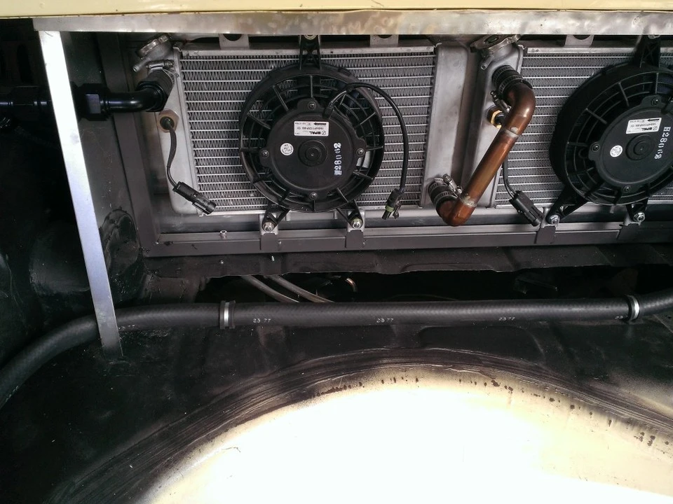

That pump feeds water to these two radiators before going to the IC, then back again to the reservoir.
