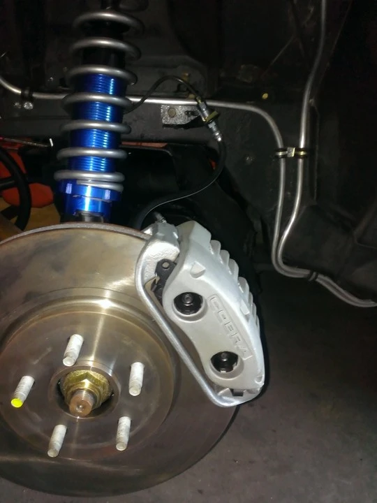

Seriously, I've been waiting on stupid banjo bolts for the front calipers. Once they get here today, I can complete the brake system, and that'll be done.
Can you not machine your own banjo bolts out of old bbc connecting rods that are laying around the shop???:nonono:
Disappointed! :stick:
Reactions: stangboy
The correct bolts showed up today. Whether or not they are long enough is a point of contention, as they are only protruding out of the brake line caliper fitting about 1/4".
I screwed dem b itches in anyway.
I've only had these stupid rotors and calipers for a year now, and today they are just now becoming a brake system.

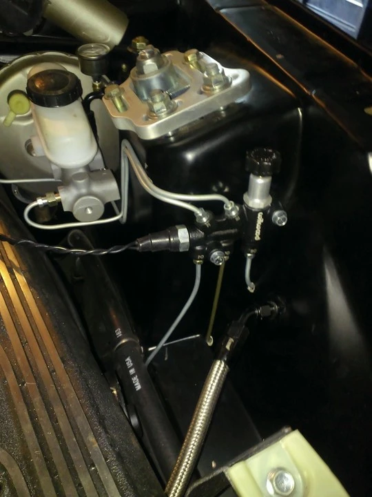

By installing it on the inside of the engine compartment, close to the MC as specified in the instructions, I managed to F up more of the paint. There is a gi honkin chunk missing behind the two lines that go to the MC because I thought after getting them bent, and tight, I'd just give the two lines a bump w/ my hand to tighten them up against the strut tower. They tightened up alright, which was immediately followed by the chip insulting my efforts by popping up behind the lines.
Everywhere a hole was drilled, paint chips.
I don't even care anymore, I'm just gonna get one of those touch up pens, and repaint the whole stupid engine compartment w/ it.

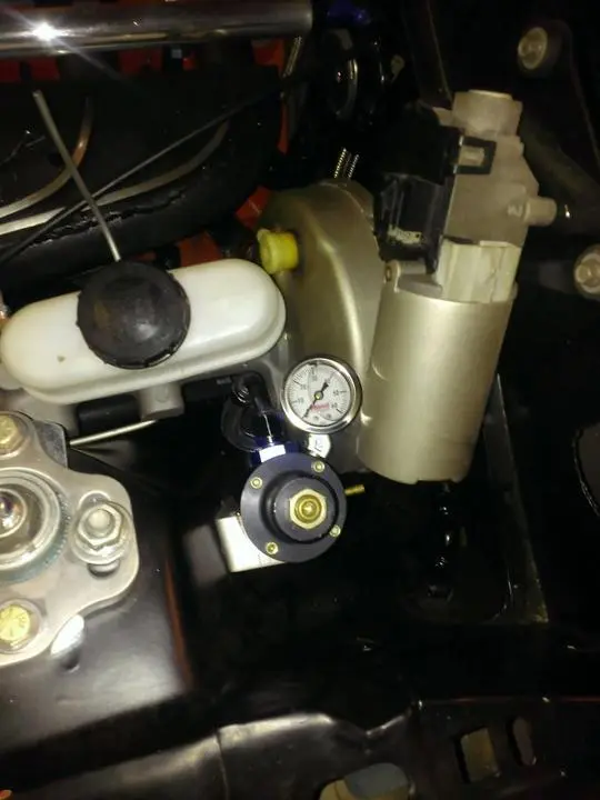

I completed the fuel system by locating a place on the exit side of the fuel rail to install the return regulator. I always amaze myself by trying to find the smallest place to jam the most s hit I can get into it, to the point of not being able to remove anything that is screwed onto it unless the whole damn thing is removed from the strut tower first.
I dare anybody to get the line at the top of the pic off w/o taking the regulator off of it's mount first:nonono:.
I'm still waiting on MM to get me the brake line fittings for the MC, and according to UPS tracking, they'll be here tomorrow, along w/ the steering rack fittings to allow me to put braided lines from the PS pump there instead.
Dare I say that with that arrival, the entire engine compartment will be done, plumbed and buttoned up, waiting on the completion of the interior so I can wire up the engine?:shrug:
I'd be lying. I still have to dick with the AC lines first.
Looks very nice. Hopefully to save you frustration is the future, are your lines higher than your MC? Back in the day I helped my stepfather run his lines on his Ranchero and we made the mistake of having the lines above the MC. We never got the air to bleed out of the system. Ended up rerouting the lines.

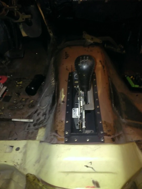

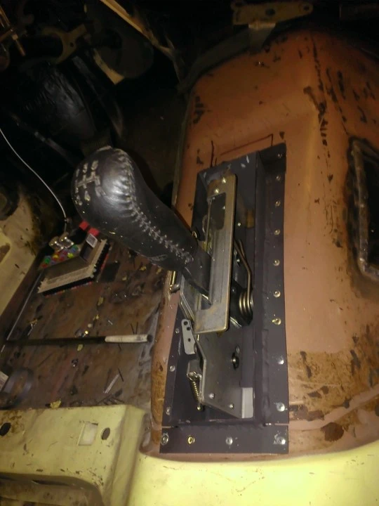

The one thing that I can do is mount the shifter, because which ever way I go, the console will be modified to accomodate it.
So that's what I did.
The pic doesn't show how far it's recessed, but the shifter sits about 1.5" below the floor in a well that I built for that purpose. Additionally, I completely made a new handle so it could be shortened as well. I riveted the whole thing in there because the floor is painted underneath, and I didn't want a raging fire blazing under the tunnel.
When it's done, all you'll see is the knob mounted above the console surface. I probably wont use the knob that is pictured.

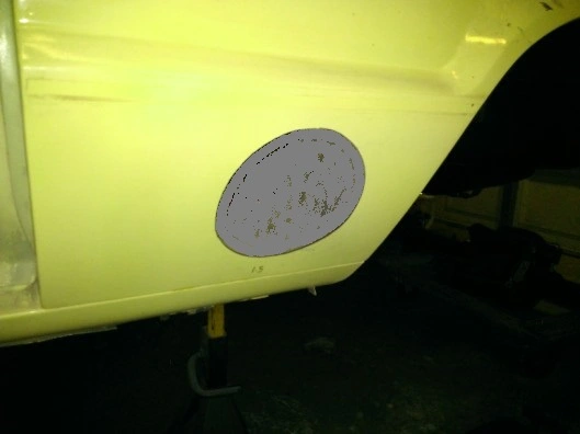

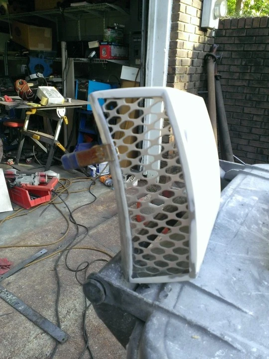

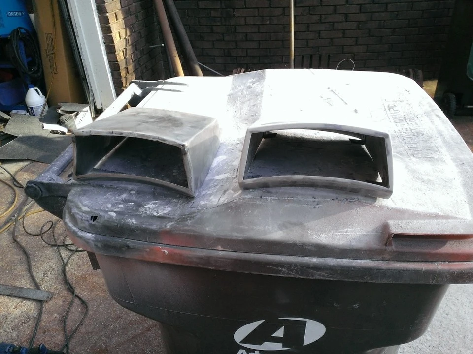

The circle I'm talking about is the hole that serves as the intake port for the heat exchangers that I have in my trunk.
Specifically, this Hole:
This is one of two, one on each side, and it measures 6" in diameter. Using what I learned from my Google search, I determined that the 6" hole had an area of 28.26 inches.
The reason that is relevant today, is because I need to convert that to a rectangular opening so I could determine how big the inlet of the scoop I was gonna build had to be.
Obviously, that was variable unless I had a limitation to either the height, or the width. In this case I did. On both.

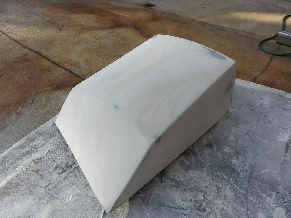

The first restriction was the height. I only had 8". My choices to accommodate my surface area requirements were now leveraged by aesthetics. In other words, how far that thing would stick out off the body of the car was a consideration that influenced my decision to build this thing.

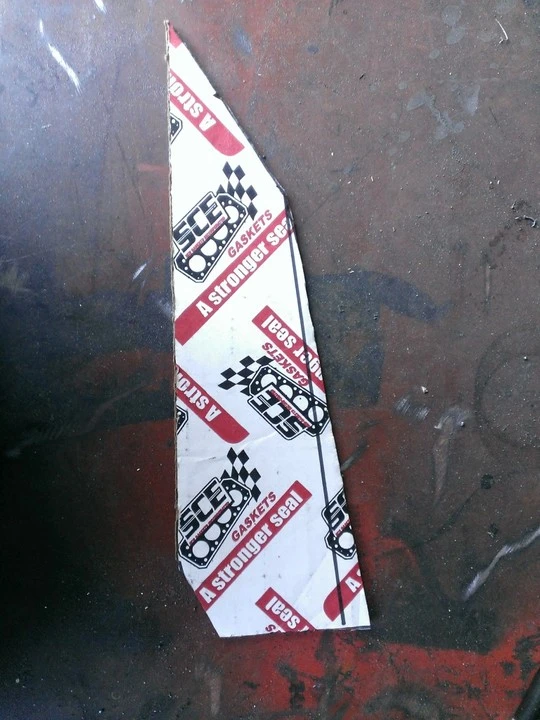

So I cut out a piece of cardboard and held it against the body to get a reference for the OMG quotient.
This was as far as I could tolerate the thing hanging off the body. I didn't want to just stick a scoop onto the side of the car, not knowing how much of it would never see airflow based on the brick-like shape of the car, so I reasoned that I would tilt it off of the body an inch, and the actual finished opening was gonna be 7.750 x 2.750.
Simple math, I didn't even have to look it up: 7.750 x 2.750 = 21.31. A trade off of almost 7" of area, in exchange for what I hope will be augmented by the forced air being rammed into it.

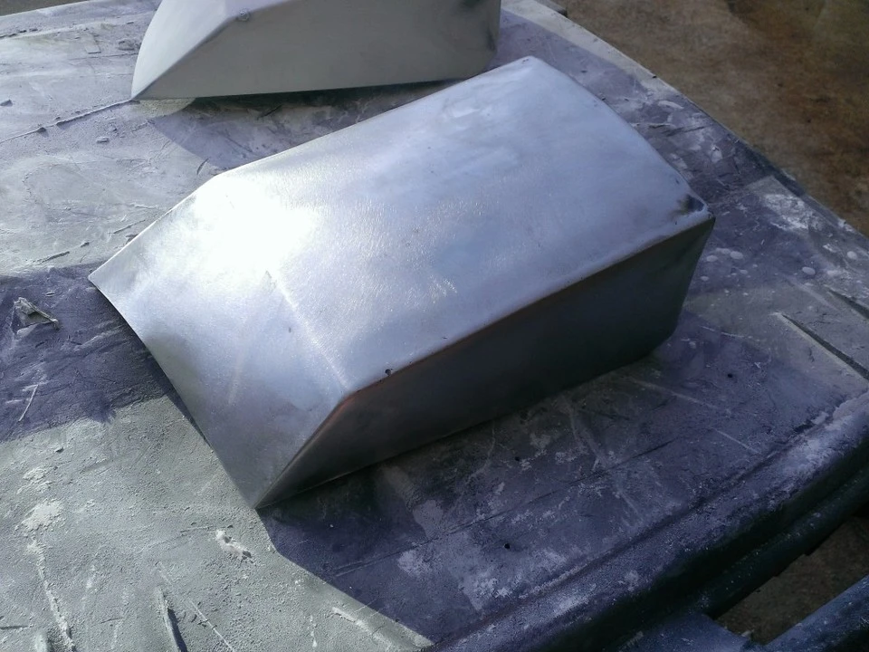

So I built it.

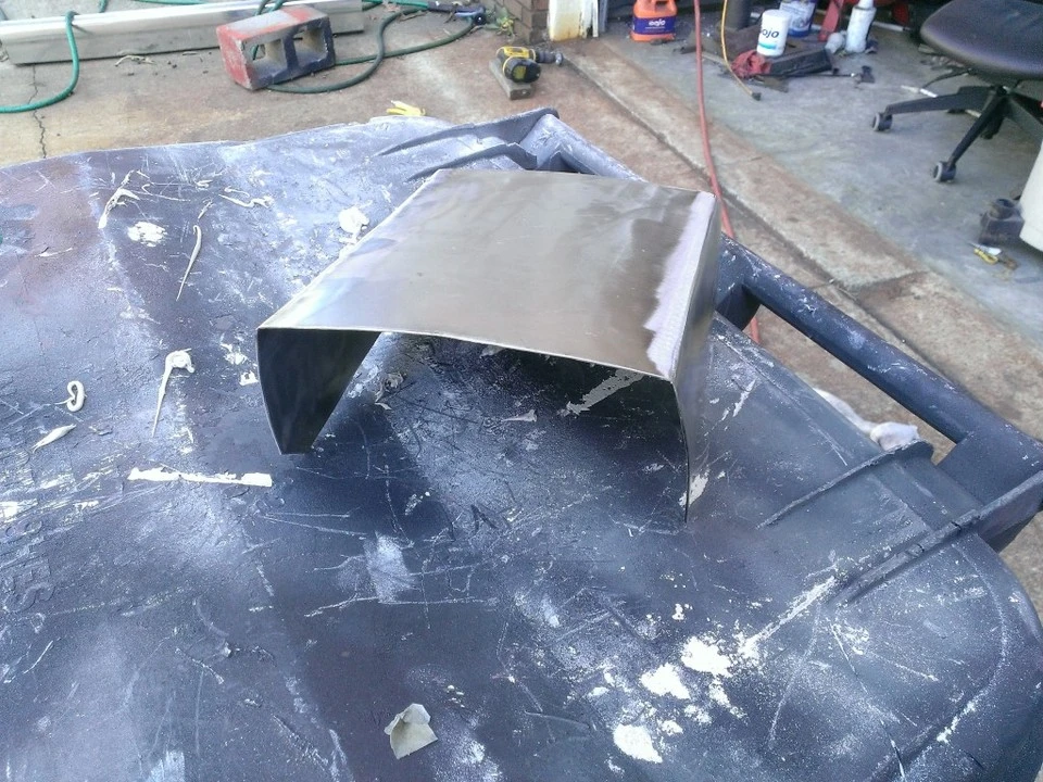

It started w/ 18ga. mild steel. I cut two sides from my template, measured the potential width for the top plate, cut it, "radiused" the three plates over my thigh, and welded it together,
I used my MIG, and welded it together from the underside. Using short bursts, and moving around a lot to minimize warpage, once done I was able to grind the thing w/ a flap wheel to get it fairly respectable.
I built the other two pieces, and welded them in the same way. They all required bending, and the back piece needed a fair amount of compound bending at that.
But I managed.

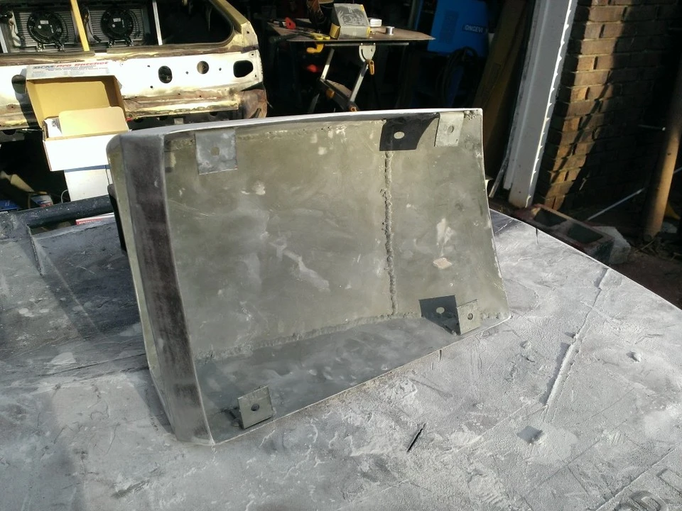

I'm gonna bolt these things on, as opposed to welding them permanently (for reasons I'll cover later) So that required I build 4 tabs to run bolts through.
I sprayed it w/ etching primer underneath after that, so it won't rust while I'm body working it.
Next I had to bend over 1/4" of the front of the ting to allow me to put some sort of screen in front of the thing.
One almost done on the right, and the one were talking about on the left.
I finished the one side yesterday, and have already gotten about 90% done w/ the rough body work. Despite the careful welding, the process of forming the front lip and all of the bends and radiuses make the thing terrible to look at. I knew it was gonna require several hours dicking w/ Bondo ( not my favorite part of the job) but here is the one that is almost finished.
Little stinkin' high spots keep rearing their head forcing yet another coat of Bondo. This is after 4 applications, and as much sanding in between. Tomorrow, I'm gonna go buy some glazing putty, to hopefully put this thing in primer.
This is what will go in the hole when it's all done. How I hold it in there is a point of contention though. I'll probably do like I've done all over then engine, and glue it.
Now for the rest of the story:
You're probably wondering where the pic is of the thing bolted on the side. Another point of contention.
It's freaking HUGE. If there was ever a 4 wheeled, retarded, second cousin to a Lamborghini Countach, placing that scoop on the side of the car just made my car that guy.
I don't know if I can stand the thing hanging out there like it does, and THAT is why it's bolted on. I really don't have a choice though, I cant make a flush IMSA style duct because I don't think I have the room. Even if I did, to properly build it to duct air in, THAT opening would be GIGANTOR.
I'm gonna plod along, and bolt these things on when I'm done w/ them, and put the car down on it's tires, to see if that changes anything, or makes it worse.
