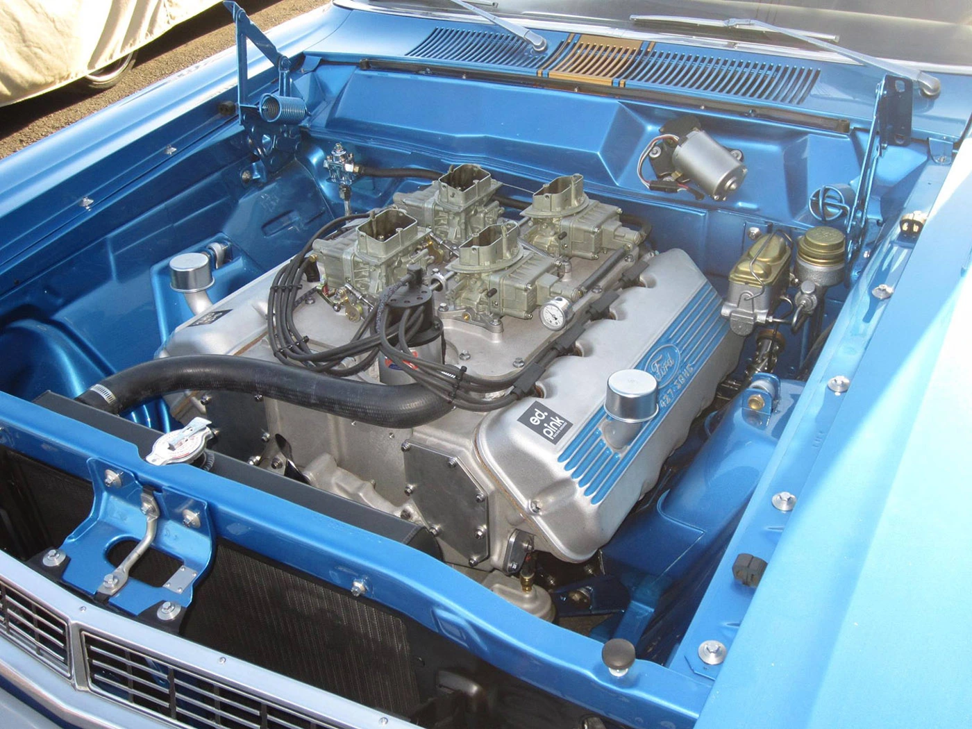

Lastly,....when it's in the engine compartment, it has to look something like this:
Now,........I'm not going to put a carbureted 427 Cammer into the monster,....as big as this engine is, the price tags to buy one is even bigger.
But a 32v 4.6 looks like one. And I'm thinking that there are valve covers out there that simulate the look. The engine I've found in ATL is 500 bucks. It needs a stroker kit.. That fixes the 281 c.i. part, and solves the weak rotating assy at the same time.
There's no sophisticated variable cam or valve timing to worry about,.....nor any high pressure fuel injection bullsht to overcome.
The only fabrication required will be the mating of my old assed trans to the engine, I can adapt my 4r70 to the engine,..maybe even find a trans case that will fit, and transfer my stuff over to it.
(Well.... The turbo(s) required to meet my hp goals might require some fab work as well,...but a 4.6 isn't gonna make 400 hp N/A)
In the grand scheme of things,..I think it'll still yield the wow factor, w/o the worry I'm currently experiencing when wondering if the thing will make it the 40 miles one way to a cruise in, or the 300 miles one way to Mississippi this October..and yes, I'll have just as much in this engine, as I would in a Coyote, but I'll be able to build it a little at a time until it's ready for transplant, buying stuff as the budget allows...and there won't be any hyperucraptic pistons or powdered metal rods inside.
