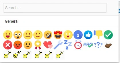

Here .......it's emoticon Friday. ( We now have a new one that I can use...yay)
I will be using emoticons to answer each and every suggestion that you have recommended in the last several months.......

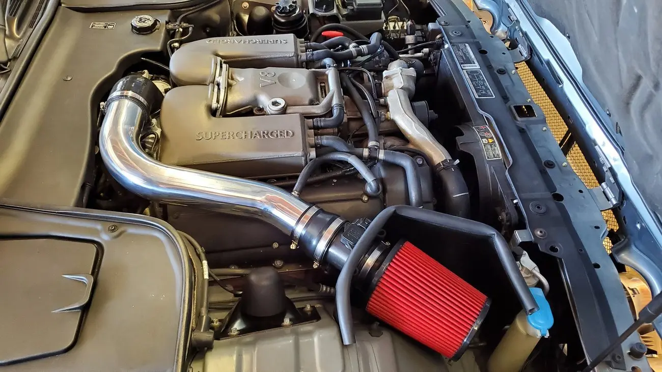

When the ITBs were being considered and you were filling my head with anticipated N/A power levels...something about 300+ hp if I ported the head....which I did.... Subsequent road testing through the " seat-o-mom meter" found those anticipated power levels to be......”Less than”..
If that engine made more than 200 hp after the turbo was removed, I'll give you a cookie:cookie:
Going hand in hand with that, When it seemed that the engine had simply fallen on its face, ran out of steam, or was just plain gutless, and your recommendation was to add additional openings to the box to open up the air supply restriction so that the 12" of throttle opening(s) weren't being choked by the single 3" opening, ......
And after due consideration......Removing the box completely and subsequently road testing it........it didn't seem to make one damn bit of difference...
And,...after even more careful consideration, ......concluding that if by putting a larger than port diameter air metering device directly on the intake port would allow the engine to make absurd power over what it might've made through a common restricted opening plenum.....and it didn't......I can't help but think that........
Maybe my engine can only breathe so much air in each cycle regardless of how unrestricted it's intake system is/was...based solely on its old assed design limitations, and chicken dick port and valve sizes.....regardless of how many throttle bodies I put on it...:bang:
When the turbo reappeared, and you recommended ( still) that I should put a second opening on the box,..and then said something about adding additional throttle bodies to meter it....on the outside of the box....
:nono:
When the engine noise started to bug me,..and your suggestion was to make some gigantic NVH ramp at the rear of my engine compartment to insulate/isolate that noise from the passenger compartment...
:nono:
And later,....to consider havIng a custom built set of carbon fiber pushrods built to help reduce all of the metal on metal harmonics,...and who knows how the hell much that would cost...
:nono:
When deciding to dump the ITB system partly because of the complexity, partly out of frustration, and mostly because I just didn't see the benefit based on the same thought process of....”If im gonna force air into an engine,.it won't matter how many throttle openings there are if all of the compressed air is coming out of one 2.25" outlet...and going into one common inlet,
The same as the case on the 700+ Hp Hemi in the hellcat, the 600+ hp in the ls powered Z06, or the 500+ hp late model Boss 302.....who the hell needs an ITB induction system, on a forced induction engine?
And.....since having one common inlet on one end of a sealed plenum is essential to forcing air into an engine especially considering that a lot of that compressed air is leaking out before it even gets past a throttle blade”....it made sense to completely eliminate the throttle bodies altogether.....The thought being that if having the biggest possible entrance into the intake port was essential to making power...eliminating those restrictions altogether should net the highest possible gain......Yet,......you told me I was trading away potential power despite all of the headache revolving around that system,..

ITB's, upstream Flow net pre throttle body air flow, proven technology one for one when executed correctly.
NVH reduction ramps.BMW, GM Opel/Holden/Vauxhall, Ford (Hash 7 and Australian Cortina)Hyundai Stella
short L/R ratios, proven results on specific horsepower. EMC are not endurance events
carbon fiber pushrods built to help reduce all of the metal on metal harmonics . 250 dollars US. Ones offs are in excesse of 60 bucks each, but not in bulk.
WHY do an ITB induction system? Unforced, or on a forced induction engine Nissan, it made Godzilla The Power. Unforced. 400 hp with ease in that 50 DCO Falcon pickup. Early carbed Lotus Esprit Turbo, on just 9 pounds, IIRC 227 hp in a crack prone 910 block.

Number six.The injectors are in the wrong spot. They were in the ITB's, are in the single TB intake.
And Seven
The six Venturi size basics that work to get flywheel net horspower are these:-
For any thing port on port, irresepctive of grouped plenumb, assuming a 5 inch from butterfly to valve head.
Up to 1.181" or 30mm,180 hp six
up to 1.260" or 32mm, 198 hp six
up to 1.378" or 35mm, 234 hp six
up to 1.496" or 38mm, 276 hp six
up to 1.575" or 40mm, 306 hp six
up to 1.653" or 42mm, 336 hp six
Up to 1.771" or 45mm, 390hp six
up to 1.889" or 48mm, 444 hp six
up to 1.968" or 50mm, 480 hp six
up to 2.047" or 52mm, 522 hp six
up to 2.126" or 54mm, 558 hp six.
If upstream area is less than this, you won't get the full benefit.
If you didn't get more than what felt like 200 rwhp, then something was wrong. Upstream of the throttle bodies. Or in the leaks, the injector placment, the cam splay or the transmission losses with the 4 stage were high. The white Falcon pickup I posted. 280 rwhp and at least 390 hp at the flywheel with 45 mm venturis. That's all I gotta say. All that other stuff, well, its your post, your finger...
