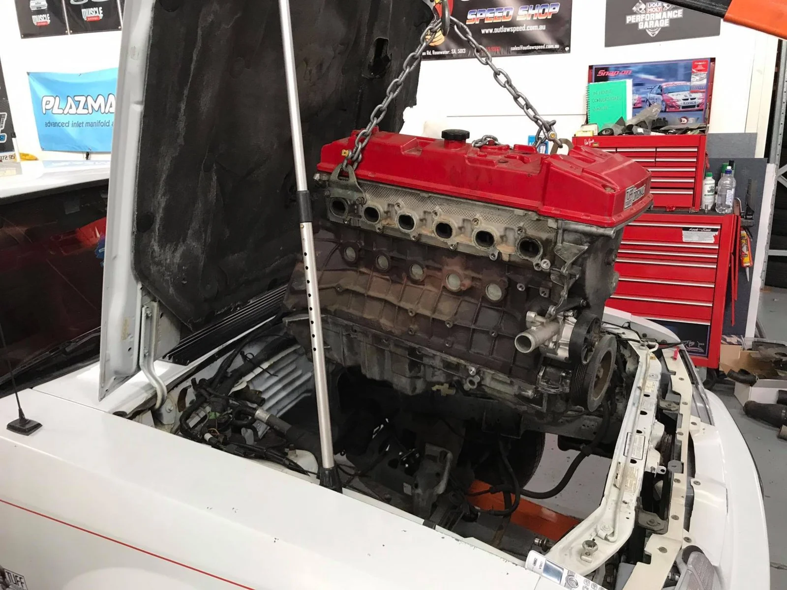

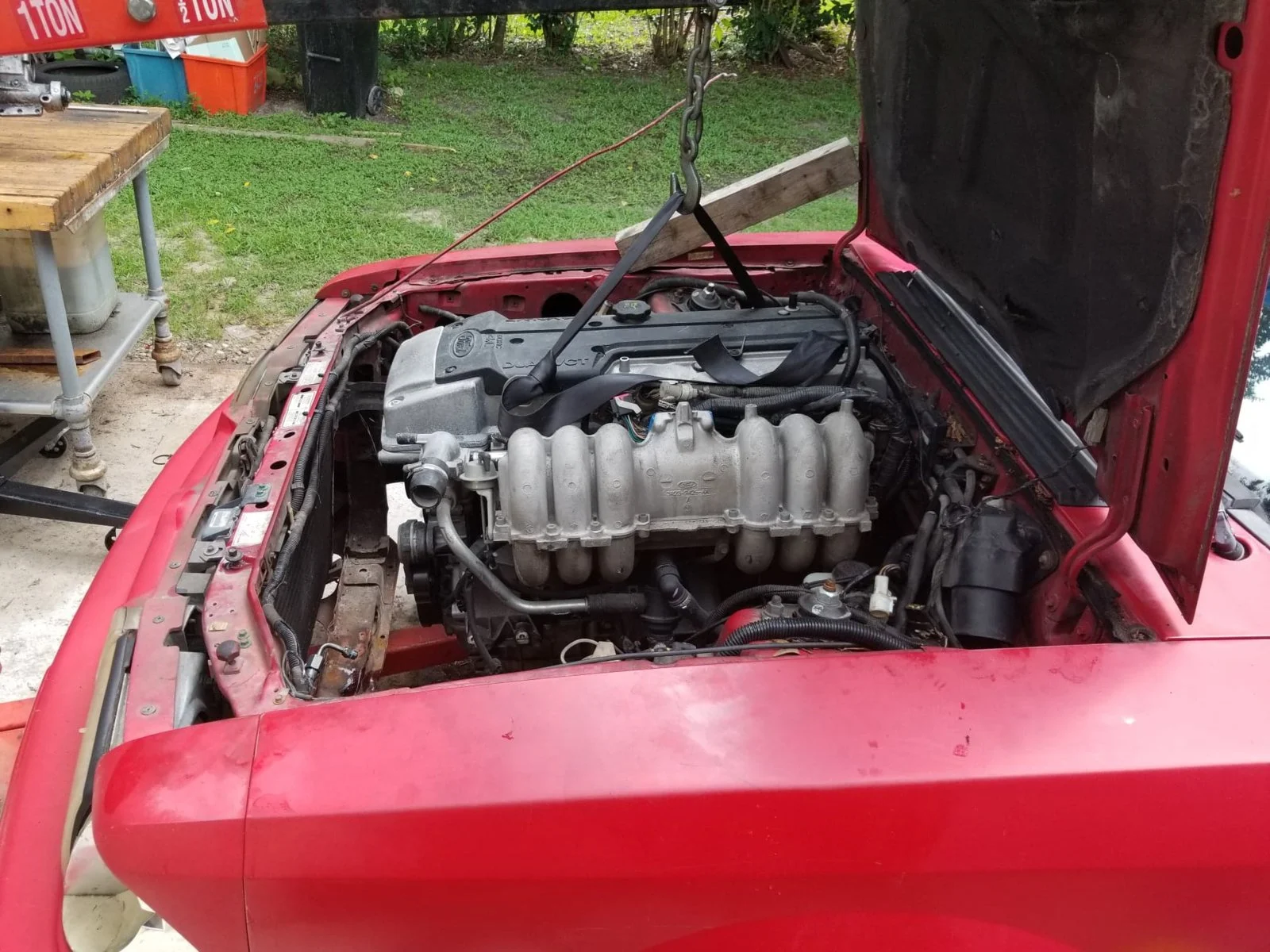

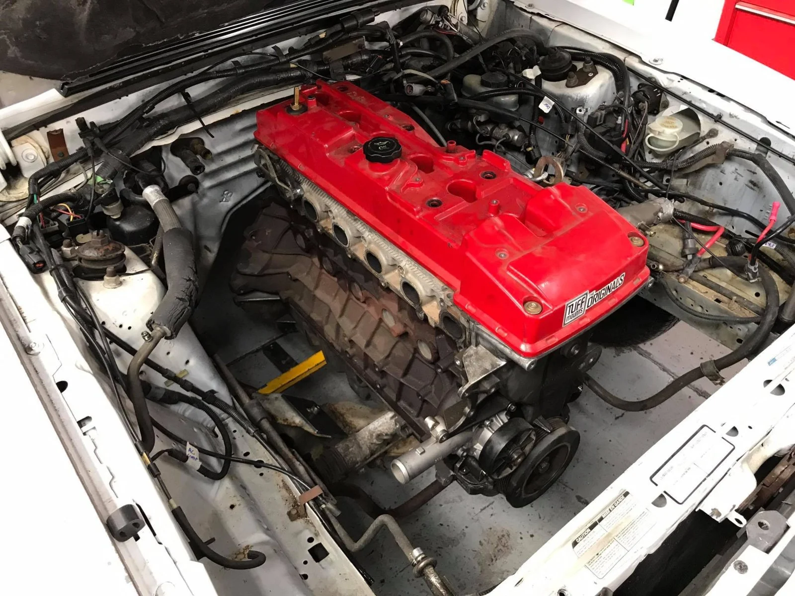

Spent the morning looking at 2jz’s
Compared to a Barra, it just makes way more sense.
The engine is reputed to be able to withstand 750 hp w/o me even removing the oil pan, and only requires that I swap out the cams and springs ( available in the US from Crower) also w/o removing the head to do so.
The stainless steel exhaust header is available on eBay for 4 hundred bucks, The intake looks to be around 500.
I’d probably upsize the injectors to whatever the domestic equivalent of 1000cc is, and I can bump my pump up to 340lph if I need to as well..currently rated to 220 I think.
The only thing(s) standing in my way from making this purchase are:
The front sump pan...can I buy a rear sump pan, and will that solve the fitment or will I have to adapt/ modify it.
The trans...I can buy the engine from several shippers between 2799 -3199 with a trans attached. Is that trans capable of withstanding the power output of say...500 whp? Conversely, I can also buy the thing engine only.
If I have to adapt,..I’d probably just buy a 1/2” thick plate and adapt the 2jz bell to my 4r70.
Maybe@TOOLOW91 can chime in?
The Barra requires a much more substantial upfront investment, and nothing is available in the US for it....Everything has to come from Australia. It’s significantly longer..I’d like to be able to solve the cooling issues by putting a real cooling fan with a shroud on the radiator,...it’d be nice if the engine wasn’t jammed in from front to back for a change.
I’ve got to find a better venue to sell the Jag as well...Autotrader hasn’t netted a single sniff in a week, and I’m priced in the mix properly..maybe eBay?
