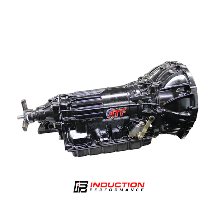

I noted the a340 toyota trans has been in the 9s
I have driven a 800 Rwhp with a cd009 with the Collins adapter and a shifter and all that and the trans was vague and felt like dog :poo: . T56 is the way to go if you were going manual .

2-3 cars swapped here . Lexus sc300 and a Scion FR-S . Trans shifts the same . But to each his own
They are going there because v160 toyota 6 speeds sell for 6-10k
Most guys don’t want to spend the conversion money even though people are seeing the light and starting to . The cd009 started cuz it was super cheap 2-3 years ago

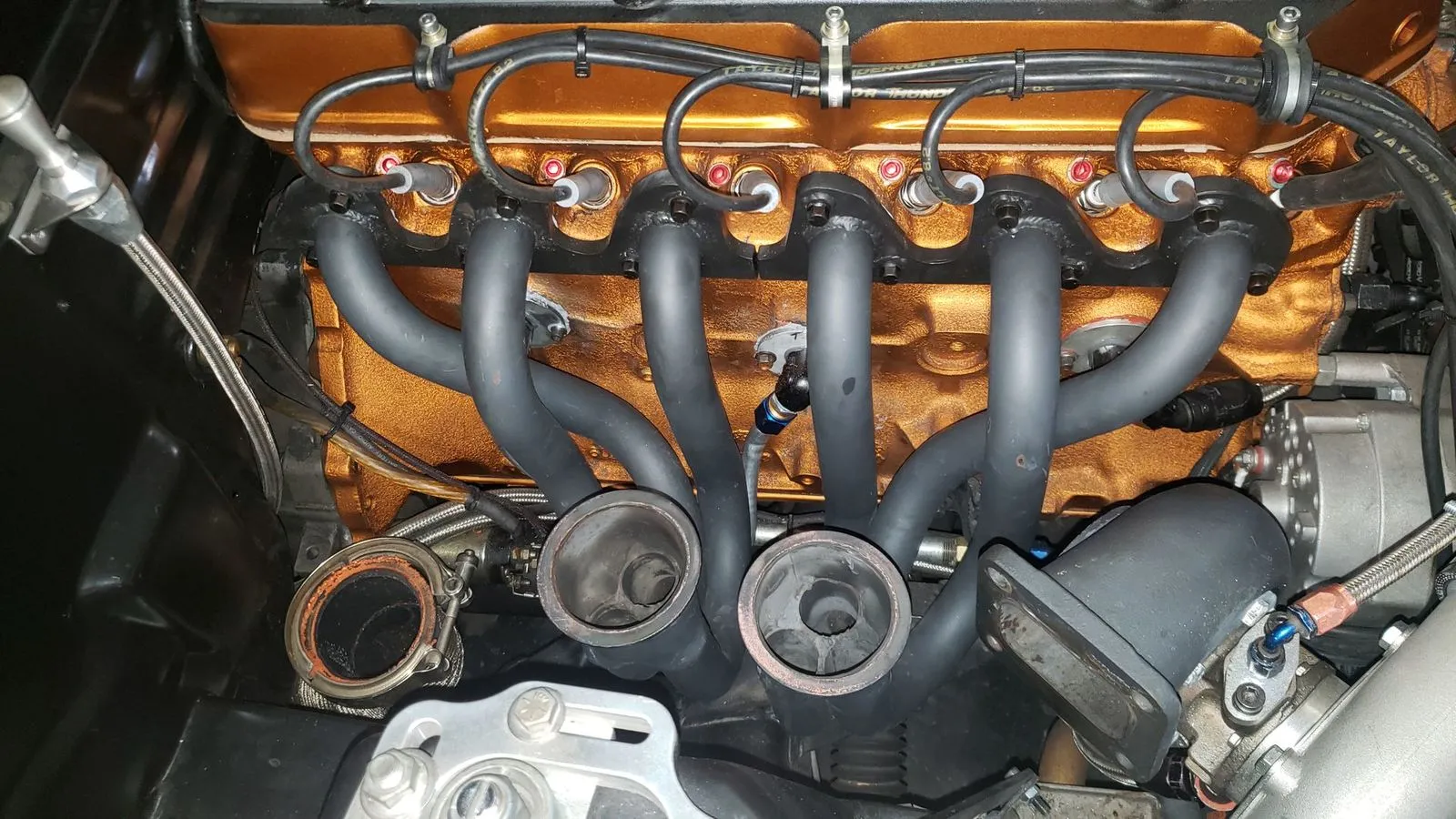

I can't remember why, but there must be some reason why you come out of the rear water port with a 90, go to the 11 o'clock and 180. I'm guessing there is interference or something that kept you from turning the 90 down to 4 or 6 o'clock and doing another 90 over to the middle port?

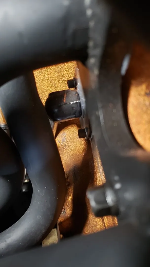

As I expected, trying to use -10 hard line was a gigantor pain in my ass. You can't get that junk to bend tightly w/o kinking.
( and yes, I'm using a bender)
You can see that kinked up piece of sht under the header..good thing too it's too hideous to have on display
Speaking of which, ck out the color of the headers versus the color of the down pipe...something is going south here.
Thinking my spooly boi has a leaky bearing...
When I said that the rear header tube touched that fitting, I wasn't exaggerating.
