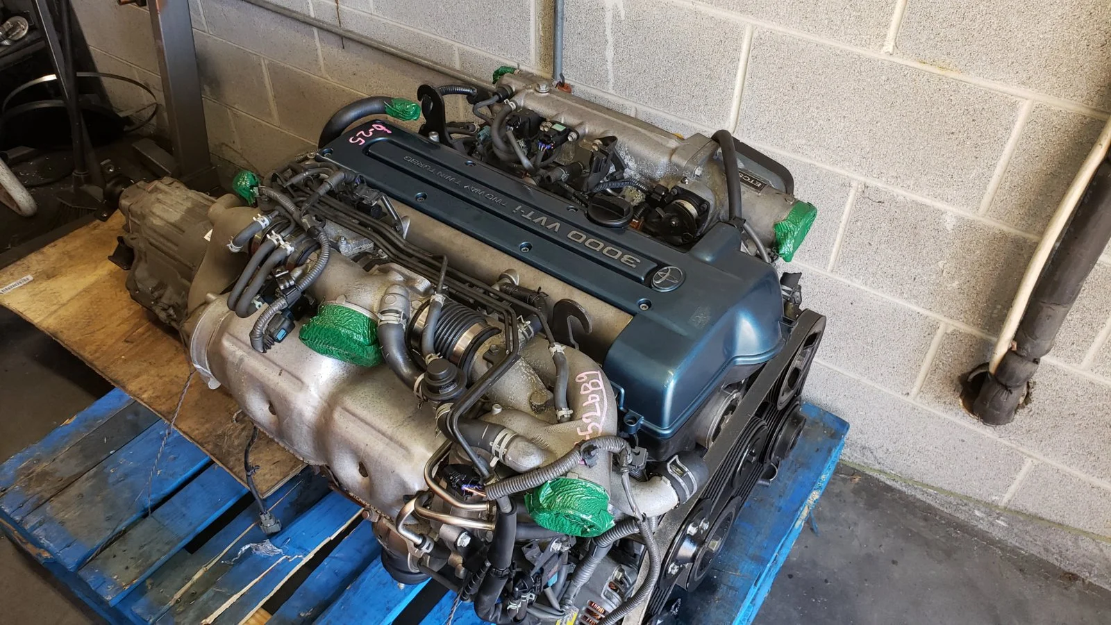

Well,...sitting here at the house..waiting on the truck to get here....and then it came.
If I had hair,....i wouldn’t have any now.
I took 2hours today so that I could meet the driver at my house and take delivery of that engine. Because the driver called me when he was 20 minutes away, and because I’m only 5 minutes away from my house while I’m at work, I waited till the last minute to meet the guy.
That meant that I had almost 2hours to piddle around.
The objective was to get the stock exhaust manifold off with all of the dual turbo menagerie so that I could determine if that turbo manifold was gonna work or not.
Three hours later...and it’s still not off. I’ve never seen such a complicated mess of inaccessible bolts, housings, lines, tubes brackets, and pipes in my life..( well...BMW’s sht is overly complicated too,...but this is a 15 year old engine.)

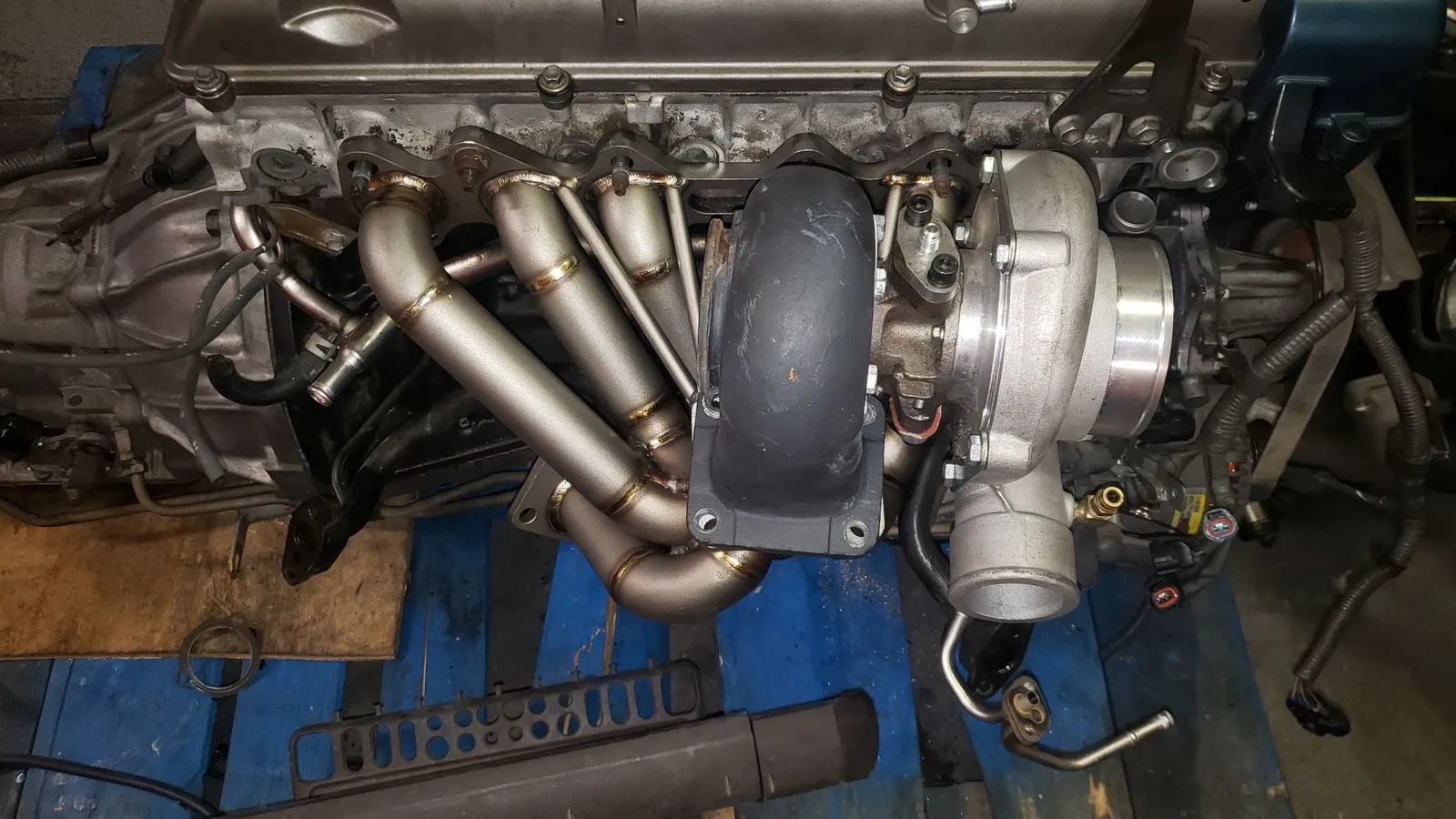

Finally got the heavy assed cast iron monstrosity off of the side of the tooges. The exhaust ports are all sooty as you'd expect for a street car, but everything looks good so far.

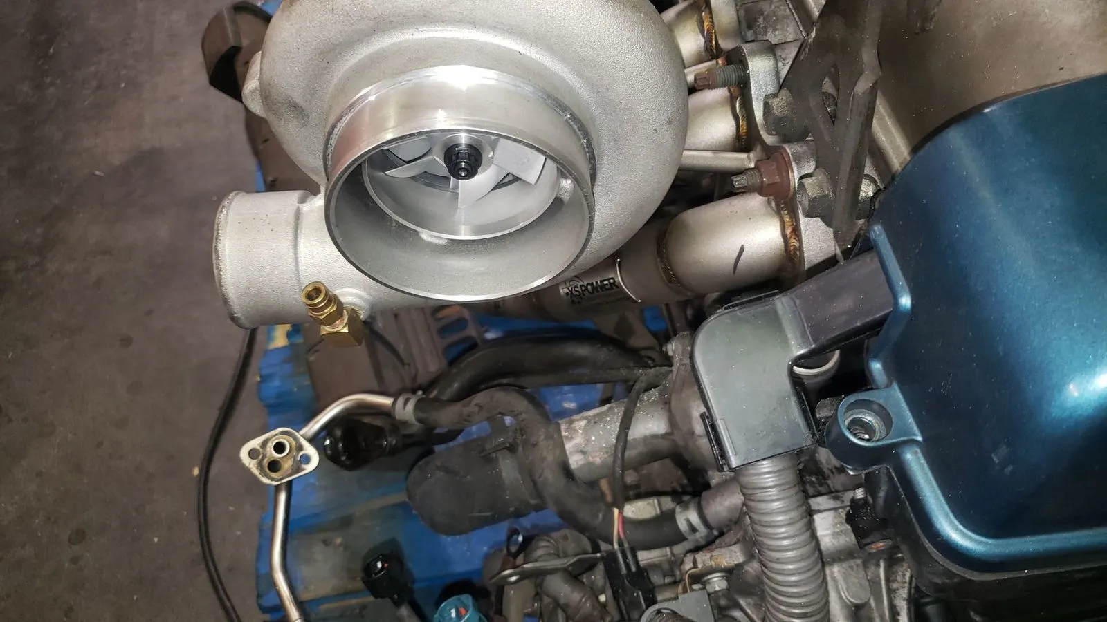

Except this thing.
It's too far down,.and angled. the turbo is in a terrible place, with no clear path for the oil return.
Besides...
There's no way in hell this turbo is gonna ever fit. This bitch is goin back.

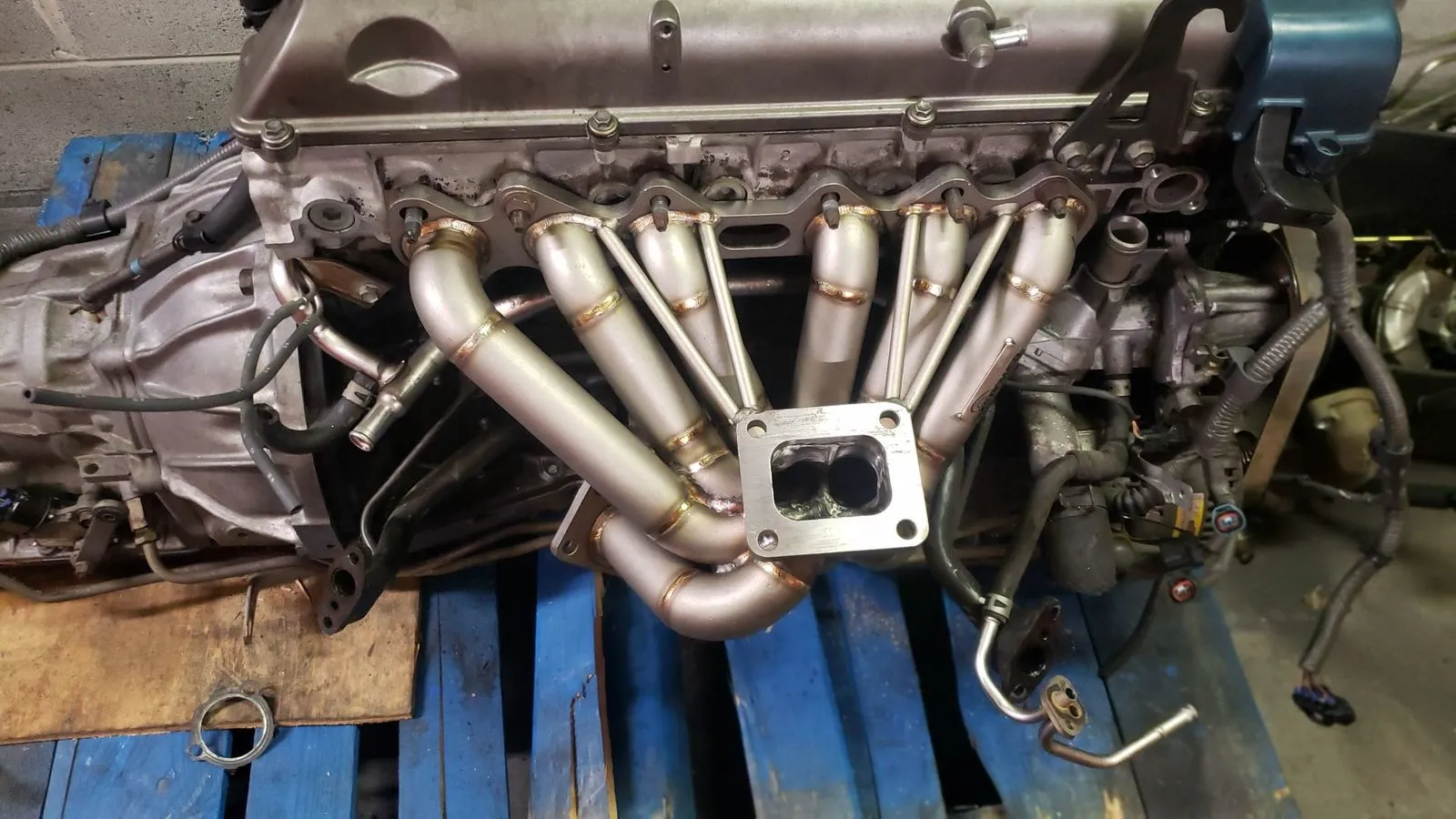

Mike I assume you could make a very simple header yourself in almost no time. Dont overthink it.
Not a SS one for 400 I can't. Besides, even if I had all the stuff to do it for free.....ever try to cut 1/2" thick SS?
:nono:
After this one gets refunded, ill spend an extra 100 on then one that looks like it'll work better, and we'll see. If the fitment sucks on that one, then I'll build one out of mild steel I guess.
Adapter plates are all over the web Mike. Should be able to find something cheap that will make the turbo sit comfortably in the big arse monster engine bay.
That header is gone. There are others out there that look to locate the turbo more forward, with tubes that aren't bent down so tightly you can't get a freakin nut to start on the bottom of the flange.
