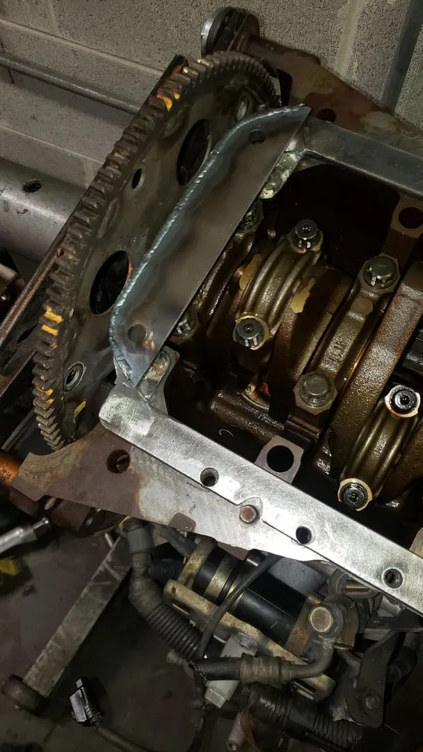

Tomorrow night after work will mark the start of the actual pan sheetmetal.

I just got reminded how limited my skills with a tig are..went home for lunch, rammed a sandwich in my mouth, and went downstairs to weld two stand off tubes onto the pan rail that will support the rear most part of the pan.
I ran a bolt through that tube and nutted it to the pan rail, then attempted to weld the tube to the rail.
And got the tube so hot, it melted, and deformed. Enough to trap the bolt inside it. I had to beat one bolt out, I had to cut the other one off at the head, and beat the rest of that phcker out after that. .both tubes had to be redrilled...
I suck.

I would have done worse. Maybe just sit and think that Iowa Nick can’t do it, and that will channel some inner Alabama Mike skill set to shine.

Like the oil pan....the one I'm making
I know........you're looking at this and thinking....."so what?"
Well...let me tell ya... Under those two holes are two spacers...welded to the pan rail, and the underside of that top plate. If......If I didn't get that right,...oil will find its way out one of those two bolt holes.
The other thing worth talking about is the TIG welding....I'm thinking that as long as I have two similar sized pieces of CLEAN steel that need to be fused together, and I'm sitting on a stool working over that weld,...I'm gonna be able to do what you see here.
But........add one weird scenario into the mix,.and you're never gonna see what that looks like.
So,..that brings me up to 11 pm...2 hours since I've came up from the garage......I need to go to bed...I'm beat.

Have you considered tig brazing for some of the more delicate features? I've used it on some stuff I didn't want to burn through (gas tank as well as 3/8 fuel line used for my fuel return in tank and my dipstick tube). Although if you have to go back and flatten things it might not be too helpful...
