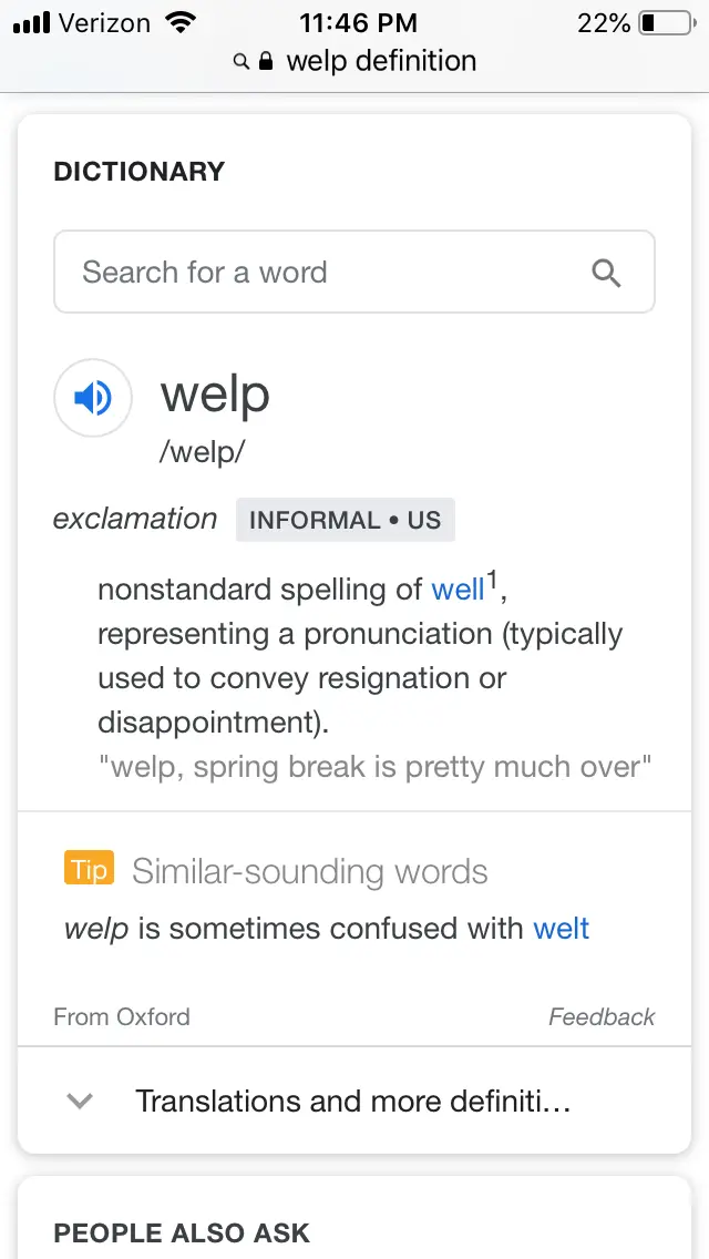

Here’s some clarification:

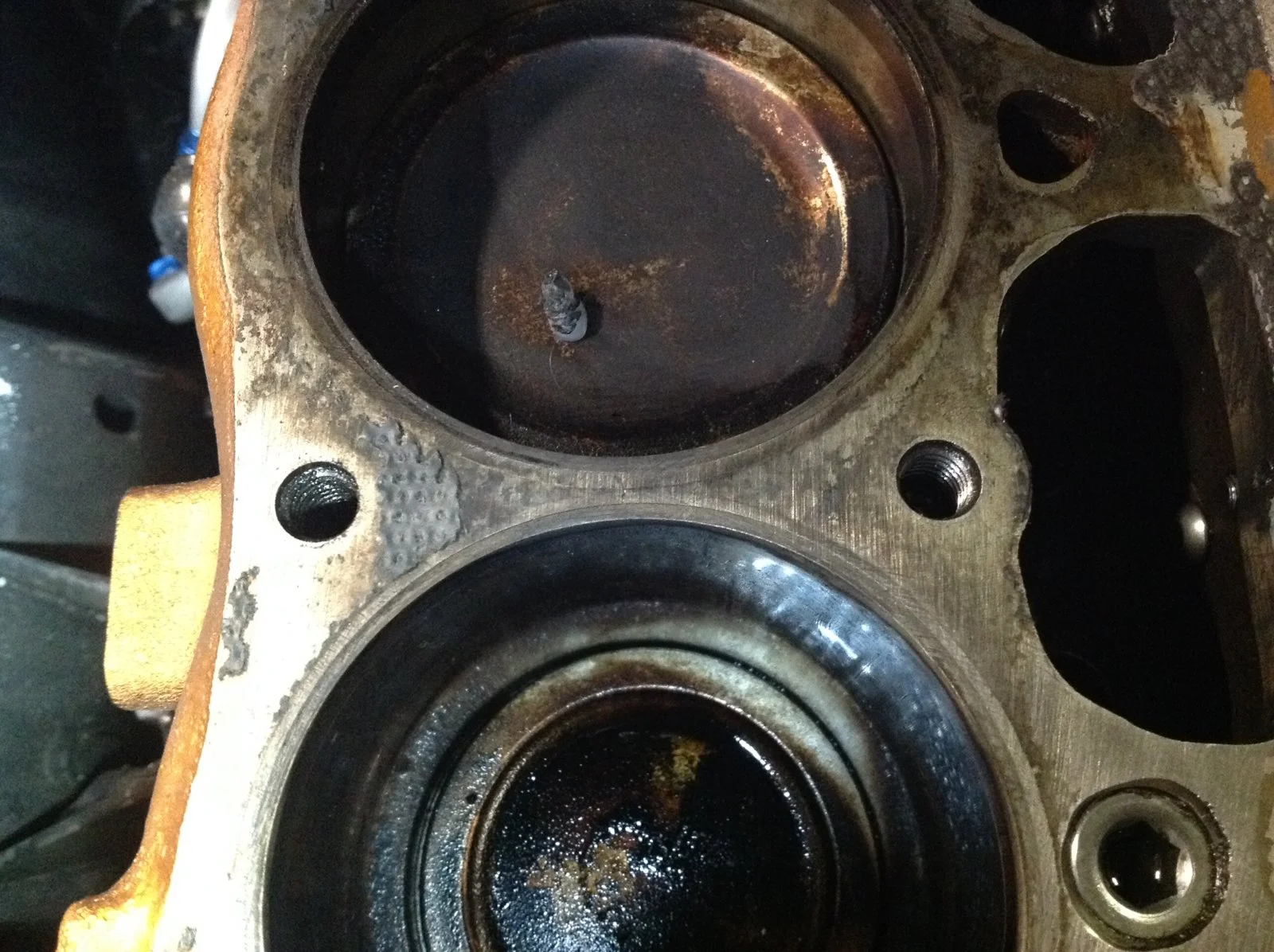

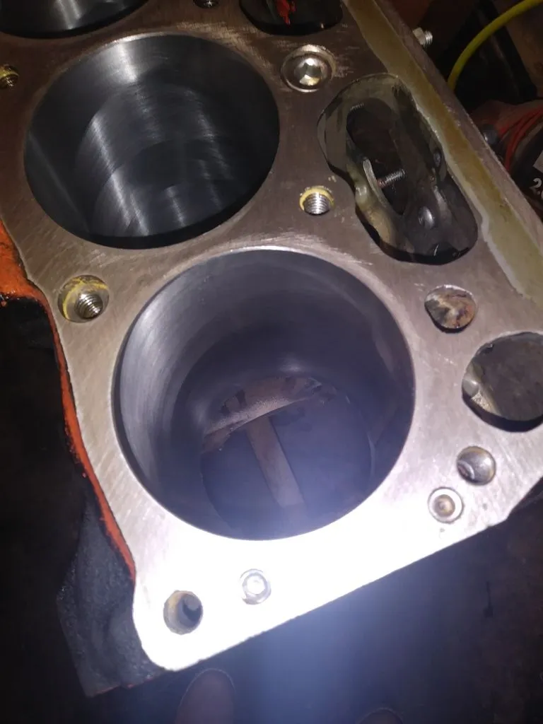

On a whim last night in between bitching about one thing or another, I decided to go downstairs and see if there was anyway to trace how all of the water had gotten into the monsters block. On another website, I'm trying to sell all of that stuff, and I wanted to be sure that it was truly a HG issue that allowed all of the antifreeze into the pan.
I had ported the head two years ago when I converted it over to N/a, I wanted to be sure that a port in the head hadn't broken through. And who knows about any of the rest..the block has been over bored to the moon twice to install the sleeves ( once .180 over, this last time, .250 over.) People that follow this would know that the original sleeve had a .090 thick wall when installed, and after final boring, left me with like a .070" cylinder wall.
But you'll also remember that those sleeves were improperly machined, and I ended up with a taper in the cylinder bore that was much more narrow at the bottom, than at the top. And the #5 cylinder had bad machining marks where the boring bar cut huge gouges into the wall.
And After discovering that when I disassembled it after running for awhile, I made them fix it.
The second time around, and who knows why, they installed a much thicker sleeve. This time, even after boring to the final bore dimensions, the cylinder wall thickness looked to be at least .100". That means, they probably hogged those old sleeves out and damaged the remaining block to the point that they had to install those bigger sleeves..and who knows how big they had to cut the holes to get them bitches in.......Like maybe .260 over?... in other words..they bored my block over 1/4" to install those sleeves.
when I got the block back I took a pic of the deck, cause you could plainly see the wall thickness...I was happy that I had such a thick cylinder. In January of 2018.
But now, after running the thing since then...I think the folly of the whole thing has finally shown itself for what it truly is/was...
A time bomb.
* Look at the crack between the cylinders..there is one between everyone of them. And now that the block isn't all clean and shiny, you can see those thick assed sleeves for real.
So....obviously it took it awhile..I drove this thing to the Gulf coast last year, and It ran perfectly..probably as a result of me bouncing the thing off the rev limiter a couple of times,..maybe just a matter of time...I don't know. But one things for sure,...the old Monster is dead.
Long live the New Monster.
Reactions: 02 281 GT, KZGUNS and Hoytster
A time bomb.
...and there it is.
I don't have a funny comment for this one but I'm not surprised either. This is the first post in this long thread of posts that I could feel in the pit of my stomach as I read it.
I know the final 'thing' isn't what you're always after but it completely sucks that all that time and effort you put in came to this. It did [look] good.
Is this new motor going to take you down the same road for other reasons?

All that time and money only to be a victim of machinists that don't care. I'd want to drop that block on someone's nice shiny hood!

Who knows what caused it. It could be that I'm simply pushing an engine was never intended to do what I'm doing with it.

I'm curious to see how deep those cracks go.... You thinking the cracks compromised the HG seal and caused your issues (I would expect the seal to be between the liner and head gasket)? Have you straight edged the block and heads yet to see what the distortion is? I'd check to see if the liners have moved/protruded/dropped which caused your diagnoses HG issues.
Excuse any ignorance I have on this motor, I don't know this platform very well.
