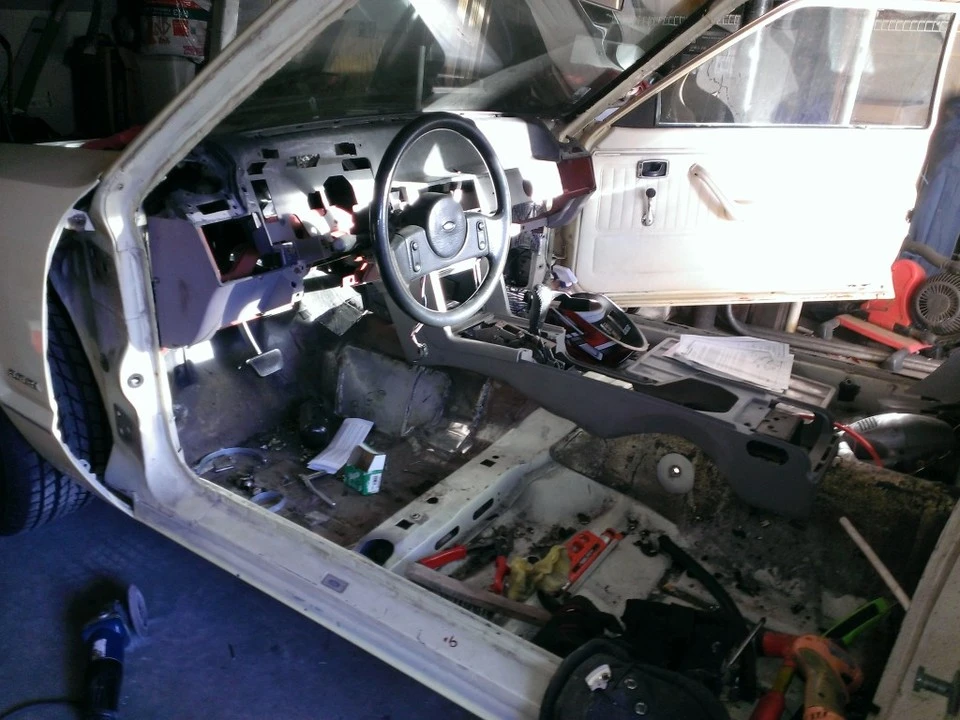

You'll notice the dash is hacked up. I'm not gonna use the stock gauge housing, the stock AC vents, or the stock shape for that matter. I'm really only using it for the basic shape, and structure to build upon.

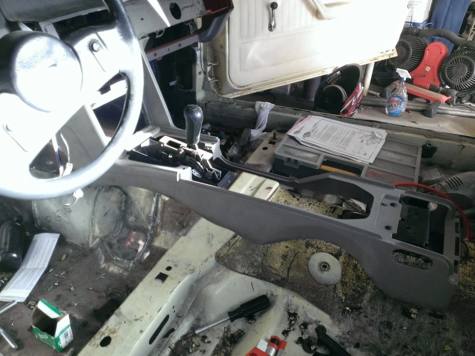

It's no obscure mod, but converting a pre 87 dash'd car over to a later model unit isn't exactly a bolt-in affair. No single factory screw hole lines up, and the dash itself is actually shifted about 1/4-3/8" too far to one side. I let the column act as a locator, since there was a little half-circle dealy-bobber that sat on top of the column shaft that was part of the dash plastic. That being the case, there was only one way the stupid piece of junk wanted to go in, and I decided that who was I to try and tell it differently. It fits the windshield alright, it's just........off.
The console mounts were a complete fabrication, as Fairmont never had a console, or a center mounted E brake handle. I had the factory junk from the donor car, so It was a simple matter of welding them into the correct spot. As for the center mounted Ebrake,...not gonna happen. ( No E brake is gonna happen actually) The console will also be completely different to accommodate the shifter that sits too far back now.

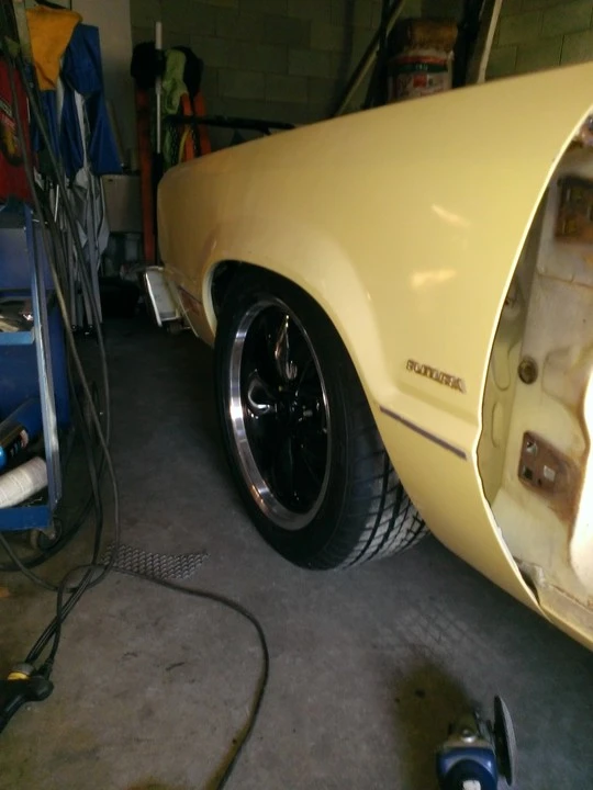

Since I was getting the dash from the storage facility, I grabbed a front fender to see if I was gonna have clearance on the wheels, now that they are 1" narrower than the 9's I used to have up there.
Right now, there is tons of room, but the fender is stretched out of shape where I was tugging the hell out of it trying to make room for the 9's. I hope that I can restore it back to it's original shape. But before I go and do that, it may be prudent to put the other side on there (that I didn't tug the hell out of ) and see just how much room I truly have.

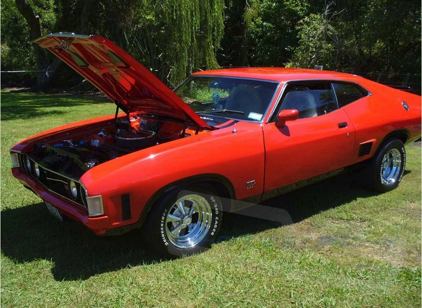

I think you have the right shape. It just needs to be cut off, rotated 180*, flipped over so that the portion of the scoop facing us, faces the center of the car instead, then sunk flush with the body.
The skin of the car cut like
_________
| x x x
_________
So that the portion where the Xs are are molded to form the bottom of the scoop.
Like this one:
The bottom/floor of the scoop is pressed into the car. Not really sticking out of it except for the lip in the back. Anything higher than the surface of the body should be little more than a piece of molding or trim.

You're right. I am the type to let a 1/4" offset bug me.
So I corrected it.

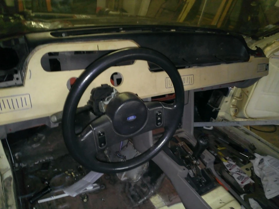

I said that I let the steering shaft be the guide when I mounted that thing, and it made sense (at the time) that it would only allow the dash to go where that plastic semi circle that sat on top of the shaft wanted to sit.
But then I got to thinking, (like I always do AFTER I just made something permanent)
I wonder if I can adjust the steering shaft over to the right 1/4"
:think:
After looking at it,........... of course I could adjust that. It was simply a matter of loosening the bolts that hold the column mount, and the steering shaft itself,...and Lo and Behold, the whole thing slides over the requisite 1/4".
:doh:
I spent the morning yesterday doing that. It involved cutting loose the welds that held the front console mount that I welded to the top of the trans tunnel. Once that was done, I moved The whole mess over to the passenger side and it all became a perfect world again.
After that, I started on the mock up that will inevitably become the new face for my dash.
Yesterday, I cut and glued two pieces of 1/2" MDF together. Today, I cut, drilled, filed, and sanded those two pieces until they looked like this:
Still miles away from being done, I am only in the beginning stages of making it fit well enough to even contemplate making it part of the dash. I still am undecided on how many, where and what type of switches I'm gonna use, but I'll keep the multifunction switch on the column and let it control what it controls. I'm gonna use a vintage air HVAC control panel, so in my mind, the only thing left that actually needs a switch are the headlights. The three holes that you see will allow for instrumentation to display RPM,MPH, temp, volts,oil press, fuel level, AFR, and boost.
The oblong panel will also provide led lighting for TS, and highbeam.
Am I missing something?
I also have no clue what I'm gonna do to cover the dash, and how I'm gonna dress it out as of yet, I figure I'll get the basic structure in there, and let it stew in my head for awhile.
I'll come up with something.
_________
| x x x
_________
Like this one:
So did you just jump the part where the redesigned scoop was pictured?
Believe it or not, that car was the inspiration for the revision. (and if you look at the pic of mine it's almost zackly like that one, but with a decidedly "pronounced" standoff.)
I figured if I was gonna try and force air in there, I needed a little more than a lip standing proud of the body.

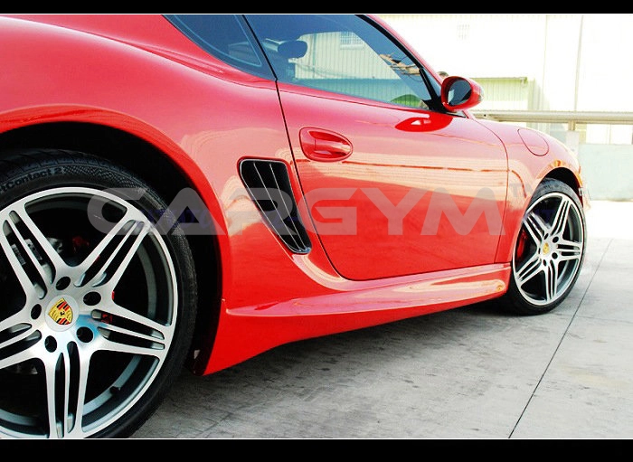

The last thing that I saw that "inspired" me was this:(and not just the vents either)
Completely flat, W/ no protrusion at all. w/ maybe (3) 1-1.5" deep slightly forward angled fins inside the recessed box w/a screen at the bottom.

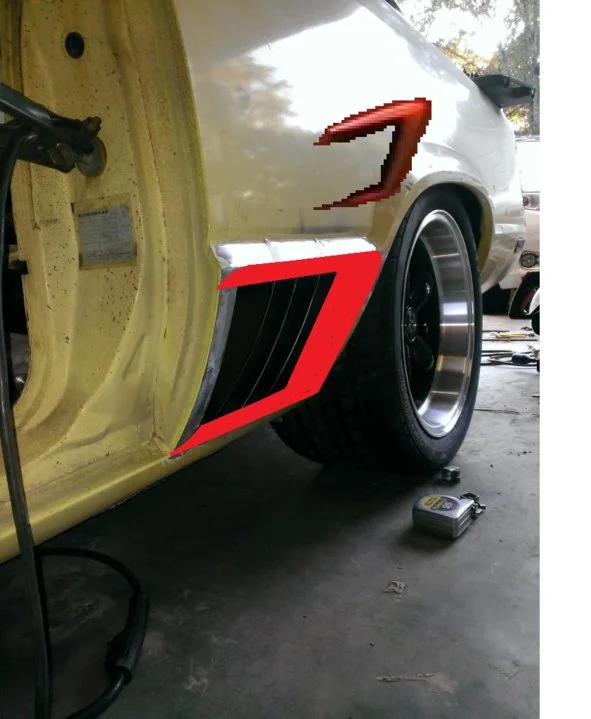

And the funny part of the story is this:
I had a filling done on Tuesday. That filling wasn't adjusted properly, and interfered with my "bite".
The tooth directly beneath the filled one was traumatized all to hell to the point of I couldn't eat, I couldn't drink, I couldn't even stand for the toothbrush to touch it. It was so bad, that I had to go to a dentist on Saturday to fix it.
So here I was, driving the 20+ miles to go downtown to one of the only dentists open on a Saturday in mortal pain, and it didn't stop me from stopping at the import place where I saw a Porsche Cayman to look at that side scoop first.
Time to go get a cut off wheel I guess.
...and man believes that his destiny is his own hands. :rlaugh:
Reptiles breathe air, so they do not have gills.
A Gila Monster is a reptile.
Again, just to be sure that all of you reading know that I know the difference between my reptiles/ amphibians/ and fish. And now that I've got the biology lesson out of the way, I wanted everybody to know that I know that.
All this to say that today, I have created a new species.
A reptile with gills.

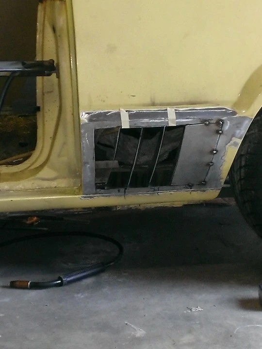

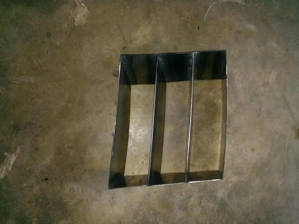

This solution is the first of the three where I can honestly say that I don't care what others' think. I am finally satisfied with what the final result will end like.
I'll call these Gila Gills,..(or G gills for short.)

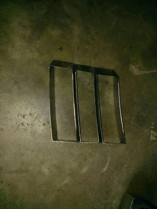

Still missing a piece in front, the back, the grille, and the tube to allow me to duct the hose to the radiators, welding it in and blending it in to finish. (aka another 8 hours).
The gills are actually made up of 12 pieces of 18 ga. steel, all individually cut and welded one at a time, piece by piece.
The two center pieces are siamesed, and tig welded at the apex of the "V". You might think that it would've been easier to just insert them into a frame, and that might be the case, but for some reason, I have a problem tig welding at an angle.
I need the corners to look like this:
Mild bubbles in the corners are easily filed out to leave a clean, sharp edge.
So, I finally came up w/ a solution that I can say I like, and that I am happy enough with to actually leave alone.

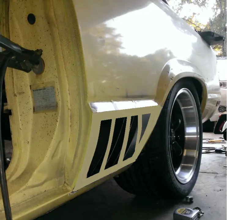

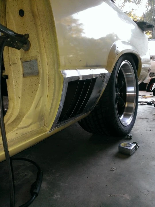

No, Noobz......there'll be no trim ring. After cutting the old one off the "trim ring treatment" is off the table for this body mod.
Here, I've got another pic for you to prove that it can work.
I know you don't really care but I like those a lot fwiw. Very cool:nice:
No, you're wrong. I care what everybody thinks. (That's the problem). If everybody would've loved the first scoop, it might've impacted my decision whether or not to get rid of it (I doubt it, but it could happen ;)).
Ultimately, I see the same junk everybody else sees, and kinda know that it's gonna have to change when I submit something for public scrutiny.
I just like the feel of the stones when they hit me.:rolleyes:
I should be able to complete the one side today (if I can find the right mesh to act as a backer), and it'll be easier to see how the thing's gonna look, instead of it just being a big assed hole looking into the body.
