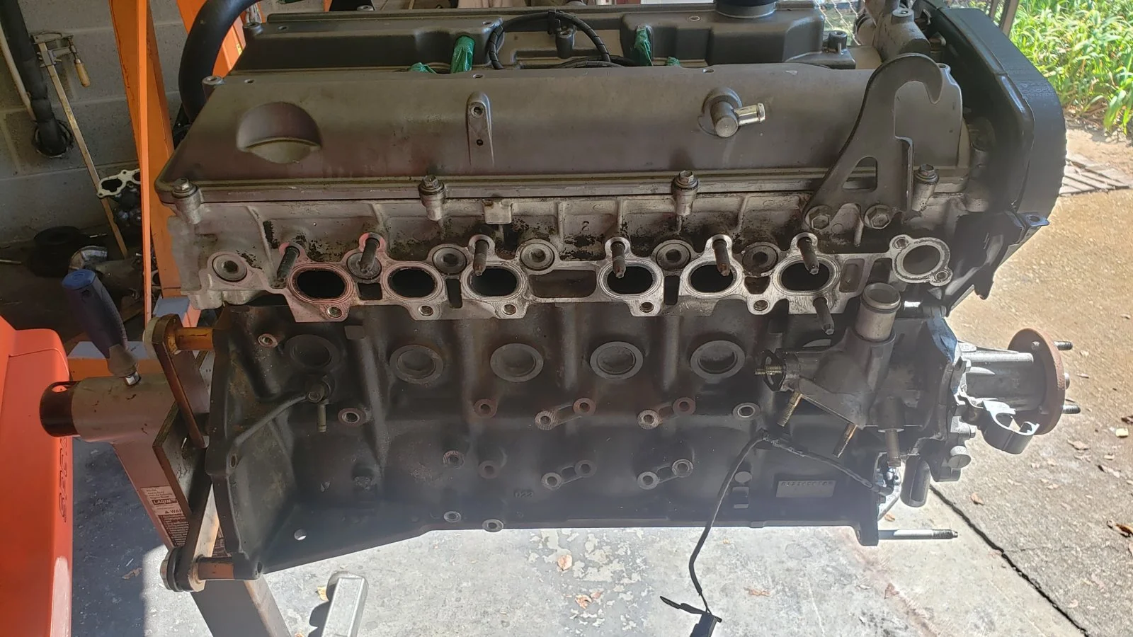

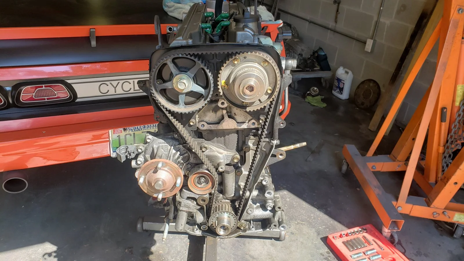

Now the engine is almost stripped to the point of me being able to clean and paint it.
There is a small oil leak at the front of the engine, no idea where that comes from. Dont know what steps I need to take to fix it.

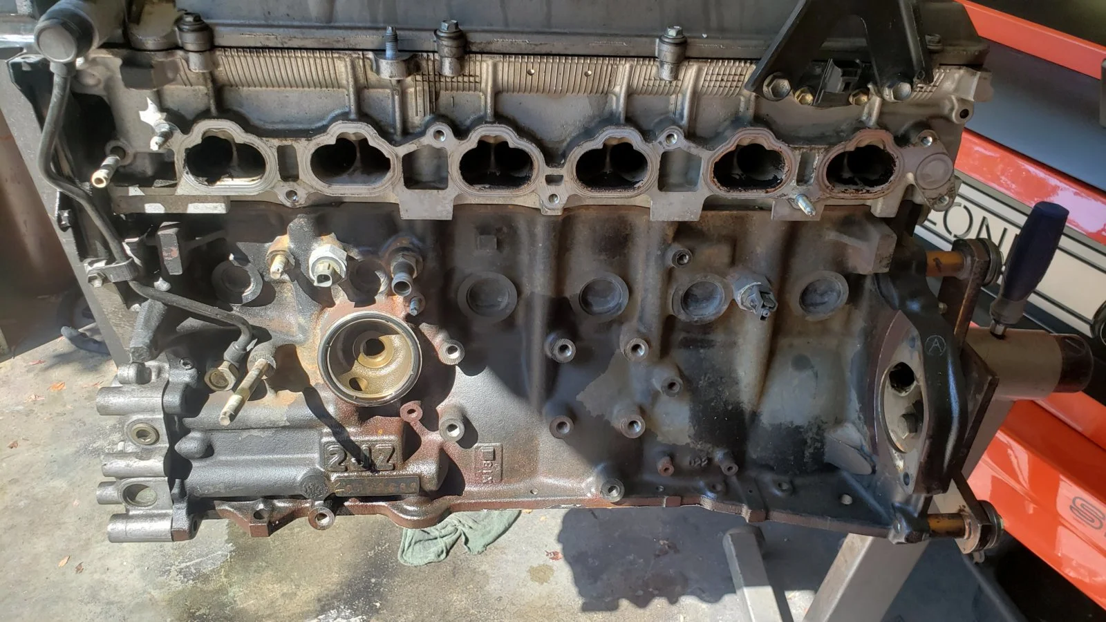

The whole engine is stripped and cleaned now..the block is painted. I decided that this time around the monster was gonna be more of a titanium vibe instead of a burnt copper.
The water pump is off,..the oil pump is off...this thing is very LS-esc........But I don't care.
