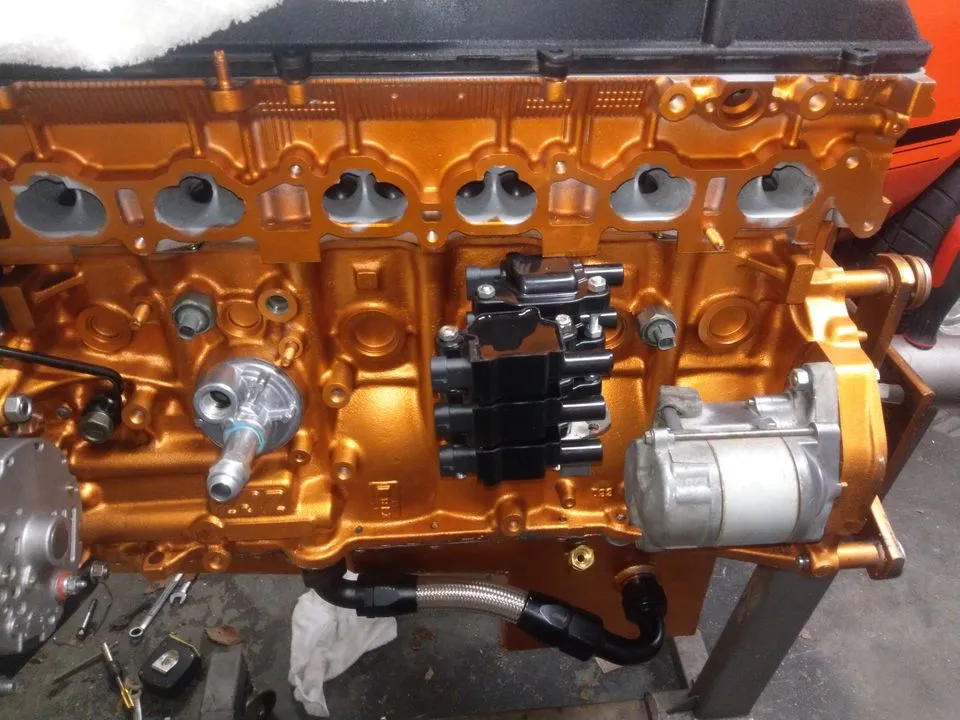

Noobz347 said:
Is there room for the coil packs underneath this?:
There is if I use LQ9 coil packs.

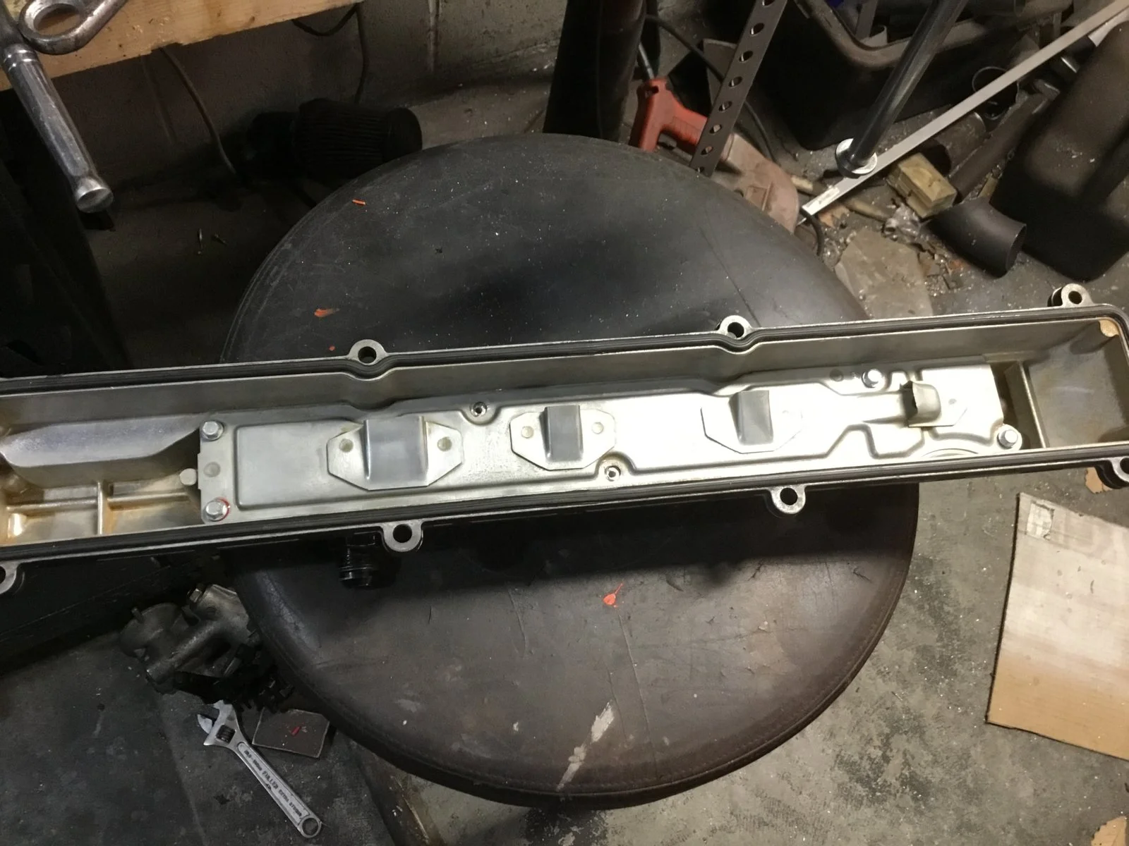

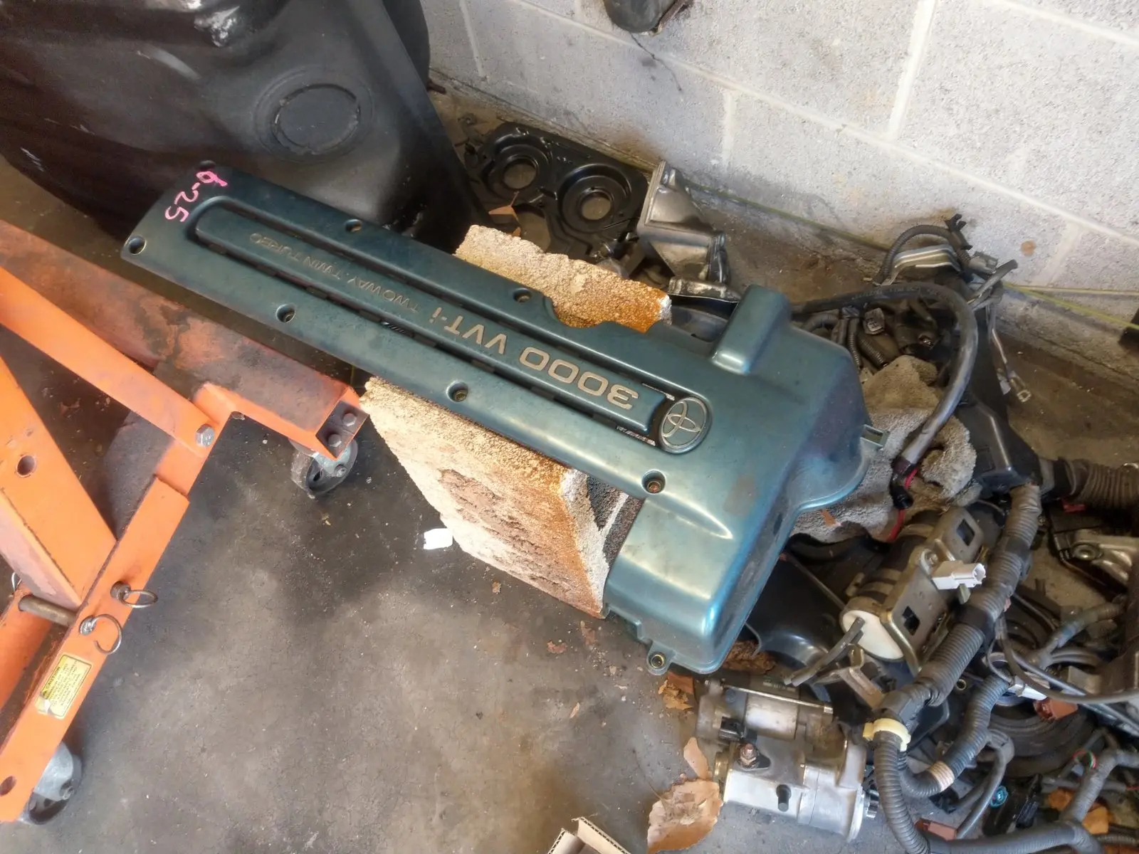

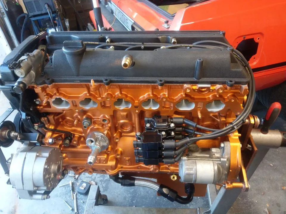

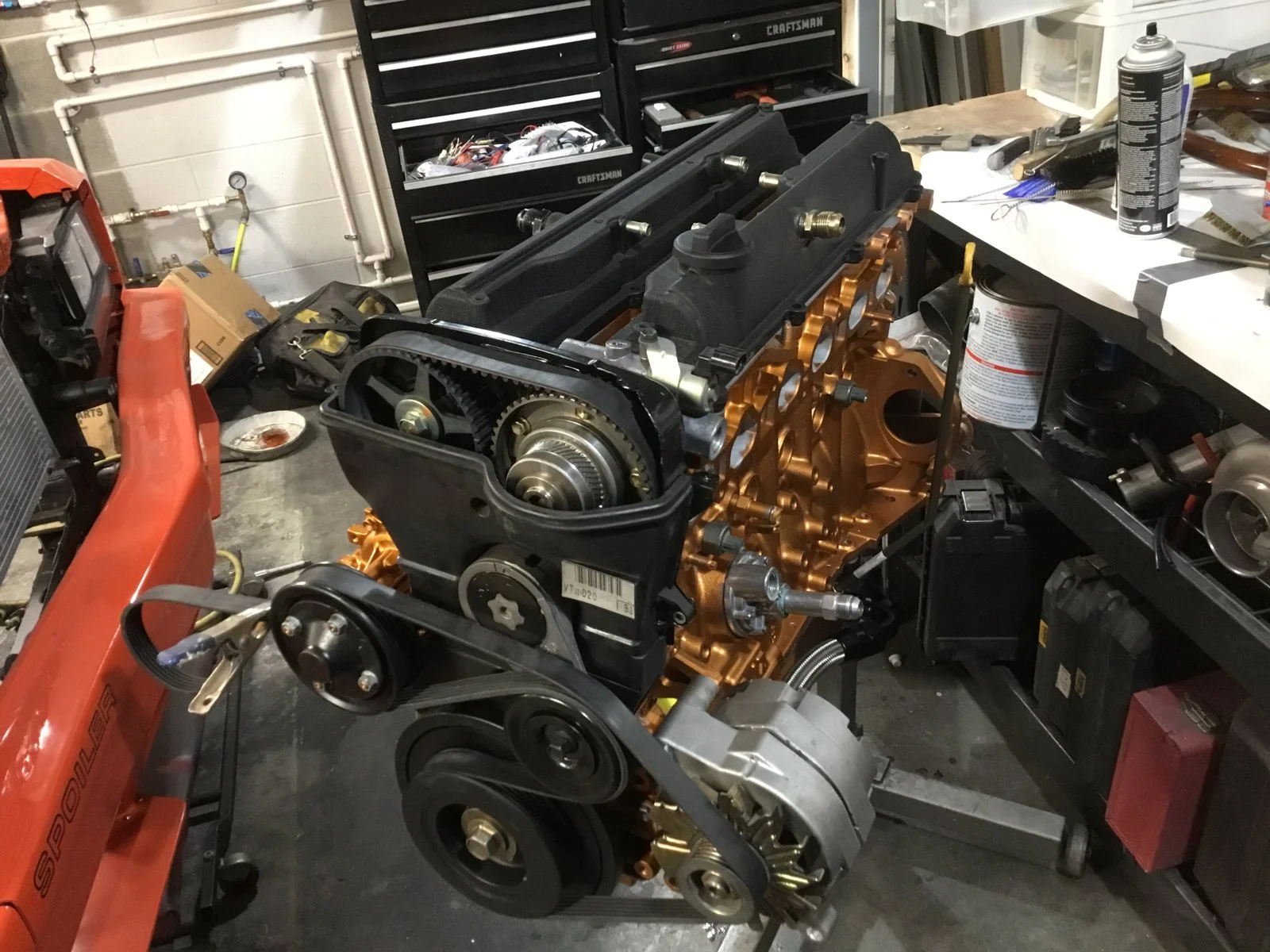

Well.....
Can you say Two Jay Zee?
save for modifying the cover, and doing away with the Toyota script,...mounting the LS coils, running plug wires, creating the necessary bracketry to run my ford alternator, and the Sanden Compressor that I currently have... The tooge is ready for install.
Clearly,...I gotta belt routing hurdle to jump.
I was at this early this morning..the most time consuming part being the cam covers...the baffles are riveted on from the factory. If you are even remotely concerned about the funk that is trapped between the baffles and the cover,.....you gotta drill those rivets out,..clean all that crud that’s underneath,...and screw then bitches back together.
I ain’t putting all of the bolts back in..the four corners are good enough in this application.

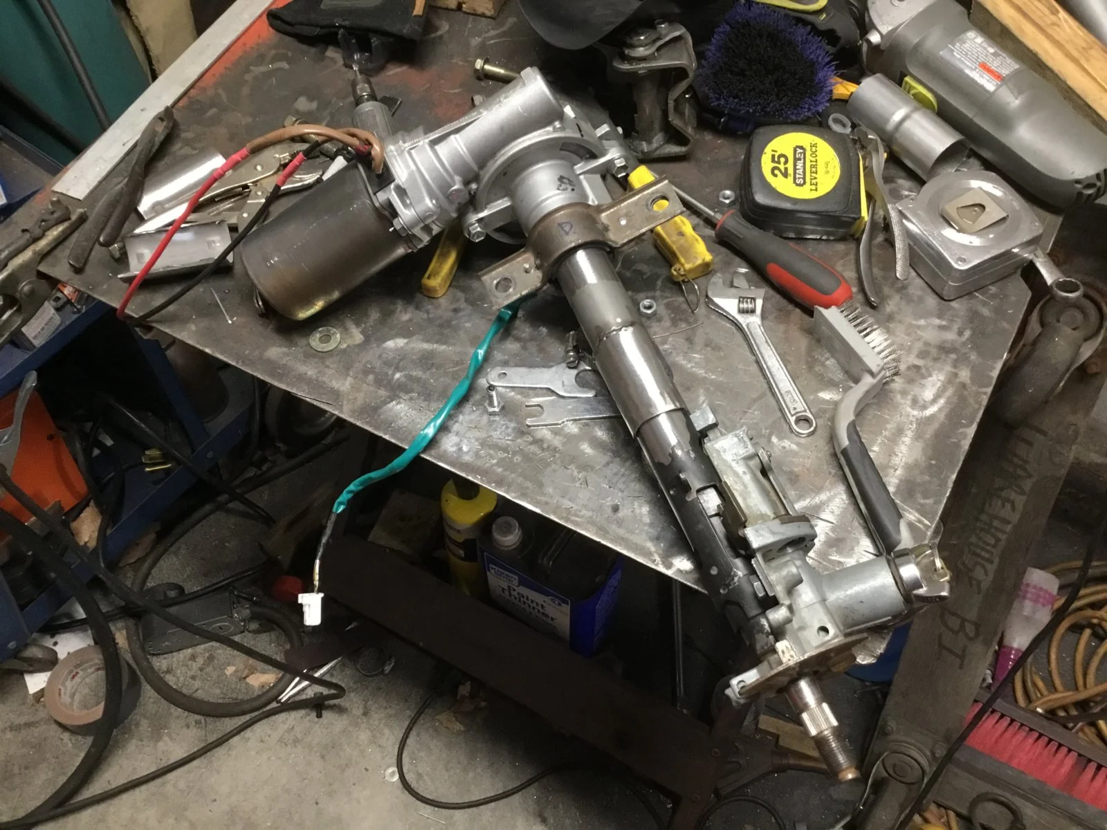

The Prius steering thing is turning out to be a pain in the ass...I can’t weld the shortened column together and still get it to fit. So,....I gotta come up with a two piece solution.
The sleeve is a “ coupler” of sorts.It allows me to slide the upper into the lower. I’ll weld studs onto the upper and lower, and strap the two sections together after it slides into the sleeve...On a fox mustang, the whole lower half of the dash is exposed. So having a column that is “ too long” won’t be a problem. If you have a Monsterdash on the other hand with a custom bent Chromemoly tube running the length between the driver side, and the passenger side......not so easy.
Kates gonna be traveling this week....means I’ll have evenings to work some more if I can stay away from the whiskey.

CarMichael Angelo said:
Well.....
I hope that you put some Loctite on the baffle mount bolts. It would make a disaster if one of then came loose...
CarMichael Angelo
10,641
8,909
Birmingham, al
Jan 27, 2020
#11,088
  • Jan 27, 2020
  • #11,088
Thanks for the input Joe,...look closely, and you’ll see the red googe on a couple of those screws.

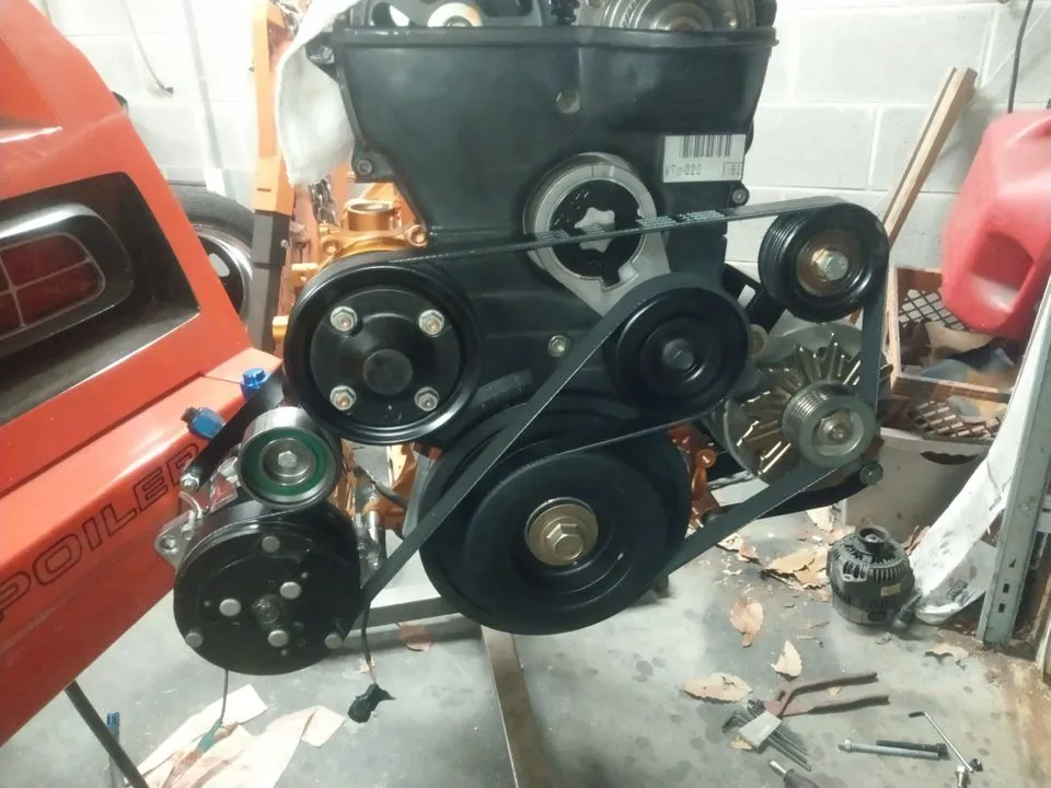

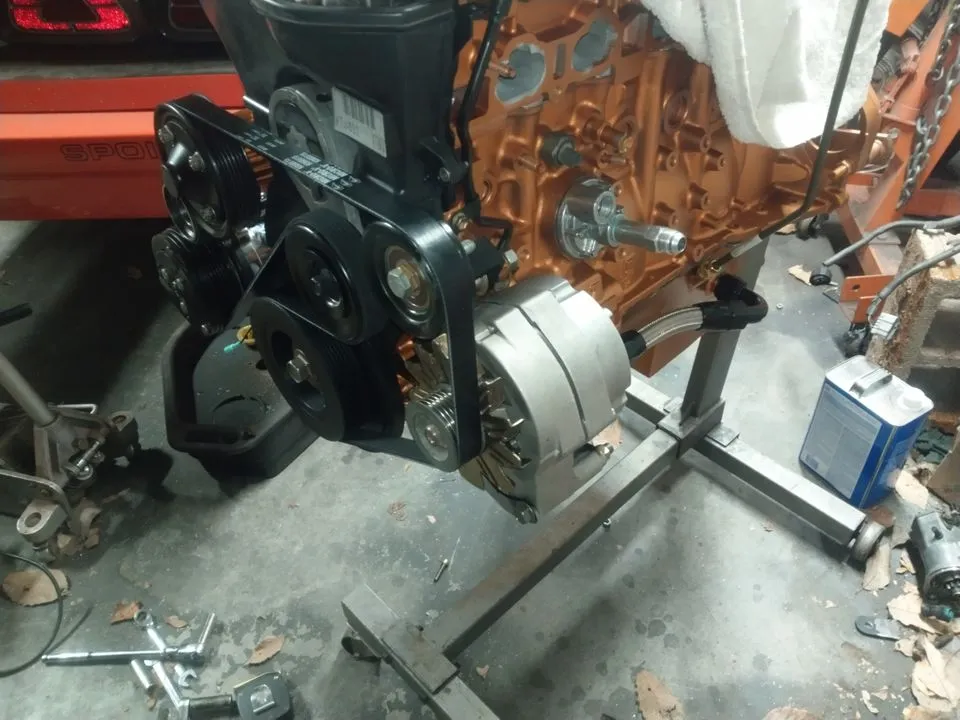

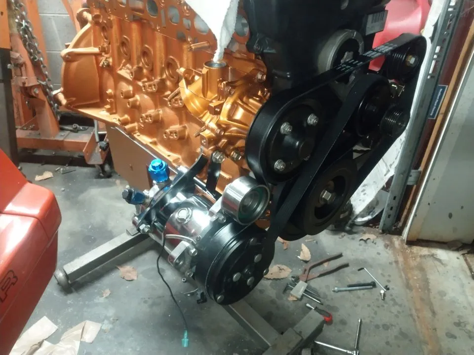

This is a good update. Seems I’m either making japanese stuff fit into domestic stuff, or making domestic stuff fit onto Japanese stuff. One way or the other, it’s the same as jamming square pegs into round holes.
But I’m the king of making square pegs fit into round holes...
Say for instance, .......Ohhhhh....you got a 2Jz. The AC compressor, and power steering pump are on the driver side of the engine, and the alternator is on the passenger side. ( Probably the exact opposite in the car it came off of in Japan)
The AC compressor, is specific to the car, the power steering pump is a remote reservoir variable assist unit requiring a circuit to control that assist, and the alternator...........Who knows?
One things for sure...I know.
I know all of that sht ain’t goin on this engine. MOF,...none of it is.
You might be thinking “But Mike.....if you don’t have an alternator, hows the battery gonna stay charged, if you don’t have an AC compressor, how are you gonna stay cool,......If you don’t have a power steering pump,..How ever are you gonna keep from blowing a nut trying to steer the thing?”
And I’d say: : Calm down,....I got this.
On the passenger side......”What tha.....Is that a Sanden AC Compressor? Wasn’t that what was on the Monster?”
What? ......This Sanden AC compressor?
As a matter of fact.....it is.
But mike...”What about the Alternator?... Whatever will you do there? I thought you had a Ford pattern, one wire, 140 amp alternator?”
I do...
That bitch is upside down,...but it’s mounted.
So then,....let’s recap.
I have a AC compressor that hooks up to the existing AC hoses..
I only need one,...4ga. Wire coming off that alternator to charge the system..
I have electric power steering....I DONT NEED NO STINKIN’ POWER STEERING PUMP.

Nicely done Mike. Hopefully the alternator has enough belt wrap not to slip when the throttle is pressed. Only one way to find out though.
I was not going to say anything about that. Did not want to encourage 'accessory drive V2.

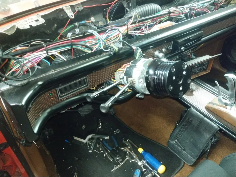

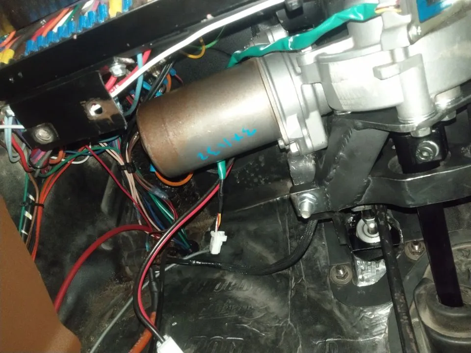

Today I’m off. Im gonna try and get the steering installed, wired, and behind me. The last time it was mocked up, it didn’t fit right. I’m guessing that I have the two mount straps that are in the factory column reversed ( upside down). It’s a potentially easy to change fix. I’ll know about that here in a little bit.
The other issue is how much force is required to get the motor to assist. On the vid that I linked, the dude had the Prius steering gear all hooked up to a battery, and had one end of the steering shaft clamped in a vise. On the steering wheel end, he had a pair of vise grips clamped. All he had to do was seemingly give the vise grips a little nudge, and the motor moved one way or the other.
When I do that on mine,.......it didn’t work so smoothly. It took a lot of effort to get the thing to move. Now how that translates into steering effort once there is a steering wheel on one end, and fully weighted front end on fat tires on the other remains to be seen, but that’s going in today.
I’ll just have to wait till I can get the car on the ground to know for sure.
The other goal is to get the coil pack mounting figured out, and the wires ran to their respective plug. Once I get a mounting system for those coils made, I can start to consider mounting the engine. I didn’t want to have to either lean over the fender, or lay under the car to do that, so getting the coil packs mounted is next after the column.
I may add a shaft support at the firewall for the steering column, and I’ll do that with a 3/4” rod end, but I’ll wait to see how the whole thing feels once it’s all mounted. If anything feels a little wobbly, I’ll support it. Doing that will require welding, and that will keep the engine out of the bay till it’s done. If I had the freakin rod end, I’d just do it anyway cause it won’t hurt, but I don’t.

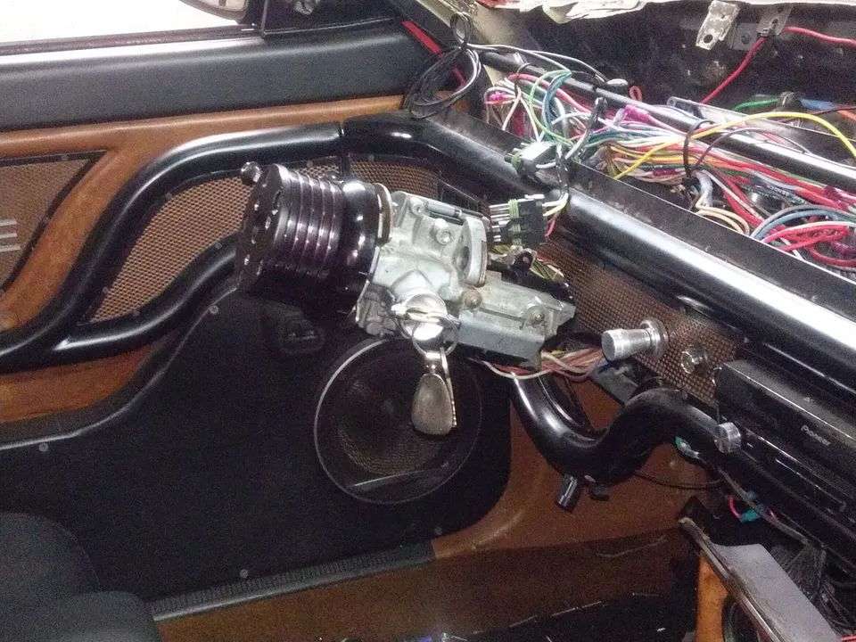

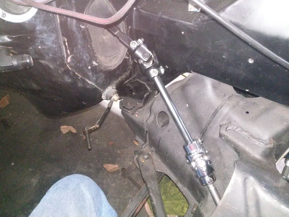

Well,....the steering is mounted.
The column is two pieces. It’s the only way I could get it to fit. The motor assembly is bolted to the 4 anchor points the factory uses to hold the column. It is where all the torque will get transferred from the motor to the steering rack. There is a short 1/4 column that is where all of the electronics are bolted to. I made two tabs that hold the upper shaft to the lower. Additionally, the upper slides into a sleeved coupler to keep it all aligned.
Im good with it.
The motor assembly is completely hidden, it’s way the phck up under the dash. On a factory fox, I’d be concerned that the factory fuse box might interfere with the install,...but you could just tilt the motor down to clear, or flip it over to the other side.
The steering shaft is complete.
What looks like a 200.00 LMR steering shaft is two universal set screw double d joints with a piece of double d shaft that I cut to fit. Total cost was about 100.00. I’m gonna add the rod end at the firewall to add support to that shaft.
Still left to determine is whether the column trim will fit again. It’s really close..I think it’ll work.
the coil packs were last thing, and the mount bracket still need reinforcement,...but Im good with the location.
so,..that’s it,...once that bracket is done, and I get a rod end to support the steering shaft, I’m gonna put the engine in.

I took the head to a machine shop that has been in this city for as long as I’ve been here back in........October?
Back in October if you’ll remember...the guy doing the head, “surfaced“ my head with a belt sander. I had to take it to a machine shop after that fix his phck up. At the same time, the guy at the head shop tells me that he “clearanced” the valves, and basically saved me hours checking and setting the valve clearances using the standard method of checking them after the cams were installed, and replacing shims as required to get the proper clearance.
Well given that he was such a phck up, I decided to check him today.
Every valve is too loose....And now my choices to fix this are minimal.
1..I keep the cams in place, and use a goofy ass tool to compress the spring, and another goofy ass tool to hold the spring down enough so that I can remove the lash cap. I don’t have the tool.
2. I remove the balancer, now torqued in to 270 lbs again, so that I can remove the timing belt, so that I can remove the cams, and remove every single lash cap, so that each one can be measured to determine what can be swapped around to other valves if possible to minimize the expense of doing it right. Then, once I know what lash caps have to be purchased, and what thicknesse,..I can go about the process of sourcing however many of the 24 valves that I cannot get to come into line.
At about 10.00 each.
