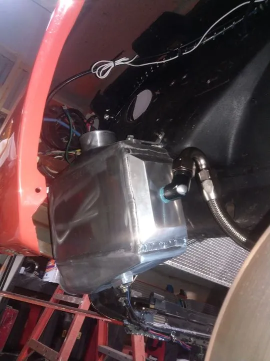

I hung the A2W I/c.
That fitting is the same one that was on the old intercooler,.figured I may as well put it back the way it was.

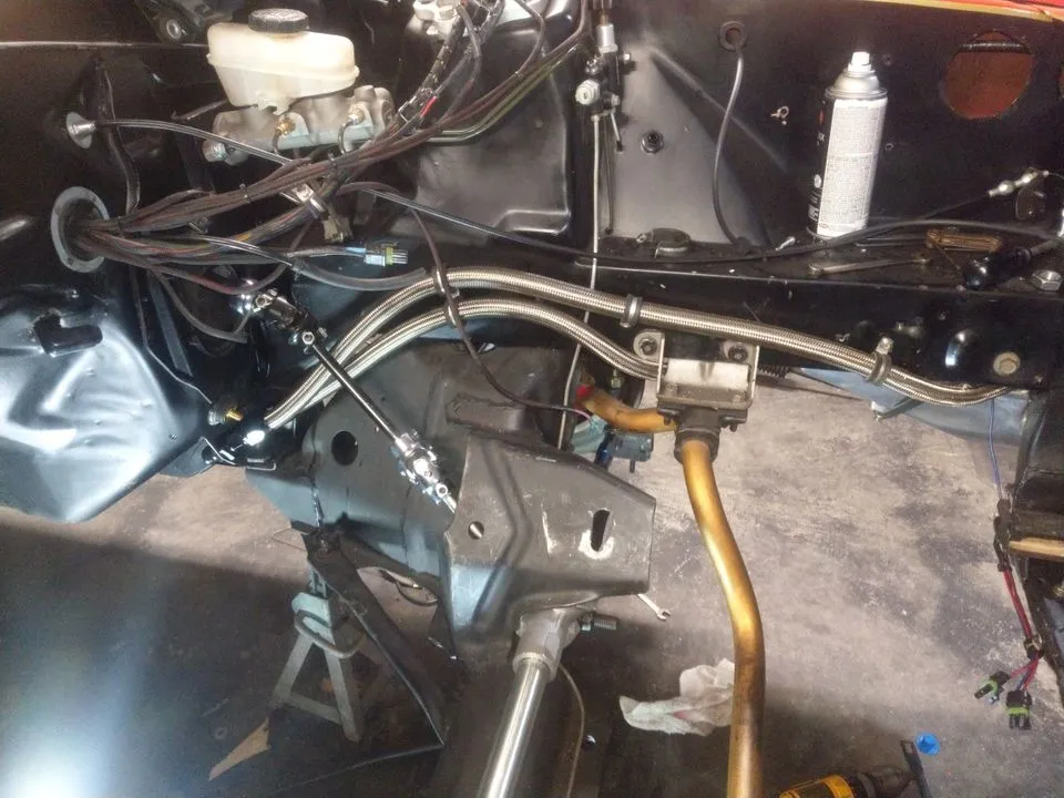

I also ran the engine bay lines to the intercooler...I have all of this -12 stuff left over from trying to get the old monster engine from puking oil..all with stupidly expensive 120-150-180* hose ends attached, so what better place to reuse them bitches.

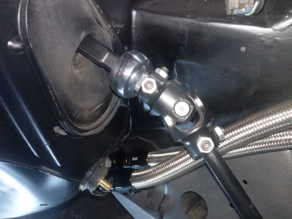

I said I was gonna put a column support using a rod end at the firewall...and that’s what I did..
Which brings me to the final stages...These things needed to get done so that it would be easier to do with the engine out of the bay. Now, I’ve got the accessories mounted, the coil packs mounted, the steering column supported, and the intercooler hoses ran. Once the shims get here, I’ll get that cam clearanced properly, and put the front of the engine back together.

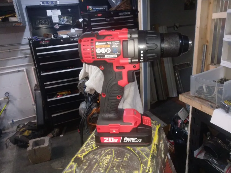

This is a 20v 1/2” drill purchased from HF. They now have 3 different “ tiers” of product in their cordless lineup.
This sweetie cost me 69.00...( said something about “ Compare to Milwaukee “). The guy at the counter wanted to know if I wanted to spend another 20.00 to give the thing a 2 year replacement warranty. ( (I chose not to). When I got home and opened the thing, and chucked up a bit, you can tell by the way that the thing tightened that it would be a problem sooner than later. Nonetheless, I started using it.
It drilled 3 holes and died. I had to dig through the trash can for the receipt.
The only thing that can be compared to Milwaukee with this flaming pile of Doo...is the color....other than that...Milwaukee it ain’t.

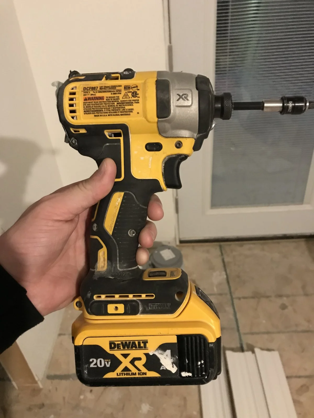

My Dad bought me this cordless impact driver for a “house warming gift.” I’ve been using it almost daily since July and have charged the battery three times since the start. Built several walls, hung tons of drywall, drilled holes in studs for electrical, etc. It’s fallen off the top of the ladder several times and keeps on going. I love it.
I'm surprised...I was hoping their Bauer line was better. I can't complaint though. The only thing I have purchased from HF that hasn't lasted is the $9.99 heat gun. I've gone thru 2 of them doing the wiring on my 85. The first one was kind of cool...it kept working but started to sound like a pulse jet until fire and smoke belched out. The 2nd one last about half as long as the first and just wouldn't turn on one day. The last one I bought is different style and I haven't used it much yet.
Question is, did you swap it out or get a refund and go by a Makita or Dewalt?
What are you guys doing to your tools?
I've had the HF cheapie heat gun for 8 years, still works, and it even did a full re-wire on an Explorer interior harness last year.
The Bauer drill I don't have, but two coworkers at my last shop did and even getting used daily in the dustiest and grittiest shop I've worked in they both had over a year of use on them when I left last week.
