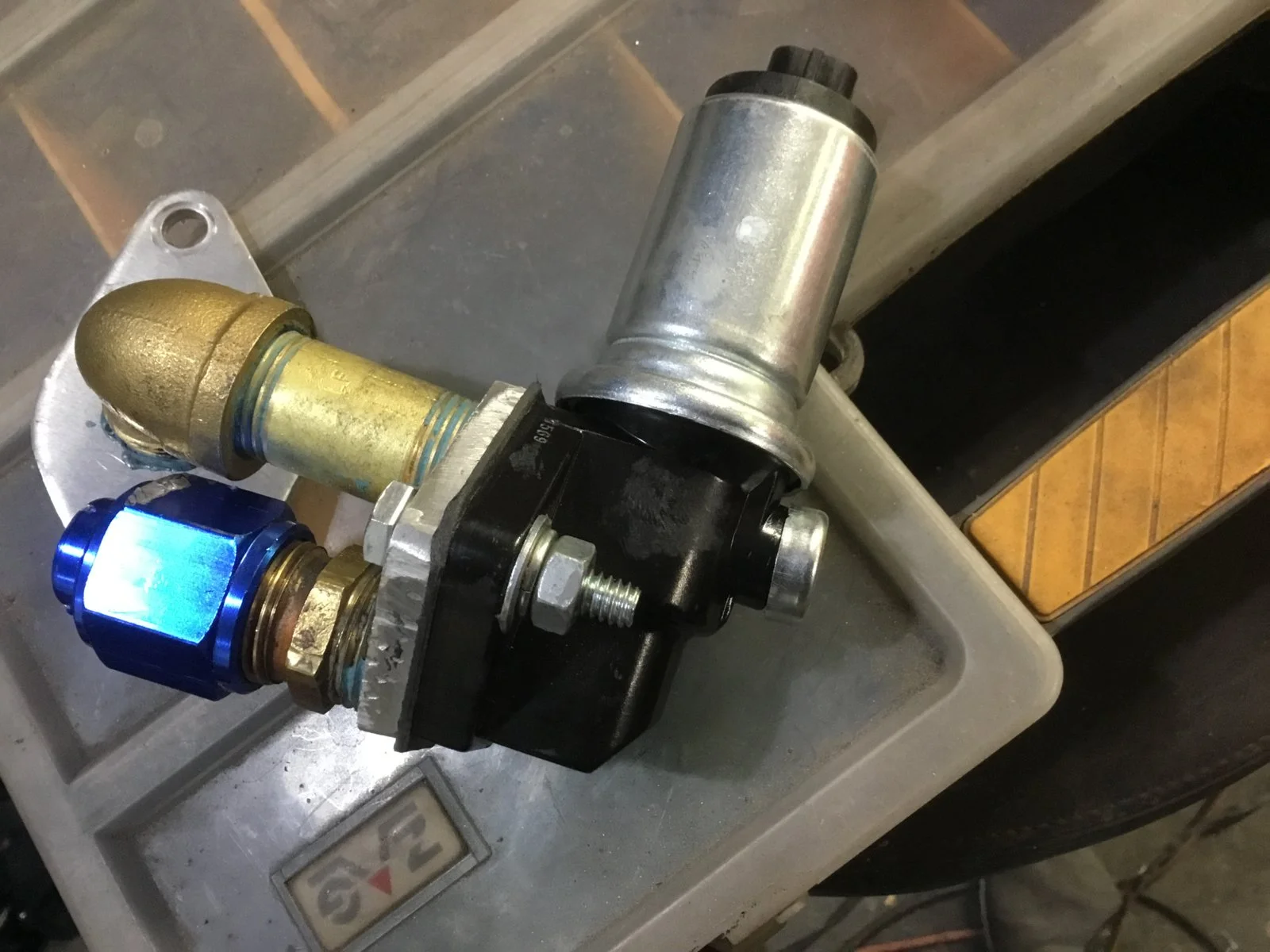

The IAC valve I’m using is effectively an open hole in the intake manifold now..Does this thing get 12v constant from the ECU to hold it closed when running, and pulse on/off to control the air leak to vary the idle speed, or is it supposed to be closed now, and pulse 12v to open it? With this thing under the intake, changing it out once it’s installed will be a bitch, so I kinda need to know. It’s for a 96-04 Mustang.

You dont want it open to atmosphere, it will leak boost. Which version did you get?
The iac should be closed when powered and then open as we command a greater pwm%... even if you manage to get it backwards I should be able to reverse it in the software.
So are you saying I need to tie the air “ supply” side into the charge tube before the throttle body then?

Yes if that's how that particular unit is setup. I assumed you were going to use a tb mounted unit

The IAC valve is a piece of sht.
Fir whatever reason, I decided to cap off one end, and pressurize the thing....( to see if it will hold boost)
Nope,...whatever reason there is a capped whatchamacallit on the thing,...it leaks significantly.
Ive already pried the cap off to see what the hell its purpose is, so it’s just kinda “on” in the pic. It’s obviously supposed to pass air, there is a little filter thing under the cap...as bad as it leaks air, it’s gotta be a non-contender.
Piece of junk.
Nope, the intake manifold has a big assed hole in the bottom. I had to make the above contraption.

get an iac valve for a 87-93 should be a direct swap.

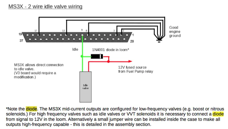

Hey Mike... did you place diodes in the harness in the appropriate places? like across the idle valve? I ask because if you did not it will drive me crazy when i go to get the idle dialed in.
Yes, I was thinking I could do that to the relay board and jumper across the relay socket that was dedicated to the fidle valve.
But after thinking about it, maybe there isn’t sufficient circuitry in place on the MS2 side of the thing to do that w/o having to add some stinking transistor internally. If the 3x side has the stuff in place to support the IAC valve already, ill just make that mod. Otherwise, I was planning to jumper the fidle relay socket. I gotta go to an electronics store tomorrow (if they’re even open to buy from) to buy that little SOB. I’m gonna remove the entire ecu next week, and hook it up to the ms3x capable jimstim I built a couple of months ago to test stuff as well.

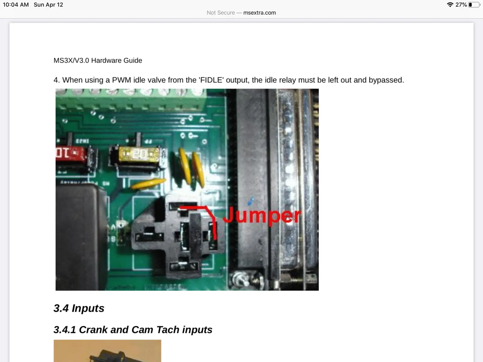

What does a ”like“ mean?
Can I use the relay board as it with that jumper, or am I using pin 9 on the ms3x output?

Well Mike I assumed you would place the jumper and test it with the stim. I dont see why it would not work with the jumper in place, the fiddle output comes off the ms3 mainboard.

I don’t have anyway to test the relay board, and it’s hooked up to the main connector. If that pin 9 you’re referencing is on the 3x connector, wouldn’t it be a separate circuit?

Fiddle is on the mainboard just like with the ms2.

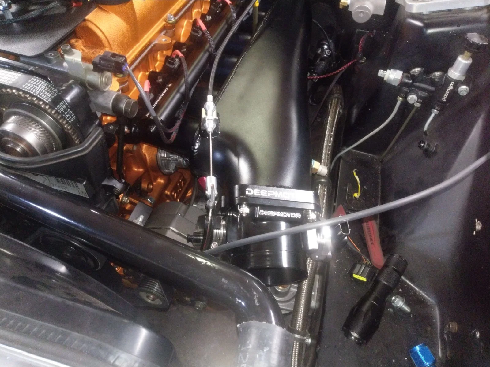

Well,..I guess I just have to do things 3 times. The solution was a slot. It’s still not a perfect fit, but it’s much better.
Up in the air is the throttle linkage. It had to be two pieces because the Japanee throttle body uses a different attachment style than the cable I had. The cable that wraps around the TB connects to the one mounted on the manifold. ( which is now permanently attached.)
