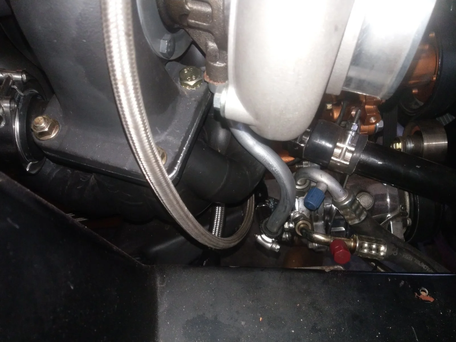

The turbo drain was a jug phck. The intake manifold puts the turbo drain immediately above one of the exhaust tubes. A drain tube would have to make a zig-zag to get past it. I thought I had the problem solved with a 90 degree AN fitting, but that was not to be. I couldn’t get to the fitting to tighten it, and it interfered with the compressor housing.
It took too long to remedy.
Made out of hardline aluminum at the top, and a piece of nylon braided hose at the bottom,...you can see the freakin Jinky I had to make to get it past that tube. I actually had the entire tube made out of aluminum, but decided that extension from heat may stress the tube, and cause it to crack or split. So I added the rubber hose as an expansion joint.

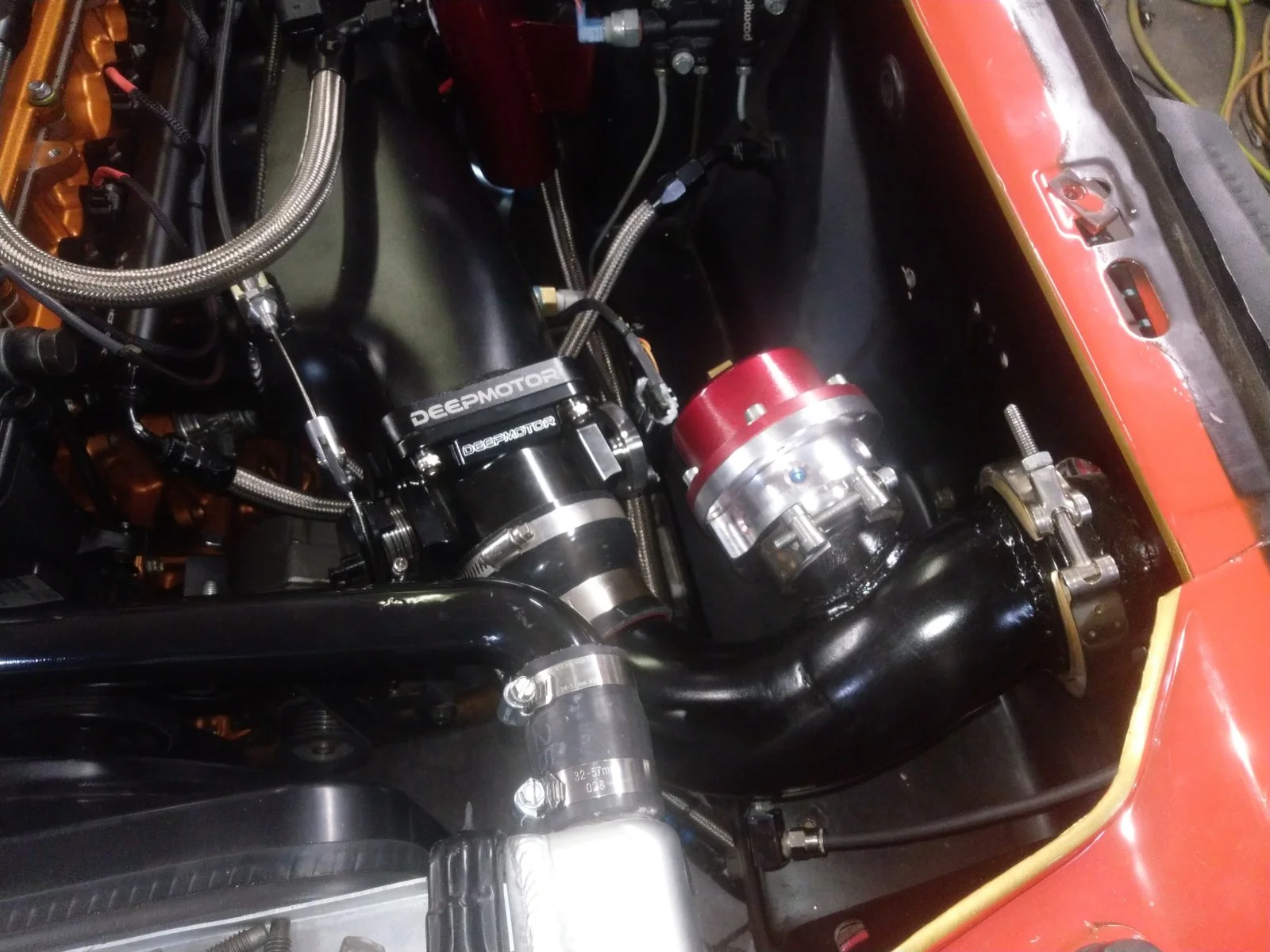

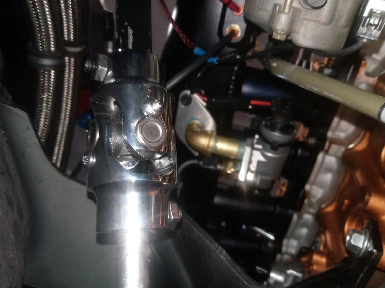

On the other side, the new IAC valve is now installed. I used one from some 2001-2010 Ford V6. This one don’t leak, and as installed is closed. 12v opens it. What should’ve been a simple cut to fit task, again turned into an ordeal. In actuality, it was the first project I tackled this morning. The hose that I planned on using was already assembled. One end was straight, one end had a 90 on it. Last night, I screwed the straight end on the IAC valve inlet, and eyeballed where I would have to drill in the -10 fitting in the charge tube. This morning, I drilled it and installed that fitting. Put the charge tube back on, and clamped the v band down to hold everything in place.
the hose that was already attached on one end wouldn’t work now. The fitting was at a wonky angle, and the 90 wouldn’t screw on...(To say that I was bitching out loud,.......really, really loud bitching................ is minimal). I decided to bail on that hose, and make a new longer one. The problem was ( at the time) that I didn’t know what I was gonna need “ angle wise, on the hose end fittings. I only have a few -10 hose fittings, and I had to be considerate of that because I hadn’t started on the turbo drain yet....

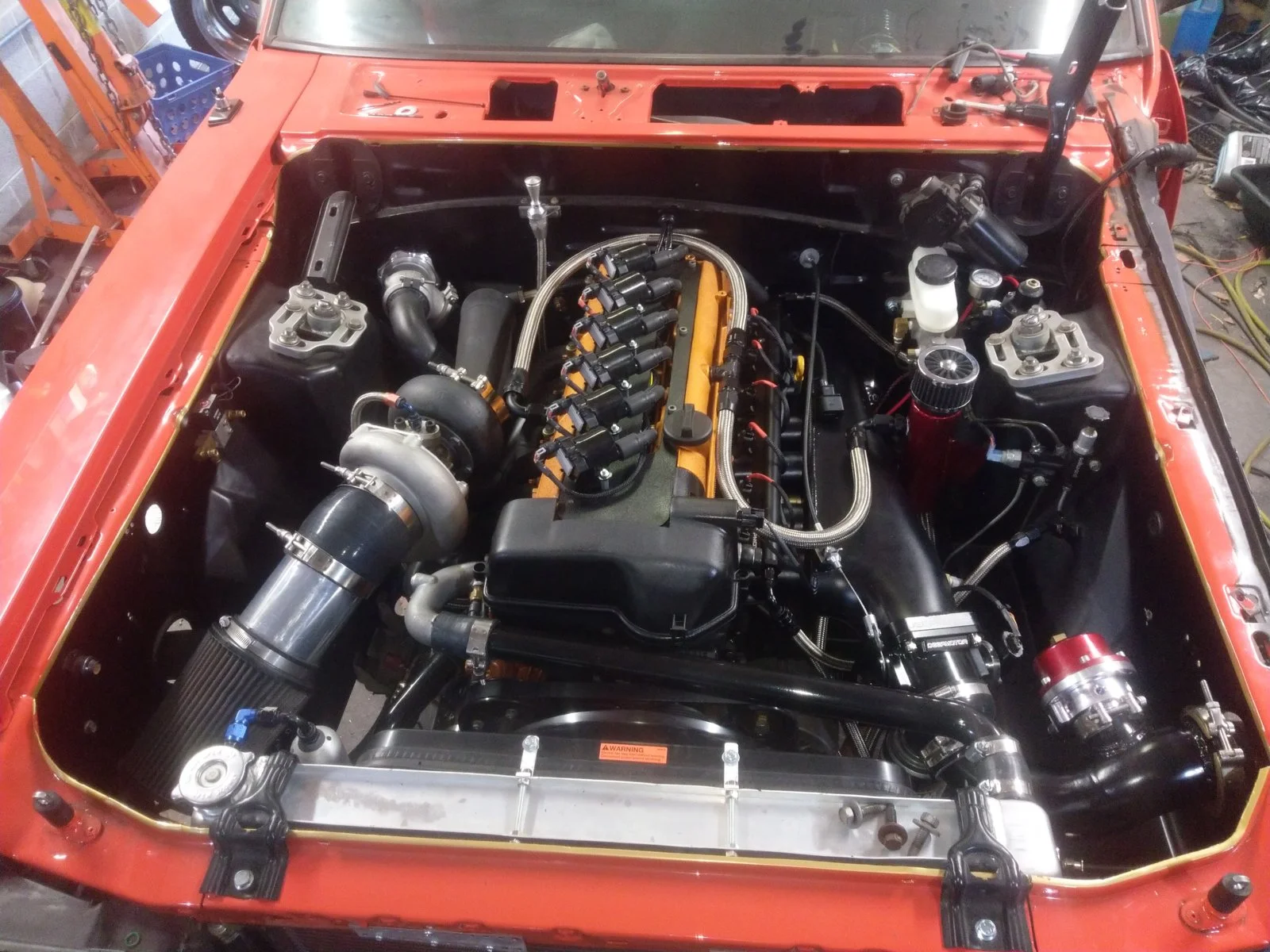

I figure out the IAC, I figure out the drain tube..I figure out the overflow bottle,....I figure out a whole bunch of sht.
This is it. This is what it looks like when you open the hood of my car in 2020.
A couple of days ago, I said that the new engine aesthetic would pale when comparing it to the old engine.....Now that everything is done,...I’m thinking that that isn’t gonna be an issue.
Lastly,...the charge tube..( Nobodies seen the completed charge tube with the all new and improved “ have to look it up on the internet V band clamp).
So,........
That thing is the sht. IAC supply on the bottom, water methanol injector in the back side, and my Chinee BOV standing all high and proud...with a 3” V band holding it together,........and red.)

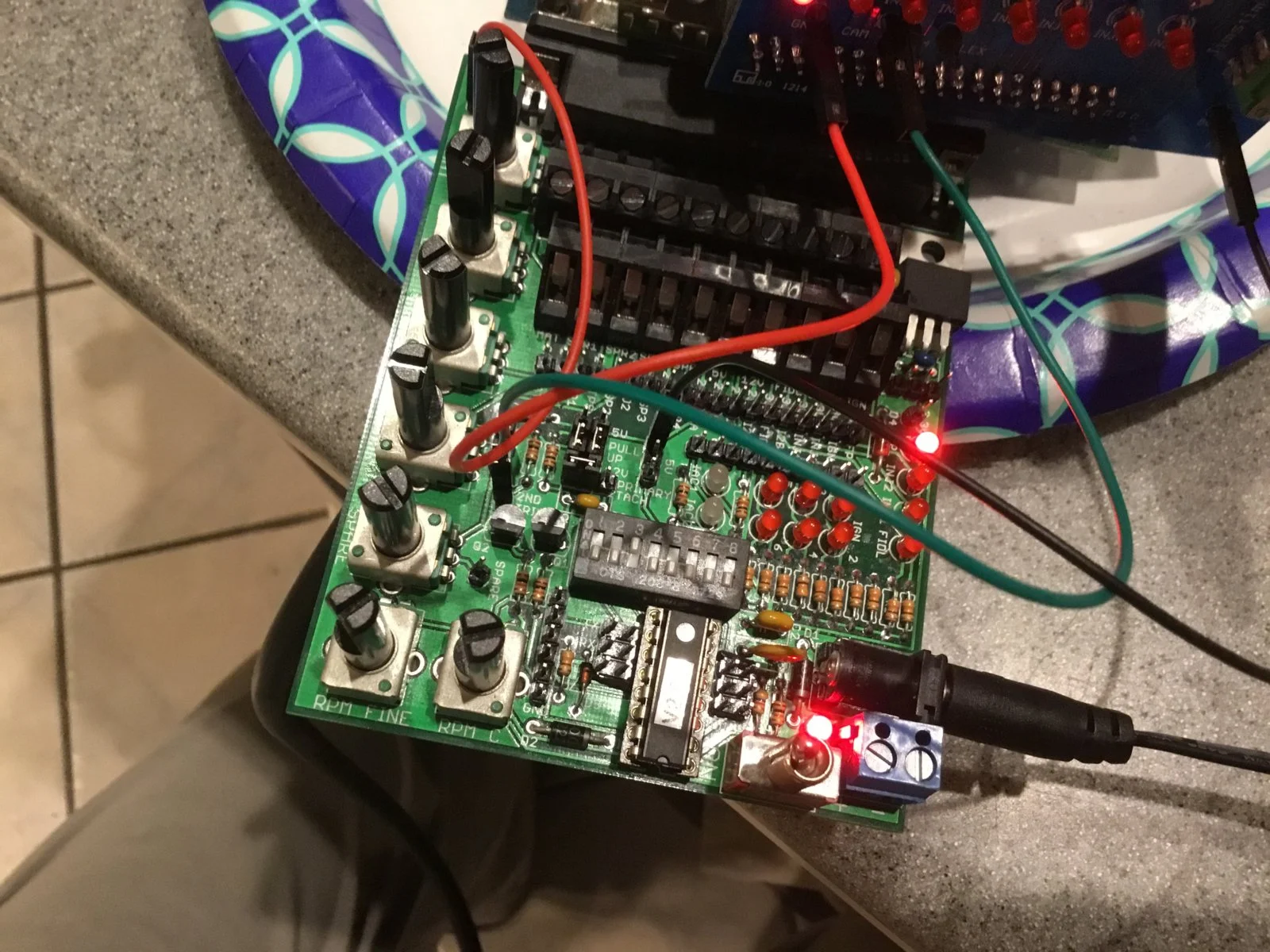

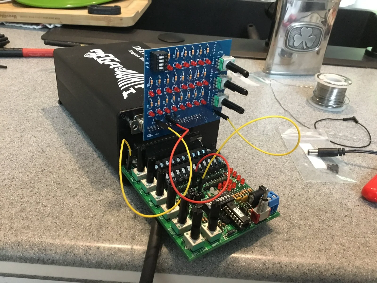

Here I sit this morning (in my jammies) trying to figure out this freakin pain in the ass Jimstim and ms3x expansion card. If it hasn’t been said already about a bagillion times, by about a bagillion people, the most frustrating thing about using this freakin system is the lack of documentation out there so you can self help.
The jimstim has dipswitches so that the board can be configured to match your engines’ specific tooth wheel count. When you go and try to find one that matches mine..( supposed to be a 36-2), there is absolutely nothing out there.
For what was supposed to be such a prolific iconic engine, there is a remarkably small amount if sht out there to work from..Put the letters LS in a YouTube search bar, and you’ll find every freakin thing under the sun you’d ever want to know, with updated stuff occurring that minute.
Put 2jzgte in there instead.........and you get old crotchety sht from 10 years ago. :nonono:
Tunerstudio has a VVTI setting in the ignition config. I’ve already started building a base setup up for the new engine.
But to be that much ahead of the game, I wanted to check see if the ecu was gonna fire the injectors, and coils sequentially like it’s supposed to.
That ain’t gonna happen until I can:
A. Find the correct dip switch setting to emulate my trigger wheel.
B. Not have to freakin guess how to wire the two boards together.
I don’t see how anybody ever gets this sht working right....and this coming from the quintessential Do It Yourselfer.
Whew..... :nonono:

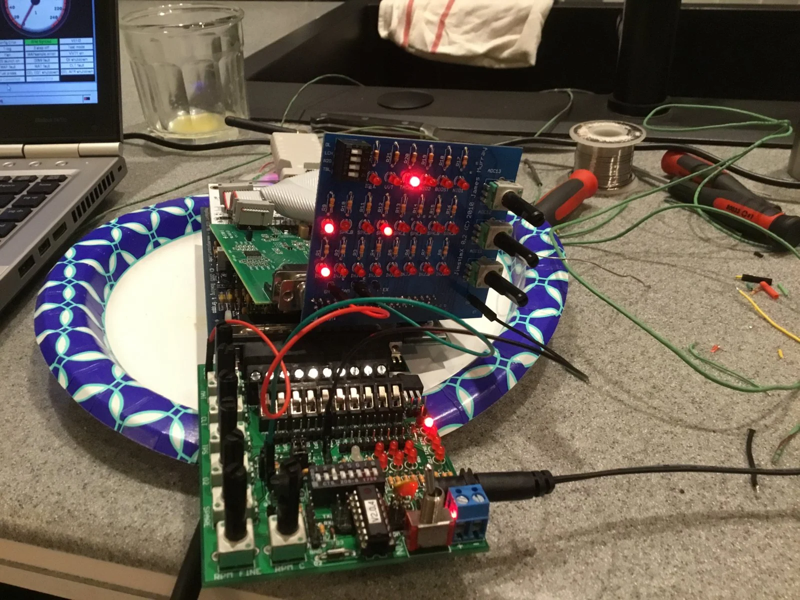

After literally sitting in the same spot since this morning, and almost completely returning my ECU to a pre-fcked up state by reversing every mod I‘ve made to the thing since it was a lowly MS2,....I have removed the boost mod, reinstalled all of the LEDs, and undid everything that was configured for EDIS. It is now set up as a VR sensor type of ignition.
This is where I am as of this minute.
Those lights are strobing away,...How I go there was purely by accident.
According to the Jimstim instructions, this is wrong. All day long Ive had that shorting jumper that is right above the dip switches moved over one pin to the right. That is supposed to be VR emulation. Having it that way however wouldn’t do dick.
Moving it one pin to the left, brought about the light show that you see above, but that mode is supposed to be Hall effect emulation, and my ECU is not configured in that way. it has taken me all day to make that move.
Tunerstudio is telling me that I have a cam fault. I’m sure it’s something in the way I’ve got the jimstim wired..( be nice if there was actually an instruction booklet).
