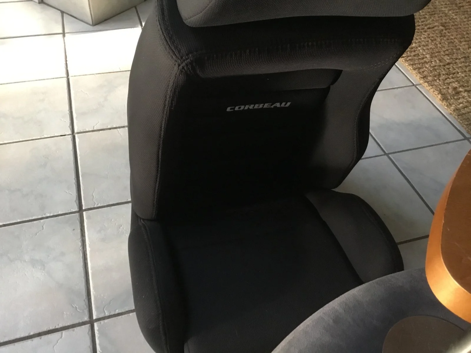

This is a picture of my new Corbeau driver side seat that I’ve shamed it so bad, it’s actually bowing it’s head.
Like a dog you caught eating the cat food, or tearing up a shoe.
I bought these in October of 18. Given that the car has spent the first part of 19 getting the old engine rebuilt, and converted back to turbo, and didn’t actually run till around May-June, and has definitely spent the entirety of the last two months, and all of this year so far not running,......Simple math puts the actual time I could’ve sat on the seats at about 4-6 months.
For most of you here that read this, you’ll also know that the time it did get driven was occasional at best.
So we’ll say they’ve actually been sat in for a total of 5-6 hours...Over the period of a little more than a year and a half.
When I went downstairs to work on the car yesterday, I noticed what looked like a deformation on the driver side bottom cushion side bolster......The foam under the fabric had torn/separated and was now exposing a metal rod that you could see under the fabric they used to make the seat frame.
I looked on line and checked Corbeau‘s warranty..........1 year
Fortunately,.....I purchased them from Summit. Summit called Corbeau, and somehow convinced them to extend the warranty, and have issued a call tag to pick this one up today. I have to go to HD to get a freakin box big enough to put the seat in, but it’s all good.
What isn’t all good is the fact that they failed as quickly as they did, with very little actual usage.
A Recaro they’re not.

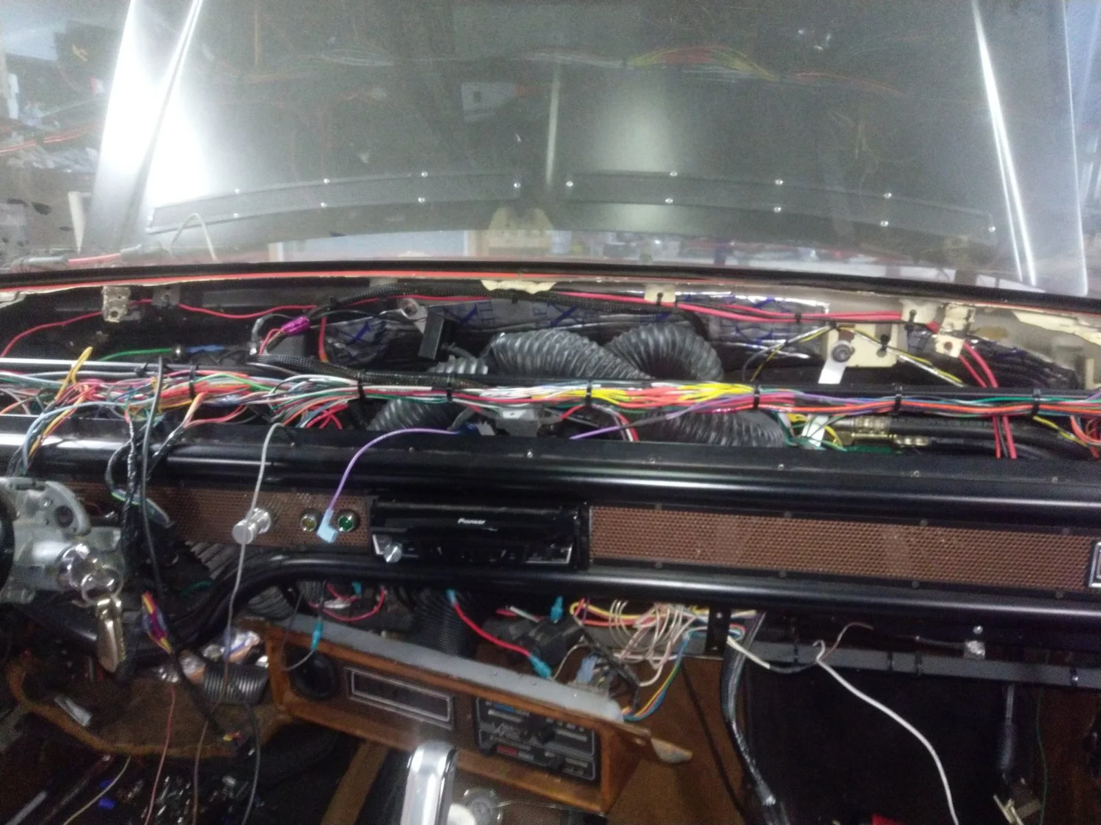

Whether or not you find this to be organized, or a freakin disaster depends on your level of electrical expertise. For me..it’s better than most, not as good as others...All I want is for the freakin thing to work.

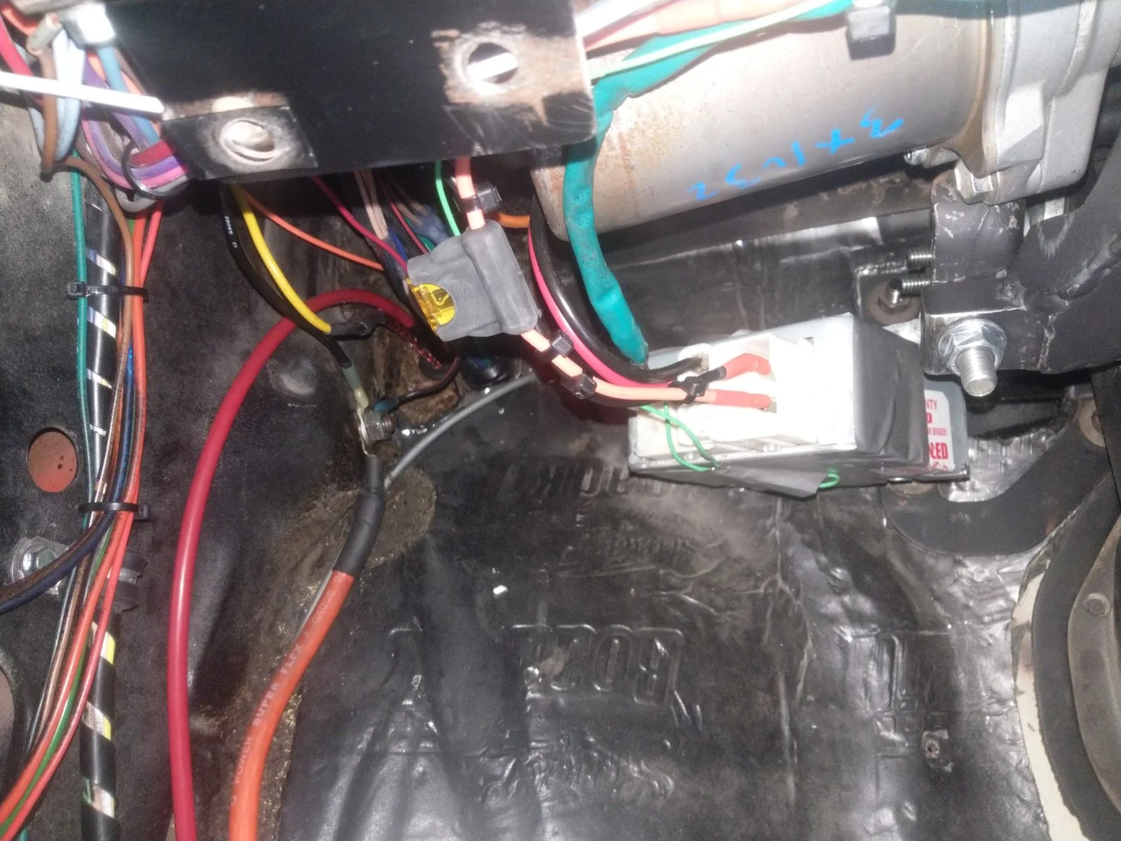

This is the EPS unit. It’s now wired in completely...Can’t wait to try this out.

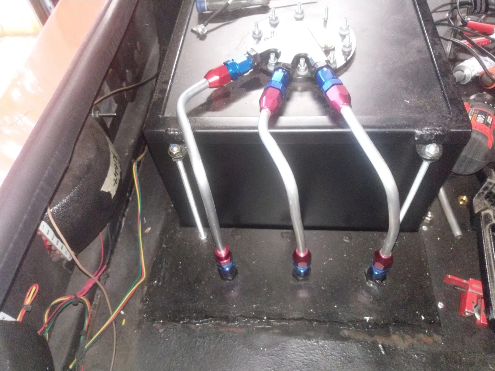

The fuel lines are now complete, I still have to connect the pump, and the fuel level sender.

Even though your wiring looks like a mild rat's nest to me, I'm sure all your connections are correct. I'm also sure that the right gauge wires have been used. I'm going through my wiring as we speak. I'm at the point now where I'm pondering whether someone else would be able to look at my wiring and tell what's going on. If the car was sold and I was nowhere around ( possibly dead ) would anyone know what to do with all these wires. I've started putting tabs and color coding stuff. Part of it is because my memory hasn't been the best since my stroke. The other part is because my wife has no idea how to fix this stuff and my kids don't either. My wiring is nowhere near perfect either...but my connections are right...everything is fused that should be...the right gauges are used.

Is that Prius EPS gonna work,?..my bench test required a fair amount of torque before the torque sensor triggered the motor.

The battery 12v is running through a relay. The ecu ground is a pin on the relaySorry I have been slow to respond Mike but been busy. Anything the ECU is going to control needs switched ignition 12v power. If you feed it with battery power the SS components will allow current to flow when the key is off due to how the transistors function.
is the other side of the relay to switched power? just making sureThe battery 12v is running through a relay. The ecu ground is a pin on the relay
Nope,..both are tied together..I’m guessing you are telling me that I need to add percentage points back to my completion table?is the other side of the relay to switched power? just making sure
Yessir or the relay will turn on when you turn the key off.Nope,..both are tied together..I’m guessing you are telling me that I need to add percentage points back to my completion table?
