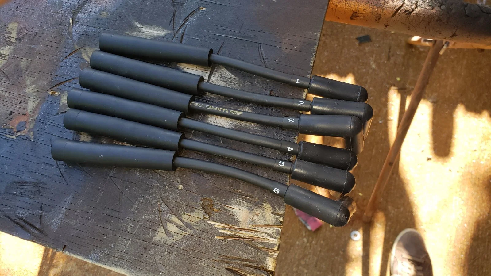

Well,.... Coil six was doa.
I don’t know what was going on with 2, but that coil pack is firing .
At least it was firing.
All of that Mexican built sht is in the same box that the other 8 LS coils are in. I ordered the Ign1a coils, and the crimp connector pins and socket so that I could build the new pigtails. 478.00 to my door. Should be here Tuesday.
Preemptively, I modified the coil mount plate for the new plug wire angle. The new plug wires will have a 90 degree head, whereas the old ones were on a 45. That means that the slot needed to be elongated so that the plug wires will be more lined up than they were before.
I built the plug wires...
Hopefully they’ll work.
Theres just too much at stake to have a freakin coil pack fail. And everything you read about these aftermarket GM coils is rifled with people complaining about doa failures, or at some point after install.
I ain’t having any of that sht. As stated,...I expect to be able to go anywhere in this car,..and I expect to be able to get back home.
There are no more leaks,..but just to be safe the car is back in the air, and it’ll stay there till after it’s running well enough to heat cycle the engine.
The other Corbeau should be here mid week, the coils on tuesday ( I think that’s my “ day off“) . It’ll be hard going back to work, I was getting real used to doing what I wanted...But w/o any money, ( gotta work to get paid) stayin home will have to wait 3 more years.
Reactions: xecute, Olivethefet and RaggedGT
