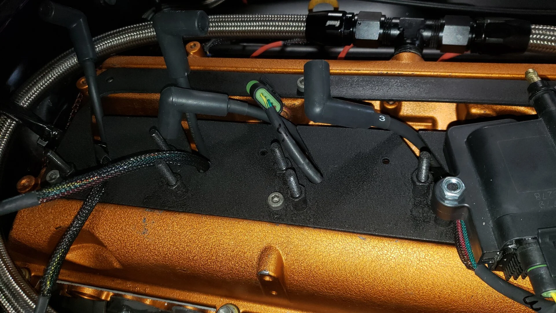

Well, I’m back to a “normal” work schedule. We were busy yesterday as well ( like normal) I sold two cars. Despite that,.........it’s far from normal.
I planned to let this thread keep sliding into obscurity ( at the bottom of page two,) until it was running, or about to be. I guess I’ll settle for the latter.
The coils came in yesterday. Since I’m back in normal work mode, that leaves any progress to be made relegated to my day off. Today, is now my day off.
And since I’m talking about the coils, they are significantly bigger than the D585 units. The bolt hole spacing is also wider, the things are longer, they are heavier, thicker, and taller. Nothing fits. I cannot use the old bunch of screws and spacers either, as the coil body is thicker. Im gonna need longer screws, and drill more holes.
Additionally, they are GROUNDED. Of the 5 wires that goes to the coil pack, 3 of them are grounds. One to the block, one to the battery, and one to the ecu directly. I don’t know why other than ensuring that these things won’t misfire from lack of it, but they are.
The one wire I had to add was the direct ecu ground. Fortunately ( like I almost expected I’d need it) I left one of the ecu ground wires unconnected, and accessible under the dash. All I’ll have to do is get a wire to it from the new coil packs now.

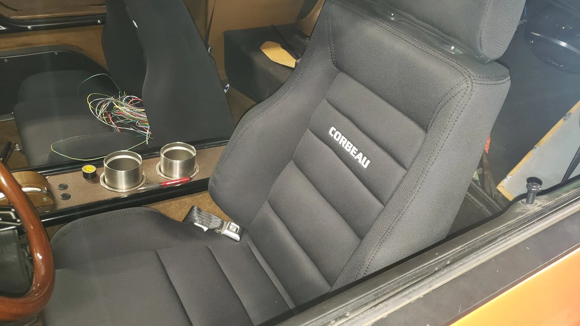

My new replacement Corbeau will be here today as well. 4 bolts to bolt the bracket to it, four nuts to hold the whole mess in the car. ( If only everything was as easy)

You'd think that if I had the whole day and all I had to do was drill some holes, and mount 6 coils, rewire the connectors, and screw four bolts into the base of a new seat, I’d at least‘ve had that to show.
Nope.
I got all of the new holes drilled, the longer bolts purchased, ( had to go back twice), and got them mounted, using 1/2” spacers.
The coils still don’t stand off the plate high enough to allow the plate to sit down on the cam covers properly.
I got all of the connectors rewired, including the additional ground wire, but for some reason, one of the six “ legs” that comes off the main trunk line is now just a little too short. And as a result, a little too tight. I didn’t have anymore the braided nylon wrap that I used to cover the wiring in, so I had to try and reuse it. That didn’t turn out as hoped. The main trunk line can no longer be put under the plate, and it has to sit on top....exposed. It wasn’t wired to be exposed, so I wrapped it in electrical tape.
I hate the way the whole freakin thing looks.....I’m redoing it.
I did test them. They work. Allllll of them work. But that don’t matter, I’m gonna cut the harness up.

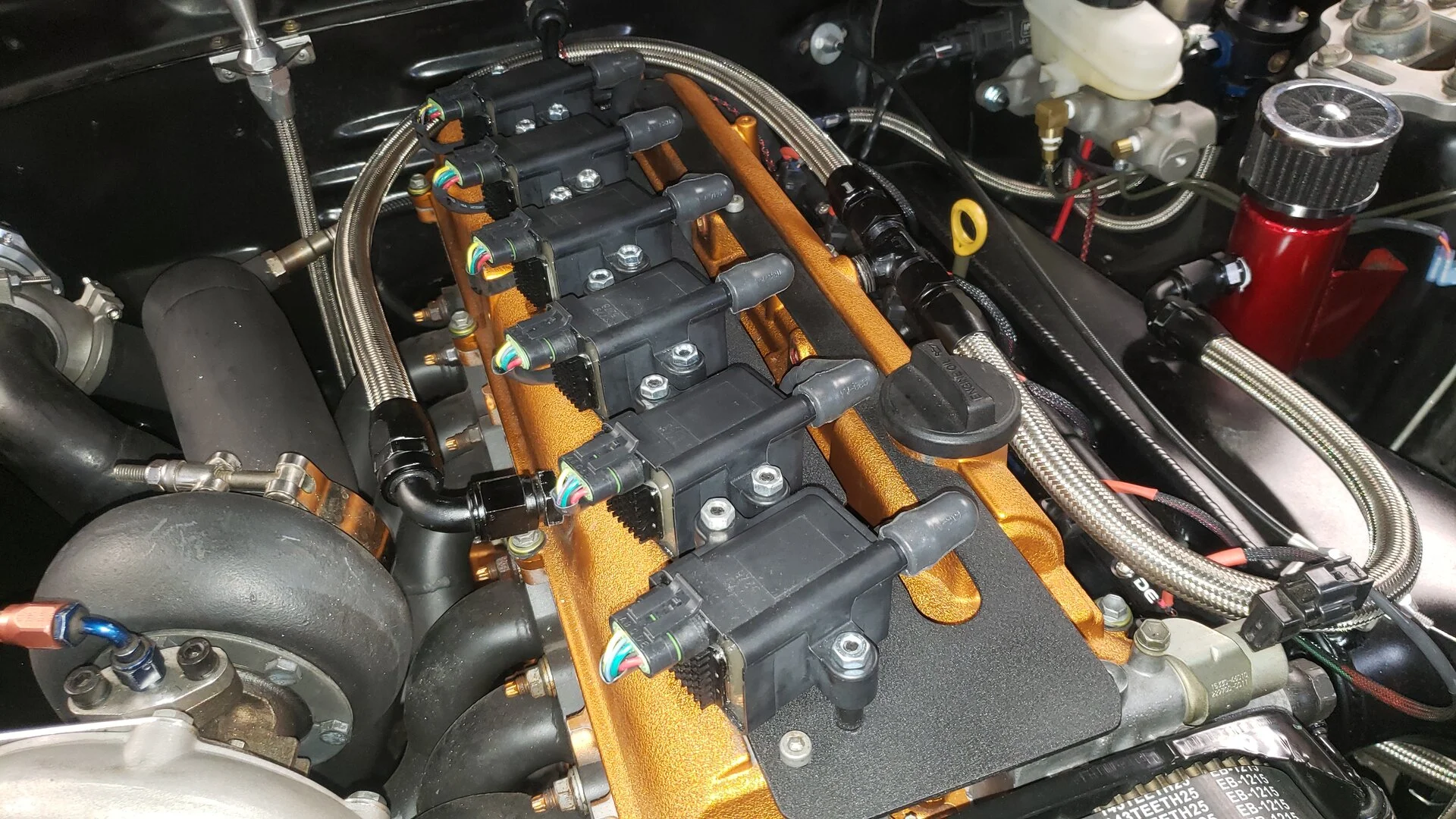

It still won’t run. all it’ll do is choke, and gag, cough and sputter at about 500 rpm. I took probably as much as 40 percent out of the fuel map, and modified the After start enrichment down significantly. despite that, the thing won’t run.
Piece
of
Sht.
Im gonna dumb it down. the COP will remain, but i’ll convert it to wasted spark. the injection will be batch fired. That’ll take the cam sensor out of the equation. I don’t know how any of that will affect the VVTI, but if it ends up where i can’t advance the cam, and it just stays straight up like a regular 2jz, then i’m good.
Fck technology.
Now that the rant is behind me however,...
I did solve the coil mount dilemma.
The fix made the plate look like a fish bone.
The diagonal slots allow me to run the connector cables under the new coils. Didn’t have to lengthen the wires, they are all too long now....I think they look great.
( too bad all it is is a photo op)
I put the seat in..
This is so i have a place to sit when i make engine running noises.
