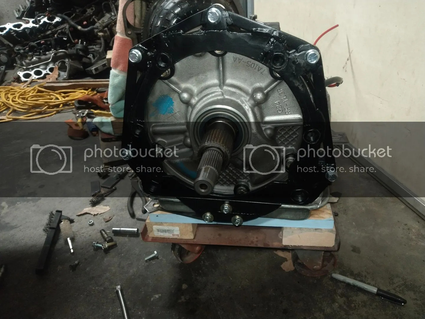

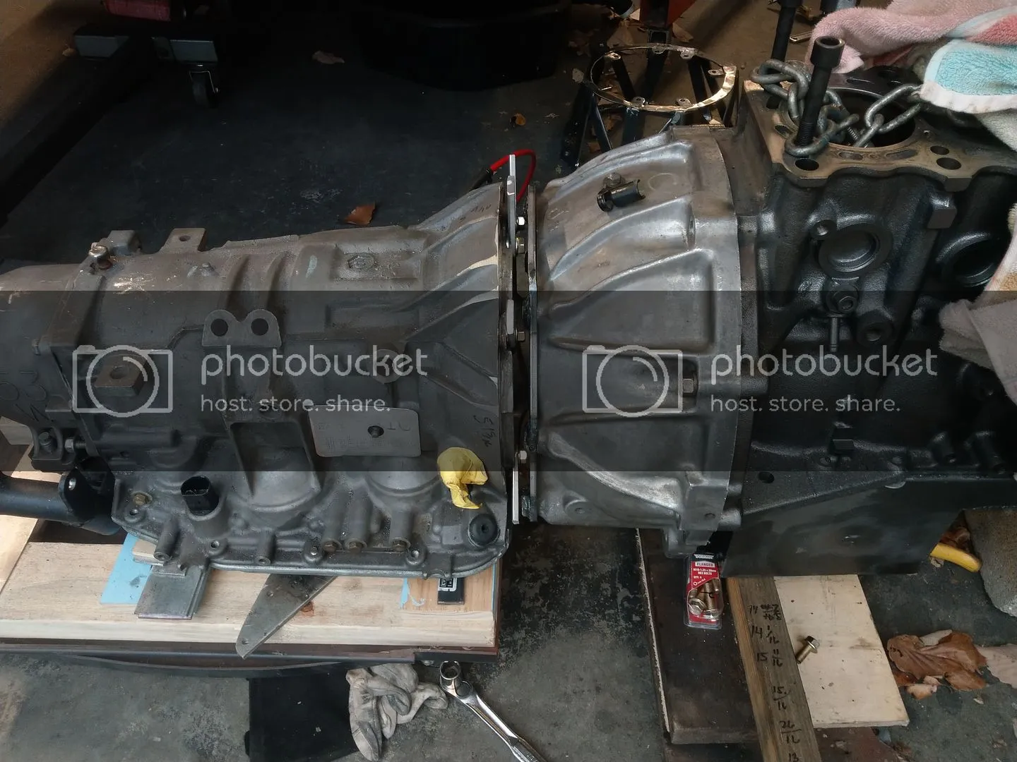

There was a hidden trans leak that left a decent puddle after cranking...I must’ve hit one of the two male -6 fittings line fittings with a hammer or something when I was cutting off the bell, or making the adapter plate, cause that top line fitting was mangulated. ( Had the engine started and ran like it was supposed to,.....the puddle would’ve been epic.)
You remember the WTF bell housing adapter stage.....Where i decided to cut off the 4r70w bell,...cut notches in the front pump, and make this goofy ass adapter to allow the A340 bell that fits the 2 jz to bolt on....
( phuckin photobucket....they claim that this is a “small” watermark in the corner of the pic,...as many photos as they have of mine that are now being stored, they wanna charge me 13.00 a month to access them.....they can go phck themselves)
Anyway,...when the engine was “ old monster”, and noisy as hell, who knows what other clicking/clunking/whirring noises were also going on at the same time.
Now that I have the new monster engine,...and despite the fact that it has only chugged and choked for a few seconds......
I got a whirring noise now.
The suspicion is that the starter is hanging and remains engaged while the engine runs. Except, every time that i’ve gotten under the car to check that, ( after the engine has stopped) the starter is where it’s supposed to be. So,...maybe it hangs while the engine is running, and retracts when the engine stops.
A potential bad thing I know, but the adapting process has nothing to do with causing it. The starter bolts to the block.
Nonetheless....I changed stuff relative to that.
What I changed was the flexplate, and it’s spacing off the rear of the engine . ( Both very relative to the problem). I guess if I have to, I can shim the starter away from that, but i’ll have to make that shim. On the other hand, I could just need a new starter..it is the stock unit, and it is.....like the engine........20 years old?
