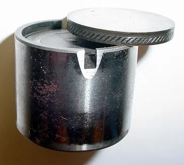

Mike, way back when I worked in John Deere's engine works they had hardened caps for the valve tips, you could research that option. But then you may have problems shimming your valve train properly. Just a thought....

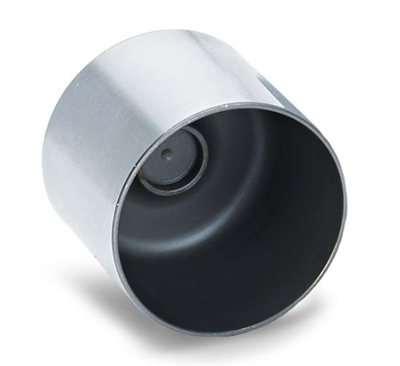

Sharing this link as an example:
A 2jz has what’s called a spring bucket that sits on top of the spring and retainer.
The variable shim is shown sitting on top. Both pieces are hardened.
The underside has a male protrusion that makes contact with the valve tip. And this whole mess moves as a unit with the spring......at 7500 rpm.
But still infinitely lighter than a lifter, pushrod, rocker arm and THEN...adding a retainer, spring, and valve.
They make a much lighter option called a shimless bucket, and they are built in varying thickness to eliminate the shim altogether. Instead of varying thickness on top, they just increase/decrease the length of the contact area with the valve tip. ( the above pic is the underside of a shimless bucket), The obvious benefit being less valvetrain weight..
I’m not buying those things. They are for full tilt 2j builds that’ll see north of 8k rpm, and usually go right along with titanium retainers and light weight valves. Cost about 500.00

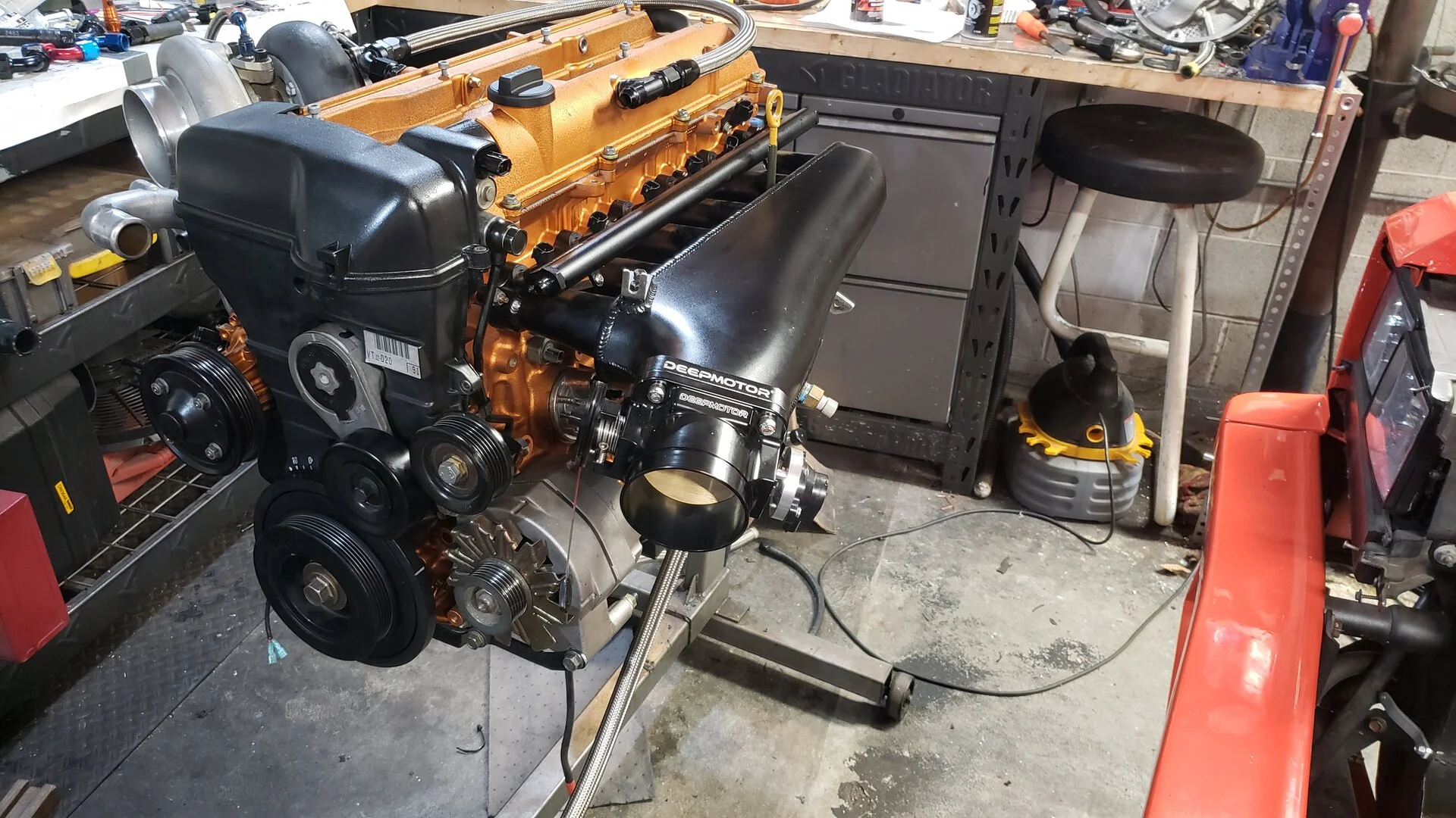

The engine is done ( again).

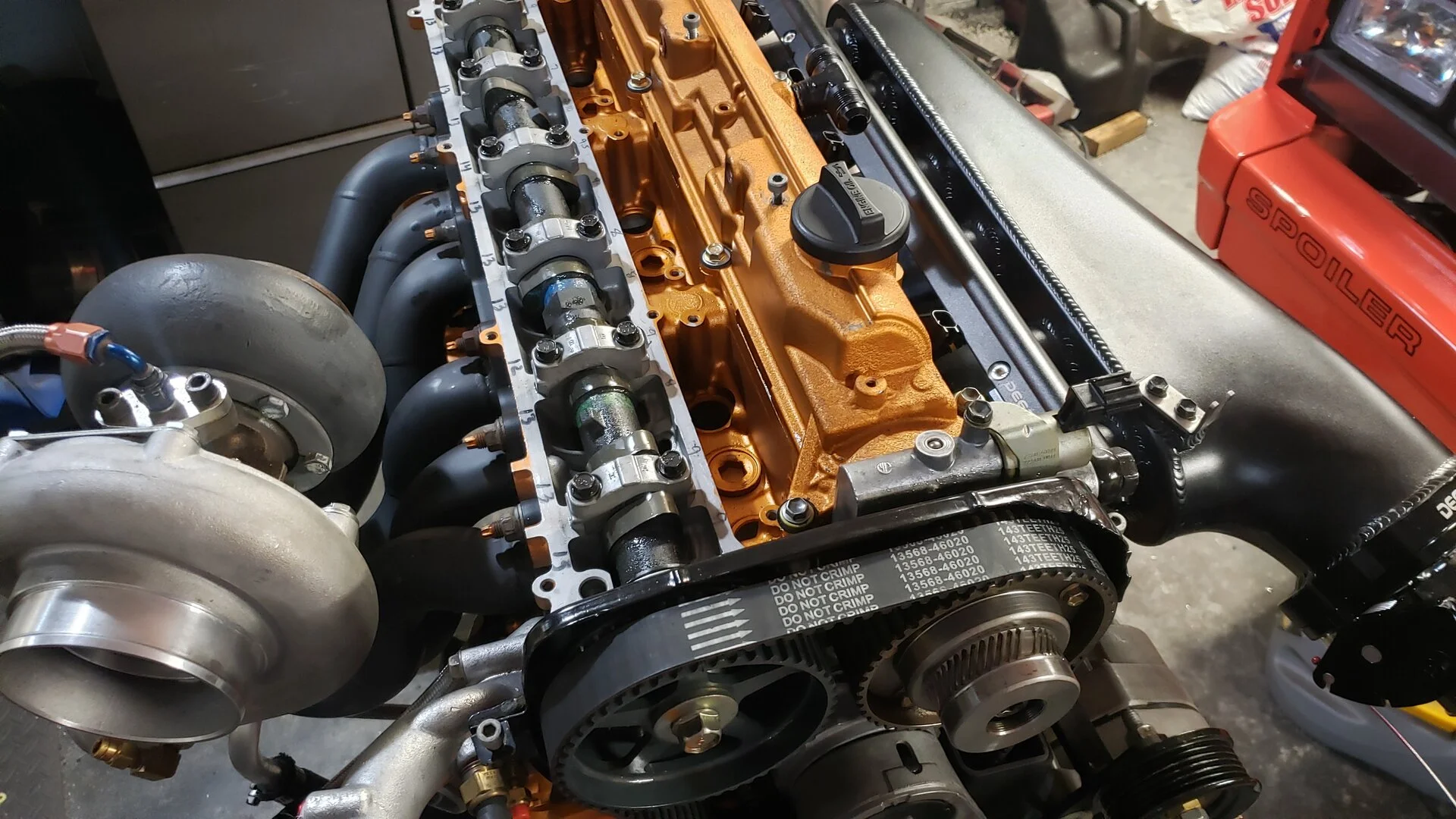

The Cams are clearanced. All but one valve is within spec, and the only one that isn’t is only .001 over. I’m not gonna obsess over that.
You c an see the clearance I started with, and where it ended based on the written numbers on the valve cover rail. After spending 150.00 bucks on shims, turns out I’m dyslexic.
( The shims I ordered were too thick..I needed to increase the clearance, not reduce it.)
The good thing in this is that I only needed two of the 12 shims to get the cams where they needed to be...Hopefully they’ll let me take the things back for a refund.
The pan has had 5 qts of oil in it all day..Filling it showed no signs of leakage, I’m hoping it’s finally fixed. Since this pic the AC compressor, and drive belt is back on,...Now it’s a matter or waiting on the converter to get here.

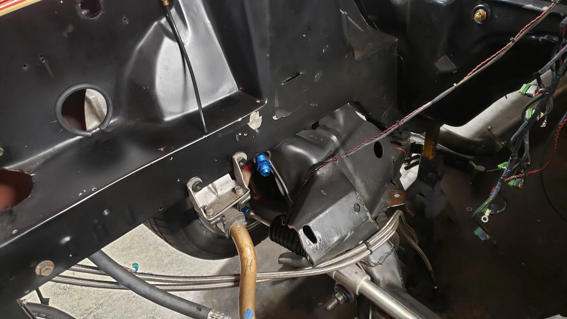

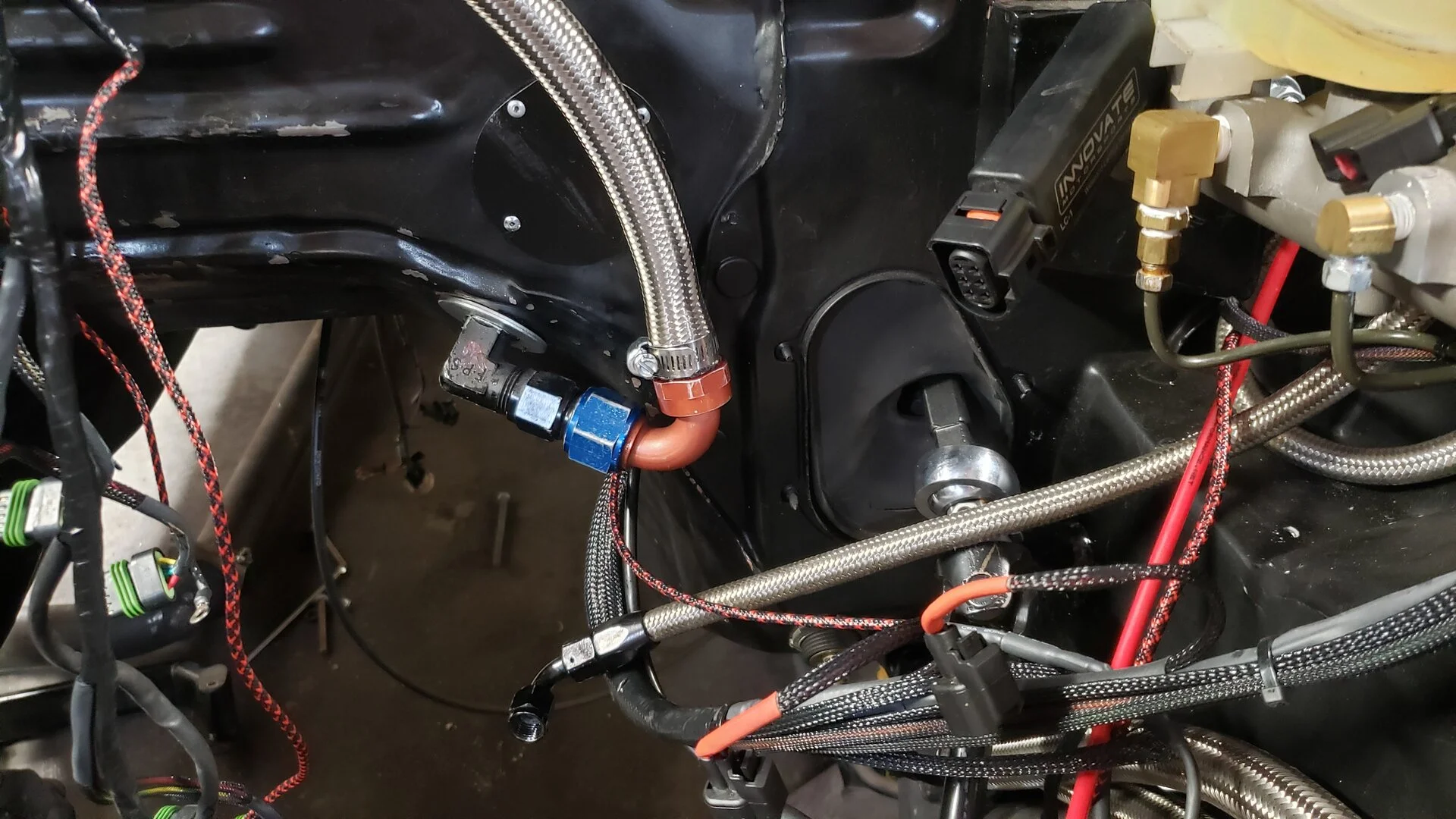

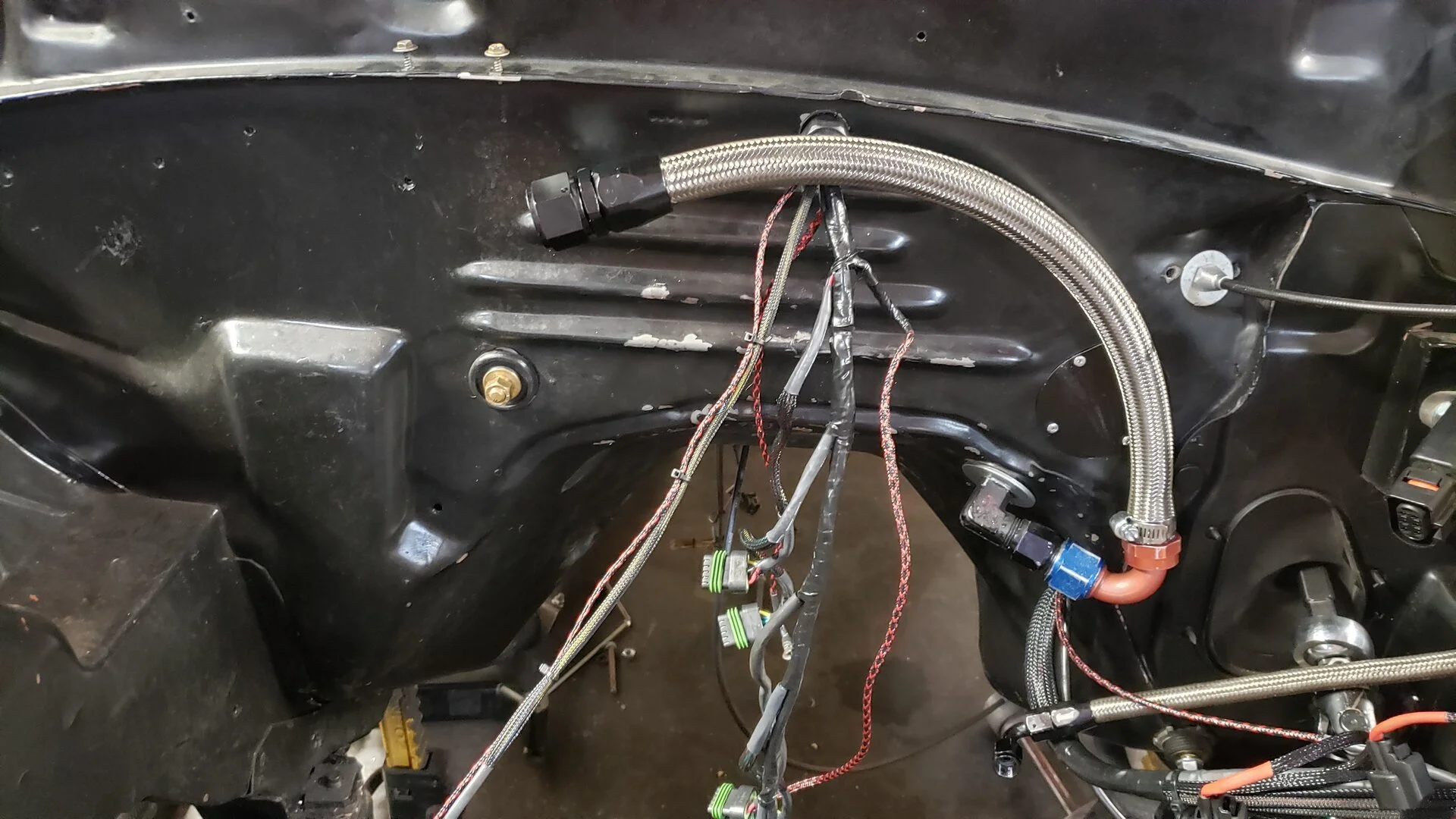

The firewall is just a Jug fck..That cheesebag braided hose is the one that leaked that I couldn’t get to to tighten once the engine was in..This time around it’s so tight, it’ll probably never come loose.
Time will tell there.
