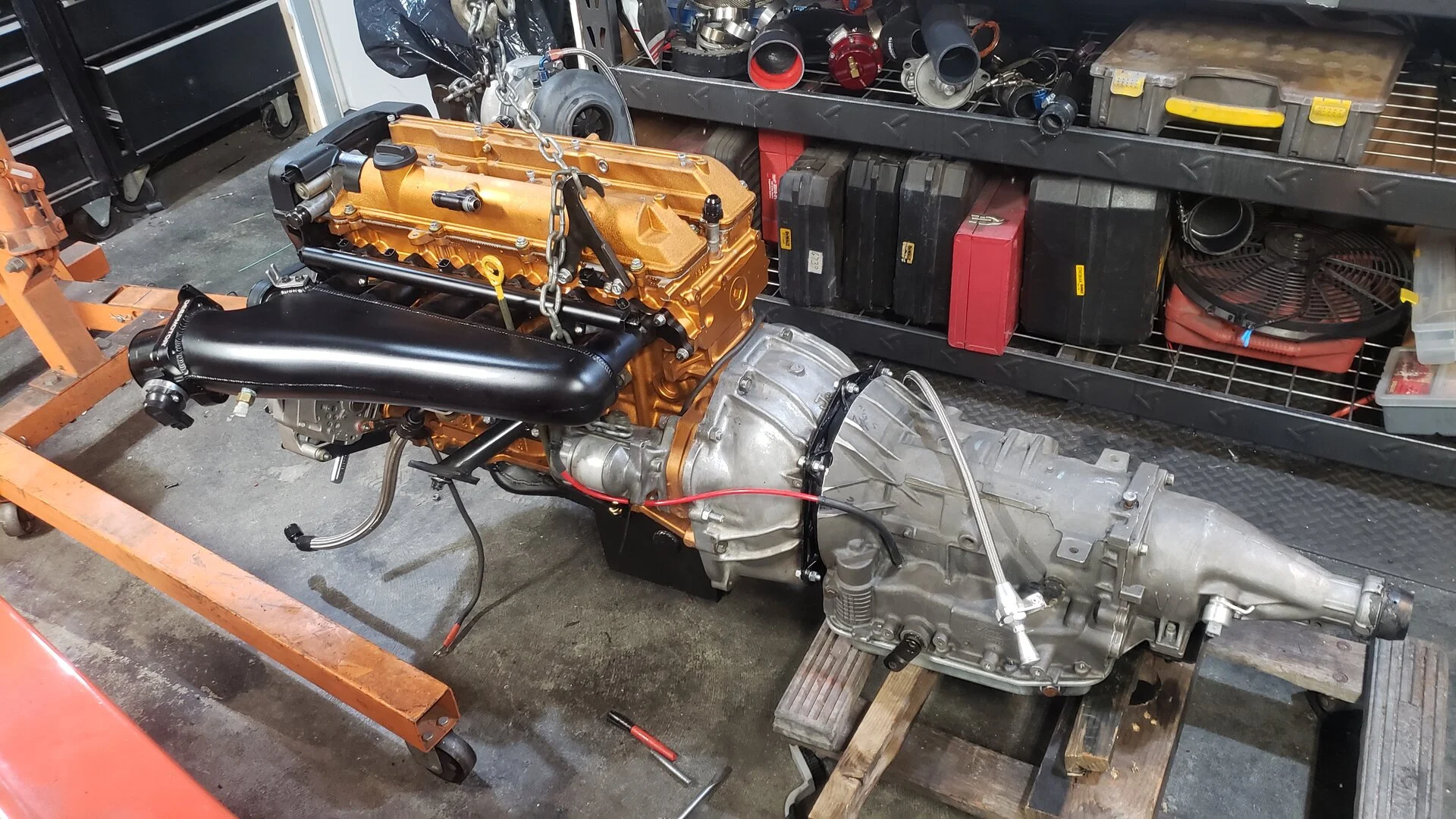

Its snack time..
The fitment this time around is actually better than before, as to be expected when you have to do sht over. Before I put the two pieces together and I shoved the converter onto the front pump, there is a "rub" that occurs when it's all the way on. A good thing in the grand scheme, cause you can hear the little ribs on the converter making contact.
So,...I'll know if the converter is not bottomed if I hear no noise when I bolt the bitch together.
( I also had a gap between the flexplate, and the converter foot pad of about .100, so I'm confident it isnt jammed into the front pump.)

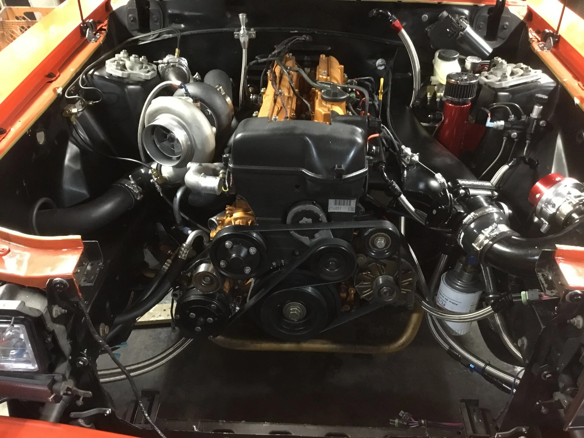

Well...it’s in.

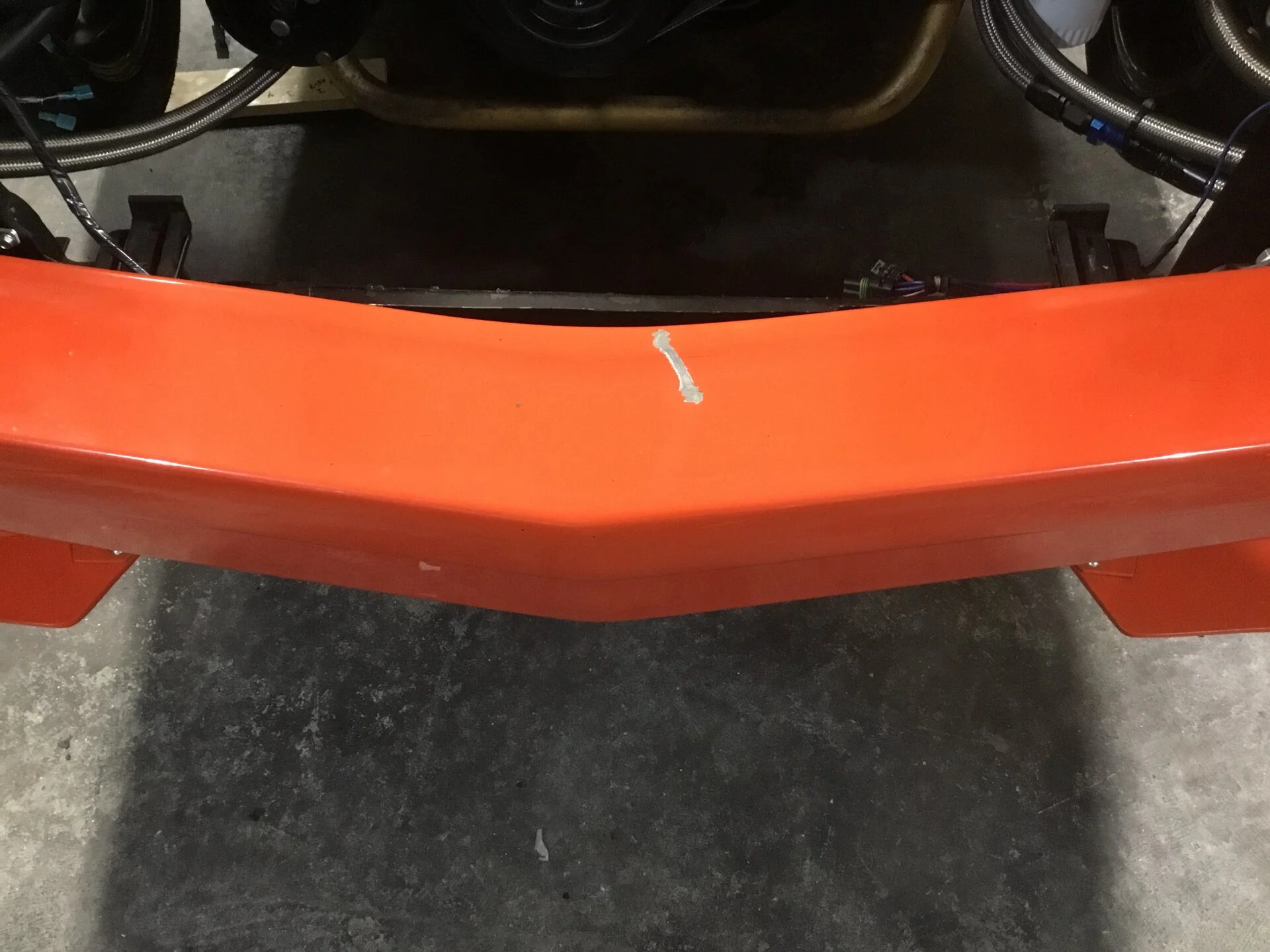

But the Monster kicked my ass the whole way. With a really big bitch slap about 15 minutes after i posted that last pic this morning.
Even though there was a towel covering the bumper, the transmission mount stud was making contact with the bumper. And..Even though it looked like the engine was high enough, that stud was dug in. The towel in this instance turned out to be the problem because I didn’t know it was embedded, and in my attempt to move the engine forward, gave the thing a little shove, and the noise you’d expect to hear when paint is being scraped off with a gouging tool let me know that this had just happened.
I tell ya before this engine runs again i’ll have to repaint the entire fcking car.
After the 15 minute tirade that came when I lifted the towel, I put the engine in.

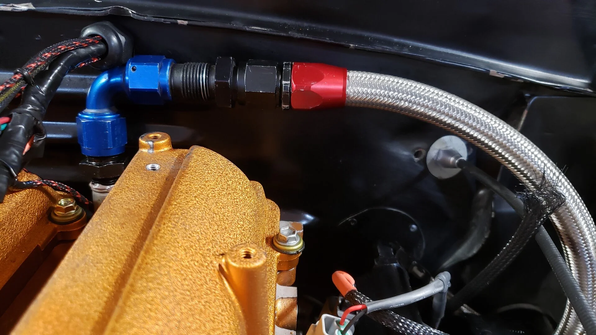

Everything went pretty much w/o incident until it came time to hook that rear water line onto the male fitting i tapped into the nipple at the back of the engine...
The freakin 90 degree fitting interferes with the grommet. About the only thing I can do is remove it, and go back to some kind of pre-formed hose and try and add some sort of splice coupler to the hose...
By 2, I was pretty wiped, but just had to keep on going...In this condition, I’m an absolute ass to be around. Everything I attempted from then on became a challenge, and I bitched, and yelled, and cussed and threw stuff...Just an all around fun guy to be around. The exhaust was a freakin disaster..Nothing fit....and the whole house knew it.
I finally drug my dead ass out of there at 5:30,...having been at it since about 9 am pretty much non stop.
Tomorrow, I’ll focus on the exhaust and solve that water hose problem,...Barring some unforeseen catylclismic failure, I should have it start-able by mid afternoon.

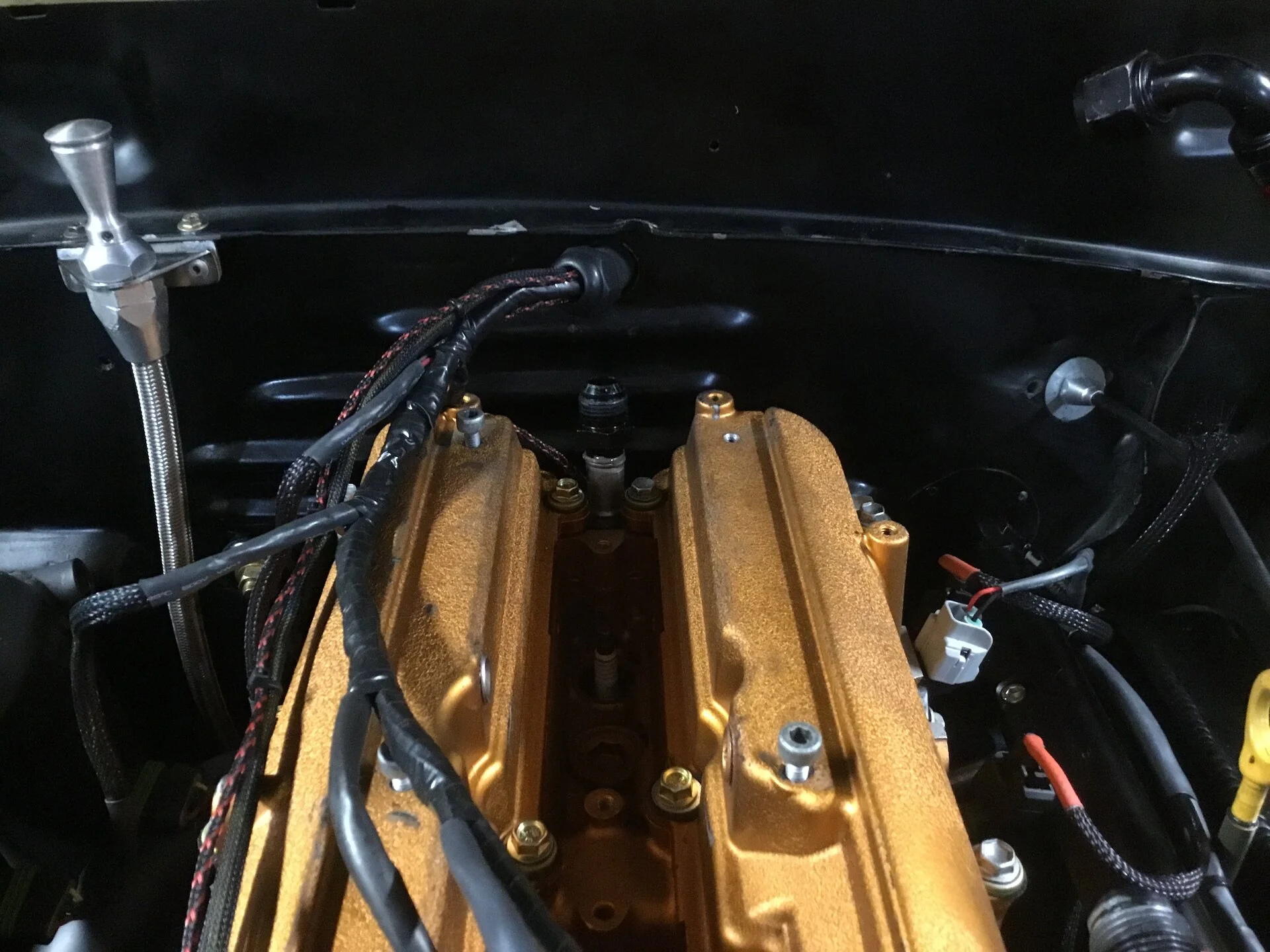

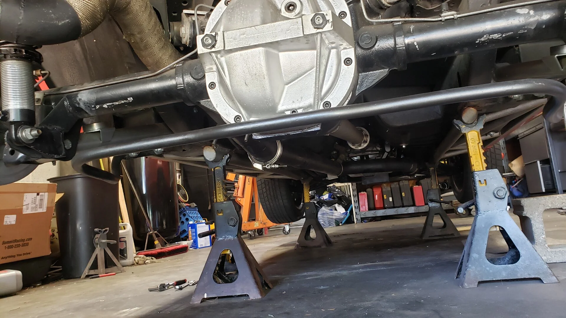

And in the light of day...long before fatigue sets in...
The solution presents itself. All stuff I had yesterday..I just couldn't see it for the angry clouds in my eyes.

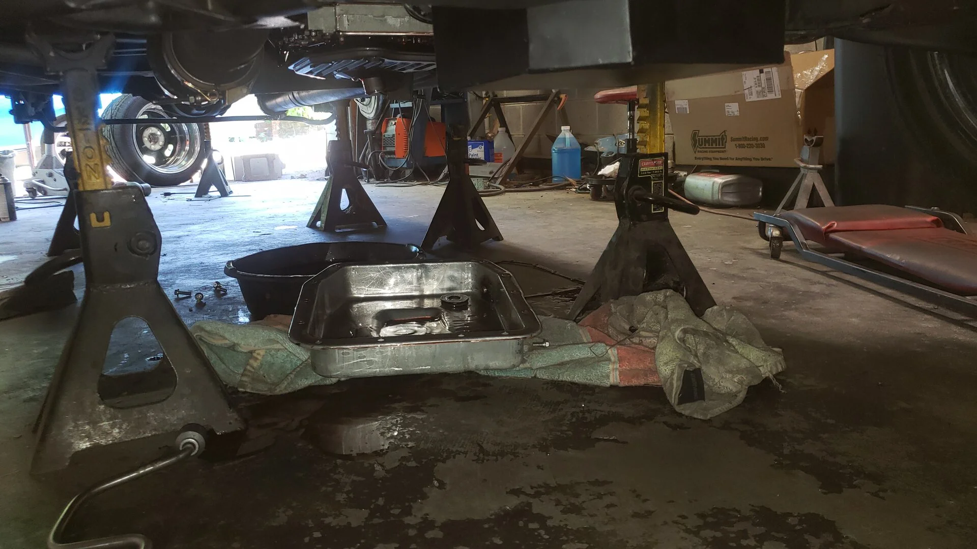

And speaking of transmissions..
This one has to come back out.
Just as soon as trans fluid went in, it started to slow drip it back out. Looks to be either the front pump lip seal, or the converter input seal. Either way, it's nothing I cant ignore. ( I should left the freakin front pump alone,..it was the one thing that wasnt leaking.)
To add insult to injury, the drain plug I added to the pan had a slight leak as well. Prompting me to give it a tug to tighten it..
And it pulls the thread out. That's why the pan is on the floor.

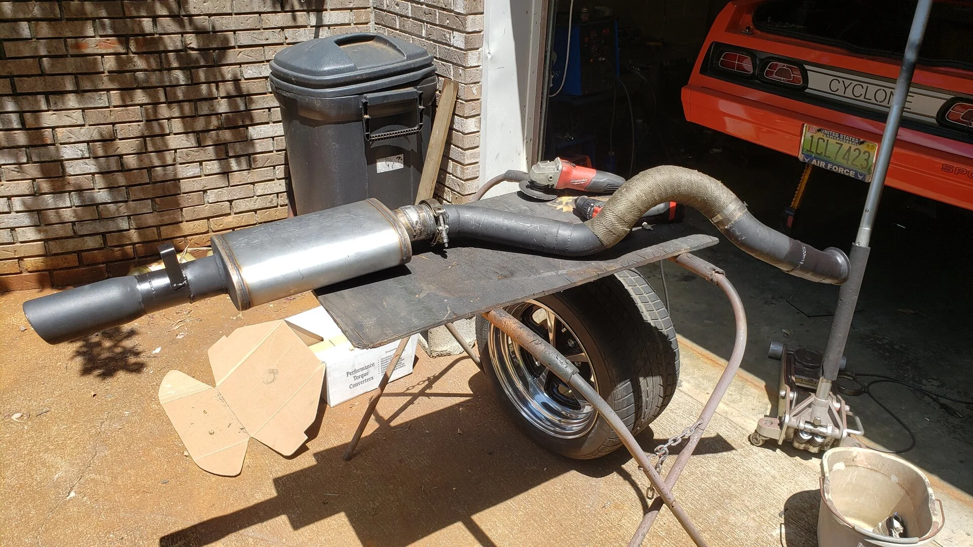

Everything was going along before hand though...Got the exhaust sorted out.
And installed and hung...
There may even be a drip up there if you zoomed in.

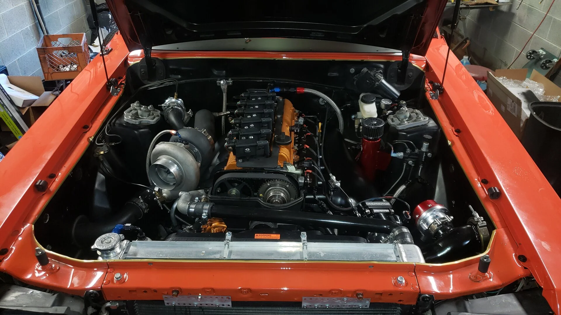

I started the car, but weird sht was happening...the Cold start was running at 10.9:1 afr. My stupid computer died in mid run,..when I got it back up again it had corrupted the tune file. I had to build a new project....twice.
I forgot to hook up the cooling fan, and the engine got hot..( 250)..the afr started swinging wildly..I shut it off. And the project got corrupted again.
So...defeated again..but at least it runs.
