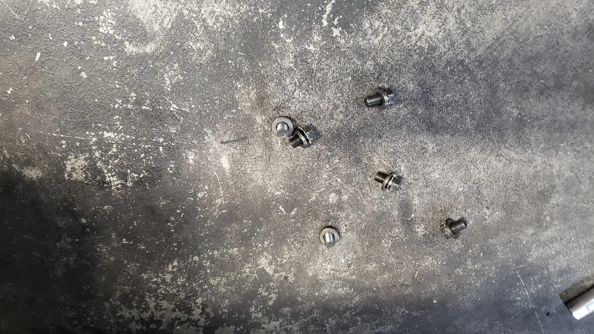

Went to start it..theres something hitting something in the bell housing,...like one of the bolts holding the front pump on has backed out..if you rev the engine, the interference noise gets worse, so definitely the converter is hitting a bolt head.
That forces me to remove the converter bolts to make sure that it is what I think it is, and sure enough, the converter will barely back away from the flexplate. I started it nonetheless just to be sure...

Im done with this trans....Clearly the vibration I was talking about yesterday managed to loosen one of the bolts that was so freakin tight that I was afraid I'd strip them if I pulled it any tighter..and now one has backed out and started making contact with the converter.

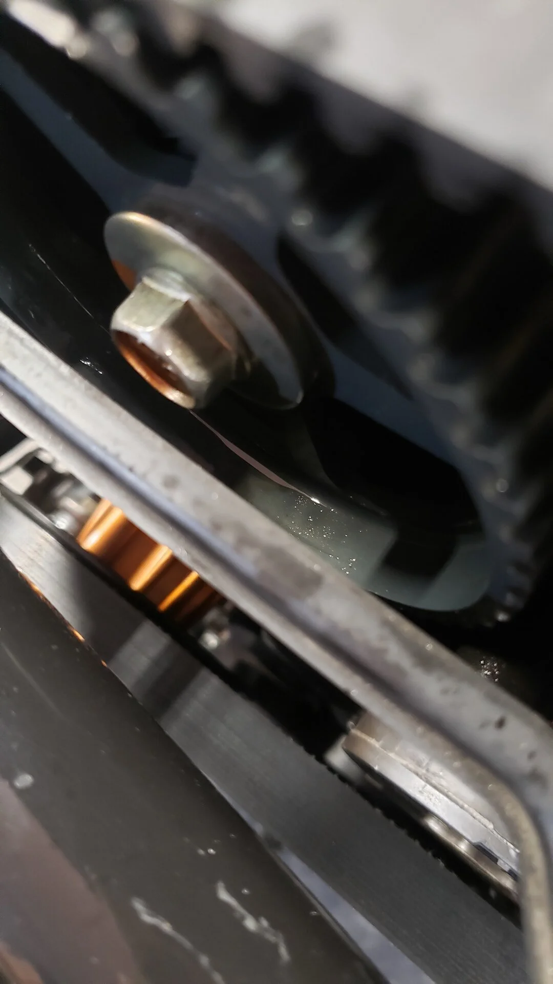

The fcking exhaust cam seal leaks..
Throws oil everywhere..

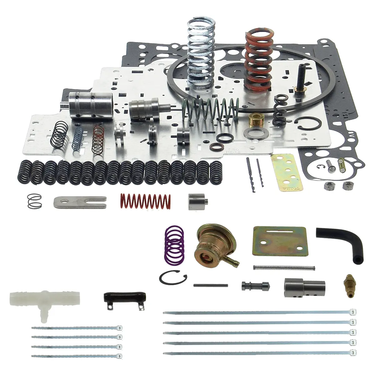

1. Transgo 4l80e-3 transmission valve body reprogramming kit to allow full manual control of all 4 forward gears, with the same push button converter lock up capability, and the TCI 4 speed gate plate to allow me to convert my 3 speed shifter to a 4 speed shifter.
I don’t have any idea why i’ll need the zip ties,..but they’re included. 330.00

Grey RTV or Honda bond on the bolt . Sounds like they didn’t press the little ball into the cam to seal it .
My buddy had the same issue with one of the GSCs on his .
