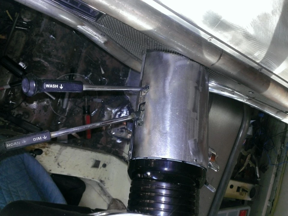

I decided to use my preferred medium. Steel. The horn adapter measures in at 4.0", so I called Summit last week, and ordered a 3' stick of 16ga.,4" exhaust tubing.
25 bucks shipped. That became my budget for the column surround. I had the welders, and a small piece of leftover 1-5/8" exhaust tubing from when
I built the hotside, so all-in-all I'm set.
It takes all day. In my typical fashion, most of the time spent "building" the thing was wasted having to go back and weld holes back closed that were either incorrectly located, or moved during the mock-up.

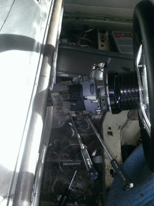

But I finally get the thing close enough for these pics.
Three screws hold the thing on, it woulda been 4, but the one side was full of ignition wire sockets, and left no room.
No worries though, It works fine.

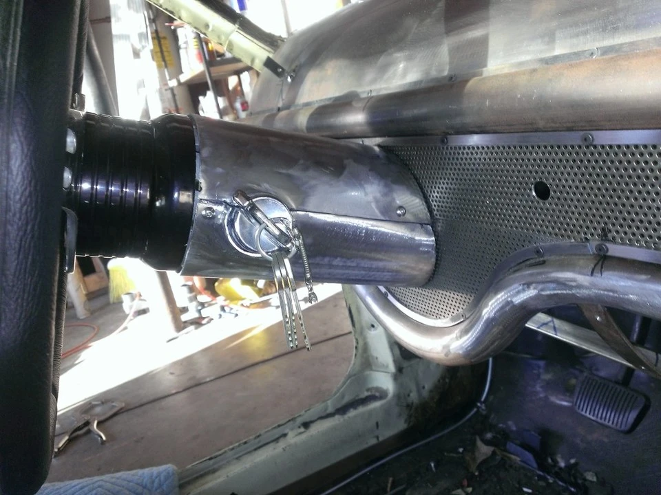

The fit is not perfect but it's pretty damn close, I still have to get after it with a sander, and it may take a spot weld here and there. But for the most part it's done.
One more chip......
Even taking all day, that is a one off piece that, again, just ties the whole custom job together. Too bad you are painting/wrapping in leather. It looks pretty damn cool as raw metal.

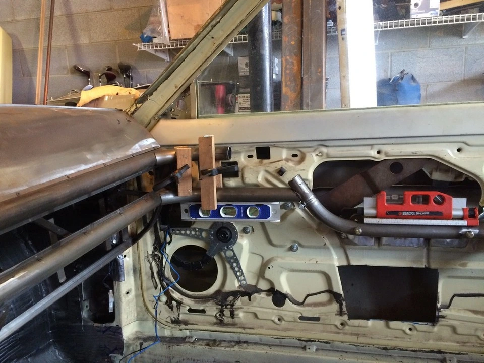

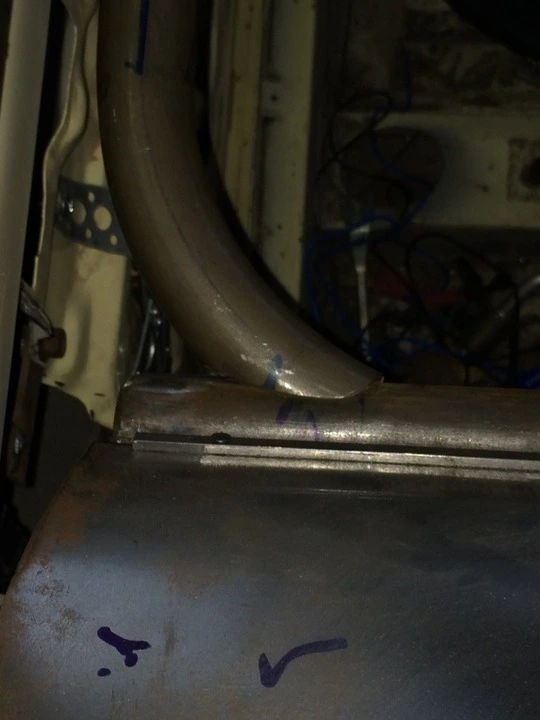

I thought to myself that before I put the final touches on the endcap, I might wanna mock up the door bar one more time to get a better idea of how the transition is gonna look.
I went one step further, and actually fabricated the mount structure to hold that bar in place. Since that bar is attached to the door, and it has to mesh w/ the bar on the dash, I had to make it all "adjustable" so that I could compensate for door alignment.
After I got the bottom two holes figured out, I turned my attention to the top mount, and that is when I looked more closely at the intersect point.
#1. The whole thing is a recipe for f'd up paint. The door bar will move far enough just by the simple act of opening and then closing the door. I was gonna have to come up w/ a solution where the two bars will have minimal contact w/ each other.
#2. This looks like ass. The intersect will be visible. You'll see that little stump that makes up the dash bar when you look through the windshield.
So, like I always do, I stopped and stared at the thing for a really long time. I'd move to the pass side of the car and look down at the stupid looking thing, then I'd move over to the driver's side, and get down on one knee and look at it some more. I must've walked back and forth between the two sides about a dozen times, all while asking myself "How was I gonna blend that transition to where it actually looked like a smooth bend, instead of some wonky attempt at a 3 point turn".

It's an epiphany. I crawl to my feet, and stand with my mouth open while the car tells me that I'll have to weld the transition onto the top bar, and make a new cut at the middle of the turn. By welding the transition, I'll be able to blend the turn, I'll be able to create a butt joint where the door bar, and the dash bar will meet as opposed to the fish mouth that would just trash the paint. The butt joint could be gasket-ed, and I'd be able to cushion the bars to minimize any interference. I'll be able to make a domed cover to weld on top of the intersection that will look more like I planned it that way, Looking more like one bar instead of the two.

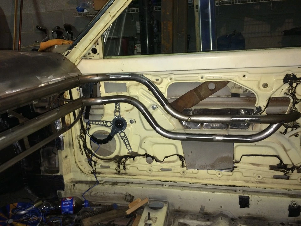

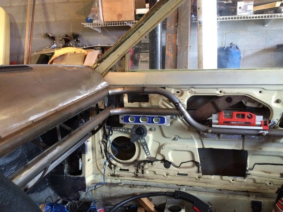

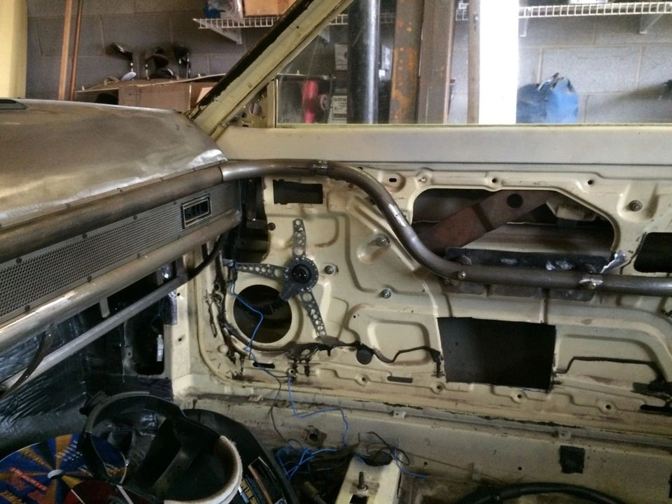

The door bar before:

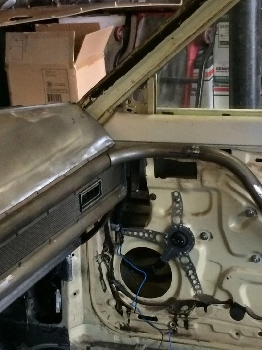

If you look at it, you'll notice that the front arches. That bugged me.
The bottom bar more closely illustrates how I wanted the radius to go. The top bar was gonna have to be redone.
Consequently, It underwent an upper bar-en-dectomy.
It took some while for me to determine whether or not I wanted the bottom bar to finish the way it's pictured. It would after all be way easier to trim out, if I left it that way, but for me, it seems that easy is not to be.
I had to build this complex "S bar" that followed the upper.
When I tell you that this was a flaming pain in the ass to do, you can take me literally. It is what I had originally intended for the door bar. All of the bends were sectioned in, welded, then ground smooth. Having that many bends that had to be fit, and precisely welded was just too much to ask of me evidently. While the top bar is now at the proper angle, now the lower bar now angles downward at the front.
Will I leave it that way?
Nope.
Now that I look at it though, The simpler "straight" bar that is the lower may be the better choice. Thoughts?
