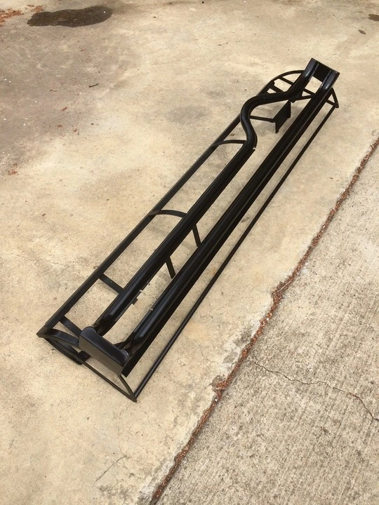

Despite the fact that this stuff is supposed to be satin black, clearly, it's way glossier than that. We'll get back to it in an hour.

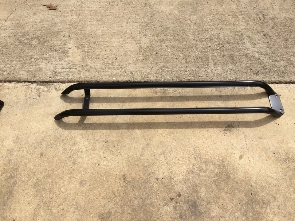

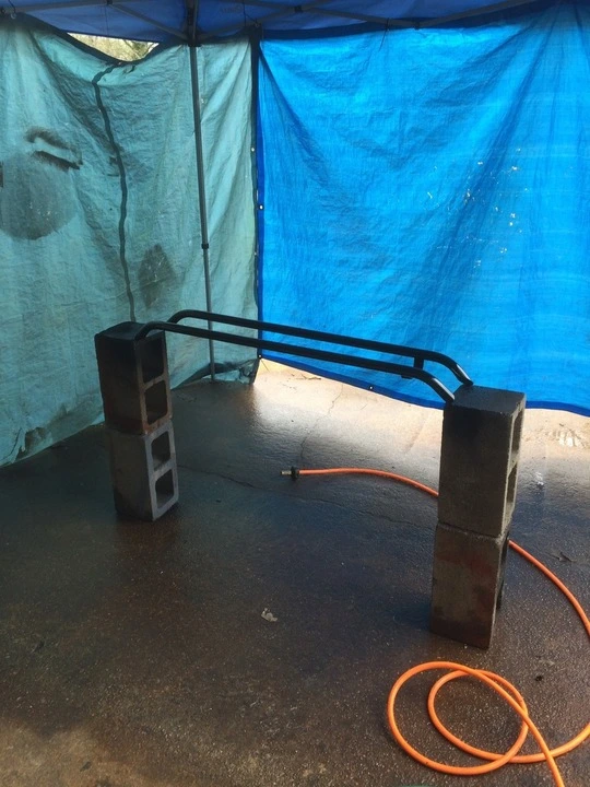

I moved onto the console, prepped the night before.
I get the first coat on and it goes on as nicely as the dash paint did, and I unmask, and step out of my "alabama paint booth" to look at the dash.

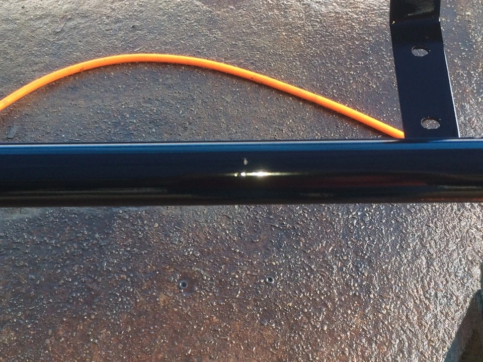

When I get back to it however, I find this:
Evidently, lil' dude has read about the medicinal benefits to be had from swimming in the Black Sea. Guess he got his black seas wrong.
That little ******* just didn't land there,...he decided to trudge......through....the .....paint,.......about 100 "bug feet" before he finally got entombed at the top of Mt. tubamanjaro.
Now had this happened on the dash, this would've really "bugged me" (heh-heh), but since it's on the console actually behind the seat, I made the bug a permanent addition o the bar, and covered his ass in the second coat. When it was dry enough to handle as well, it got moved outside next to the dash.

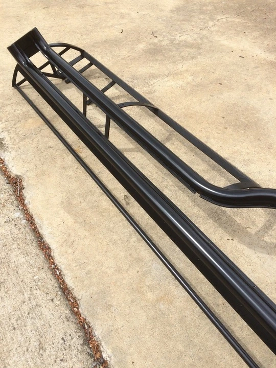

The dash was starting to flatten. A process that truly takes about 12-15 hours to finally reach it's satin finish, and mega hardness.
After looking at the stuff up close though, I may have a problem w/ the insert mesh being to wide to fit, now that there is the added film thickness of several coats of primer, and multiple coats of thick as hell satin black paint. I'll have to mask the bars really well before I attempt to fit that stuff, and that is gonna require another day.

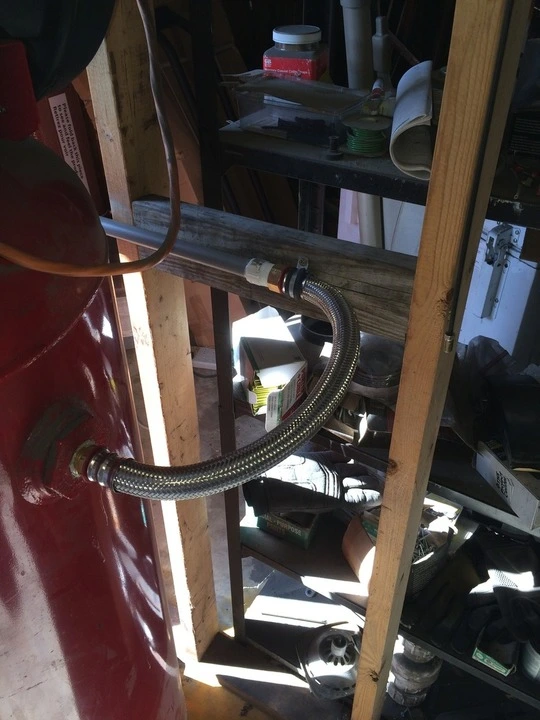

All of the years that that compressor has stood there, there has been PVC coming out of it going to a hose reel. I ain't gonna lie, I've had problems w/ leaks, and cracks.
But.
I didn't do anything to cushion the vibration between the compressor and the rigid mounted PVC before.
This time I changed all that:
My compressor runs to 135 before it kicks off, then I have to listen to the regulator hiss off the 15 pounds between the set regulated pressure of 120 and the residual pressure in the line. That system is holding 120 pounds of line pressure w/ absolutely no leaks, so I'm plenty satisfied.

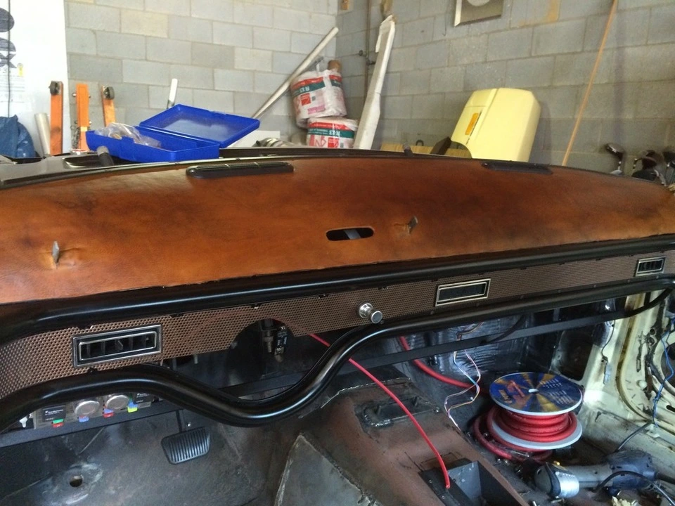

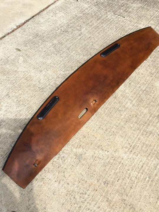

I'm gonna ask for an opinion right up front. The dash top if you'll remember has a stain where I tried to remove some spray glue, and ended up pretty well trashing the thing. In an attempt to save it, I went back to my leather guy and he sold me this junk called "antiquing gel" It is supposed to make natural finish leather look old. Works like a stain, you blot that junk on w/ a rag, work it into the leather grain, the leather takes what it wants, and you wipe off the rest. Kinda like what happens to a saddle, or old chair after it has years of oil from contacting the skin.
By itself, I think the dash doesn't look all that good
But take that, and set it on top of the dash frame, and it changes a bit.
I'm kinda conflicted, because if I do it to the dash top, I gotta do it everywhere else. (there really isn't that much the bottom three pieces, and the two door panels) On one hand, I like the lighter color, but I'd still have to seal that in some way, and doing so will darken it anyway. How that process will differ from the staining method, I don't know (it may not be any different at all). I don't know if the antiquing thing has effectively fixed the stain problem, It just made "more stains".
The grill mesh is actually a coppery metallic bronze. Matches the carpet almost perfectly. That is one thing that I'm really happy with. The top trim piece isn't pictured, because like I always do, I try to handle a painted surface to soon, and I put my finger prints all over the thing. So that is off hanging in the garage waiting on paint to dry.
So whad'ya think? antique or go with the natural finish, that has been sealed?

Mike, I actually think that looks a lot better then before. It gives it more of an edged/rough look versus an untouched look of perfection...if that makes sense. I wouldn't hesitate to do it all like that!
Joe
