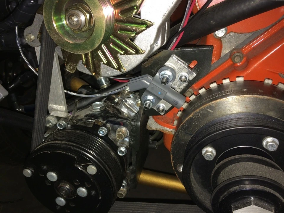

Lets look back at an old pic again shall we?
How many times do you spose I've looked at the front of my engine, and the sensor mounting that is depicted front and center?
In addition to that pic, I probably rambled on about how it had to be precisely 6 teeth away from the missing tooth. When you look at the pic, it looks like everything is perfect right? It wasn't. The engine wasn't at TDC. It ended up being one tooth off.
That required a butchering of the sensor, because there wasn't enough room to move it backwards, and shifting the trigger wheel was definitely out, (it's screwed to the back side of the balancer, and the gap machined in place. I had to move the sensor.
I did.
I checked timing.
The mark was nowhere in sight.
It's gotta be something else.

Yeah well I was right to second guess myself. It's that stupid crap that keeps me awake at night. I just couldn't believe I would've pulled such a bonehead stunt as to completely miss an entire tooth on the trigger wheel. But in my frazzled attempt to get the thing to start, I started ignoring logic for any possible reason. I should've chk'd TDC but it guess it was easier to assume that the engine was there w/o doing that.
Now I gotta take my hacked up VR sensor, and my modified bkt and move it back to where it was before, only now that it's " modified" it won't fit there anymore.

Amazing things happen when they're wired correctly. With no other changes than switching the coil packs around, (and putting the crank position sensor back where it was originally...........it runs.
