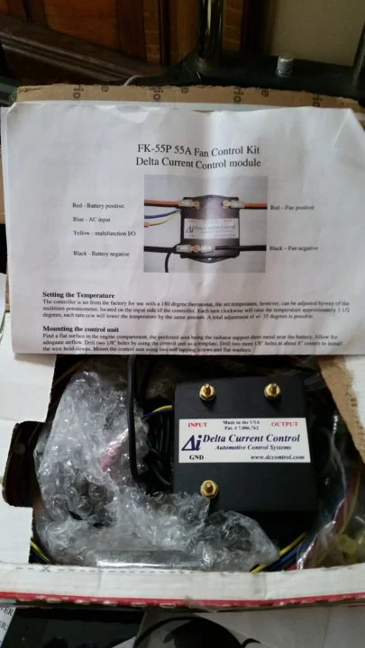

madmike1157 said:
I think if it truly comes down to a situation where the cooling system is dramatically oversized for the engine, I'll try to turn the pump on and off w/ the ECU to regulate the flow of water like you F.I.L. did w/ a mechanical switch. The exact same situation exists w/ me, the temp drops so fast you cant turn the switch off at any time after the 1st 10 degree drop because it continues to drop another 10 after that pump is turned back off.
madmike1157 said:
I appreciate that. To tell the truth, the thought of electrically restricting a Chinese Summit branded electric WP has never crossed my mind. Especially at this early stage. In actuality it may be less hard on the stupid thing to do that as opposed to turning it on and off using the Hysteresis settings on the WP control output.
This may come about as unnecessary anyway, but again, I'm early in the game, I guess it's easier to rant about it here, then read an owners manual.
I have a Vintage Air HVAC control panel that has 4 sliders:
1 for fan; 1 for mode;1 for cooling temp; and 1 for heat temp. I was assuming that when the fan control was off, so was the heat, but after looking at the panel, the heat slider (that I thought was slid all the way to the coldest position) was actually slightly off of it's stop. I haven't checked into the wiring diagram, so I don't know for sure yet, but one of the two switches is directly linked electrically to the heater control valve. I was discounting the temp control because it's not a "switch" but more of a rheostat, but who knows, maybe right off the stop, it's actually a switch as well. I'm thinking that little "tid bit" was/is probably responsible for keeping the heater control valve open, and that means a -10 bypass is just allowing water to run completely outside of the engine, and bypass the Tstat altogether.
Something like this?
Let me know if you want this thing. I'll send it to you and if you like it just send a replacement at your liesure (I understand that these guys can take a while to fulfill an order).
It's one of those things I picked up because the price was right even though I didn't need it at the time. This one is 55 amps. It doesn't operate like an on/off switch. It eliminates the spikes and ramps up slowly.
I'm sure you've heard of this outfit before. There's a couple others making similar products now too.

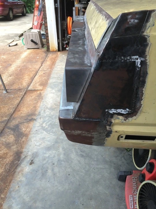

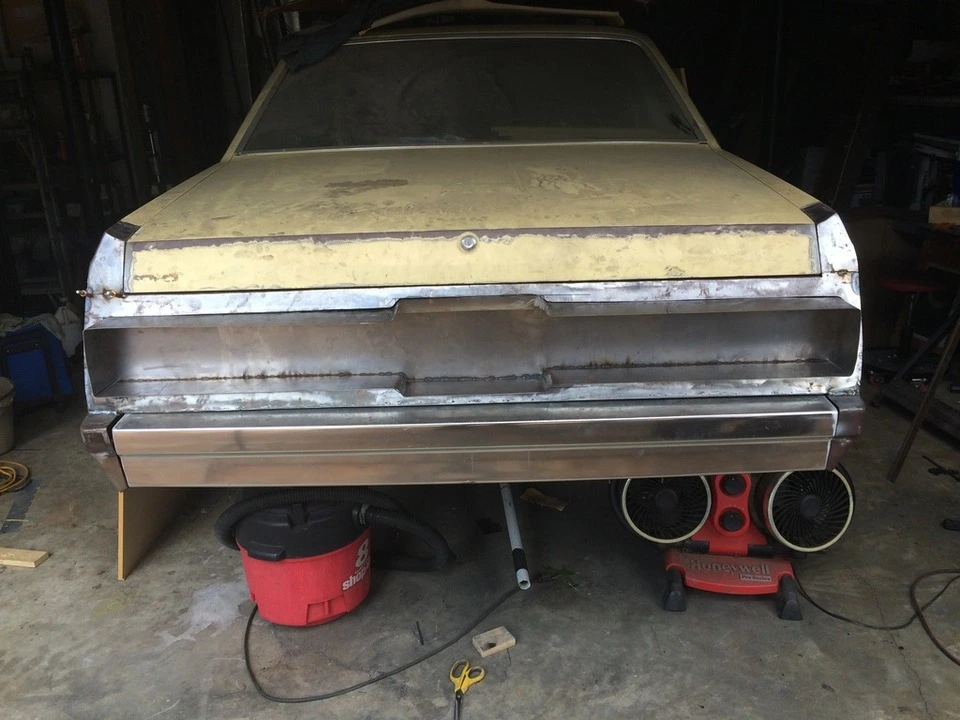

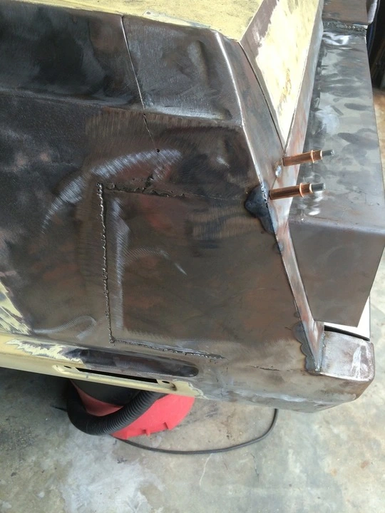

Starting out today I gotta say that again, I'm hesitant to post these pics, as they require that you be in my head a little to see the light at the end of the tunnel.
That aside, I'll post them with this introduction.
I ordered the Shelby tail light pkg from a Mustang Depot in Vegas. I had them measure the outside dimensions of the trim bezel so I could get a determination on the requisite size of the opening I needed to make in the tail panel. Those lights measure 5"h x 22.5 L". The license plate is actually 12" L x 6H. The entire back width (outside to outside) of the Monster is 65"
When you take the dimensions of the tails and license plate, and add those together, you get a total inside dimension of 57"
That leaves 7 additional inches to fill up between the surfaces.
The height of the tails are 5" and the license plate is 6". The distance between the trunk lip, at the top and the top of the bumper at the bottom of the rear fascia measured on the same sloping "angle" is about 9-3/4", which in my mind meant that there was 3-3/4' of excess between top and bottom.
The plan was to add some slop between the surfaces (1/2-3/4") around the perimeter as a safety buffer, then split the differences on the rest to get a gap for the insert that would become the backer surface for the tail lights, and the license plate to mount to.
I cut the hole in the rear fascia in the shape of a reallllly long, but very stubby "plus sign" 61" wide, and 7" high. Seemed more than generous to me at the time.
I made the backer out of a plate that was 7-1/2" high x 61" long, and built a perimeter fence that stood 4" off of the backer. This would become the recess-able insert that I could later trim to fit flush in the opening.
Got all that math? Does it seem like I've added enough extra "margin" around the surfaces?
All that junk changes when you tip it up on it's side so it'll fit through that hole.
I can hear it now......"Why that almost looks like a Chevrolet Bowtie emblem stretched across the rear of the car" :grumble:
To which I'd reply "Calm yourself,...it's a million miles from being done. The "insert" is just sitting in the opening."
It still has to be leveled and squared, then the outline traced and the excess cut off that hangs off behind the slope.
Here's the kicker though: When it was built to fit through the hole, I really wasn't concerned about how tall the inside dimension ended up, as I thought I had more than enough slop to allow the 5" high tail light to fit in. All I was worried about was keeping the thing perfectly square and equidistant as it was welded.
I still have enough room, provided dude at place I bought the lights from was accurate in his measurements, but instead of having 1/2-3/4" above and below the lights, now I got something closer to 3/8" above and below the lights. I was just trying to get a jump on the wait involved to get those lights shipped from Nevada. Let me tell ya,..............I'll bet that I have to cut the entire thing down its length, and add an inch.
You'll know it if that's the case long before you'll ever read it here,.....You'll hear me first. I don't care where you live,......it'll be THAT loud.
As a side note, I did end up cutting away the driver side that I said nobody got to see that looked like I shot it w/ buck shot after trying to butt weld in another patch panel onto a previously worked panel.
It turned out better.
As you can see, The swimming pool for air density that makes up the atmosphere in Alabama is wreaking havoc w/ the metal after just a few days on there bare,...I'm gonna have to get some kind of metal prep stuff to wash all of the oxidation off of everything and shoot a coat of some primer on it so I can at least breathe before it all rusts w/o as much as one smear of filler on it.

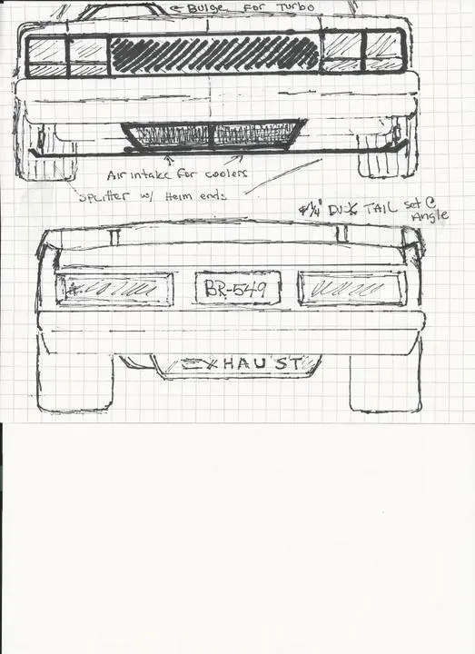

(Kinda proud of myself that the car is matching a sketch drawn before it ever showed up in my driveway)

Spent in hell. Trying to make the rear facade move from "unfinished", to "finished"
It's still not done.
Despite my feeble attempt at making sure the welds were properly ground, and matched up so as to have a smooth body line, by the time filler started to get slathered on, high spots started rearing their head. All along the bulkhead weld seam, where you couldn't simply peck the high spot down. I had to grind the high spot, which in turn turned the surrounding sheet metal into toilet paper. You can see one of them poking his pimply ass through on the lower quarter, right below the previously hacked one, barely covered in filler.
I had no choice at this point, I had to keep at it. Everytime I'd butcher a high spot, a new one would show right back up. The real frustrating part of all of this is that it would get so close, and then there it would be,......Mr. Shiner, threatening to poke it's head back through if I made one more stoke w/ the samding block.
I gave up. I'm wrecked.
All of this "body work" done mostly by hand. Despite the fact that I went Saturday, and spent almost 200.00 on air tools from Harbor Freight, the fact that they were harbor Freight air tools make them pretty useless.

Then,.....because I'm as tired as you are of looking at the same damn thing,.....I jerry rigged the tail light lenses in place.
This is supposed to be the money shot. But as with everything I do in this build, there always seems to be a thunderstorm, raining on my parade.
The tail lights are wrong. The left one is 1/4" deeper than the right one. How in the hell this happened is beyond me, and short of completely cutting the rear panel off that the tail lights bolt to and redoing it, that is the only way to fix the discrepancy. I'm so pissed right now, you don't even know.
Yeah, the trunk is sealed shut in filler. I'll cut it back out when I get everything finished. Ironic actually, I was so worried about making sure that the trunk will completely blend into the rear facade, and now I have a wonky assed tail light instead.
