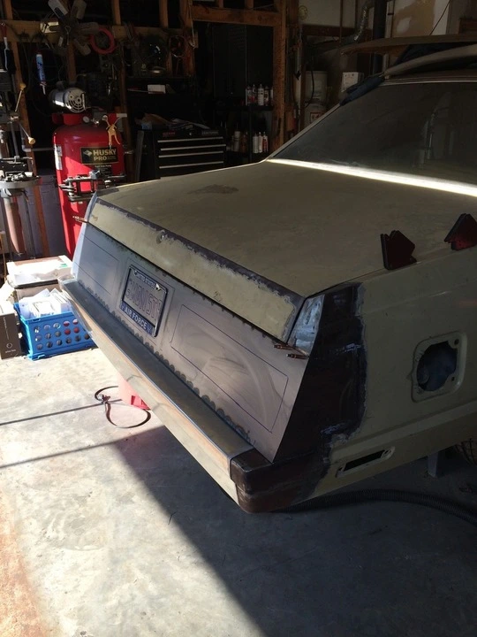

Plan B was to use the stock rear bumper and come up with a way to blend it into the body. The problem w/ that is that it's aluminum, and the body is steel.
When I built the last car I ran into the same issue when it came time to blend the potmetal headlight buckets into the sheetmetal of the car. On that car I used a combination of bolts, and JB Weld to hold the dissimilar metals together.
That method lasted about a year before cracks started to show through
So this time around I ain't bonding anything on the body together w/ bolts and glue. (I have enough of that in the engine)
I decided to cut the ends off of the aluminum bumper, and I'll cap them. In essence, I'll have an effect similar to a baby LTD w/o the urethane end caps to worry about.
I came up w/ this hair-brained solution:
In the pic, the steel endcap isn't finished yet (I was, I was dying of thirst, and was tired of messing w/ it by the time I got this crap done)
Like the Mustang pictured above though I do one side at a time, and it seems that each side never matches the other. The driver side was first, and it was the "Beta". By the time I got over to the passenger side , I had figured out how to do it better.
(I'll probably end up cutting all of that junk back out on the driver side to better match the "new and improved" passenger side):nonono:
Just like this for instance. On the driver's side that center piece you see above was butt welded in. The quarter was already distressed as a result of me trying to fit Fox mustang tail lights in there, and by the time I started welding in patch panels to bring it to the finish level you see here, I warped the **** out of it.
( We will NOT be looking at that side)
One the passenger side, I learned my lesson, and got out a flanging tool, and flanged a 1/2 " perimeter around the patch. That flange served as a backer, and helped to keep the quarter in better shape. I still got it too hot, but the warpage is managable, unlike the driver's side. (Which now looks like the surface of the moon)
So what we're gonna do here is create a gap between the steel end caps and the alunimum bumper similar to the 1/8" gap the trunk has around the perimeter. That'll let me slide the bumper in and use the stock mounting system for that, while the end caps are permanently mounted to the body.
So then this is gonna be the approximate rear facade the tail lights will recess into. I'll just take a regular piece of sheet metal, and follow the crown of the trunk. I'll make a bottom piece that will sit approximately 1/8" off the bumper, and trace the crown onto that piece. Then I'll weld the two pieces together to hold the crown. I'll do the same thing at the top.

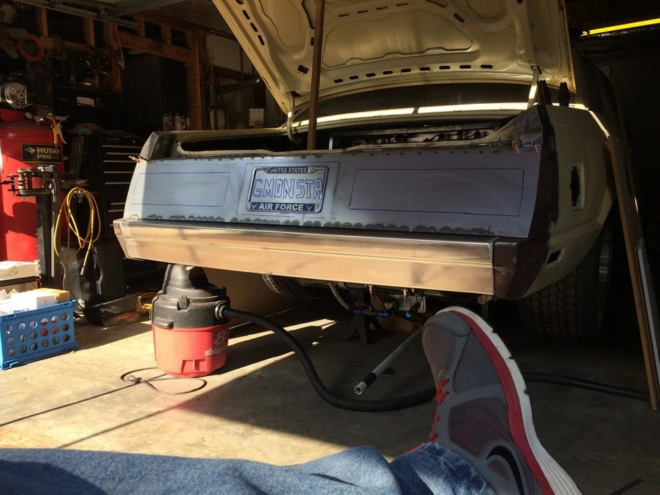

On Friday when I finished work,I did manage to get my 18ga. stuff that would let me finish the rear facade.
So,....this:
Taken from my "admire my work, chair cam", clearly, the thing is no where near done. Although I have all of the steel to finish it, the leaking valve on my welding bottle managed to change my plans for me. That was a newly refilled bottle that lost almost all of it's gas via a faulty bottle valve as opposed to me actually using it up. When I got it home I noticed that it looked low and called the refill guy to make him aware of that, so it should be NBD getting a refill at no cost.
Hobbled by a empty gas bottle on my favorite welding option, I was forced to use the TIG instead. I guess I'm competent w/ the stupid thing, It's just too slow, and unwieldy for me to use it as my "go to" when I need to weld something.
But nonetheless, I managed to tack the top piece in place.
(actually, I know all of the reasons TO use it, and I should, I'm just lazy that way I guess)
So anyway, The two lights and the license plate will be recessed into that angled facade. The tails measure 5 x 20", and the plate opening is something like 16 x 7.25. I just drew that outlines on there to be sure that those were the sizes I actually wanted them to be. (They better be, that's the actual sizes I had the steel that makes up the inside recessed perimeter cut to).
The plate box is easy, and I can completely finish that. The tail lights are still up for discussion. If I change anything about them, it'll be to make them more narrow, but for now, I'll say that this is the cut size for the openings.
There is gonna be a problem getting the trunk open by the time I get all of the gaps evened up to include the one at the tail lights. Since I left no trunk lip over hang, there is no way to get your fingers in between to actually lift the trunk. I'll probably remedy that w/ a spring similar to what is up front w/ the hood latch, only not as big. I've also considered maybe installing actuators on both the trunk, and the hood,..but I'm sure I'll come to my senses before I do that for real.
( What a pea-brained idea is it where somebody would install electric actuators that stand in the way of getting to the battery should it die.)
We'll see on that one.

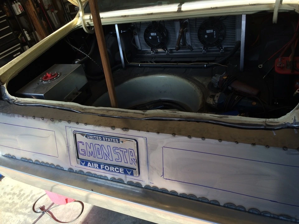

I also ordered a replacement tank this morning because this bugs the holy hell outta me:
You've obviously heard of Junk in the trunk?,.......well I have junk under my trunk.
I always thought that I was gonna hide that w/ some sort of extension beneath the rear bumper, but that would be so damn low, it would also look dumb as hell. So, The plan is to revamp the fuel delivery starting w/ a clean fresh tank. I wont install that dropped sump this time, and I'm gonna add a tube-type fuel sender like what a plastic fuel cell uses. The old 70/10 ohm stocker isn't working properly, and my new digital gas ga. never acknowledged that I had any gas in the tank. By using the tube type sender, I'll be able to drop it in from the tall portion of the tank where the filler neck comes into, and the old factory piece w/ just serve to seal up the hole in front. As for getting gas to the pump, and how best to do that w/o adding the sump, I haven't decided how I'll do that just yet.
All I know is that the existing menagerie is so low that when the car is sitting on it's tires I could actually see it dragging when turning into a steep uphill driveway.
Yeahhh that's the ticket,.........Force a fuel line against the pavement, and then drag it against that pavement w/ about 1500 lbs of force....
