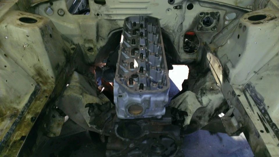

I do have to start making forward progress though,..so I will start tomorrow by doing an engine mock up ( now that I have a transmission) and make my trans mount, throw the X flow head on and start mocking it up for the intake and exhaust.

Well here we go folks,...I actually started making............................... progress.
As I stated this morning, the plan was to strip the engine compartment, and trial fit the 250. While that sounds like a few hours,...it actually ended up being all day.

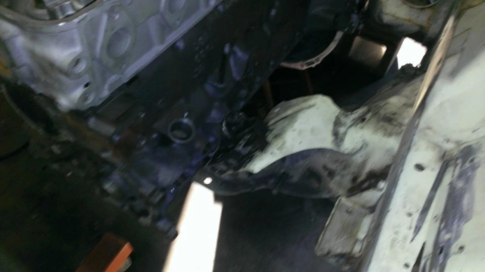

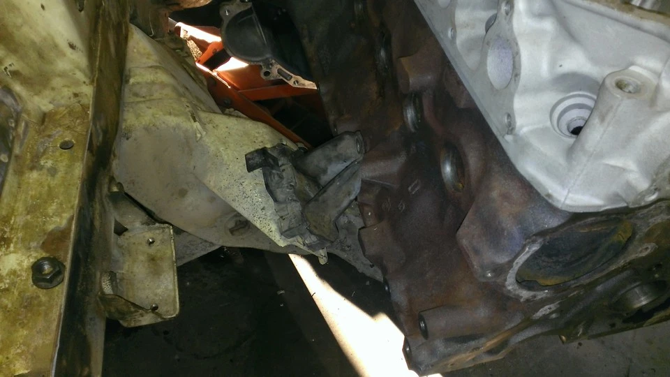

I drug the C-3, and the old 200 out into the driveway, and bolted my 250 bare block to my 4R70w and swung thatpair over into my now bare engine compartment.
Does it go right in, and settle into the factory mount pads that the 200 used to occupy?....Nope.
I have to modify the factory mounts to allow the wider 250 to fit.
Ordinarily, I'd at least use the trans mount to "locate" the combination, so I could concentrate on the getting the monts right.
Do I have a trans mount that will allow me to "locate" the combination?....Nope.
This transmission hangs 2 full inches past the factory trans mount. Besides,.... in all the time, and with all the cars I've dealt with, I've never seen a trans mount so badly mangled as the one under this car. It appears the little old lady that owned it before, must've ran over a boulder,..as the trans mount was badly bent, and distorted, literally torn.
I spent the next hour beating, prying, and bending the trans mount back to a state where the crossmember ( which was also bent to hell) could fit again. After all of that, the trans mount was so far to the rear of the factory location,...I just put a jack stand to hold it there, until after I figured out the motor mounts.
I had to cut the motor mounts, to allow the engine to drop,..but by the time I tackled that,..I could only manage one before the wife started "reminding" me that it was 5:00. So I did one.
I don't care what anybody thinks,.....This thing will be so damn cool.:cool:
Sorry for the blurry pic,..that is supposed to show the difference between how low I had to redo the mount.
compare to this:
