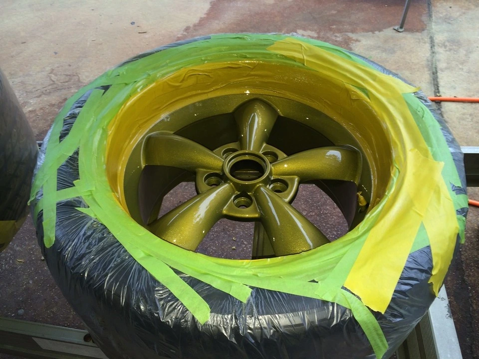

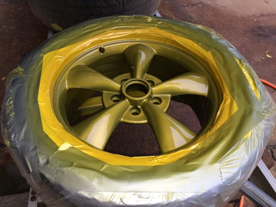

Coming back around to "the plan", I always intended to paint the black Bullitts Gold. In an attempt to give myself a break from the maddening monotony that is hand sanding, and body work, I removed the 4 wheels and masked them so that I could do that.
Months ago, I bought a qt. of low VOC single stage paint and hardener from Summit. The color was called Gold rush metallic, and the chip (from best I could tell) looked like the right shade of gold to fit the bill.
The ordeal of masking the wheels was no picnic. While better than having to sand, bondo and breathe 50 lbs of the resulting dust, it still took about 2 hours of just taping, followed by..........what else?
Sanding.
Well not actually sanding per se', it was actually "scotch briting". Just enough to give the paint something to bite into.
When it was time to spray the things, I opened the qt. of paint, and mixed it 4 parts paint to one part hardener, strained it into my Home Depot Husky gravity feed gun, flipped the wheels over so as to be able to paint the back side first, and started to spray.
Heavy metallic, but very transparent, it took forever to get the things to color.
Only problem was that they weren't gold at all. The color on a black substrate was definitely much more green-gold than gold. Didn't matter how many coats it seemed, the green gold hue was what I was gonna get. After 4 coats however, it became apparent that if I was gonna have enough paint to be able to paint the front sides, I was gonna have to bail on the backside color.
So I flipped them over. I had 20 oz. of mixed paint to try to get the outside of the wheels the "gold" that I had planned for them to be.
That was not to be.
So here we are, at the fork in the road.
Orange don't go w/ green. Even if it's green gold.
So my choices are to rethink the exterior color to a more green friendly color, or repaint the wheels.
The problem w/ repainting the wheels is....they now have 4 additional coats of paint on top of the black powder coated finish.
And.....
They look freakin' gorgeous.
* the white dots you see on the spokes are actually the reflection of the camera flash*
That paint flowed like liquid gold. Seemed I couldn't screw it up. As good as these things look, It would be a damn shame to paint over them, and take a chance of something happening.

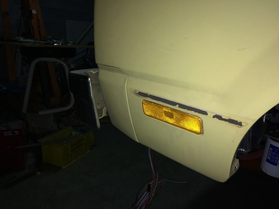

The front bumper is gonna eventually get a similar dork-n-dectomy, where I cut off the way too wide outsides, and blend them into the fenders. When you look at the front of a Fairmont, Ford used a plastic extension beneath a body line, actually "making" the extension part of that body line.
It just seemed stupid to me to re-make that plastic extension, keep that body line intact, and then come up w/ a way to assimilate it into the new front bumper.
I decided to eliminate that body line. And fill it in.

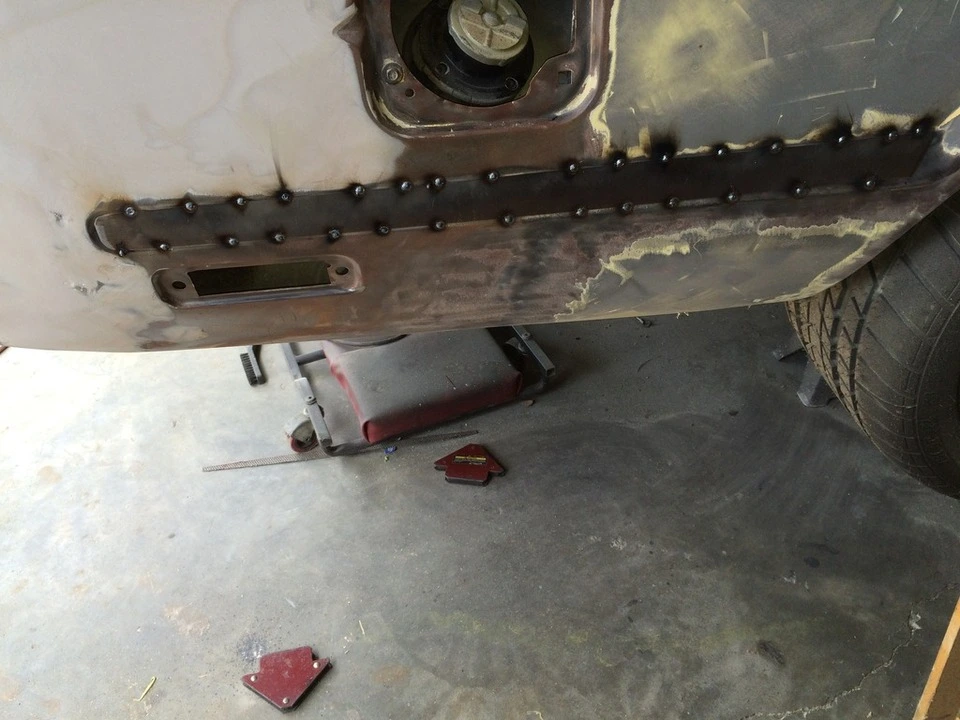

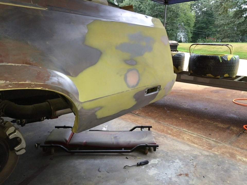

If I did it up front, I had to do it in back.
So I welded this strip over the body line.
And while I have yet to finish that side,.....
This side is close.
Doing that also solves the "road to nowhere" that leaving the old body line in back created. The body line actually ends, and then there is the bumper back there now blended into the body. Looked stupid to me. Now it's gone.

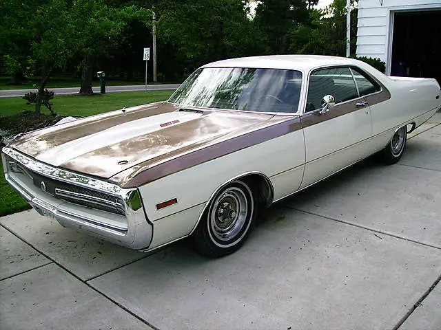

The Completely Obscure Original Tuna boat Chrysler 300 Hurst, sporting a "I can do that" paint scheme.

So you are telling me that's the same gold?
