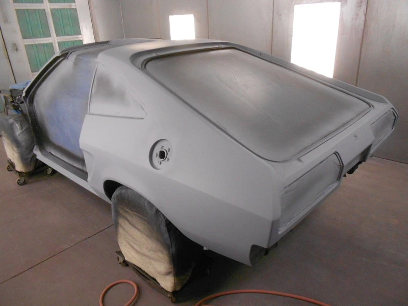

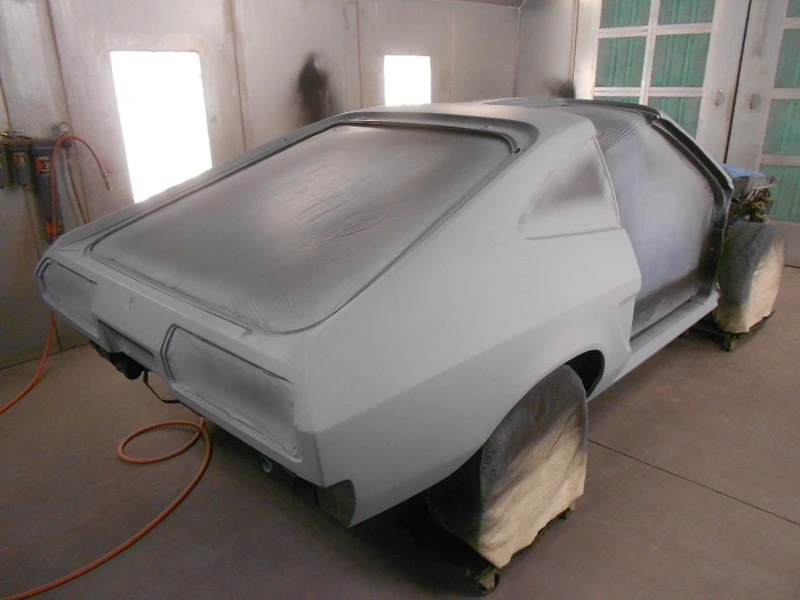

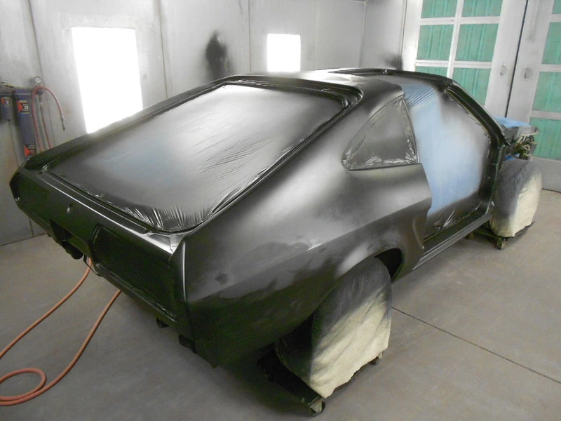

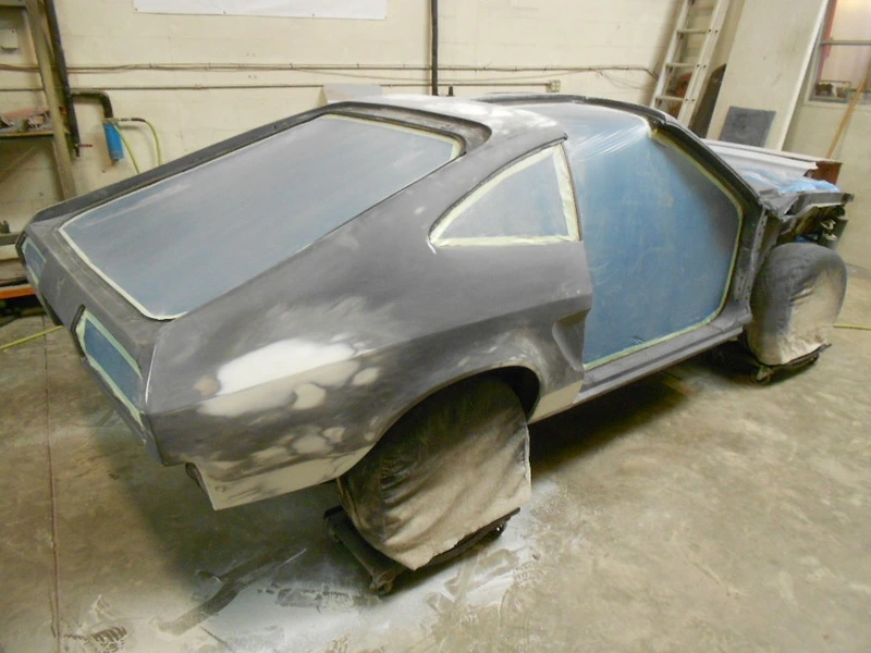

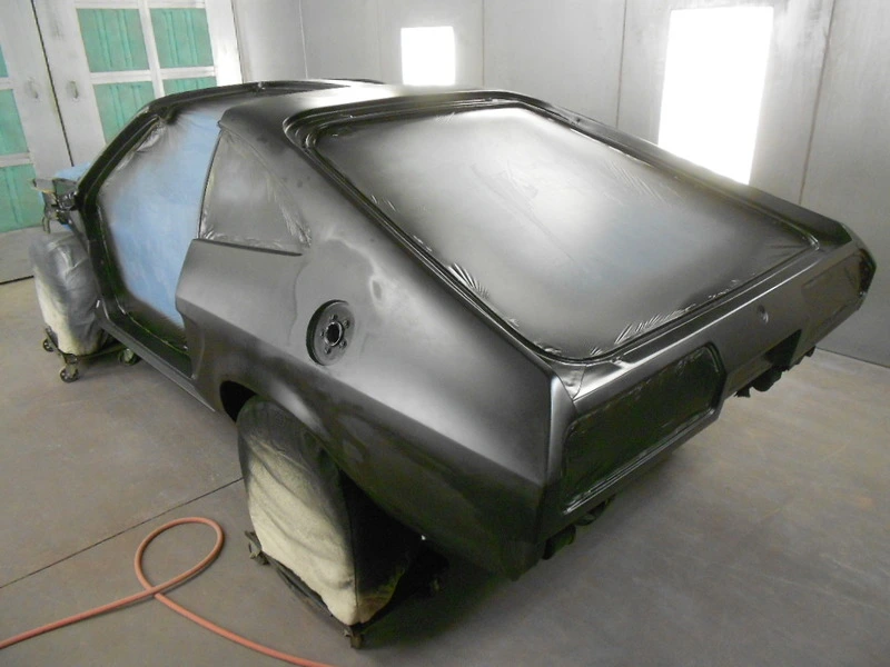

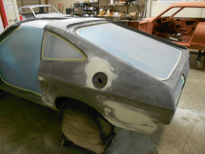

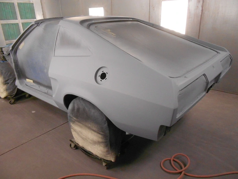

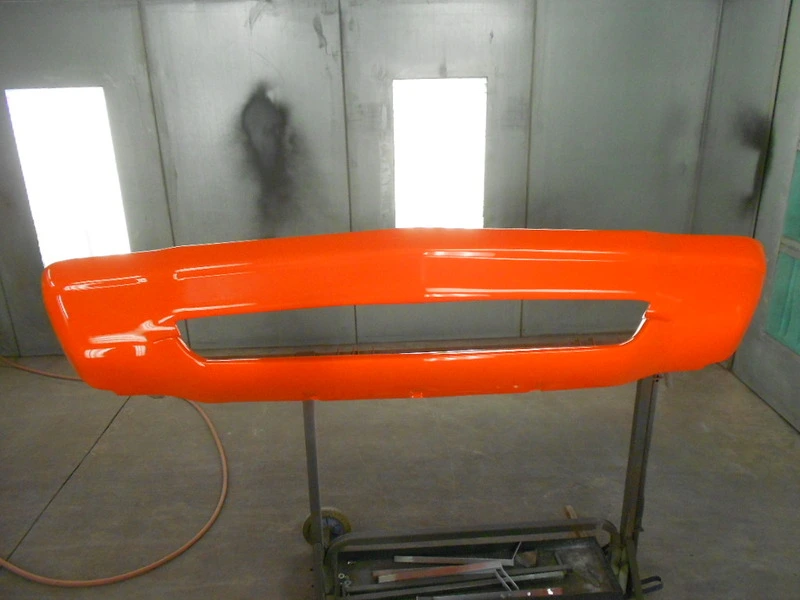

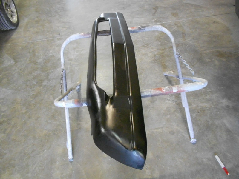

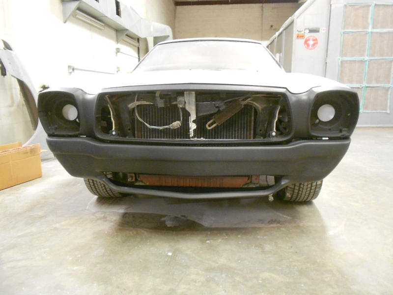

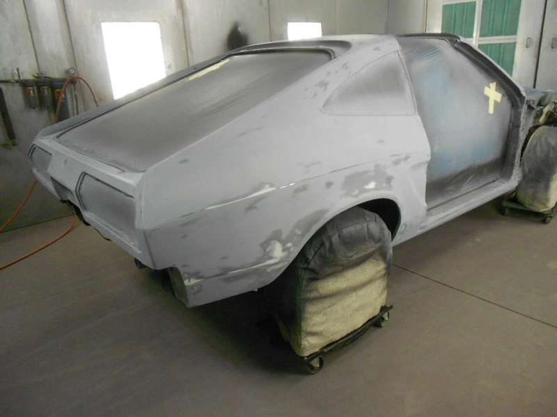

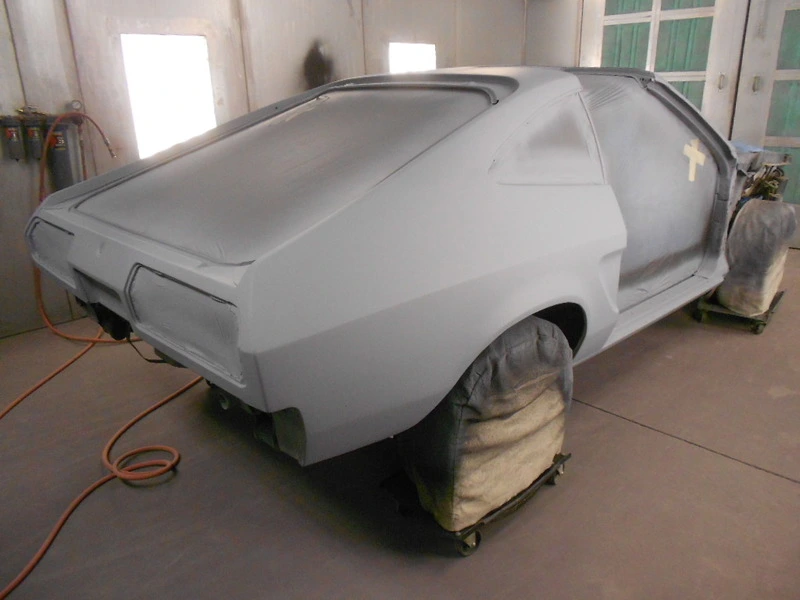

I have decided no spoiler. The major bodywork is finished

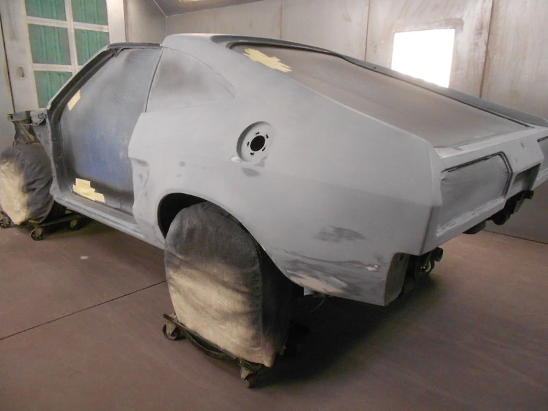

Two coats of SPI epoxy
Block sanded and a little more bodywork
More epoxy

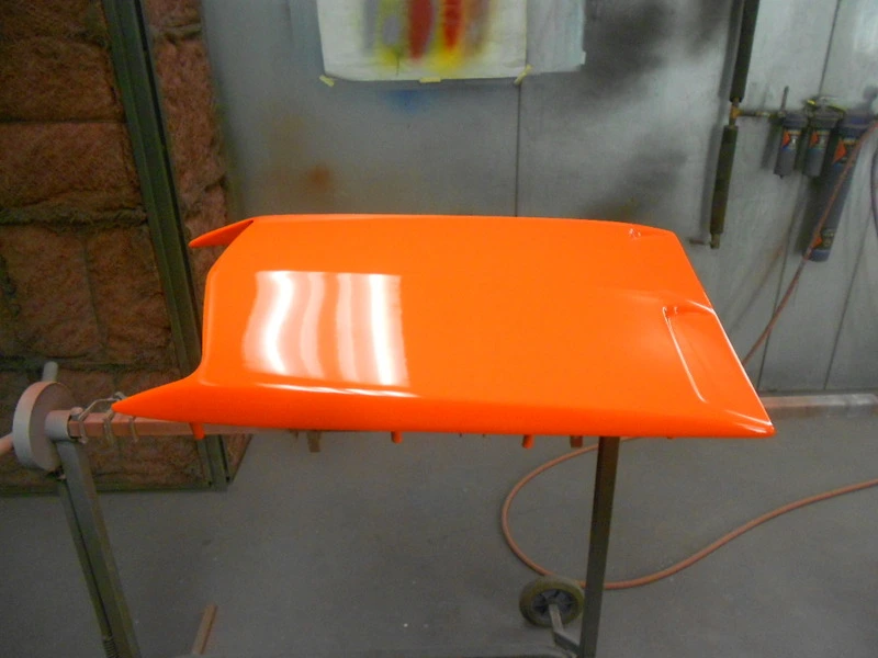

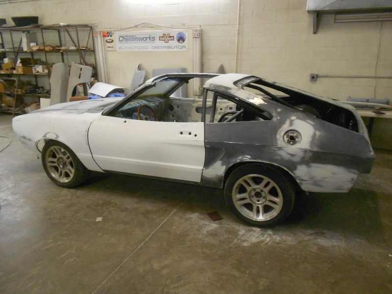

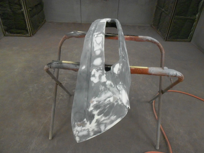

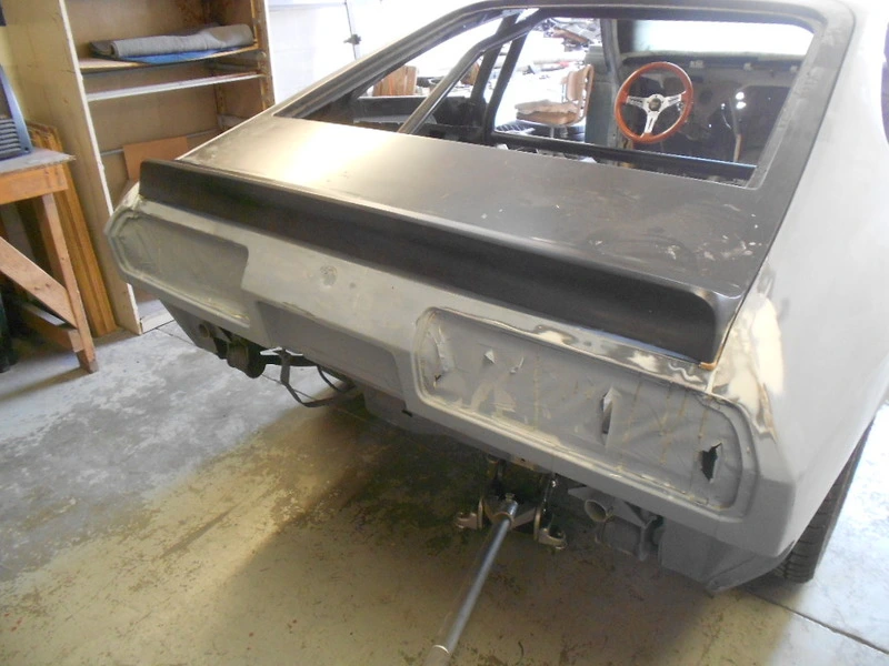

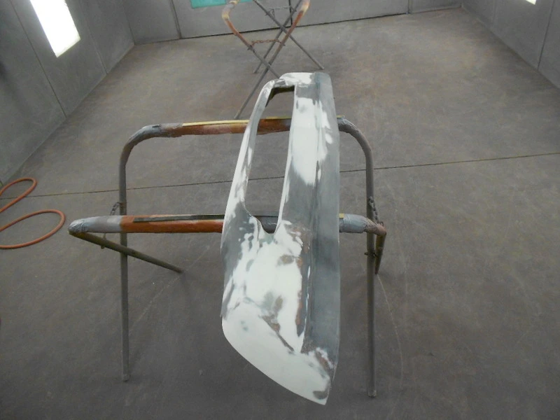

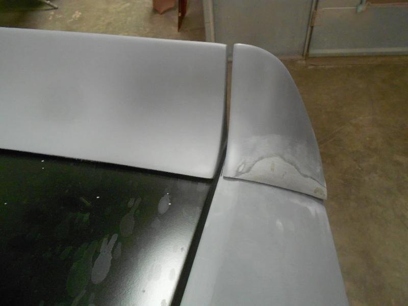

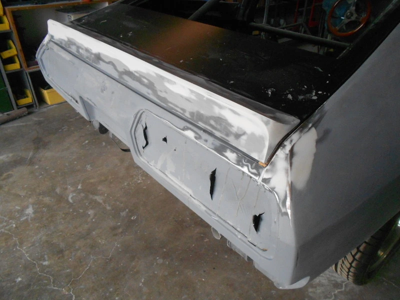

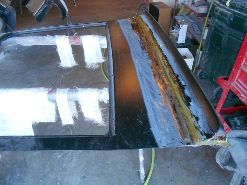

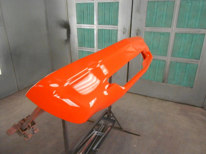

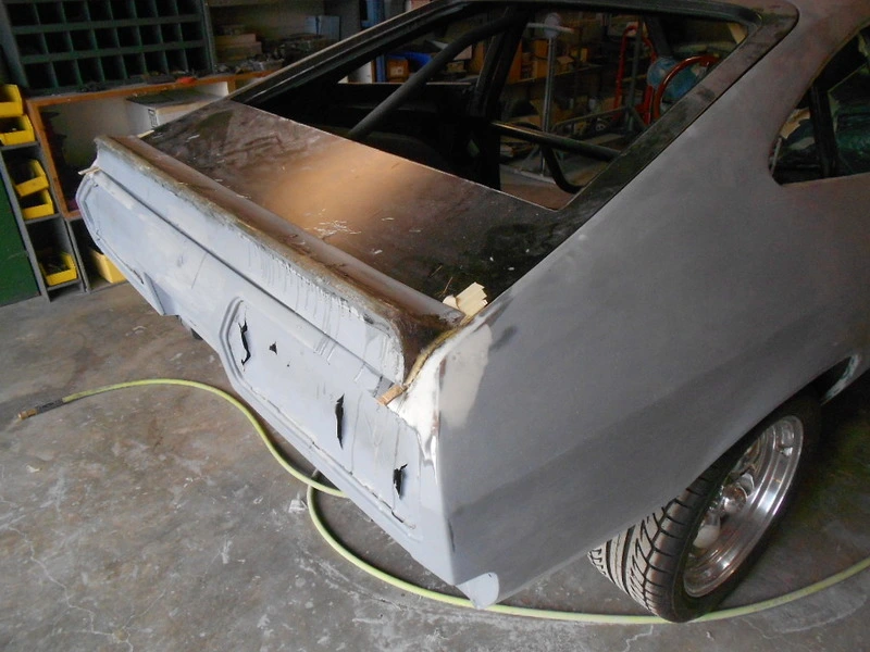

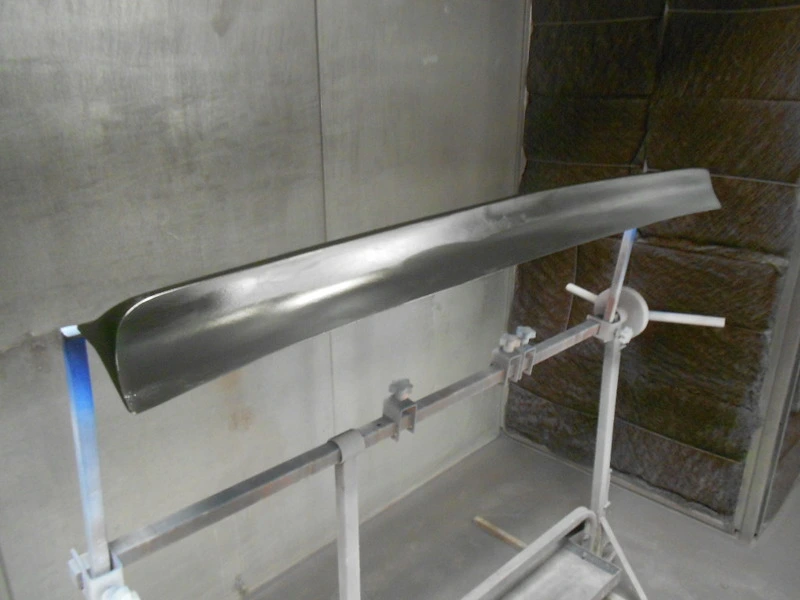

I ordered a spoiler from Mustangs Unlimited but after test fitting I realized I never did like how the spoiler is on the quarter panel and how tall it was.
I cut it down and added a little fiberglass
After some bodywork
Epoxy primed

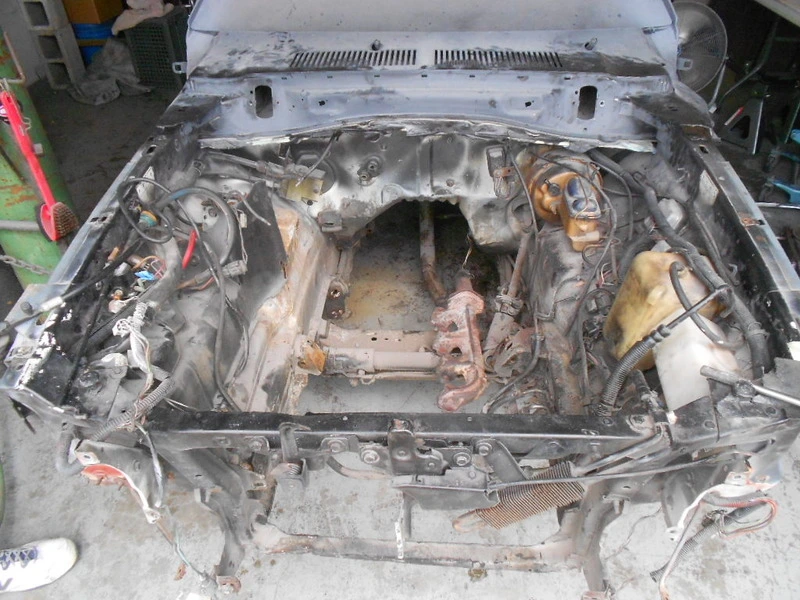

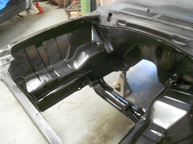

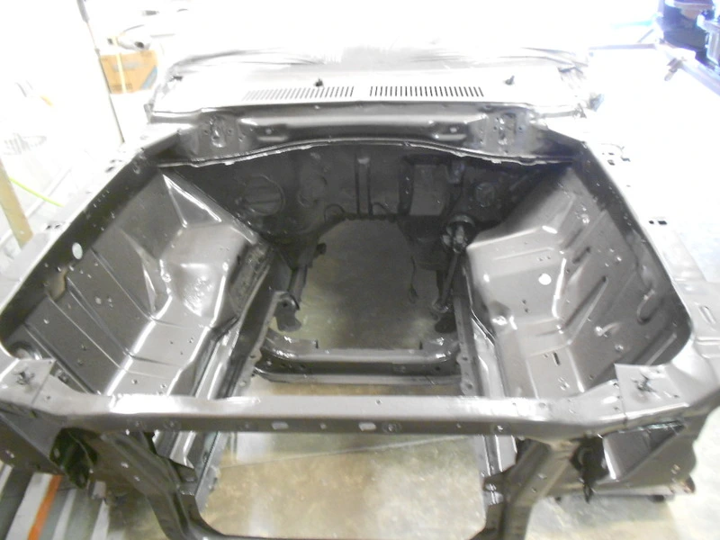

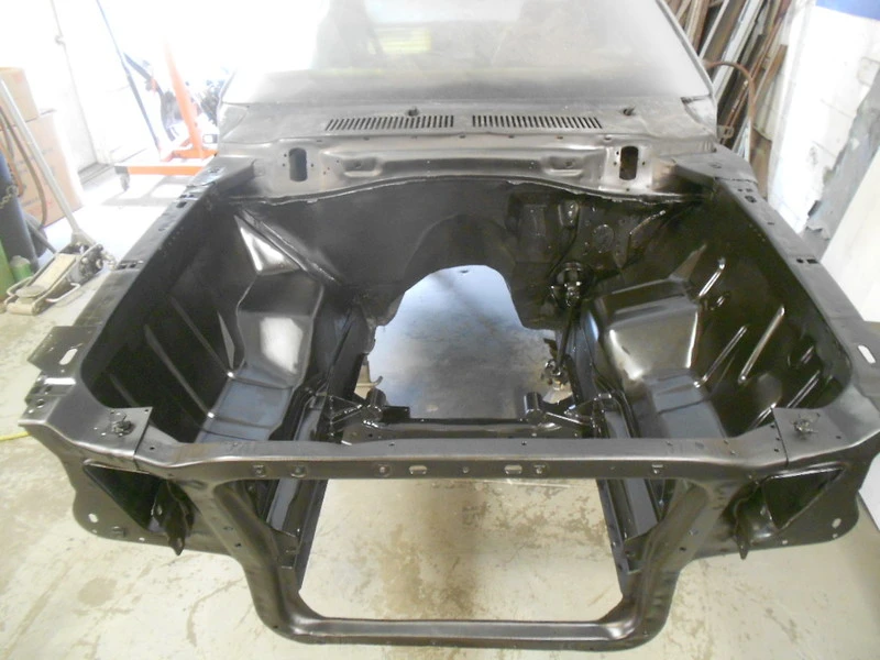

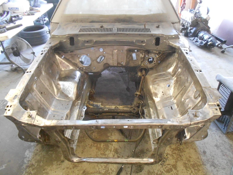

I decided it was time to upgrade the engine compartment

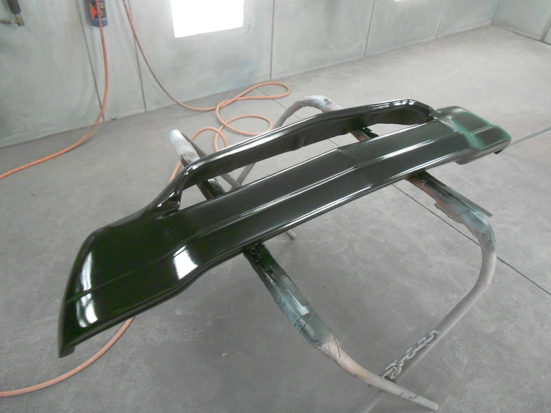

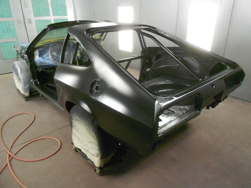

Two coats of SPI black epoxy

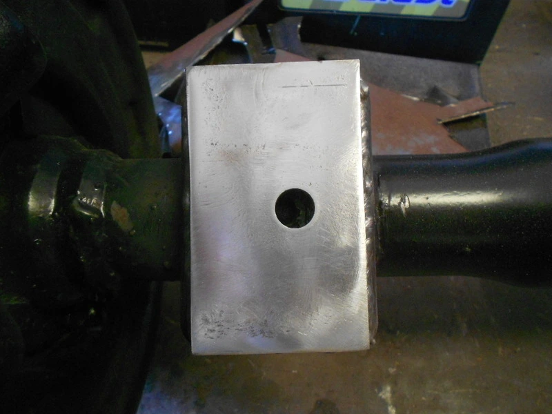

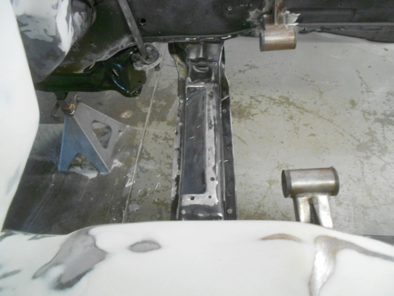

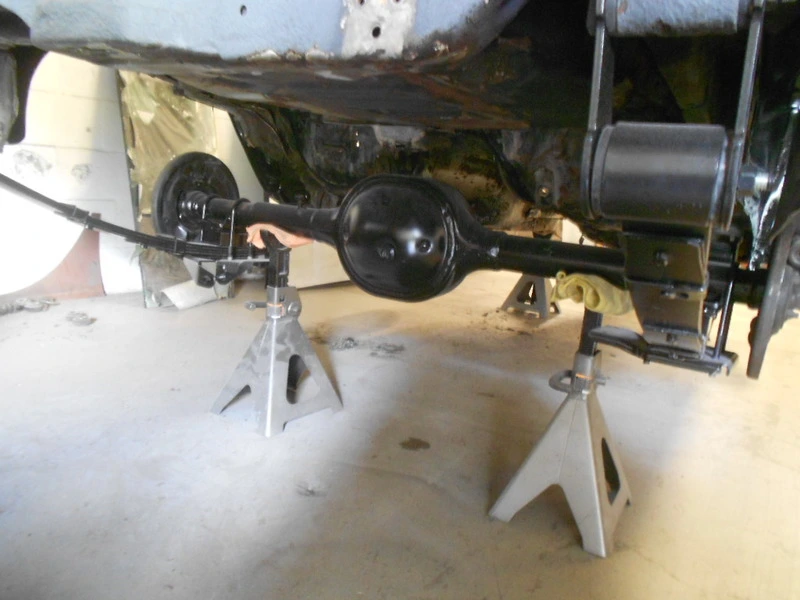

The spring perches on the 1965 rear end are 1/4" to wide on each side so we added metal to the bottom of the perch with an offset hole.
New rear shackles and test fitting the rear after the leaf springs were sanded and epoxy primed.

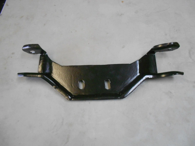

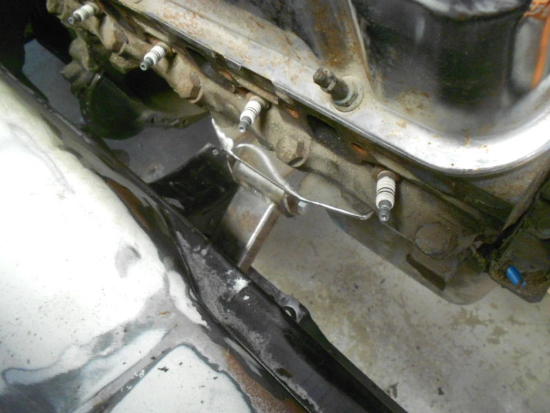

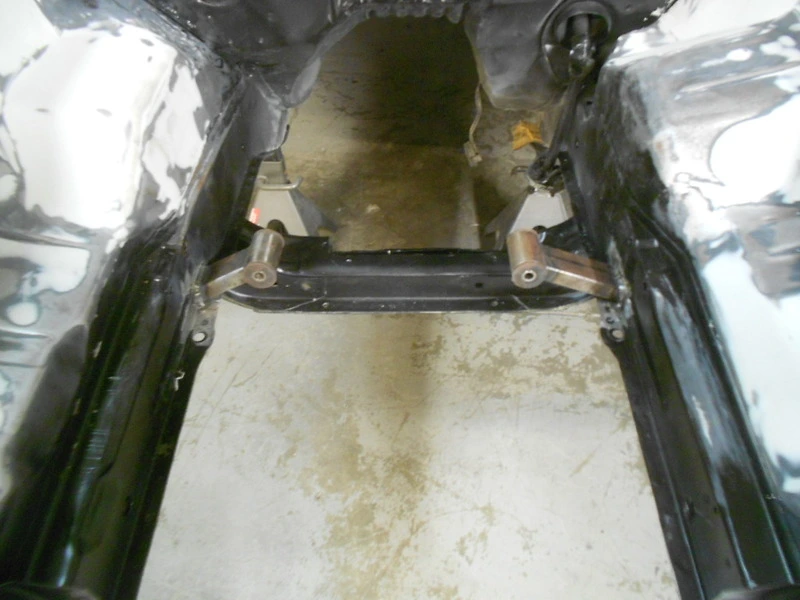

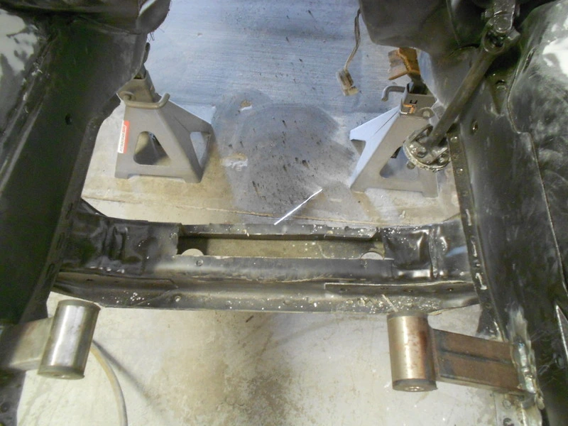

It is hard to believe but new motor mounts for a V8 are not available so we made our own. We had a set Rod & Custom small block motor mounts that we did not use on another project. They were cut down and welded to the frame

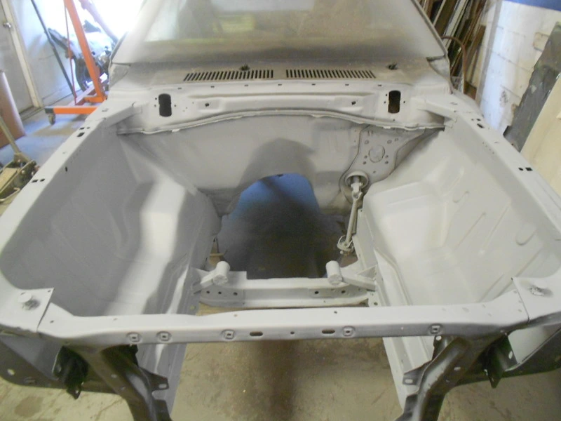

We will add another brace after the firewall is modified for the AOD and we install the engine and trans again

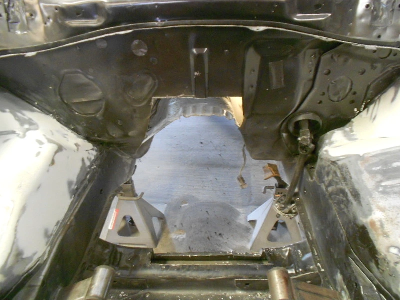

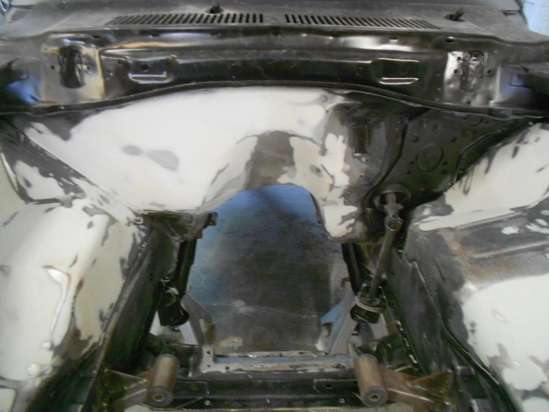

The AOD is a tight fit so to make it easier to install we modified the trans tunnel

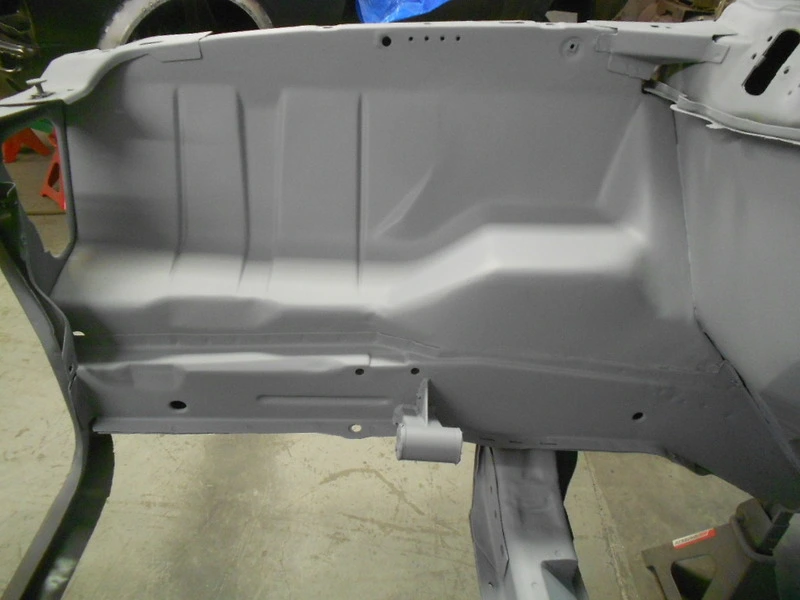

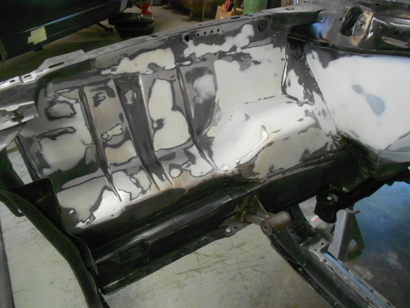

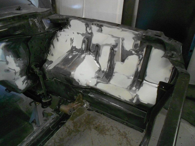

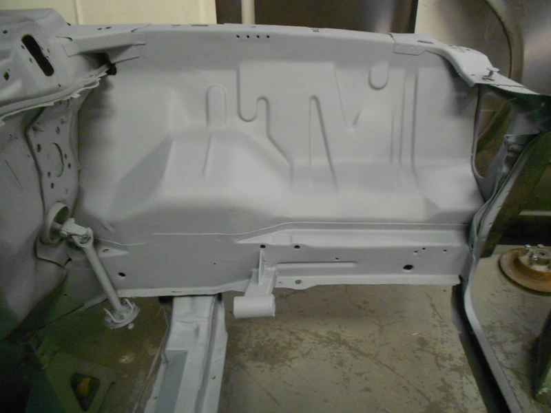

Also decided to fill some of the holes in the firewall
I also didn't like all the holes in the fender aprons

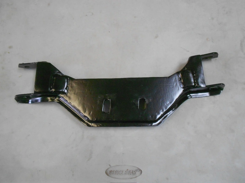

Crossmember was also modified for more clearance

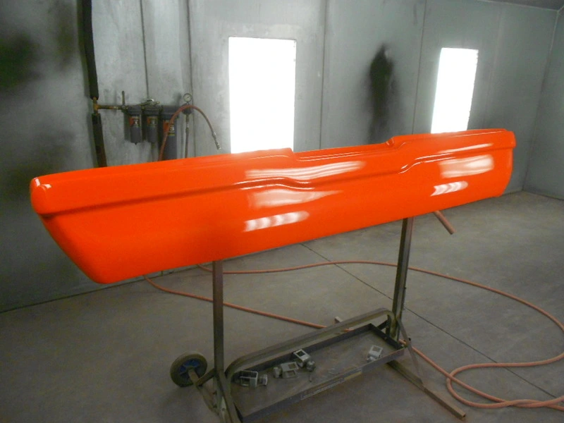

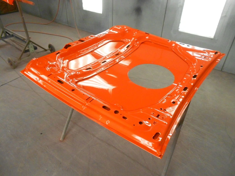

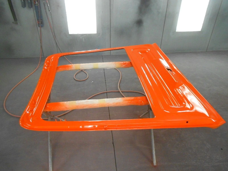

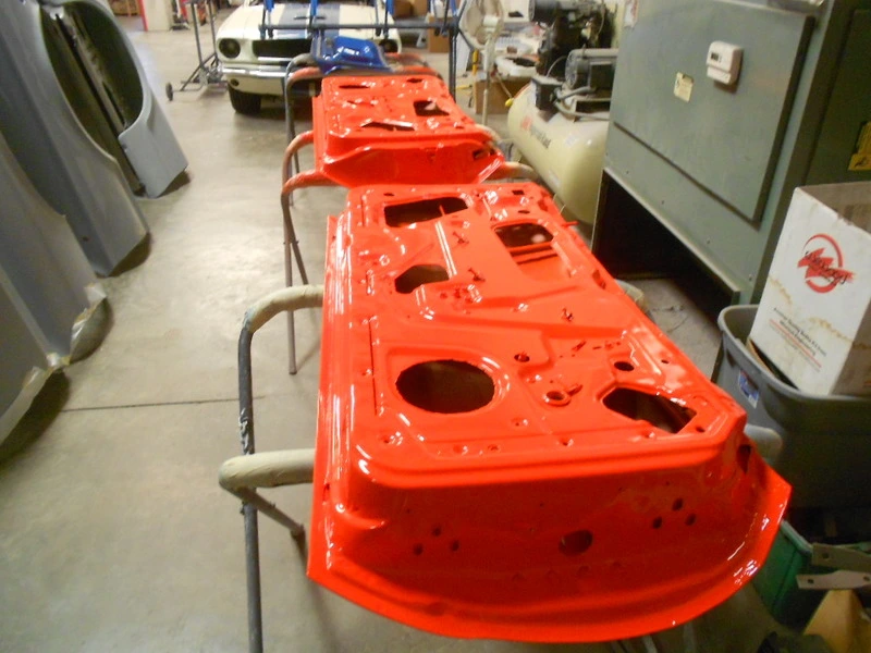

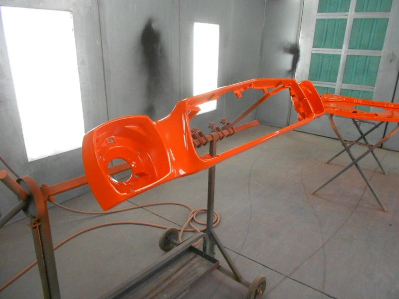

We had to do a little rust repair to the hatch and bodywork and I painted the back side SPI Orange. The spoiler was bolted and fiberglass mat was added and needed bodywork before the back was painted.
