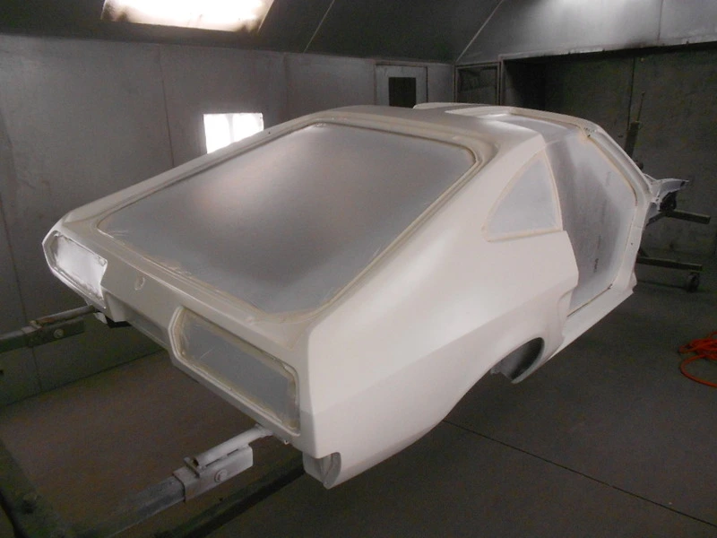

Two coats of SPI white epoxy. A little wet sanding and this weekend it will be SPI Orange

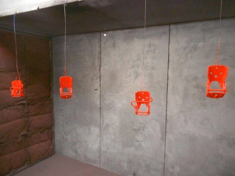

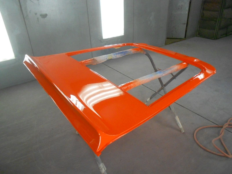

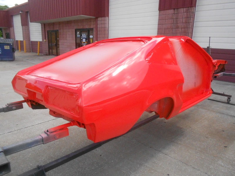

Three coats SPI Orange and three coats of SPI Universal clear.

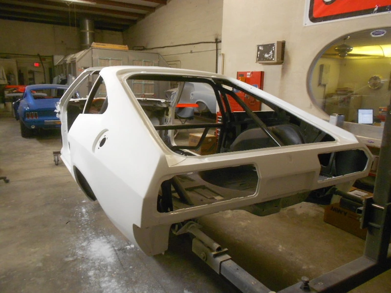

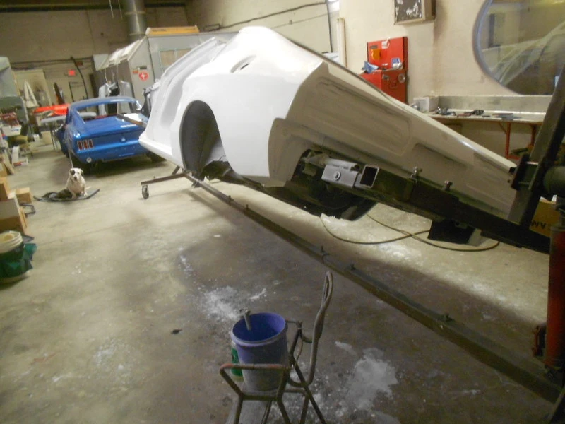

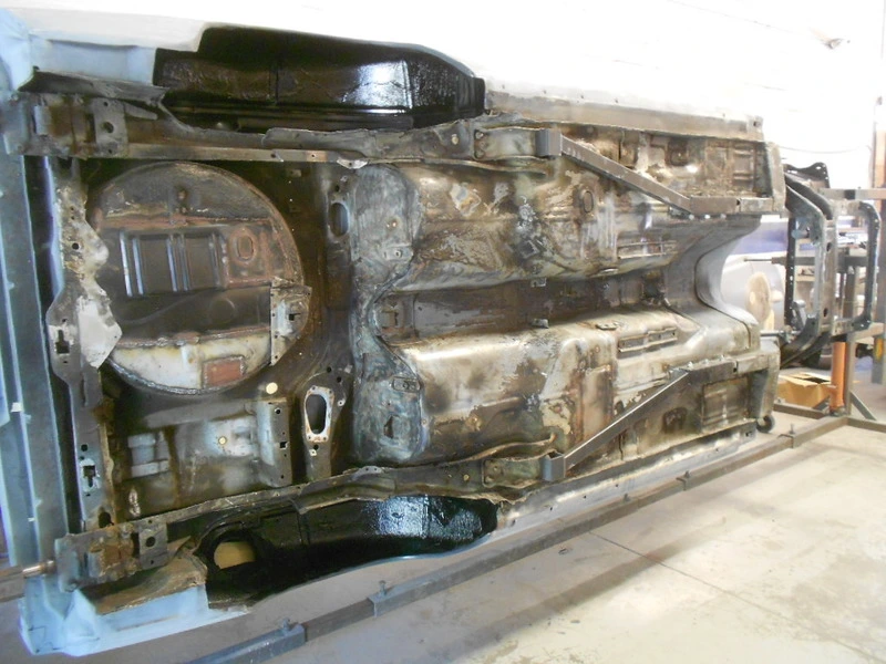

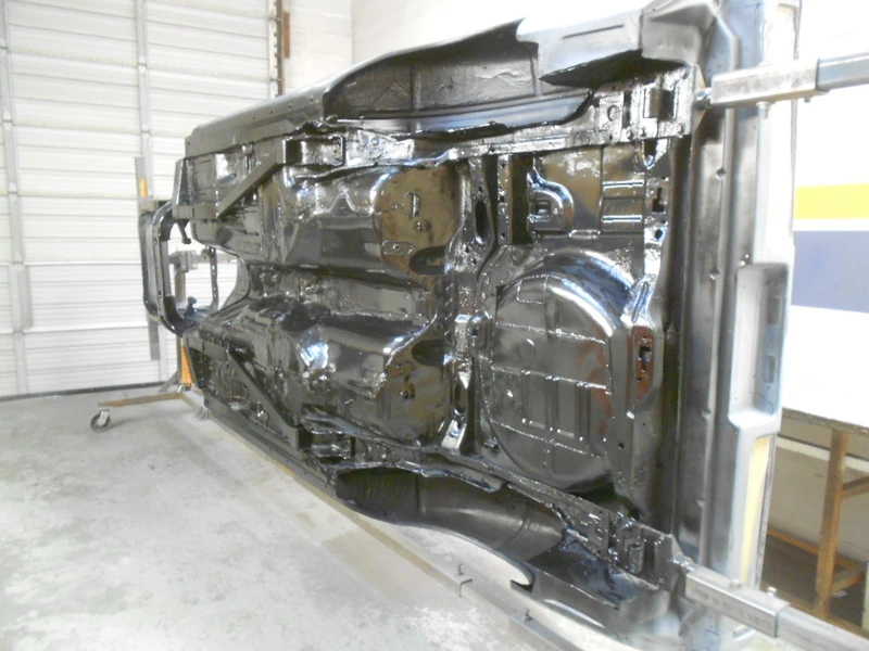

I had not planned on putting the Mustang II on a rotisserie but the more I thought about it I could not just leave the undercarriage looking like this. Brian and I (mostly Brian) fit it on the rotisserie yesterday.

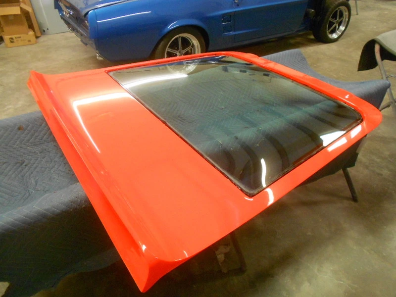

Yesterday I sprayed 3 coats of SPI orange waiting 45 min between coats and today I sprayed 3 coats of SPI Universal clear waiting 30 min between coats.

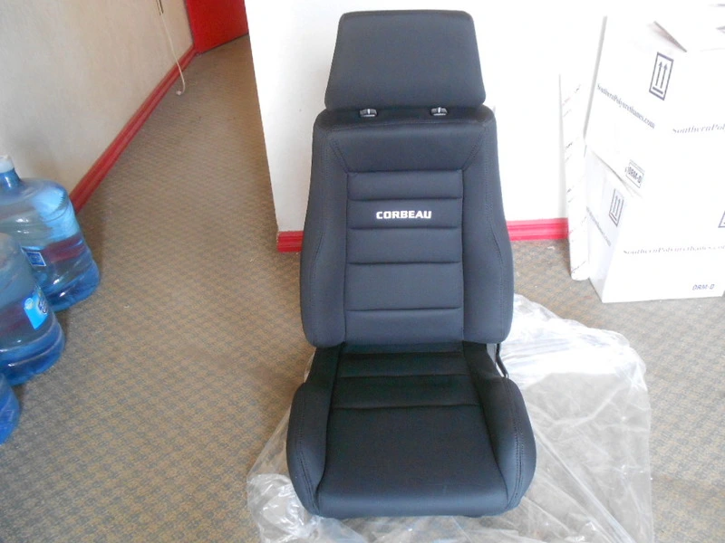

The seats came in today from Mustangs Unlimited still waiting for the seat tracks

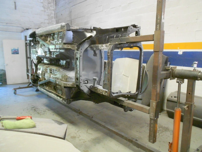

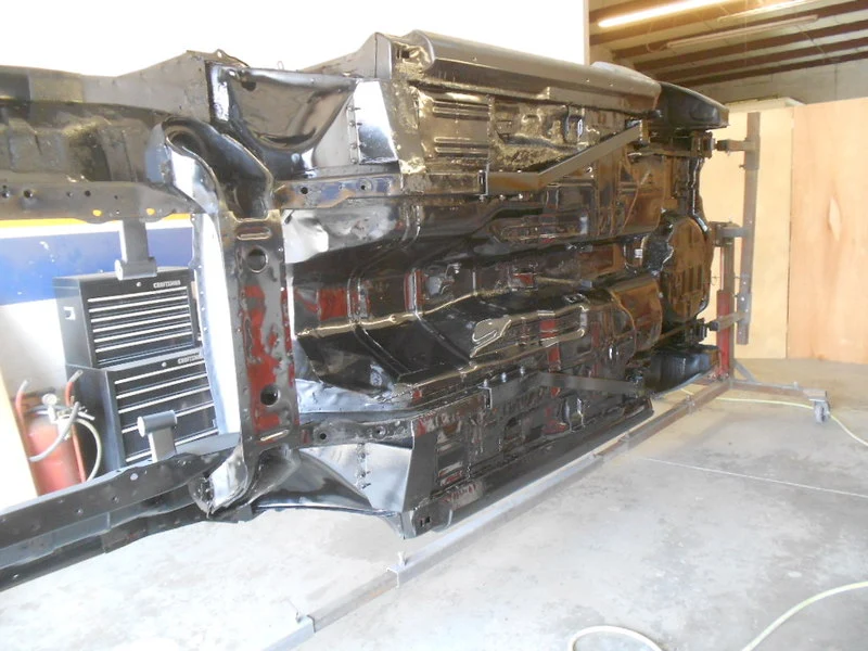

Last weekend I decided it was time to spray a couple coats of SPI black epoxy on the undercarriage

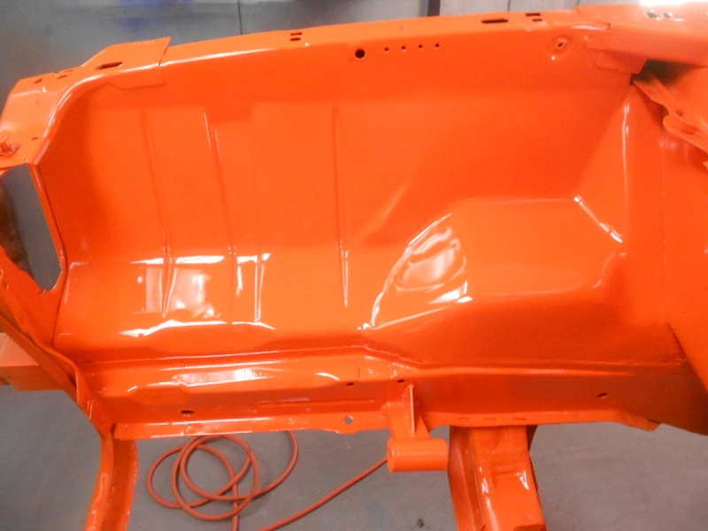

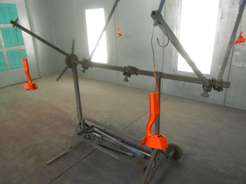

Today I painted the hinges. I know its not a lot of progress but you can't install the doors, hood or rear hatch without them

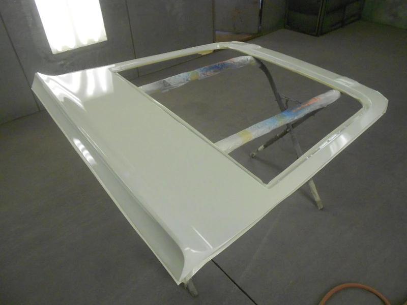

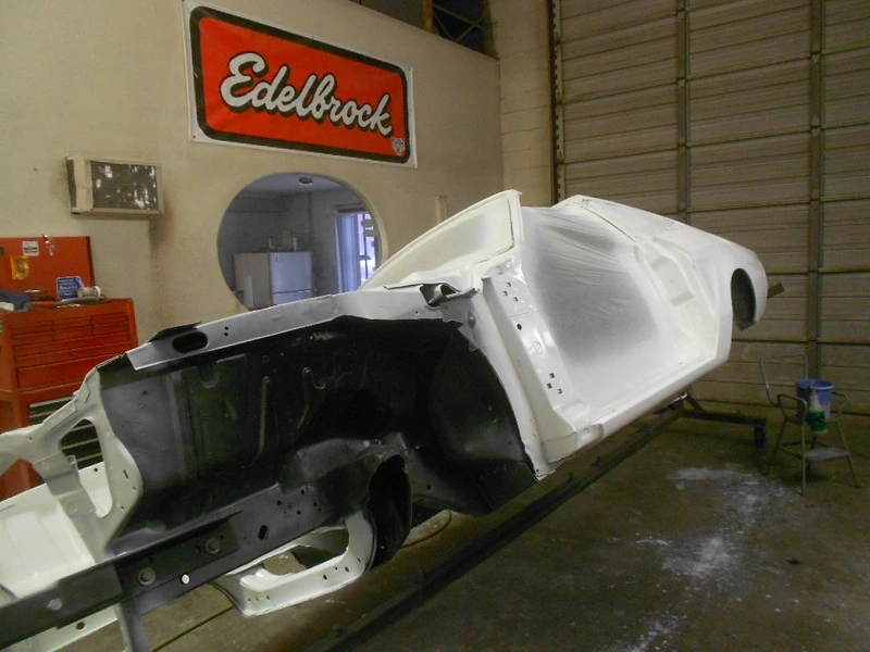

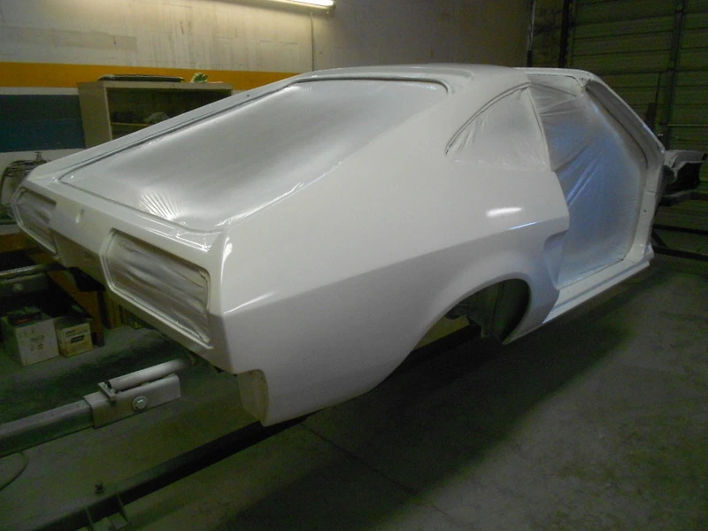

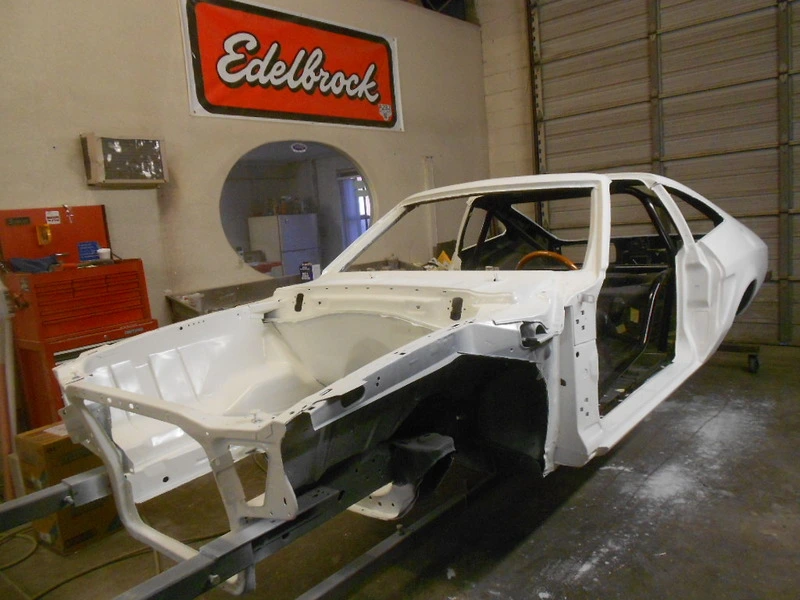

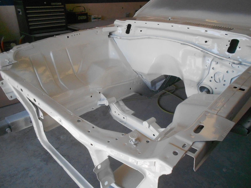

Two coats of SPI white epoxy. Almost ready for paint

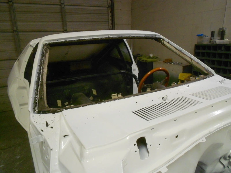

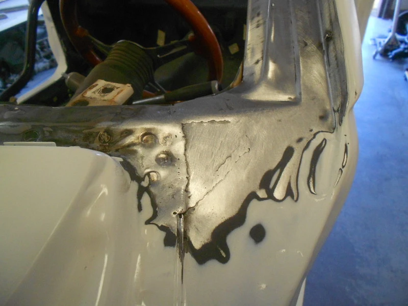

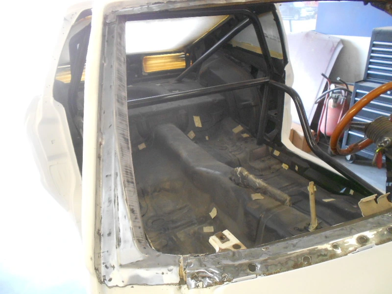

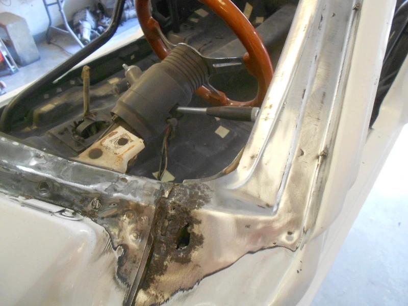

Today Brian cleaned all that nasty mess from under the windshield.
No rust in the right windshield pillar.
He found this on the drivers side.
Brian cut out the rust and welded in a patch.

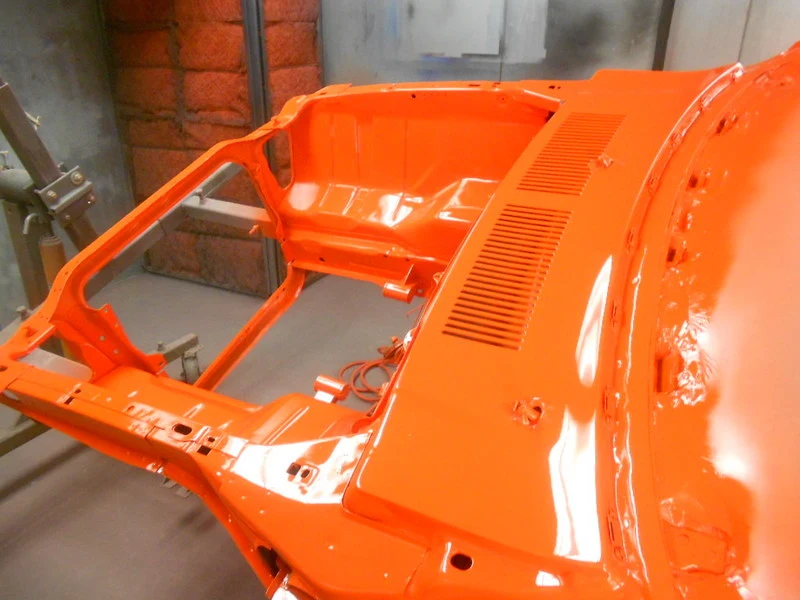

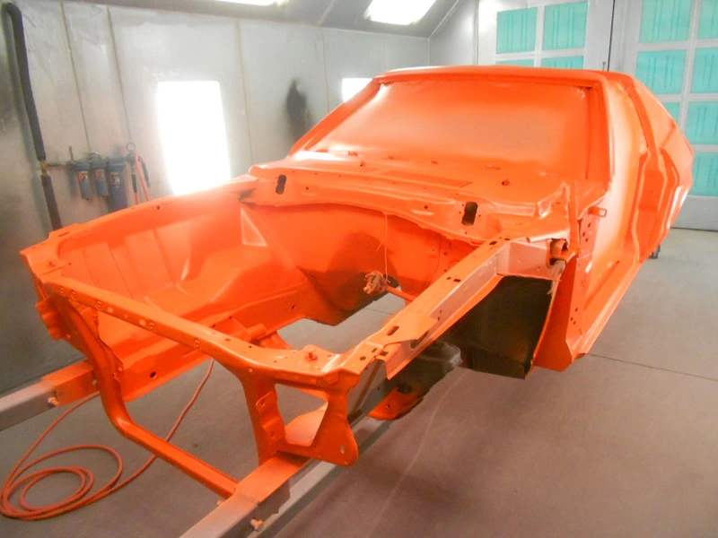

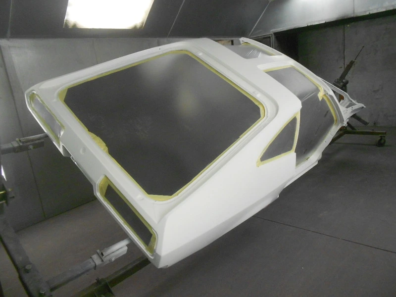

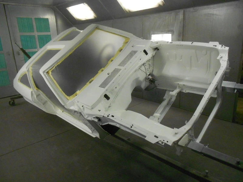

Yesterday before Brian went home he got the body ready for paint. Finished taping, moved it in the booth and wiped it down with SPI wax and grease remover.
I got up early and was at the shop at 5:30 and mixed up a cup of reduced SPI white epoxy and sprayed a sealer coat. Around 9 I will start spraying orange.

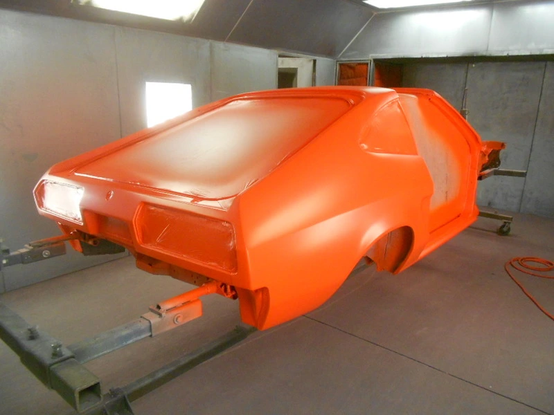

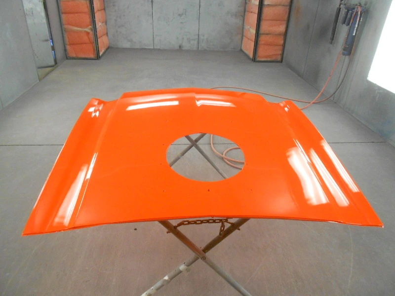

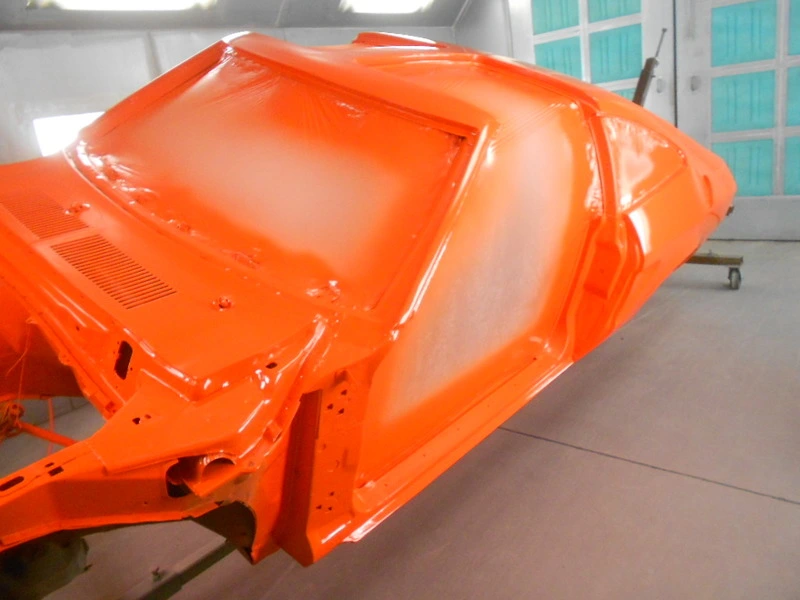

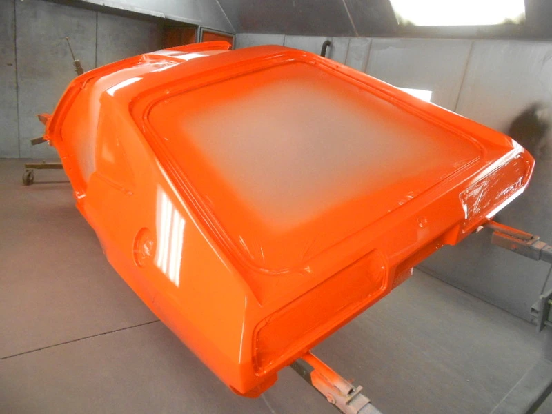

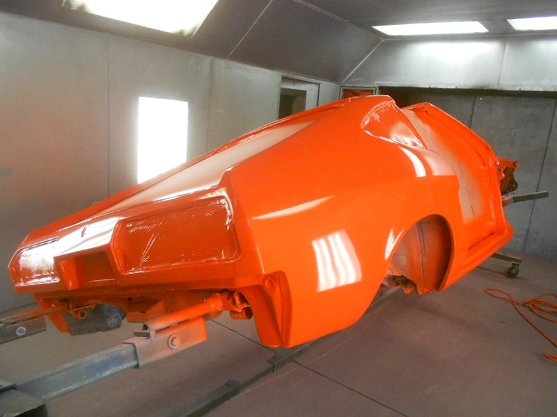

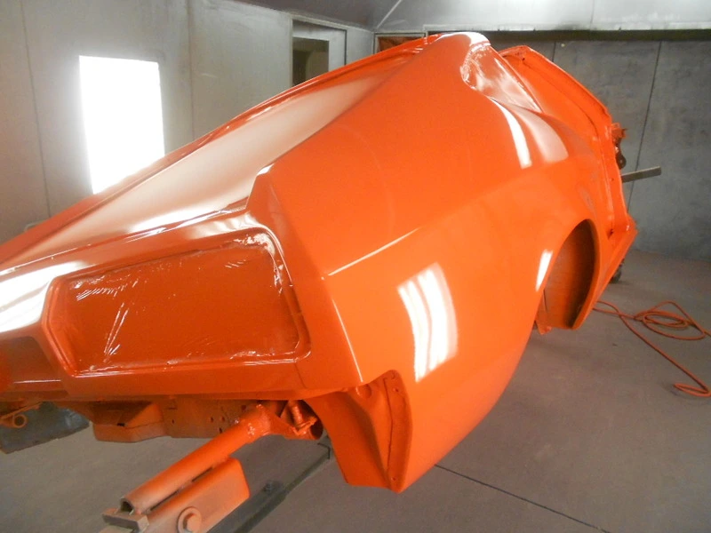

Three coats of SPI Orange tomorrow I will spray clear.

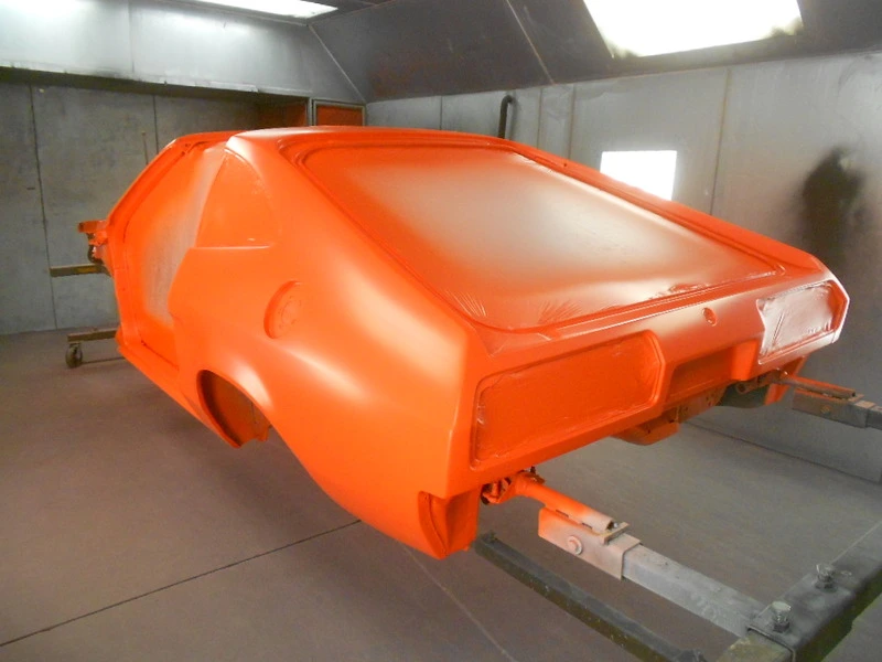

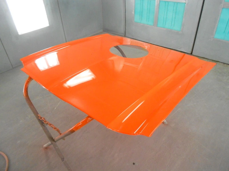

Three coats of SPI Universal Clear

It is hard to get the true color. In the booth it's to light and outside looks red. It is somewhere in between. Brian has been wet sanding the body and should start buffing soon.
