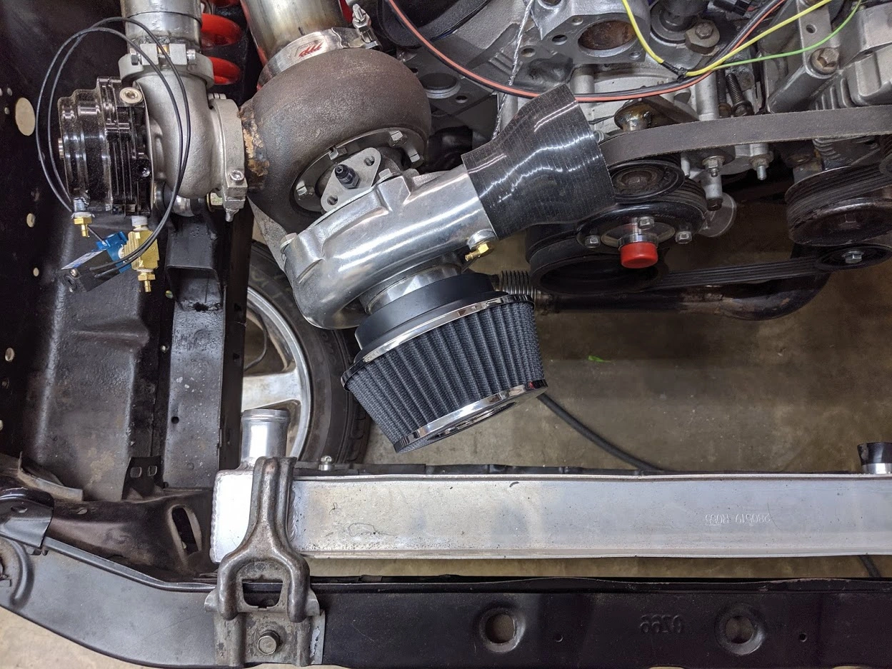

This has an inverted cone end, we'll see how it performs.

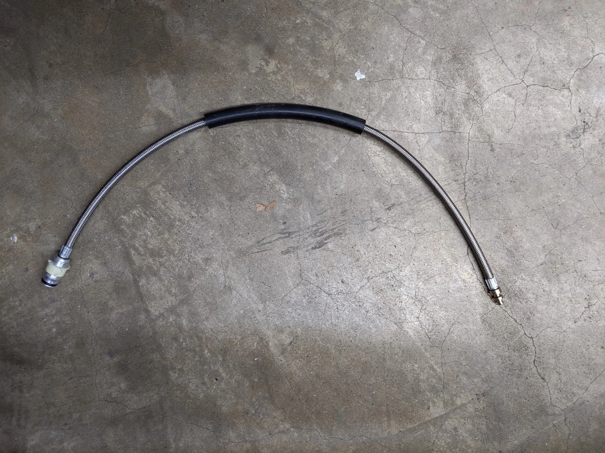

I got my clutch line in yesterday, turns out the t56's in 98-02 camaros use the same fittings as what I needed, got an damaged box special on amazon, 20 bucks for a flex clutch line

You do realize that the air that filter breathes is probably coming from the single hottest place in the engine compartment.:shrug:
If I didn't I am thinking about it now. Here are some of my educated guesses:
I want to believe the radiator shroud that will be between the filter and the radiator will help with some of the heat from the radiator, I feel like ambient temp in an engine bay will only be helped by placing the filter in the fender or ducting air in, that's what I'm leaning towards.
That being said I want to postpone that journey till after the car can move under it's own power.

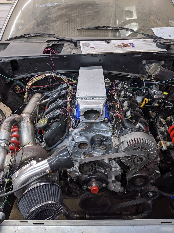

Started wiring tonight. There are a lot of wires here but I didn't feel like it was overwhelming. About half the wires are for spark and injectors, the rest is just sensors and the majority of those were predefined and labeled. Dissecting what's needed for power wires was a good bit of reading but now I've got relays ready and fuse blocks on the way.
Now that I think about it, sacrificing a bag of zipties might be what made this so pleasant. For a couple bucks at harbor freight you've got a hundred ways to bundle wires together. Need to tweak something? Chop chop and zip it up.
I've got high temp cloth tape as well as a box of new and lightly used corrugated loom and a good amount of stock hold downs. I'm feeling good about this.

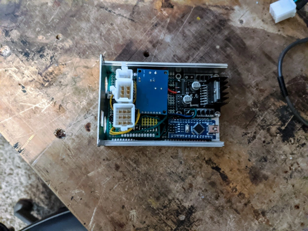

I've been working on the throttle controller over the last week. It's been an example of iterative design. This is the third or forth iteration. I've added canbus and a second arduino in the process. Now we're talking right to the ecu, have pedal mapping and idle control. Bench tests looks good so I suppose I'll hook it up tonight and see if the hard work pays off.

Are you going to use the idle control through the MS3 or somehow add that process to the controller you are building?
Unless I am mistaken the MS3 can adjust target for idle (looks like it was added in 1.5.2 beta 4). If not then I can do it on the communication side of the controller.

I got the throttle controller working. It needs some enhancements but overall it is talking to the ecu and giving me a smooth operation.

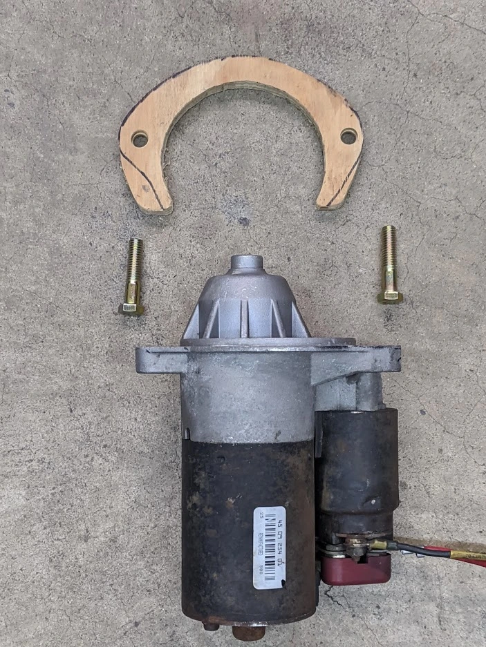

My neighbor, an actual mechanic, is over and we start it up. He points out in a heart beat a noise I had not been able to figure out. The starter's still engaged. It's not so much the starter is stuck as it's too close to the flywheel. I didn't even think twice about reusing the starter from the explorer, the automatic explorer. Luckily there's no damage to the flywheel or starter and I just need a shim. Ordered. But I wanna try and get the car to run today.
A little more trimming on the outside to fit and this thing works like a gem. For any concerned citizen the actual spacer comes in soon and the alignment precision of this spacer is just as good as any ford 2 bolt starter spacer.
