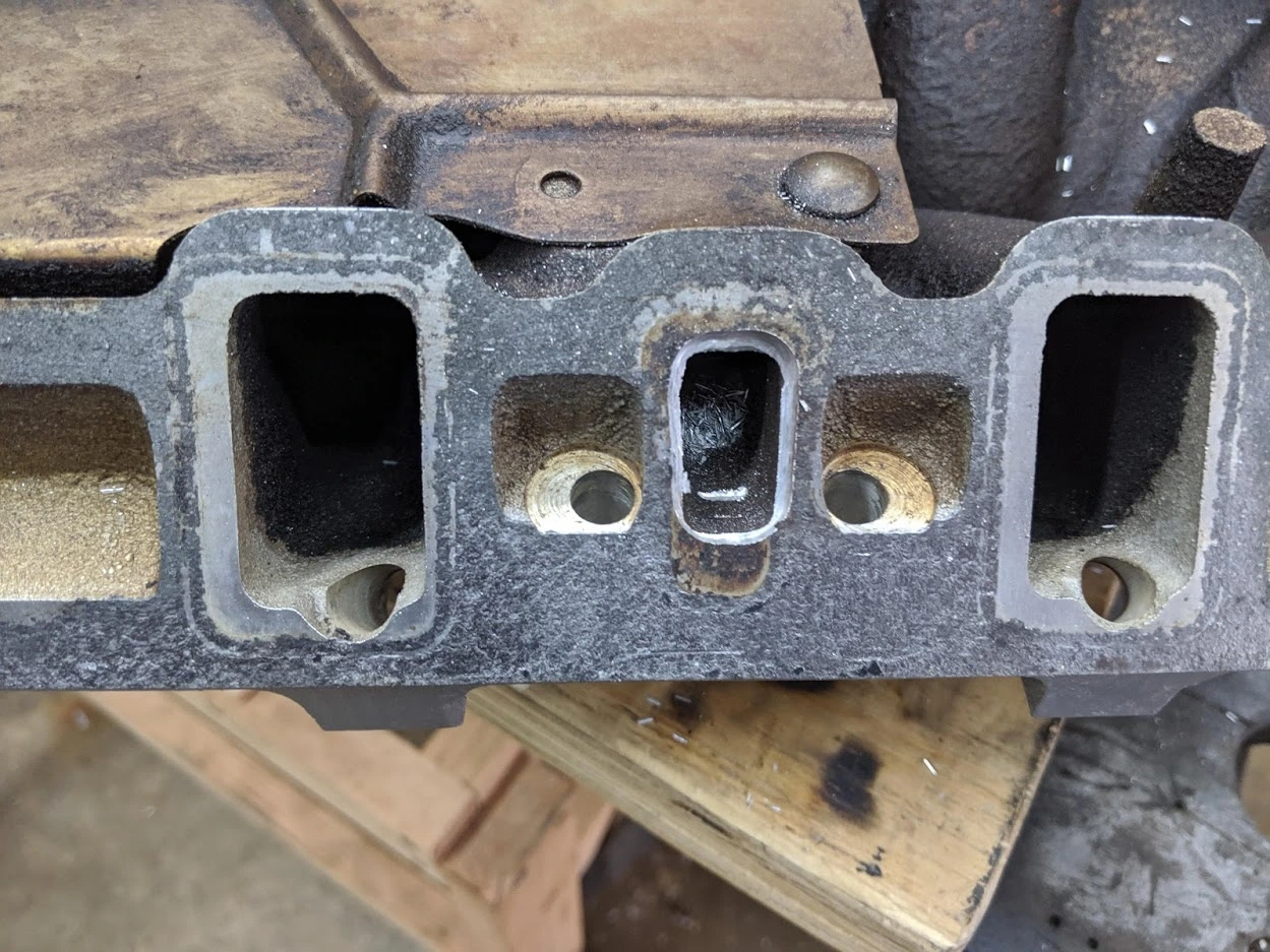

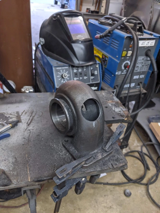

Knocked this out real quick last night. Should be sealing the lower intake on this weekend so I wanted to block off the egr ports.

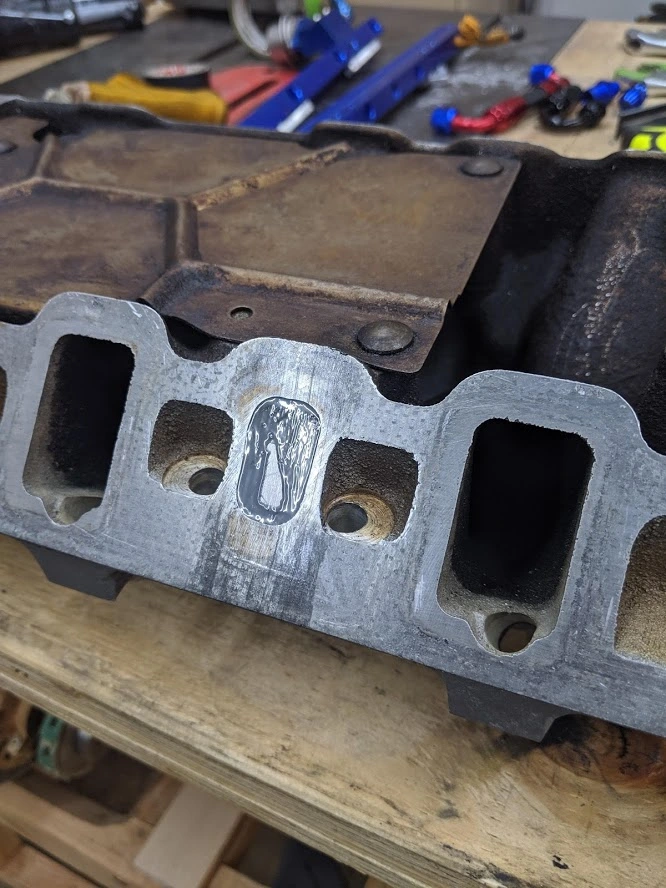

A router bit with an undersized bearing made quick work of this
And epoxied in. Might skim more epoxy over it for a completely flush finish but if the gasket sits outside the cut that's probably not gonna happen haha, I think this will do the job.
