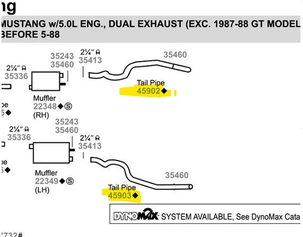

I bought a used set of headers and pipes with mufflers for my '82 stang with 302 engine. They were on a 1984 Capri with the same engine.
I need the tailpipes because I was not sold the tailpipes.
Who has any experience with tailpipes? I'm not looking for fancy stainless or anything, just basic exhaust.
I have read that exhaust for years 86-93 will work for my application since they are all Foxbodies.
I am looking at Walker exhaust products. When I call around, the local parts stores give me part number 45903. When I look that up, it's the LEFT side tailpipe.
I looked online and I see that 45902 is the RIGHT side.
My question: do I get 2x the LEFT tailpipe like the local shops here tell me? or do I get 1x left and 1x right?
Does anyone know what I need? I will need to install hangers, that's ok, I'm just looking at ordering the tailpipes for now.
I just want the proper clearance and angles, I am aware that I may have to do some modifications.

Right for right side, left for the left side, the parts store counter person only sees what's on the computer screen, they are not paid to really think. Others just don't care.
I think you'll have to deal with a possible brake line to rear axle issue, maybe not, here @limp just worked through this.
That's what I was thinking, but 2 local stores and one online store has said the same thing, only giving me the part number for the left side.
I will search for @limp 's post, thanks for the help!

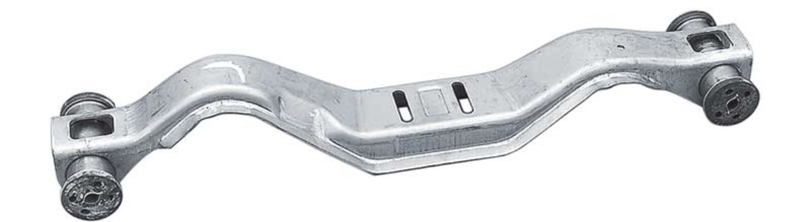

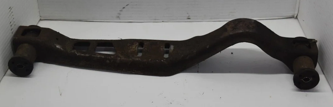

You are also going to need a “double hump” cross member to provide clearance for the dual exhaust.
Single Hump
Double Hump
Reactions: 85GT4V and General karthief
Single Hump
Double Hump
Yes, I already acquired one, thanks! Good information for anyone else coming upon this post in the future!
