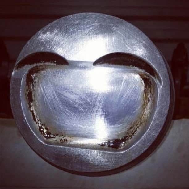

I have a stock 302 mated to a Weiand 174 right now. Very easy going on the road and decent power. Not enough though, but not bad considering i have the stock flat tap cam and big 69cc chambered heads. I have ready, a set of windsor sr heads for the motor (prepped and cleaned with a valve job), some Probe SRS pistons used in a 347 (I wont be stroking it) on boost and a custom ground cam. Im just going to swap out the pistons on a stock crank and balance the rotating assembly.d As for the cam, its a custom ground turbo cam from comp if im not mistaken.
Its a .598/.600 lift, 254/248 dur @ .050 with a 114 lsa and 112 intake cl. (based off 1.6 rockers). Just curious, what will the idle be like? anyone have anything similar?

Don't think the 347 pistons will give you the right compression height to work, unless your looking for like 7:1 compression ratio or lower. Might want to rethink that.
Scott
Well, with the stroker crank (347), its at 8.5:1 and 331 is at 8:1. But I compared the pin height and rod length and piston height, and it looks the same as the stock trw pistons i have from a seperate motor. It just has the bigger and deeper valve reliefs. That allows me to boost more. I was thinking of compound boosting in the future, but thats a whole different story. I was planning on boosting around 10 psi depending on my CR after the pistons.

Like already said, I wouldn't use the pistons. You're going to have a half inch of deck clearance which is senseless. I can't remember if stock '84 pistons are forged or not, but if they are, I would just continue using the short block as-is. If not, just buy a used 87-92 5.0 off Craigslist, you'll have less money in that than what you would trying to swap pistons and rebalance.

The internals are cast. But I need the pistons to clear the valves on the heads. i could always put a smaller pulley to boost more lol.

How do you know you need to notch your pistons? Have you checked PTV clearance?

Where did you measure from center of pin to top of piston for compression height? I find it hard to believe they are the same or even close. Last I knew all the 347's had a oil rail support rail in the pin boss.

Ok, so I got the spec sheet from Probe. They are custom ordered pistons. The rods are 5.4".
Piston Specs:
bore: 4.030
comp height: 1.300
comp ratio (with 64cc heads): 8.5
pin dia: .927
Let me know if these adds up to a long rod 302. Thats what I'm thinking because of the comp height.
