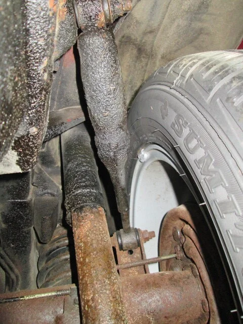

Here is a picture of the right rear:
Yup, the shorter longitudinal shock in the top of your photo is a quad shock. The stock rear suspension was kinda soft for comfort, but that softness let the axle move around too much and created wheel hop. The quad shock was supposed to slow down that extra movement to reduce that wheel hop. A Google search for "mustang quad shock" will find several results. Not sure what a shop would charge for installation, I've been replacing my own for many years. It's something you can do yourself if you want to give it a try.

If your backs look as bad as those pics, i would not be considering just the rears. I'd do the fronts for sure.
