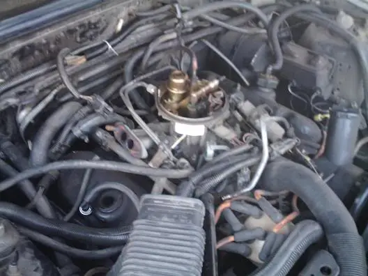

I just picked this car up on thursday and am trying to get it roadworthy, I need something to drive for the next couple weeks till I get my regular DD going again.
Recently been replaced: Water pump, plugs, wires, cap, rotor, timing chain, fuel filter. Not sure wether it was done at a shop or a "handyman" (i'm leaning towards the latter as he took it fir a test drive with the hood unlatched.... i'll be pounding dents out of the cowl later..)
The bad: Exhaust rotted off after cat (fixin today) battery cables corroded to hell (replaced) battery toasted (replaced) 245K k/m, engine is a big ball of grease from leaking v/c.
When its started up cold it will idle at 1500 rpm but occasionally it will fall to about 500, catch itself, then keep idling at 1500 rpm, when you rev it up it will rev fine but when you let off the gas it will almost stall (like someones cut spark) then once again catch itself and keep idling fine.
I'm getting codes 12, 23, 31... I think, was reading with my voltmeter.
So the TPS and EGR are out of whack but wtf does code 12 mean?
Also noticed the antifreze is a bit low which means hg's are probabally on there way out.
I'll try cleaning the egr valve and if I can find the specs adjust the tps.
Anything else I should look at?

To see the timing marks do you gotta lay under the car? looks like the pointer points off to the side, if thats the case looks lik its a beotch to adjust by yourself.

Where is the airflow meter located? is it under the throttle body?
The egr looks brand new, shiny and silver, maybe i'll pull it off anyway just to check its not stuck.

Ok, the reason I asked is because the only pointer I noticed on the engine was pointing off to the passenger side.
TheRedBlur said:
The airflow meter is between the throttle body and the air filter,
umm yeah not on this thing, you must be thinking of a different type of injection.
