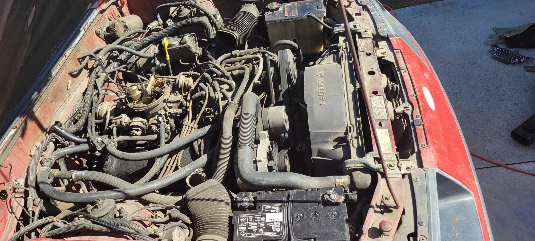

Hi, I just acquired a Mustang that's been sitting in a garage for 20 years. Aired up 2 tires, added 5 gallons of 91 octane and filled up the radiator. The owner had opened the petcock and drained all the radiator fluid
when parking it. I also put in a new battery. Turned the key, fuel pump came on for a little then shut off. I cycled the key 4 times and turned it over. I fired right up and then stalled out. I started it again and again, it shut off. I did this about 15 times and while feathering the throttle I could get it to stay running, but it always died. I replaced the fuel filter by the tank, didn't help. I looked at all the vacuum lines and all looks good. From what Ive been learing, I'm wondering if it could be the IAC or TPS or the MAP. Any thoughts or ideas would be most appreciated.
Thanks.

Oh man, its a CFI car. Not the end of the world but I hated that system on my T-Bird. My quick response it to swap it over to a carb and be done with it but you are in California. I am sure some of the guys will be on this shortly that can offer a lot more help as I just gave up and swapped mine but I am in Oklahoma so we don't have Cali's politics.
You may also try this forum as they are dedicated to the 79-86 cars and there may be a few more guys on there with knowledge on the CFI stuff.
Good luck as that is one nice four eye!
