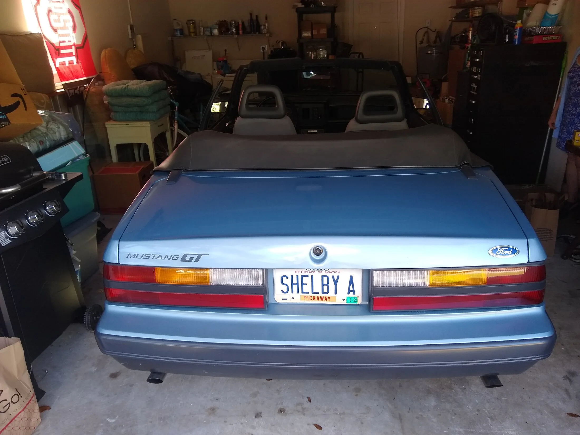

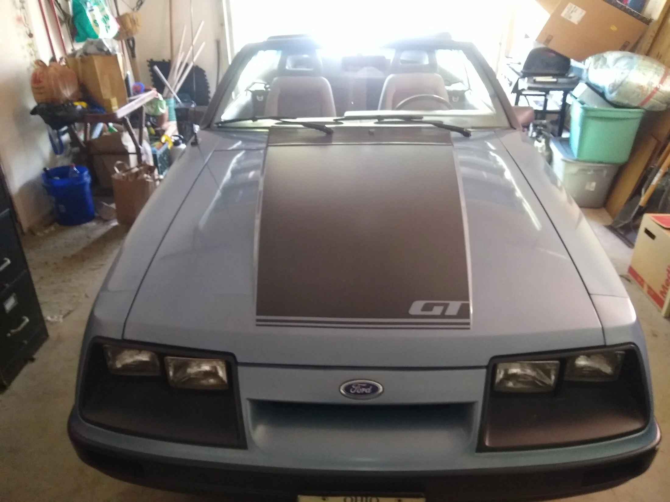

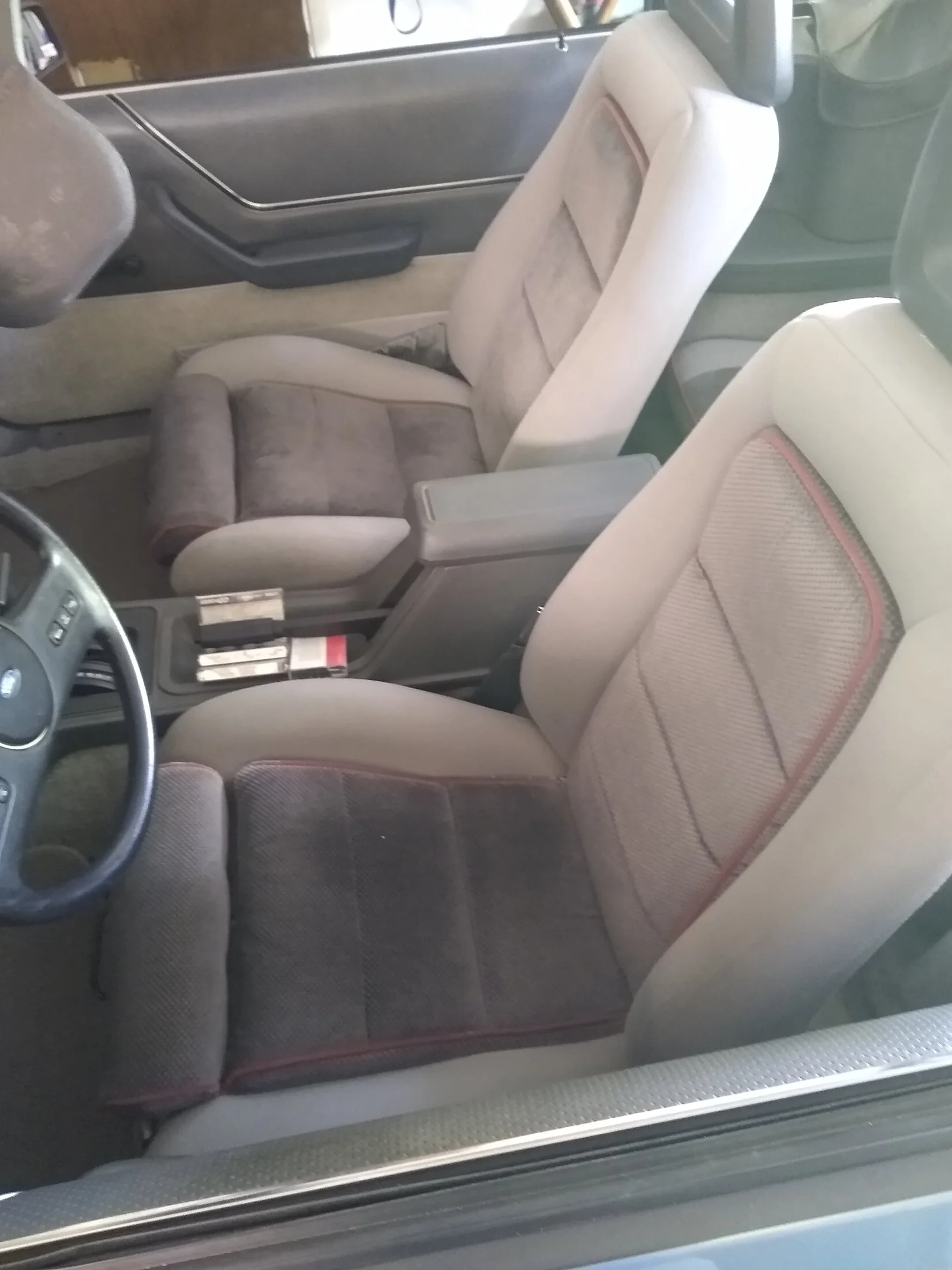

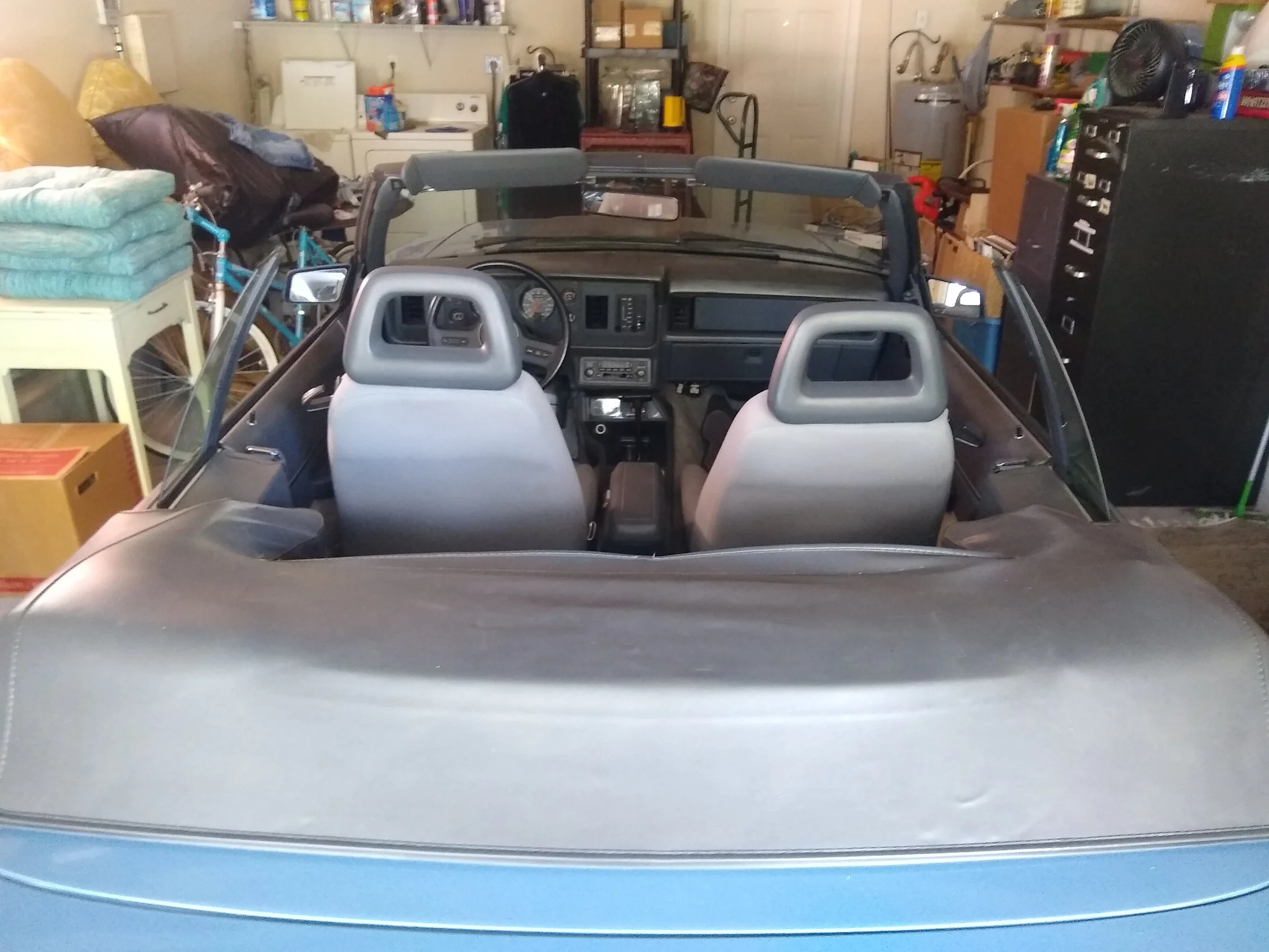

Can you post a picture of what you have?

Unfortunately I have not had time to do that. Gotta work and be a responsible senior adult first. lol Sorta funny cause when I took the pics this morning the girl says… maybe you should have sent pictures under the hood!! I just looked at her and took another drink of my coffee. she’s smarter than she looks. I’ll take some when I get back to the house.
