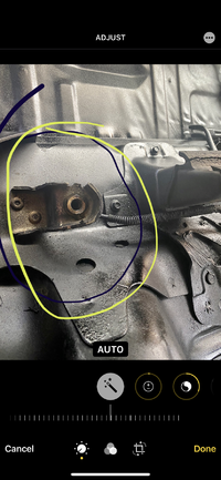

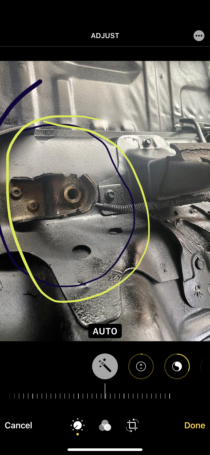

Thank you all for helping me on my build!

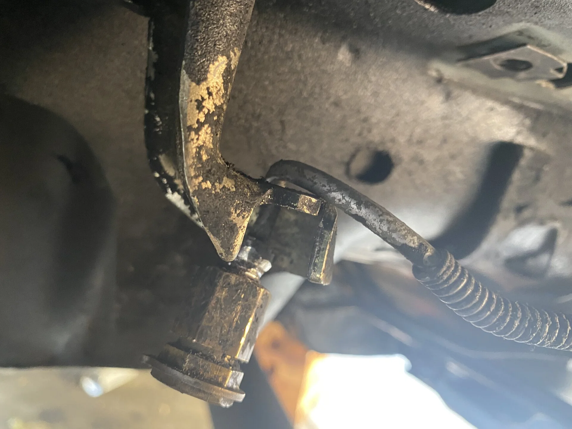

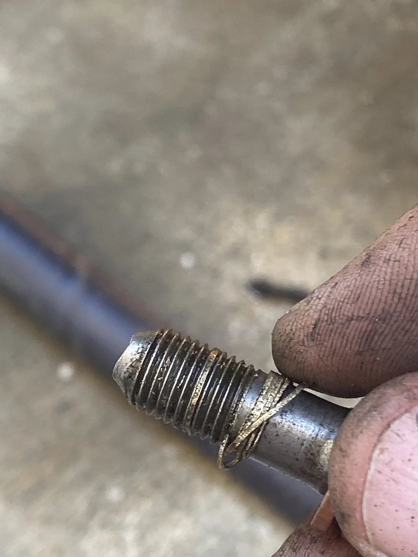

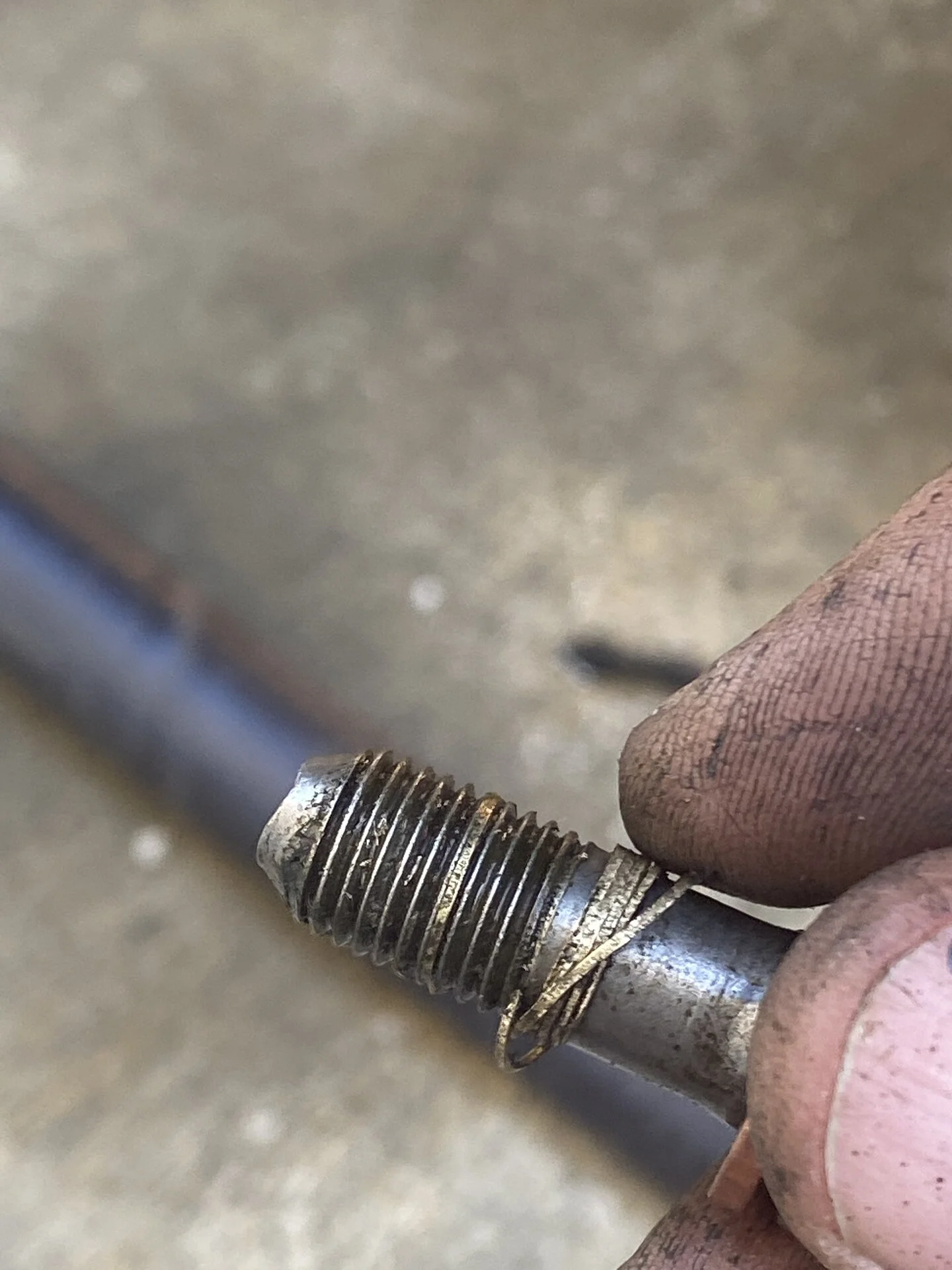

Sadly today when I was installing the REAR UPPER BRAKE HOSE BRACKET I stripped it. I was following LMR’s instructions to tight the screw to 35lbs n that was too much. So now have to replace thee bracket n flare the brake line
Any recommendations on how to do this?
What is the real torque on this?

Also, what’s the name of a rubber mount that is right above the rear gearsshaft
They do sell that bracket. I just replaced when I did my five lug conversion. I think I got it through LMR.
It’s two rivets to drill out, and then two new pop rivets to secure the new one.
Some guys have also used self tapping screws to reinstall.
As far as the flare..... you can probably go to your local Auto Zone, Advance, whatever is near you, and rent the flare tool. They’d probably have the fitting for the line as well.

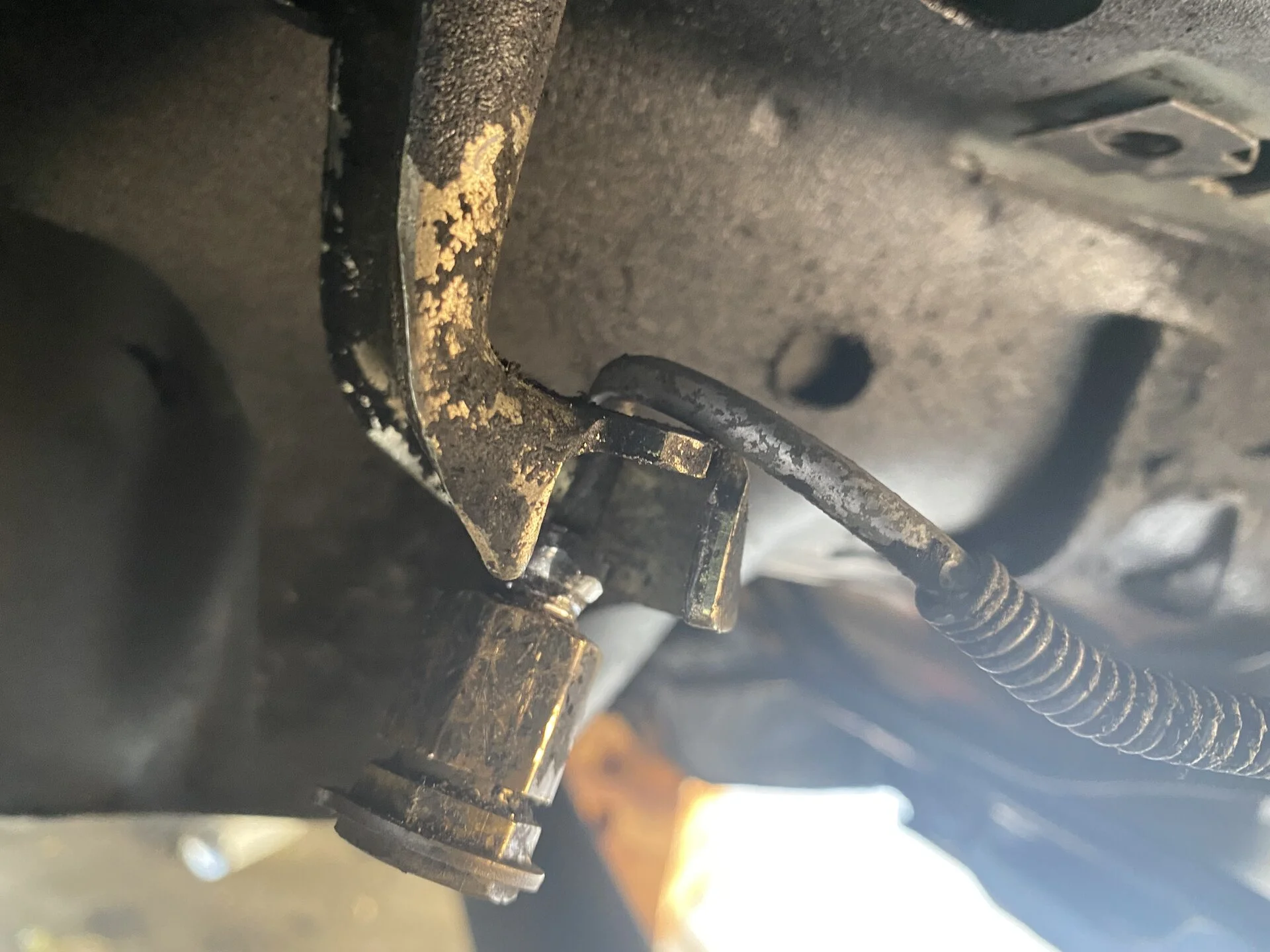

Do you know what the torque specs are? I was following Landens's video and he said 35lbs. Well 35 was too much and strippd the brass fitting. Plus the nut that is at the end fo the brake line is on their tight!!!

Where is the clip that should be holding that fitting to the bracket in your picture?
35 sounds like a lot....... let me check out the video and see what he’s talking about.
I watched the 5 lug conversion video I think you were looking at. Landon is talking about the the banjo bolt, which attaches the soft line to that fitting, when he mentions the 35ft/lbs.
That hard line that goes into the top of the fitting should be threaded in by hand and then snugged down.
It’s also much easier when that union is properly clipped into that bracket, as it is in the LMR picture.
And remember, two wrenches are always needed when installing these lines. One to hold the union to keep it from spinning, and the other to tighten the line, or the banjo bolt.
O I have it. I took it off after Fighting with the nut for an hour. I could not take it off with the right type of wrench for the fitting. It’s like it’s welded on there. Now do you know if they sell that brake line? I will hate have to make one.
