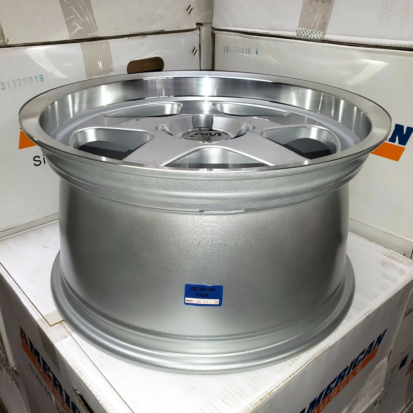

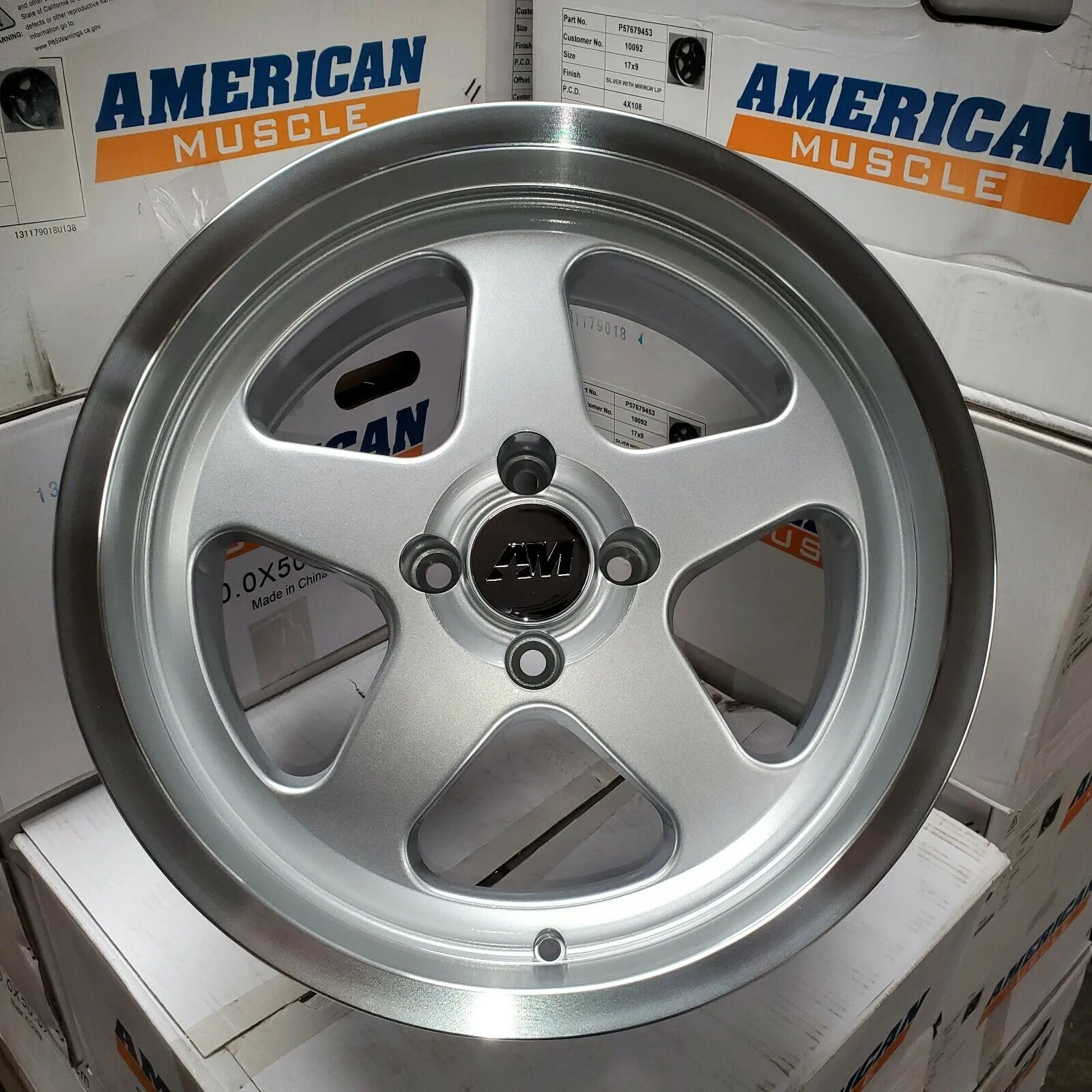

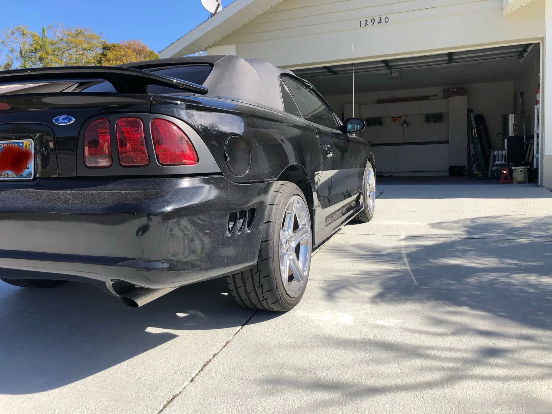

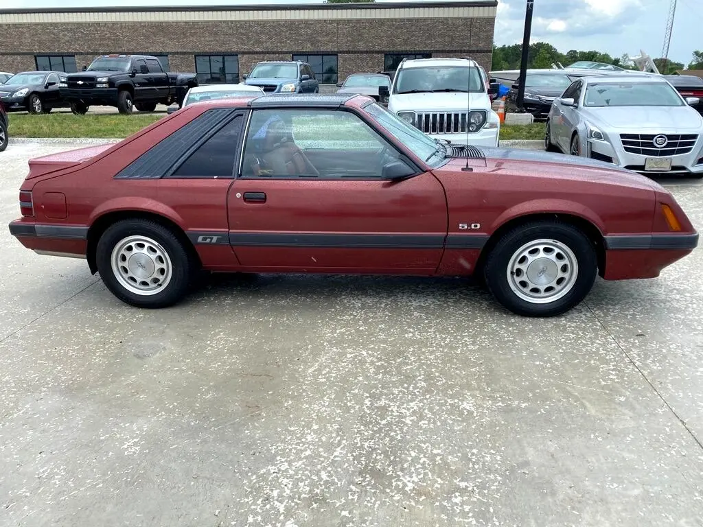

Hey guys, Trying to run these on my 86 gt, not sure what i can get away with, with the least modification. I have to do strut/brake/spindle change up front
and maybe some rack limiters but hoping to keep it to that with the right tire setup...Thoughts?

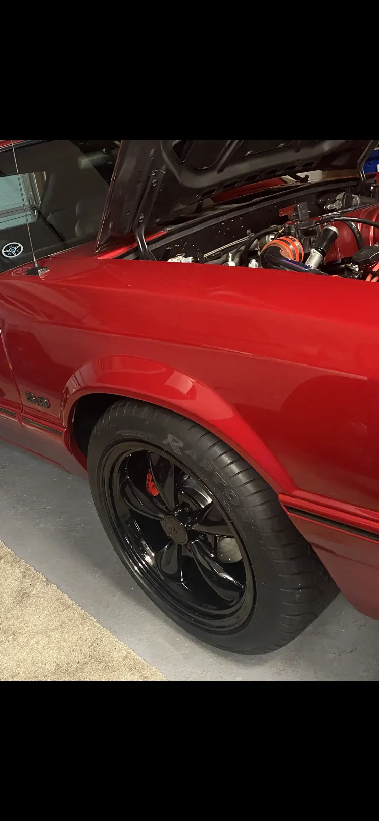

I have an ‘86 that had an aero nose conversion done on it. Not sure what that does to the front clearance, if anything, but I just put 17x9 Bullitt replicas on it.
275/40 fit on the rear with the quads flipped. I had no other fitment issues on the rear.
The fronts I’m running 245/45 and definitely have a little rubbing on full lock, so you may want to reconsider the 255. I do have a 94/95 spindle 5-lug conversion as well, so I realize we’re not talking apples to apples, but I thought maybe my info would help.

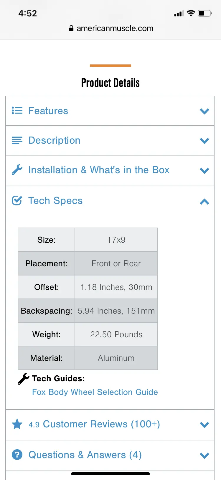

I’ll check the site to see what the backspacing is on my wheels. Got them from American Muscle.
Edit: here’s the specs on the wheels I used
Reactions: caljrjr

yeah my offset is +20mm and backspace is 5.79

I’ll get you a pic of my 245 on my 9” wheels tomorrow. I think they look fine.
I was worried at first after all I had read, but after watching some videos, and seeing some pics, I went for it.

rdub6 thank you, much appreciated man! I think they look fine. i like when the tires are flush and not sunken in the well, your rim is a little different

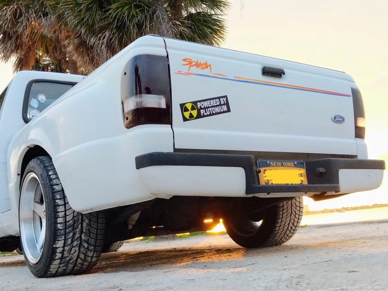

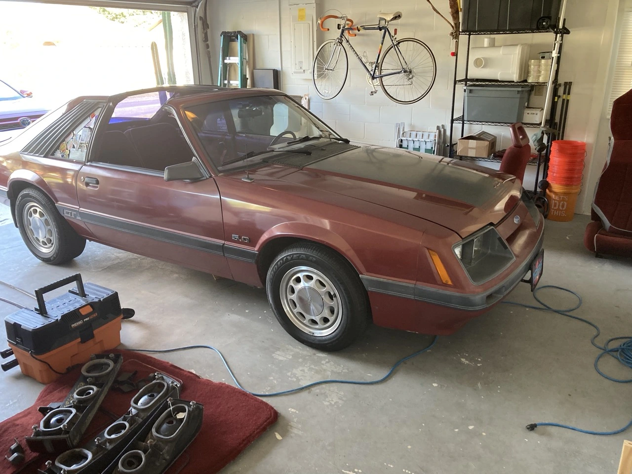

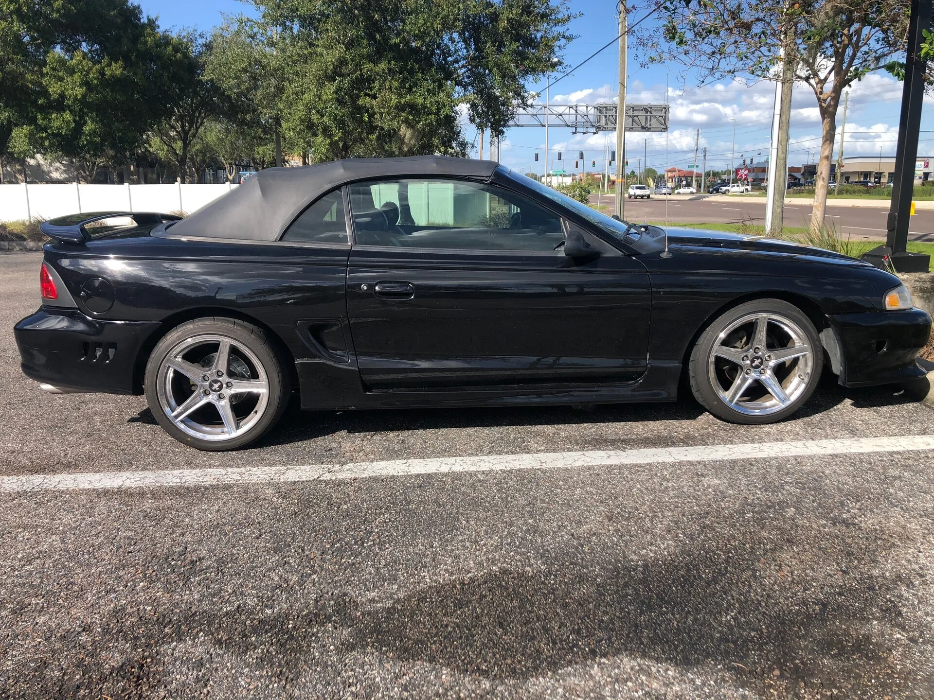

here's a pic of my ranger and 95gt i wish i still had.

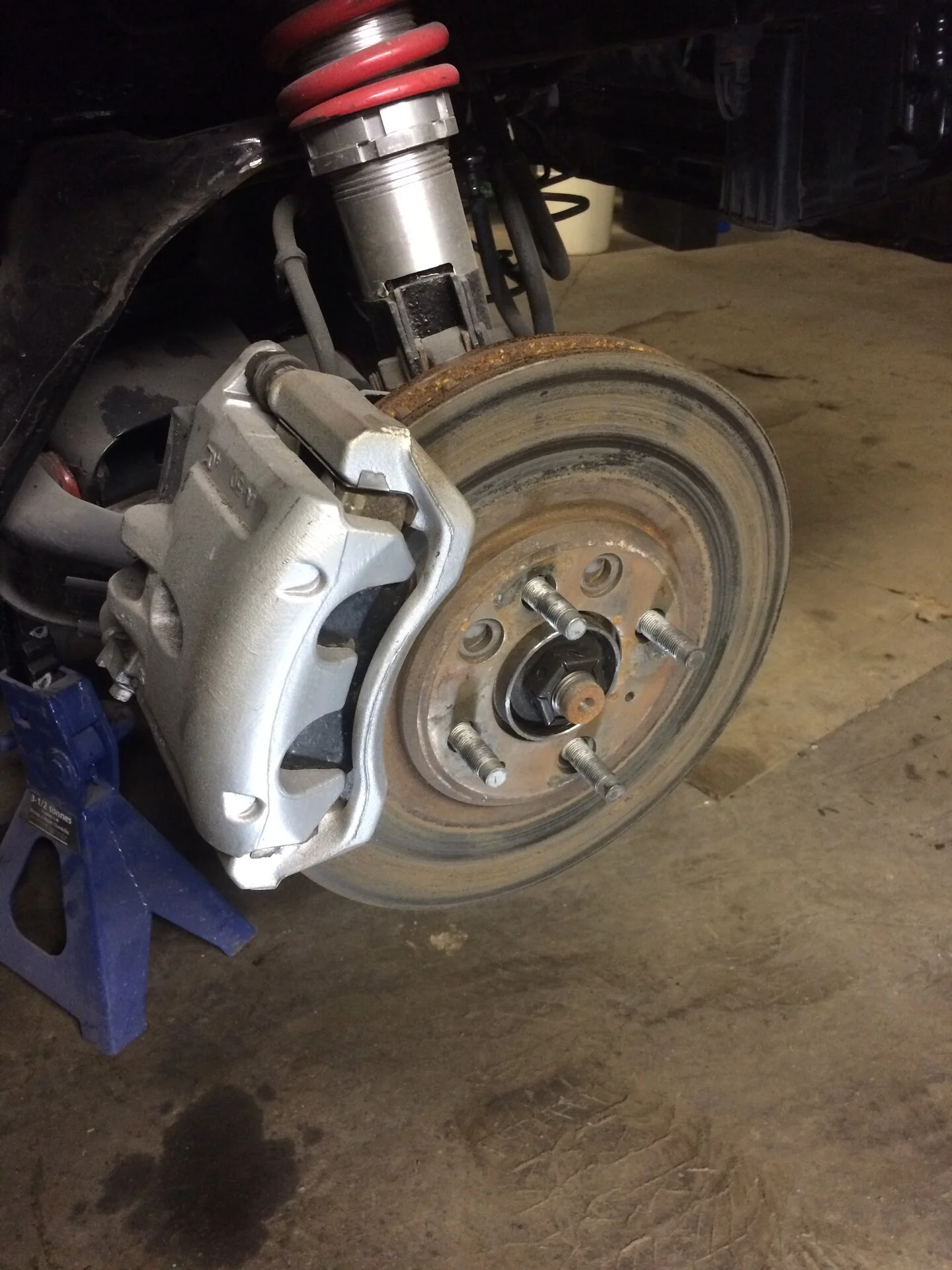

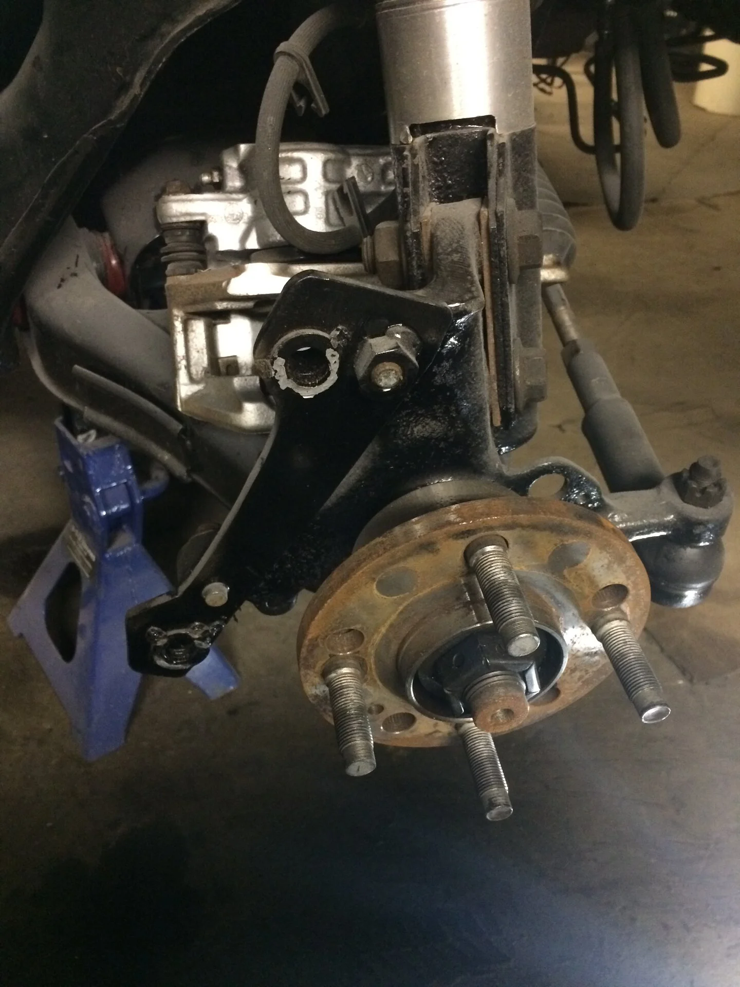

Here's an option for 4 lug and upgrading brakes...

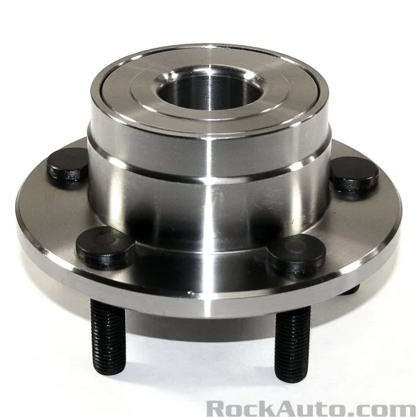

Convert to SN95 spindle - either 94/95 or 96-04 (I used 96-04). Source a new hub for an 89 Thunderbird (V6 or V8 doesn't matter - but it needs to have a smooth back, see pic below). Knock out 4 of the 5 wheel studs. Use your rear drum as a template and center over hub using the remaining wheel stud. Re-drill the remaining 3 holes and reinstall 3 studs.
Here was my 4 lug hub on spindle...
Now I used rotors and calipers from a Lincoln LS (thicker 11.8" rotor and dual piston caliper - but required 16" rim minimum) and re-drilled the rotors just like I did for the hubs. Lincoln LS/Jaguar S-type are 5x108 and our Foxes are 4x108 (same bolt circle), so one stud can be kept and used to center and align new bolt pattern.
If you wanted to keep 15" wheels and still use 99-04 PBR dual piston calipers, get rotors from a 94 Thunderbird (make sure you ask for this year specifically as earlier ones are slightly different) and re-drill for 4 lug. These rotors are essentially clones of the standard 10.86" SN front rotor but with a 5x108 bolt pattern instead of 5x114.3. So since SN 10.86" rotor was used with 15" rims, in theory you should be able to take advantage of SN spindles and calipers and still use OEM fox 15" rims if you wanted to.
The best part is, some day when you want to change to 5 lug, just change your hubs and rotors (calipers if you are further upgrading) and you are all set in the front.
